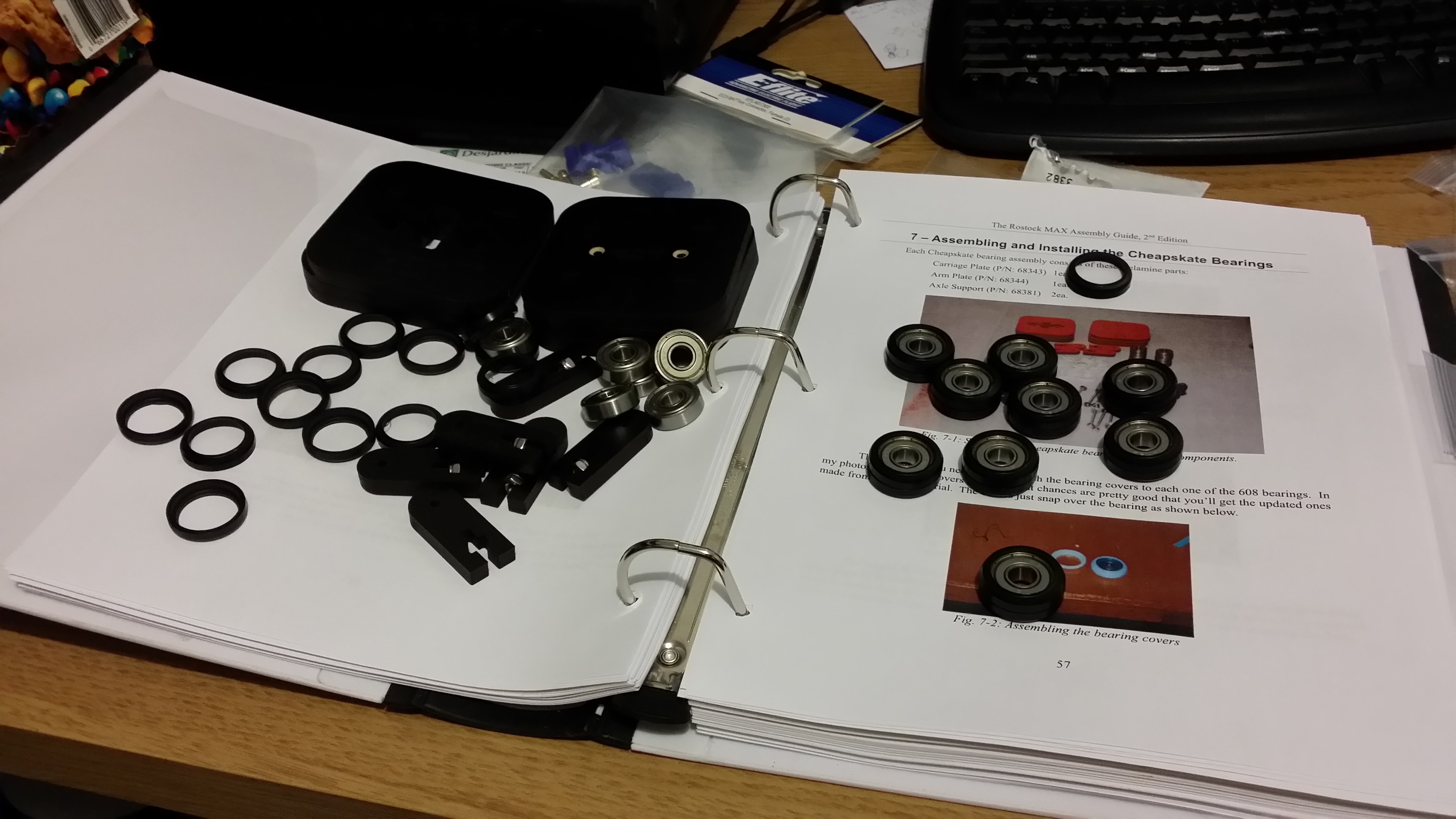

Assembling of the cheapskate assemblies went very well. When I had to put the covers on the bearings, I wasn't exactly sure how they were supposed to ride on the towers, so I was trying my best not to damage the VERY thin plastic of the inner race on the outside facing end of the covers. Turns out that doesn't matter in case anyone was wondering. The first one I tried to put onto the bearing I almost pushed a hole through my desk. CRAZY tight. I guess it was just an oddball because the rest went relatively easy.
Bearing covers.  Fun stuff.

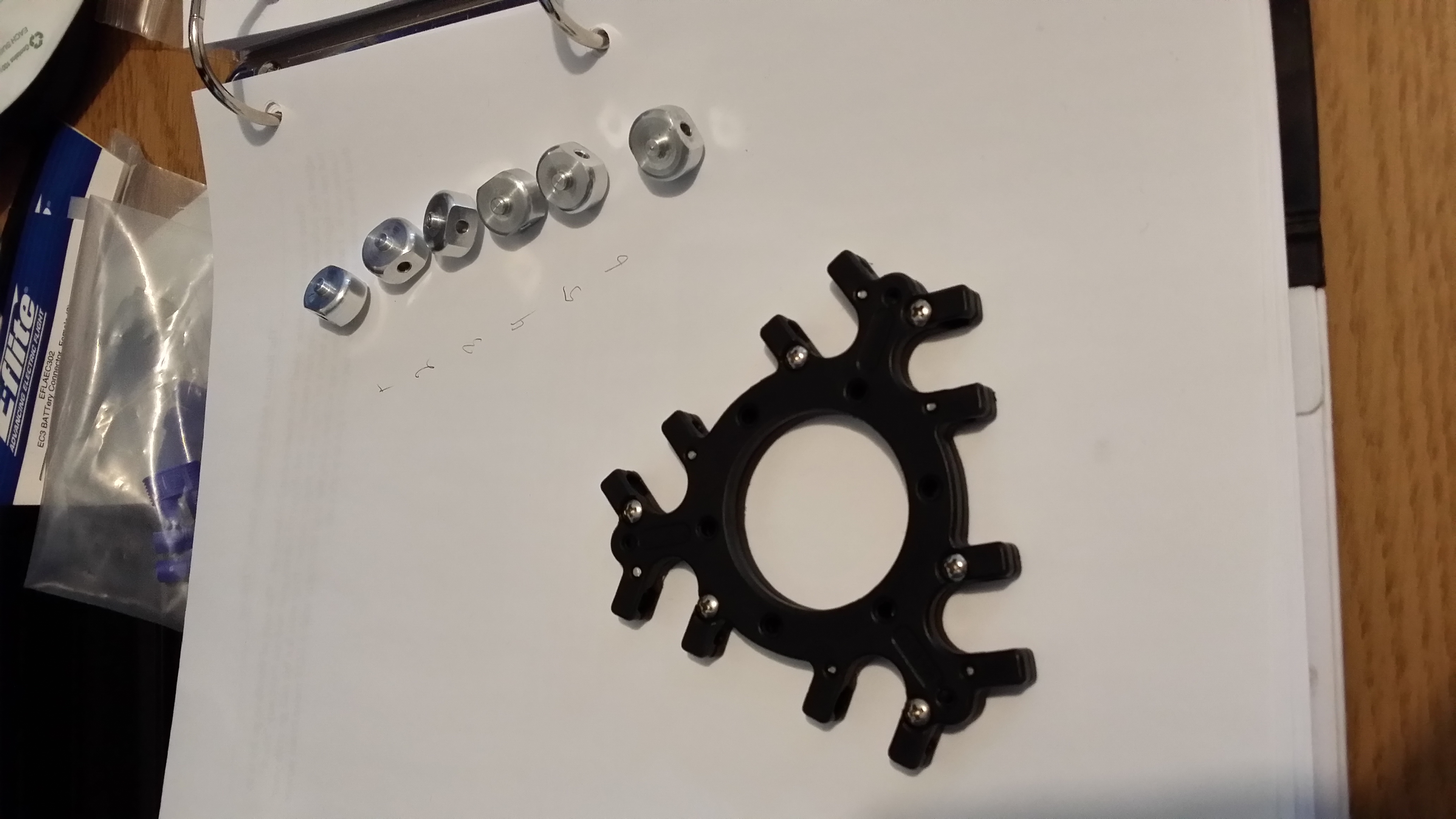

Next was another fun part! The effector platform! This was another incredibly tedious job, but it didn't involve bent shafts, binding u-joints and shims which essentially made it a walk through the park for me. Albeit a lonnnng walk. The moulding is fairly crude on these pieces so there is a decent amount of overhang that can be removed. What I ended up doing was using a utility razor and (as suggested by others) scraping away the plastic until the u-joints fit. This took some finesse and a lot of time. I assembled the platform pieces together without the shafts or anything and I numbered each u-joint space. Then I would take a u-joint, number it and go to work scraping. Once it fit in the slot just the way I wanted it, I moved to the next. Once all 6 were done, I assembled the whole thing to find where there would still be binding. With a couple assemblies, a bunch of patience, and a touch more of break-free on each shaft... That thing was running smooth. Aerospace bearings don't have that type of tolerance. I also smoothed the entire assembly and not just the areas where the u-joints sit. If I was going to spend over 50hrs assembling this cork soaker, I was going to do it right.
Numbering the u-joints
Now time to get that effector plate attached to the cheapskate using the redesigned Delta arms! No sanding at all my ass! I would have to attach the delta arm, wiggle it onto the u-joint (which would hold onto it like death), remove it with a knife and then take a tiny file and grind down the shiny spots in the holes on the delta arms where it's grabbing the most. Again, this is supposed to have ZERO wiggle room. But it still needs to move smoothly. I think 3 u-joints worked spot on. The other 9 took me a number of hours to complete. It does depend which way you have it attached on the u-joint as well. One pin on the u-joint seems more 'square' and I believe that it's this side that lines up with the 'straight' side of the delta arm. Please correct me if I'm wrong or if I'm crazy and one side isn't actually more square.

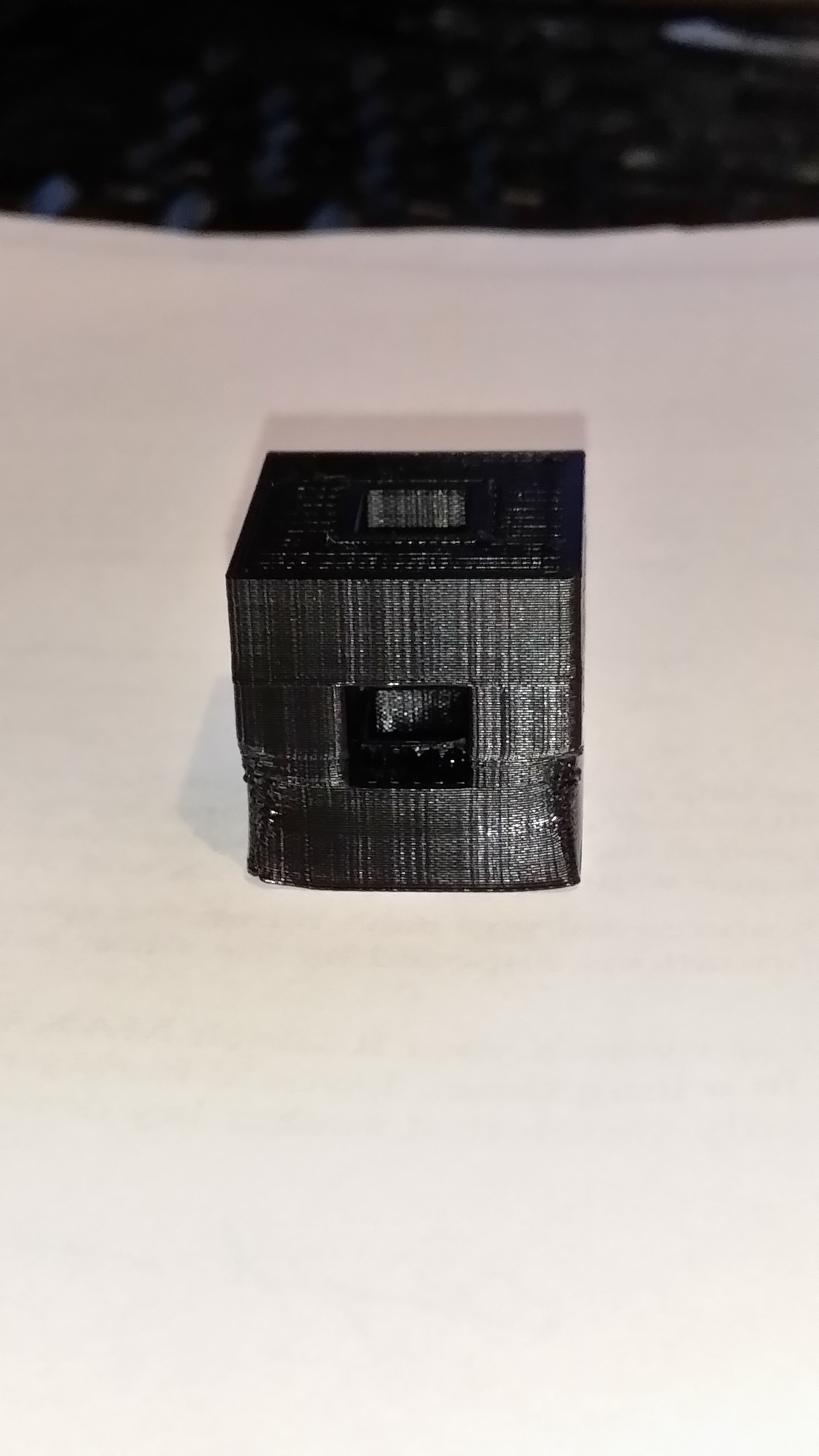

Here is another view so it's possible to see the inside of the cube.
First print.  Inside cube.

http://www.thingiverse.com/thing:43983
I've reprinted this thing and it basically came out exactly the same.
The 'top side' looks pretty good.
But the bottom area looks like a disaster zone. Is it because of the angle that it needs to print at? I haven't been using supports. I might have just answered my own question taking a good look at it right now...
Or perhaps this might not be the best fan duct to go with? I know there are plenty, but maybe someone has used a few and found one that works best. I just liked this one because it seems like it might curve the air around to get all sides, eliminating the need for more fans. I'd really like to get rid of the house fan. It's louder than the printer when it's running.

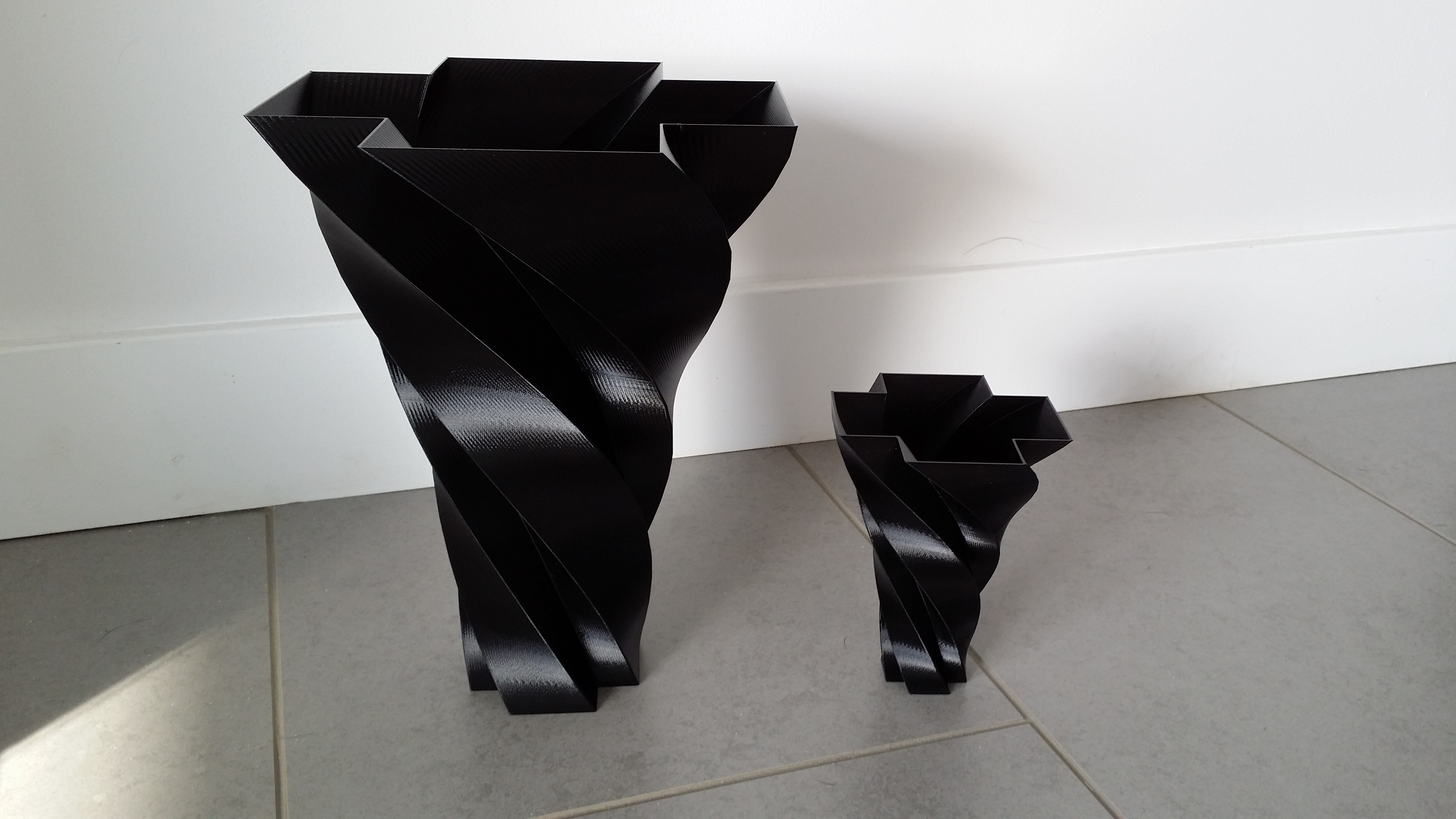

Posted: Sat Feb 22, 2014 3:11 pm
by Tinyhead
That fan duct makes a huge difference.
Tried changing a few settings trying to get my retractions a bit better. Noticed that what I initially thought was the spool 'jumping' was actually the extruder skipping. I pushed my temperature up to 190 (black PLA) and don't have any problems unless I try upping the speed, which makes sense.
Tried modifying a few settings trying to get better retractions so I don't get those little bumps all over my prints. Used the Retract Calibration Object http://repables.com/r/147/ to see what I could do. Ended up tinkering with the Top Infill setting and was blown away how much better it makes the final touches. Going to have to play with some of these settings more.
I've got some stringing going on, but overall I don't think it's too bad at all.
I also left my printer running for the first time last night to see what I would end up with in the morning. Just something simple, but larger than anything I had tried before. The 'Giant Plus Vase' http://www.thingiverse.com/thing:81908. I scaled it down to 50% just in case it did decide to fail.
I was pleasantly surprised in the morning!
To me it looked amazing. The wife even wants me to make a full sized and a medium size to put up for decoration. Now THAT... was a real surprise. She hasn't been too fond of the machine and the time I've spent on it since it's arrived, but now that it's spit out something that isn't just calibration objects and fan ducts, I suppose she sees that she might get some benefit out of it as well.
There is this little lightning bolt on the top and bottom from the layer changes. It would have been nice if the layer change had stuck to one of the seams like it did for most of the print, but oh well. I suppose figuring out how to avoid that stuff will come in time.
Got some Harry Potter-esque lightning going on here.

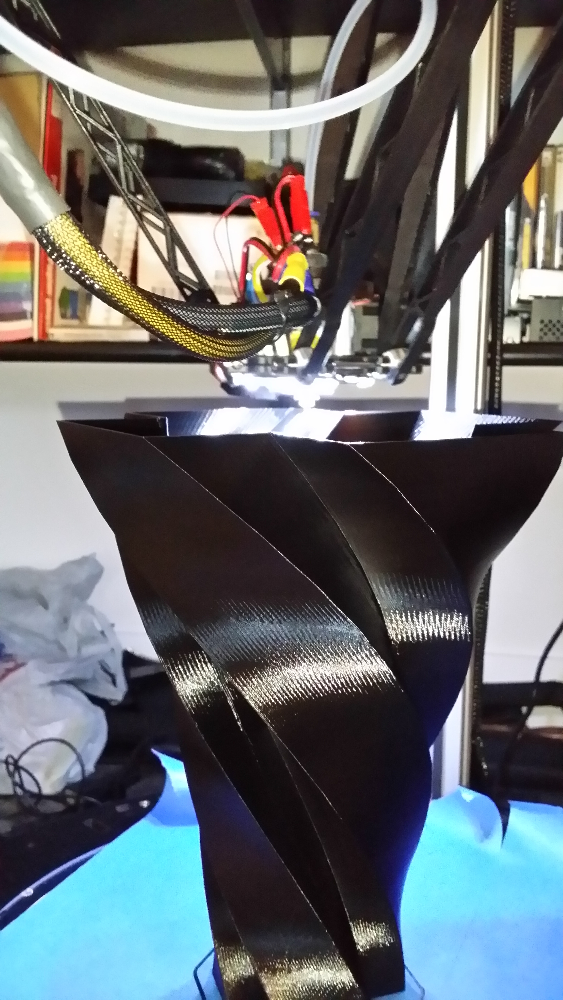

Re: Tinyhead's MAX Build
Posted: Sun Feb 23, 2014 9:08 pm
by Tinyhead
Started printing the full version of the vase last night. Came down this morning and it was at 91% (still about an hour and a half left). It was my first print from the SD card and took around 13hrs. When I saw it, it was within the last couple inches of the operating envelope and my hot end wiring was dragging on my print as it went around. Luckily it didn't get snagged on one of the vase corners! That wire loom is like velcro when it comes to thin points like that! I pulled it up in the picture and rested the cables on one of the extruder mount screws.
Still printing away!
Full scale next to 50% scale.
