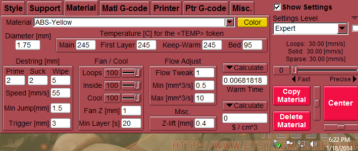

no support actually 4 perimeters print from inside out. yes it is abs

What for slicer you have used?
bubbasnow
Posts: 1061
Location: Dayton, WA
Re: diablo x 0.5 scale
Post by bubbasnow »
kiss pro

bubbasnow when you have time and pleasure ( pleasure? I don`t know is this right ? I hope )
can you make screen shot from the kiss settings?

Woolf wrote:I use kiss to and is really a nice slicer.
which setting do you want? material or printer?

when is for you okey, the Material settings, retract and Style. thx

here u go in attachment
material settings yellow abs

I have problems with the retraction and I will test your settings.
