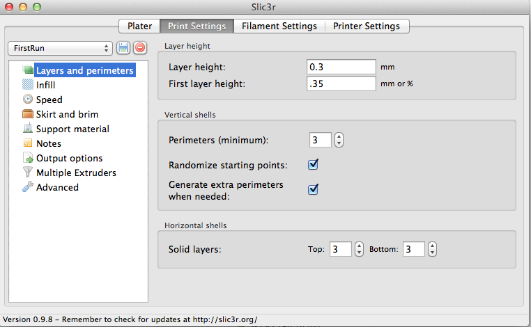

I'll be honest, with a part like this, I would make it in two pieces. I would remove the large holes stand-off so you have a flat orientable surface to put on the print bed. Then design it so the large hole stand-off (printed separately) slides in and can be glued. No support necessary. Thin walls like this, I have lately been setting a lot of perimeter loops so you don't get little tiny infill movements from the hotend. IMO It's better if the plastic goes down as several loops, rather than an inner and outer wall that the slicer tries to fill the space between with zig-zag infill. I hope that explanation is as clear as mud :D
The only other thing I would caution is maybe adding a brim or raft so the corners don't curl on you. If you are printing ABS? The rest of your settings are hard to nail down, too many variables. My typical: ABS-hotend 230C, heated bed-80C(augmented with a ceramic heater, switching to a radiant soon, keeping print area warm), Speed- first layer-30 then 100-150(?personal choice) beyond that gets slicer specific. Good luck :!: Post a pic when you do it. :)

This part is engineered to be one piece, I can't tkae it apart and glue it back together without losing all of its strength, can you explain the perimeter loops and how to set them up in slic3r?
I don't use slic3r anymore, but I think if you increase the "Perimeters(minimum)" in Vertical shells, it will do what I'm talking about. On your part, 5 should work? I encourage you to look at Kisslicer, if only for the graphical UI where you have the ability to check tool paths :)
I agree with the strength issue of changing the part to a point. I think it's a question of getting a clean print versus a little re-design. That's the beauty of being able to print our own parts. We can try prototypes, if they don't work, not too much is lost ;) and you go back to the original. I wish you success :!:
