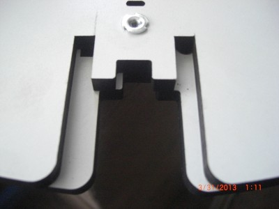

Re: My super cool build story, Rostock MAX
Excellent job, I think you win the award for posting the most pictures!
One comment, did you ensure that the top plate aligned with the bottom
plate before you mounted it? There is a "bias" to these plates and the top
plate should be placed on the bottom plate and turned until they line up
perfectly and then mounted. See this thread: http://forum.seemecnc.com/viewtopic.php ... &start=210

Eaglezsoar wrote:Excellent job, I think you win the award for posting the most pictures!
Good question. Yes, I did, they aligned perfectly when I put them on top of each other. However, I'm not 100% sure if it still lines up after you rotate the plates... and I completely forgot about that alignment when I put the thing back on so I may have put it on at a different rotation. I will have to take it apart and make sure now.
EDIT: After taking it apart, it appears to align perfectly no matter the rotation, so that's good.
[img]http://i.imgur.com/5uvi2cO.jpg[/img]
[img]http://i.imgur.com/5AZJIpy.jpg[/img]
