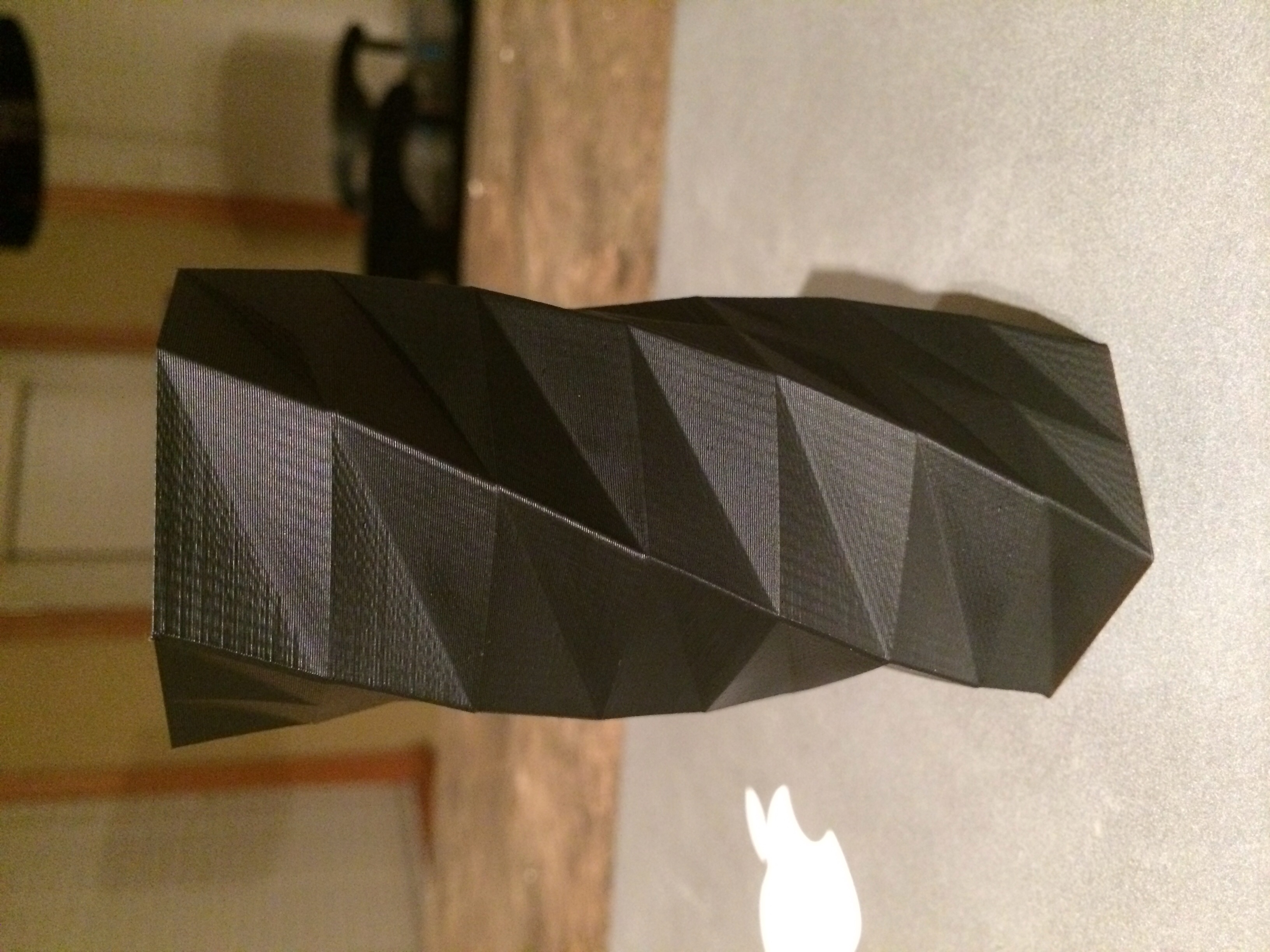

Hey everyone! Just got my Orion yesterday and boy is it awesome! Printed out a test print then started using some of my own designs. I have a question though. When I went to print the test vase, the nozzle seemed to be touching the bed when printing the skirt. No abs could be extruded and some of the glue stick glue started building on the nozzle. Does this mean I need to adjust the screws to adjust the z-height? I'm kind of scared to do this, so I would really appreciate any help!
I also noticed: when heating, a little abs is extruded and if not removed, will be eventually added to the design. Should I just make sure I remove this before the print starts?
Thanks guys and like the title says, I'm new! I'm learning new stuff everyday and I am loving this new hobby!

Congrats Silentdoom! That's a great looking first print for you!
As for the z height, there are two ways to adjust that. The first is, if the nozzle is starting too low, turn ALL 3 screws in (down) equally on the carriages. Reverse the direction for a too-high nozzle condition.
The second way is, connect to the machine with repetier host per the quick start guide, and click on the home button in manual control tab. After the machine homes (you can also type G28 and then enter), jog the nozzle down to the table until it JUST BARELY touches the table. Then in the g code box type M251 S2 and press enter. This stores the new Z height to the board as well

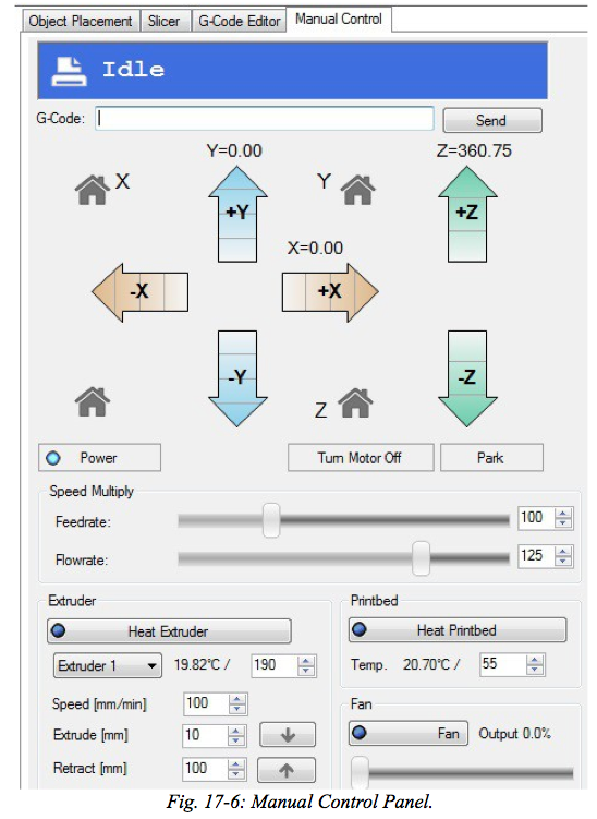

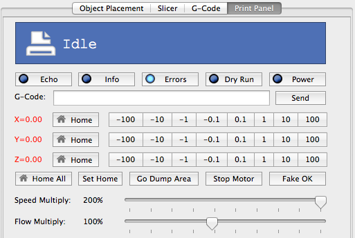

Ok, so I connected to repetier host last night and couldn't figure out how to move the extruder down in the software. Anyone who uses a Mac and Windows know if the Mac version is missing features? Or was I supposed to manually jig it down?

I use a Mac, but haven't used the Windows version. However, just based on the pictures in Gene's manual, I believe the GUI in the Mac version isn't as fancy for moving the print head around. The Windows version appears to have graphical arrows. The Mac version just has the number buttons next to the X/Y/Z axis that you click to get the same effect. Per my understanding the Windows GUI looks like this (Gene, I screen captured this from your manual. Hopefully that's not "Theft" or "Copyright Infringement" per the Creative Commons License :-D):
Windows movement GUI
The Mac GUI for the same operations looks like this:
Mac movement GUI
Mac movement GUI

EGADS, that barely counts as a GUI. I guess just be happy they ported it to MAC, but it looks like they did it under protest or at the least very grudgingly.

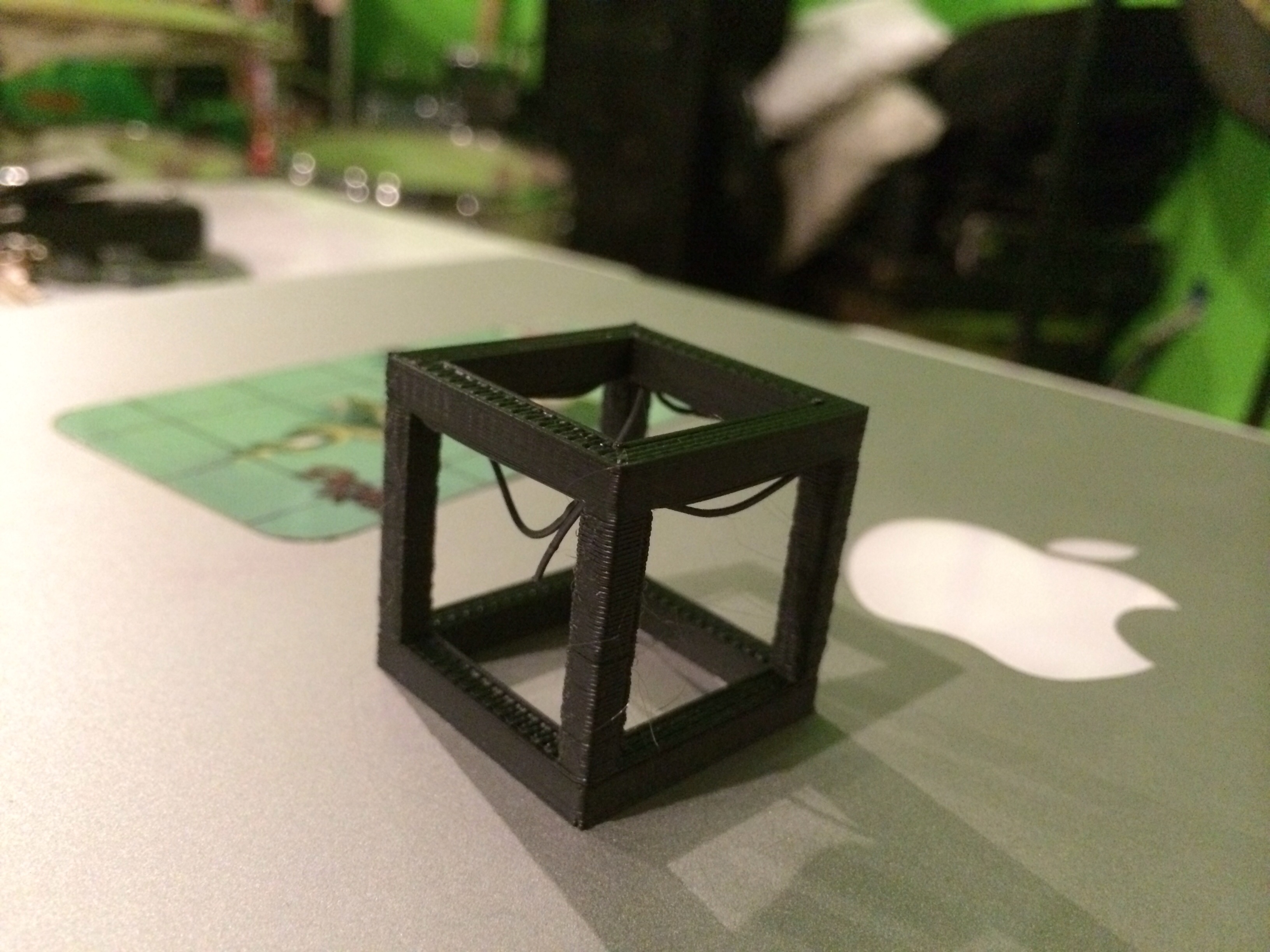

Hopefully this doesn't upload sideways. I think it's looking pretty great! I've been trying to print small yoda heads to use as a monopoly piece, but I'm having problems with warping. Any suggestions for small pieces? I thought maybe I should place a couple on the build surface, so each layer could have time to cool? Might try that now!
