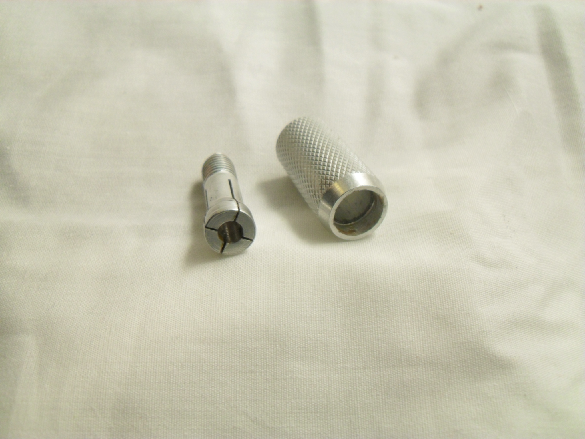

Welp, I lost my cold-end stock PTC yesterday to a failed collet. After seeing the amount of slop that had worn into it, I'm starting to think that this application goes a bit beyond the design intent for tubing movement. That or the stock fitting is of inferior quality...
Good news, though. The stock (and most commonly used in 3D printing community) fitting has an M5x0.8mm straight thread. This is almost identical to a #10-32 straight thread, at least for short thread engagements. I had easy access to more than one brand/variety of #10-32 PTC fittings, and I am currently testing.
The difference, quantified, for those interested:
- 5mm = 0.1969 inches --> #10 diameter = 0.1900 inches
- 0.8mm thread pitch = 0.0315 inches --> 32 thread pitch = 0.03125 inches
I wrapped the #10-32 thread with some teflon sealing tape to take up the gap, and there seems to be no reason why this isn't going to work long term.

Re: Heavy-duty push-fit connectors?
I use these hitch pin clips from Harbor Freight, there is a size that fit the push connectors perfectly and prevent it from going down. http://www.harborfreight.com/150-piece- ... 67557.htmlxnaron wrote:daftscience: are you still happy with these ones? http://www.amazon.com/SMC-KQ2H04-M5A-Co ... m_indust_1
I am thinking of picking some up.
Anyone find any other good ones? I bought some from robot digg and I can see the ptfe move up and down on retracts. I am printing some little spacer clips to stop it but not holding my breath....
update: the clips fit perfectly in both the robot digg and seemecnc pushfits. Attaching the STL's. I think the robotdigg one will also fit on the seemecnc push fit. It is a beefier design. It prevents the bowden from moving. Print at 0.1mm layer height.
