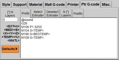

I found that using Repetier Host the following g-code turns on the FAN 0 port on the RAMBO board where the S# is the speed (0-255):
M106 P1 S255
Here is where I placed it in KISSlicer to automatically turn on my PEEK fan which I have wired to the FAN 0 port:
"P2" might turn on the FAN 1 port, but not 100% sure about that because I did not try it.

How is your code different from the code that I found and modified for the FAN 0 port? Will your code work in KISSlicer if I use the correct P# for the FAN 0 port?
Re: Putting Alerts in Repetier / G-Code
The FAN 0 port is supposed to be used for the layer fan. That's the port that is controlled by the fan slider in Repetier.
The FAN 1 port is used for the PEEK fan.

inventabuild wrote:I found that using Repetier Host the following g-code turns on the FAN 0 port on the RAMBO board where the S# is the speed (0-255):
M106 P1 S255
I use KISSlicer also and it work fine with standard gcode line:
M42 P6 S255
Here is how I setup it in KISSlicer:
[img]http://i.minus.com/iH70yIlgf87d3.png[/img]
I plugged PEEK FAN wire to Fan_1 and LAYER FAN wire to Fan_0 on RAMBO Board.
PEEK FAN starts with the start of HotEnd Heating.
