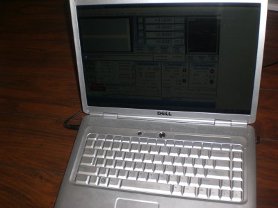

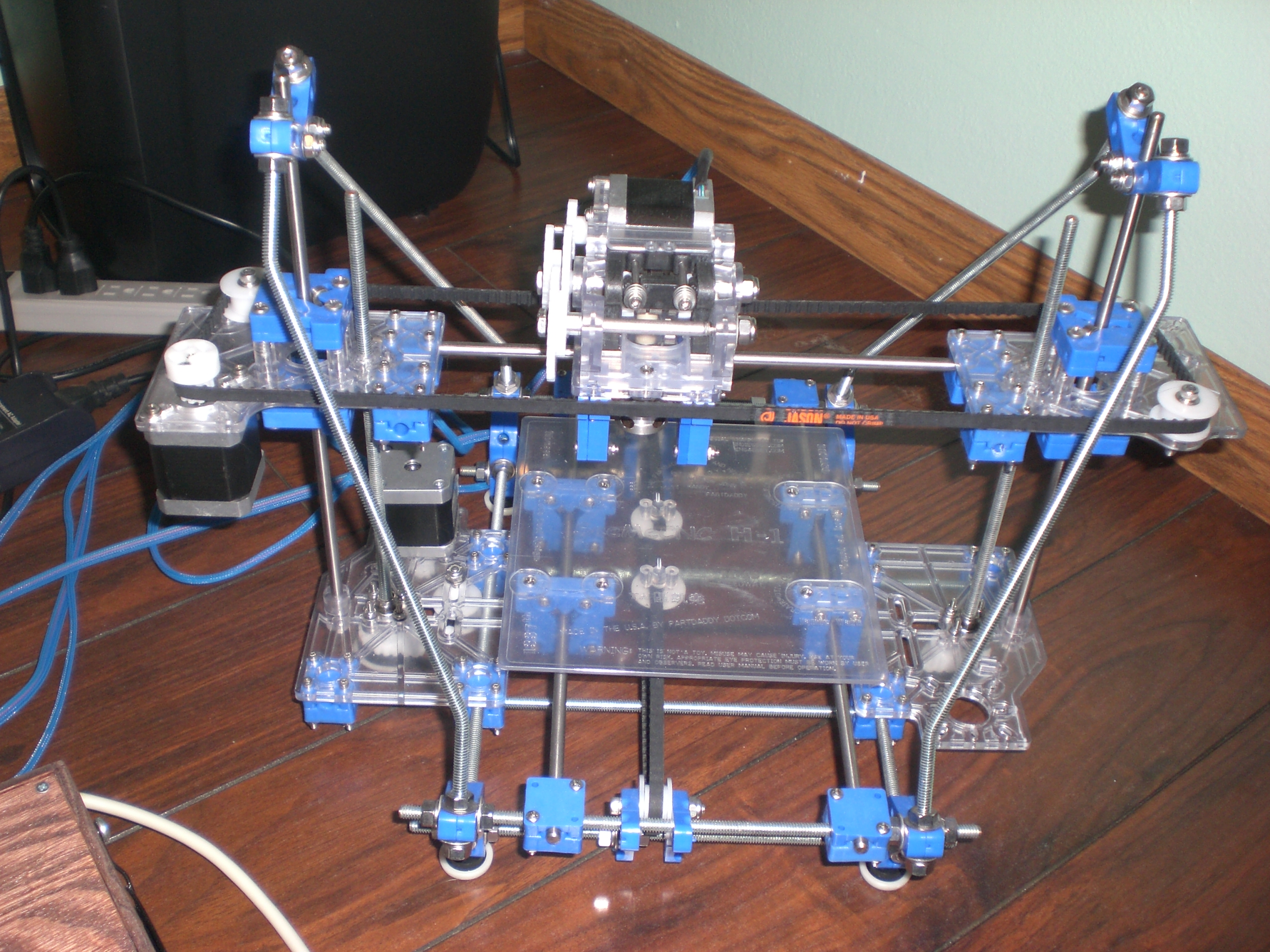

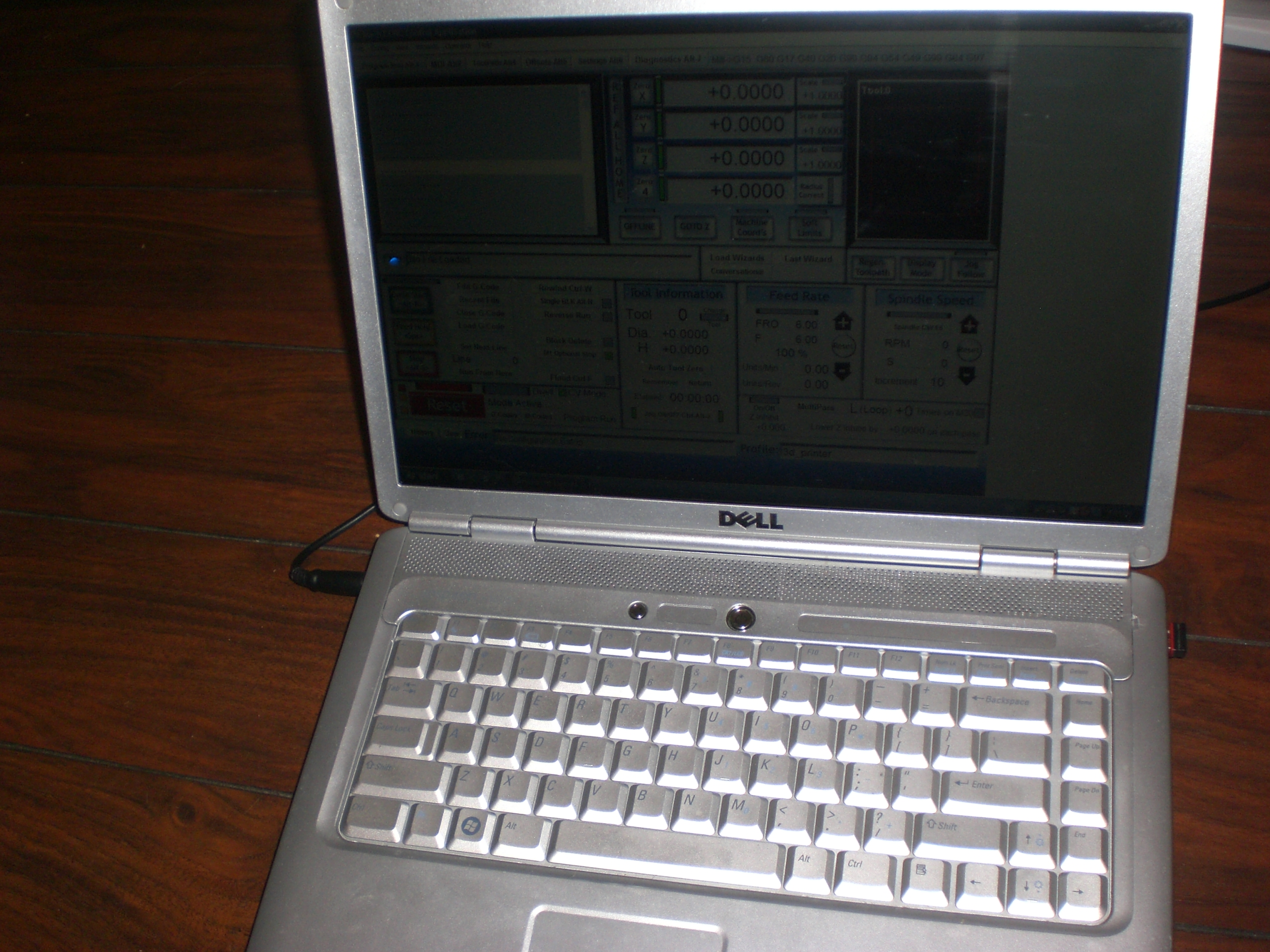

Ok, I have my printer Physically together, Except for the hot end, But now I would like it to actually do something.
I'm using mach3, on a windows XP laptop... I don't have room for a desktop.
I can't find a Good tutorial on setting up mach3 anywhere, and to be honest, I don't know where to start.
I am looking for someone to guide me the rest of the way.
I work in a machine shop, and understand most of this... But the rest is above my head.
When I finish this project, I'm going to start a YouTube channel, for absolute beginners like me... Because finding information is a complete nightmare.
Thank you in advance.

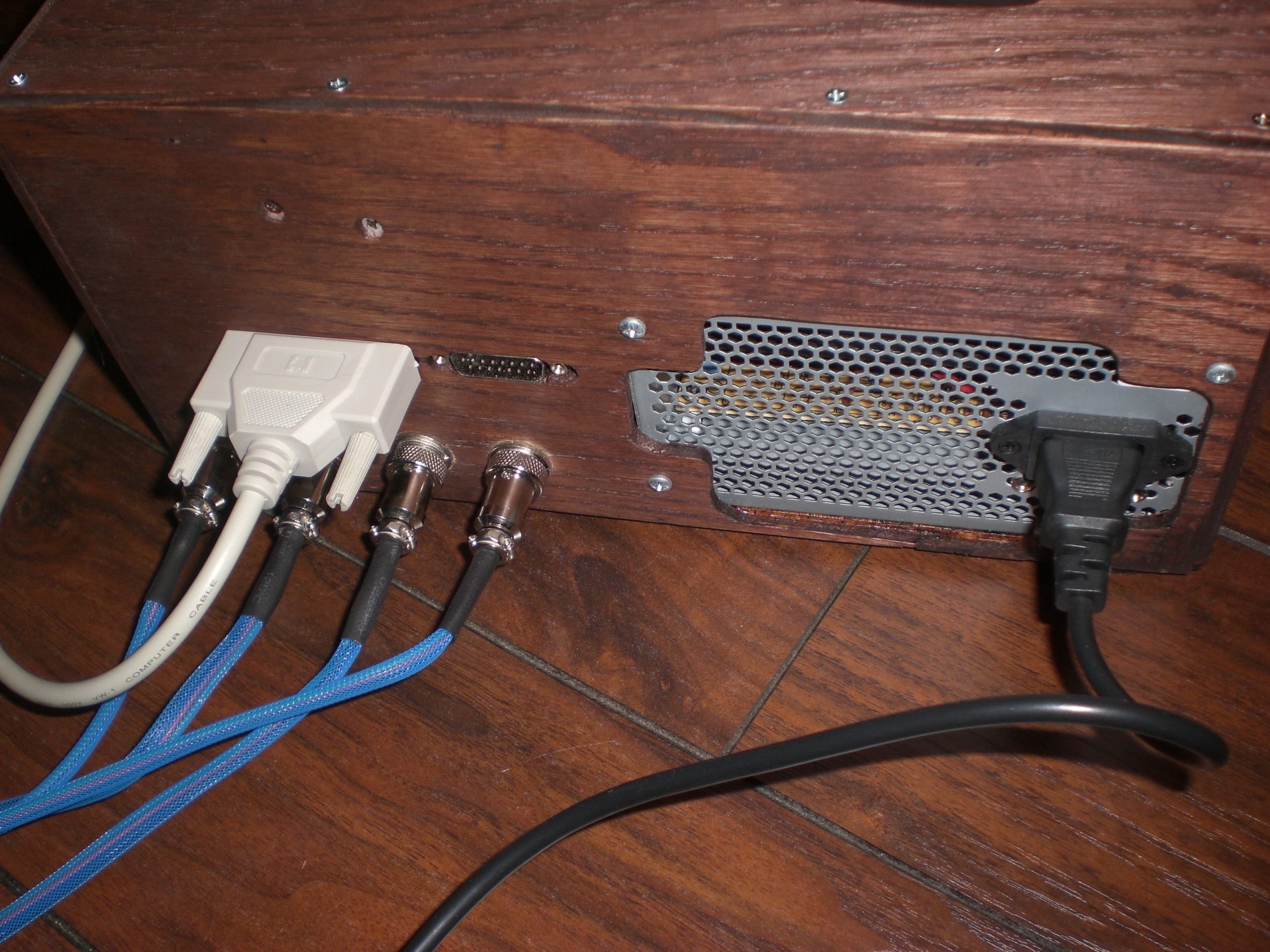

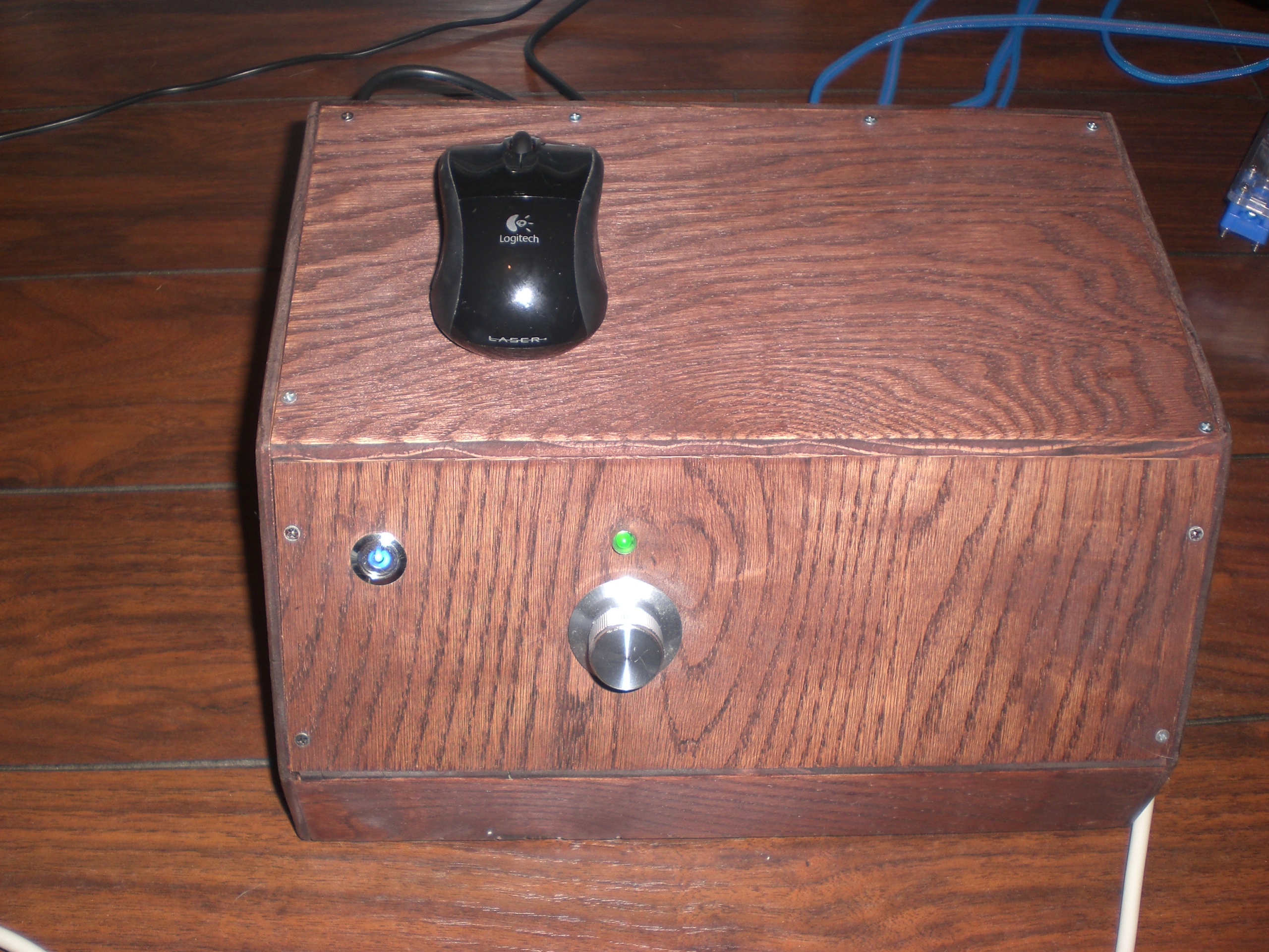

Is there a tutorial for the absolute beginner... I'm completely lost on this now.
I'm using the "StarTech 1s1p 54mm Express card with 16550 UART" for my 25 pin connection(RS232?).
It's a dell Inspiron 1525, with windows XP.
The stepper board is the stock TB6560 driver board, with the jumper modifications performed, per the online manual.
I'd like to get it working with mach3... But I will look into the "Ramps" controller, once I save up some play money.
Thank you for the quick response.

3D_what, I'm in the same boat. I'm (just now) ready to turn motors but haven't found a setup file for Mach3 and the original 3-axis board. I also have a ramsey controller for the extruder that's not wired yet. I appreciate the advice on getting arduino and RAMPS but I'd like to get what I have working first and then maybe build a different machine with the arduino based stuff. will the 4-axis config file work with my 3-axis board?
Re: Need Help with... Not sure what I'm doing.
It should - since you need a 4th axis to run the extruder. The external stepper driver (they used to be EZSteppers) is the 4th axis on the 3 axis board. The 4 axis board has enough drivers for X,Y,Z and the extruder.

I found a xml file for mach3 but it's for the 4 axis board. It does have different pin settings than what I had. Now I'm getting a clunk from the motors when I power up so I think I'm getting closer. I see a lot of discussion about the 4 axis board here but not on the three. I haven't wired my ramsey to the controller yet. I've also seen settings for the DIP switches, but again they're for the 4-axis version, and mine are set different. I tried changing them and still no stepper movement. I'm encouraged though, thanks.
gadgetjon
Posts: 6
Joined: Fri Feb 07, 2014 9:07 am
Post by gadgetjon »
found the dip switch settings here: http://forum.seemecnc.com/viewtopic.php?f=26&t=426
switch 1,5 and 6 are off. I think that's what I have but I'll check when I get home
still looking for an xml config file for the 3-axis board
gadgetjon wrote:found the dip switch settings here: http://forum.seemecnc.com/viewtopic.php?f=26&t=426
I think this is for the three axis board.
SeeMeCNC H1.zip
(30.58 KiB) Downloaded 657 times
gadgetjon
Posts: 6
Post by gadgetjon »
thanks Eagle. I tried that xml file and also changed my DIP switches and I'm turning 3 servos now. Not good for toubleshooting but I'm happy it's working! now to hookup the ramsey and velleman. stay tuned.
