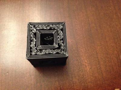

Well, that totally worked. Now I think I have the delta arm blues or possibly an extruder problem, so I need help with that.
Summary of my problem:
I bought the electronics kit and servos to build my own printer. That came with RAMB0 1.0d and 0.9 degree stepper motors.
Later on, I bought the Rostock MAX kit without electronics. My kit has the Onyx bed and the black knurled plastic belt guide bearing covers and the white acetal carriage bearing covers. The extruder mounts on the side. It came with a Steve's extruder, which I not using (yet).
I bought an EZstruder when they came out, and I'm using it.
I did the hot end and heated bed calibration, turned on EEPROM, and made those settings. I followed geneb's latest manual and did the calibration chapter using his values for settings.
I can now print! My original problem has been solved, and now I have a nice looking, but spotty calibration cube. I need help understanding if I have the delta arm blues or not enough extrusion speed.

Here's my first calibration cube. Measured size is 24.7mm, should be 5mm. I think if I solve the sticky arms issue that may resolve itself, so I'll leave it for last.
First print, probably with delta arm blues though
Re: Rostock Max bed very convex - radius doesn't help
Posted: Sat Aug 03, 2013 12:36 pm
by JohnStack
Great!
You're printing almost 5x the size it should be? 24mm instead of 5 mm?
I would keep things simple and avoid a multivariate analysis - I don't think you're to the blues part yet...
The top appears to be starved for filament - so start futzing with your slicing software...
Can't tell anything about the sides...
Once you've gotten a stable print that's filled well, not stringy or too much plastic, then maybe go back to tweaking your eeprom/hardware.
I've gotten extremely clean prints without adding hardware. You can too.

Posted: Sun Aug 04, 2013 6:40 pm
by itilguru
Ok, that totally worked. I changed the extruder value back to 92.4 and now I'm printing beautiful cubes and already moving on to new prints!
This thing is really loud. I love it, but now I'm setting up a webcam and moving it to my garage. :lol:
