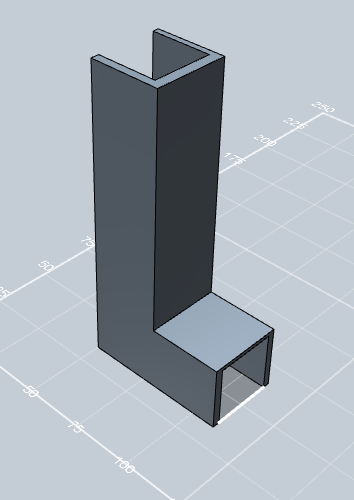

Hi,
I've started on a design for an all aluminum base/top for the Rostock Max. I'm not sure I'm going to sell them but I am considering that as well.
To come up with a design, I have some features that I would like to include as well as features that I probably should include but haven't considered.
Without embarrassing myself with a drawing, here is the description:
Bottom:
The base does not include electronics. Those are held in a separate box. (TBD but Hammond has some decent ones)
Six plates or wings coming off of a center object. (The center is likely to be a triangle.)
Each wing slides into a slot in the center triangle and is affixed with hex cap machine screws.
T-bars slide in between each pair of wings and are keyed. The keys leverage the side slots of the t-Bar.
T-Bars bottom out so no calibration, 100% precise. Set screws hold the T-bars in place.
Steppers and Rollers are the same config as the Rostock Max.
Top:
The top essentially mimics the bottom except in reverse except the end stop switches screw into the top.
Belt handling is essentially the same.
Other features:
To support the Onyx, a 3/8" aluminum ring will screw into the top of the base. (Anything I should do for heat loss?)
Questions:
I am considering other nice to haves. Please let me know if you would do this:
Pre-drilled holes in the top 'wings" spaced every inch - on top and bottom so that other things can be mounted (EzStruder), spool
Some kind of tribal design cut into the wings on the top and bottom - just to give it an edgy look.
Anodizing.
Belt Tensioners (I've never had an issue here.)
Precise base leveler
Aluminum Bubble Level
Why am I doing this?
I want to see if there is demand for a base. If there is, I'll make them - but only if it is profitable. I have access to a high volume CNC shop.
What am I missing? If you were doing it, what would you add? Beyond Barry Werner's, ave you seen any that are really great?
Your ideas are really welcome here. I would love to design the end all machine here - both to take advantage of opportunities as well as nip a few things in the bud. Maybe you've done one yourself! If so, let me know!
Also, if you've seen a commercial looking box that would be suitable for the rambo and a 600W power supply, let me know.
THANKS!!!

Since the T-bars are so critical, have you considered having the base's wings allow for slight pivoting (toward and from the triangle) and have the top wings have some keying that you can lock in. You lose the potential for no calibration of the T-bars, but you give yourself alot more flexability in machining tolerances for not only your parts but the T-bars as well. Since the structure would be so rigid it is very likely that you would only have to perform that calibration once.

The wings will be cut in one run using a Haas VMC 6/40 TR. I'm going to give no adjustment a try first and then if required, something else.
Assuming the T-bar is straight, I'm hopeful that tweaks like this can be avoided - as well as something to keep the bed on the level.
I've considered asking for a change in the Onyx design to accommodate more screws - like in the center - but I have also talked to other folks who can make same/similar independently heated beds for about $200. Not sure here.

I don't really understand why you want a different base, John. How do you expect this aluminum base to be better than the melamine base? Will it be better looking? Smaller? Bigger? More rigid? Heavier? Lighter? Easier to assemble? More exclusive?
Have you looked at the Cerberus printer? (Cerberus is a great name, BTW.) Does it have anything in common with what you want to do?

I would worry about depending on the squareness of the extrusion cut to determine upright location. Possibly some sort of set screw adjustment (in two directions).
Purple = sarcasm

Good suggestion. We'll see what we can do. Have a couple of ideas. Hoping for a mostly finished model with photos by late next week.

Ok, I've got the wing design almost set - but I have a GINORMOUS question:
How do you recommend running the wiring for the hot end and extruder? I'm going for an ultra-clean look...
Right now, my plan is to run it all through two of the uprights (barely fits but does) and have the bowden tube and hot end wiring arch between one of the uprights.
Also, a second Max is on the way - so the project is looking like I'll have something to post the week after next!

Run it through the side channels in the extrusions. Cover them over with a strip of acetate or something similarly thin and stiff.
Like this.
Like this.
You'll have to figure out how to route it so it doesn't go under the bolts and T-slot nuts. Or maybe you can use bolts short enough that they don't protrude past the nuts. 80/20 also sells thinner nuts.

I would do that; however, I'm using the side slots. They're sliding over keys in the wings. That gives it rigidity/precision.
Maybe starting routing wire above the keys.
