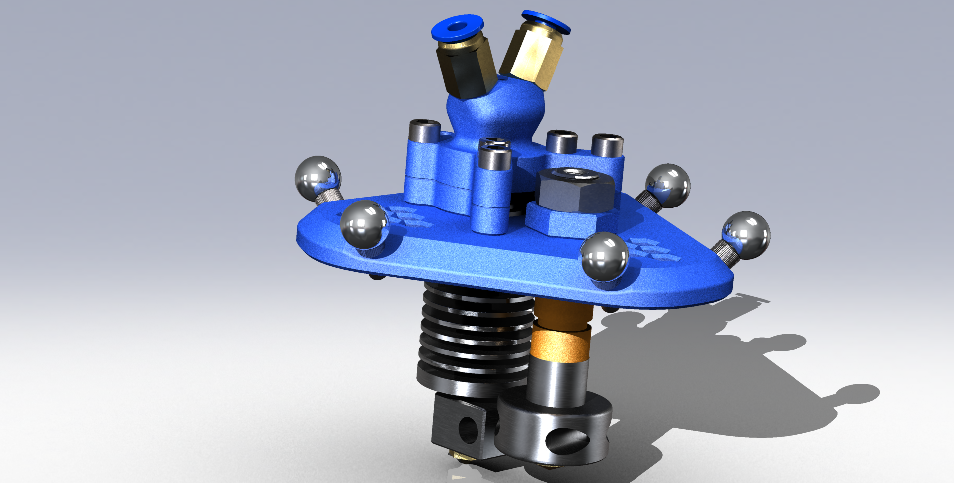

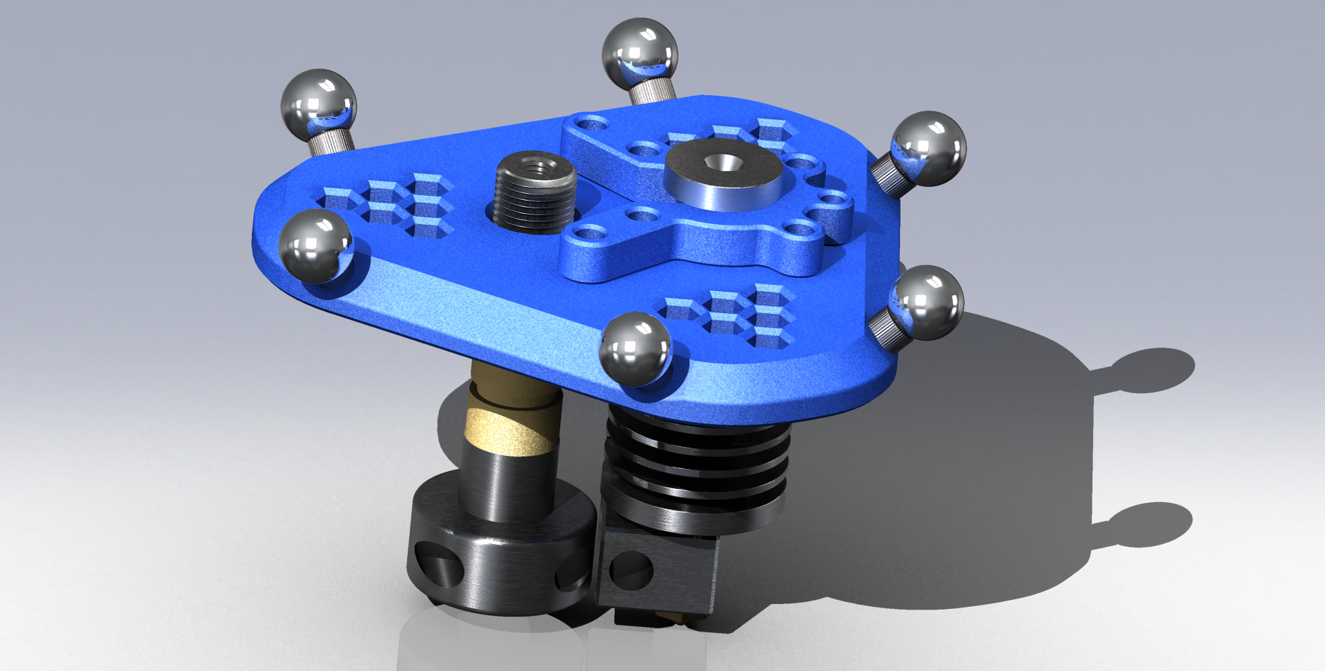

I still don't have dual extrusion working, this time because of alignment and calibration problems. My delta platform rotates just a tiny bit when it moves around the build area, and this rotation, even though it's too small to see, is causing the nozzles to get offset from each other as they move around the glass bed. At one end of the bed, the one nozzle is lower than the other. At the other end, they switched and the lower one is now too high. It's a difference of about 1mm over the build area, but that's way too much for printing. I checked to make sure the towers are parallel, and they are, and I checked the arms to make sure they're the same length, and they are.
I've made a few different effector platforms and I rendered my last two iterations. My newest one has both the seemecnc hotend and an E3D hotend on magnetic ball joints. The E3D one is set up with an adapter to input filament from up to three different extruders (not at the same time; it's meant for dual extrusion with retraction, not color mixing).
The adapter that merges the filaments into the hotend works great, but my cold end extruders really suck. Both my steve's extruder and greg's extruder constantly jam and grind and can't do decent retracts. They were just as bad before I had this design but the design won't work decently until get my extruders working right. I need to figure out how to prevent my effector platform from rotating while moving. When I eventually build my own printer, I'll probably go with a cartesian one to avoid all of these geometry complications.

Here you go. It's a set of a few stls, so just print them all at once or something. I made mine out of trimmer line nylon with 3mm shells and 30% fill in Cura.
You need some screws around 3 or 4 mm x 20mm

by kbob
Nice design! May I ask what modeler you used?
Are the honeycomb holes for cooling, weight reduction, or just because they look good?
As for your platform rotation, I wonder if your ball joints are not all at the same height. If one arm of a pair had a smaller vertical drop than its twin, then it would move further in the horizontal plane.
You can check the effector platform by setting it upside down on a flat surface. Check that all six balls contact the surface. I'm not sure what the best way to measure the height of the balls on the carriage. Maybe set a precisely planed brick on the bed and bring the balls down until they touch it.
And then, if that finds the error, you'll have to figure out how to correct it.
Re: Dual extrusion how-to
Posted: Thu Aug 22, 2013 12:13 am
by Generic Default
I use Solidworks. It's excellent for this kind of stuff, and you can get the full version absolutely free from certain websites...
The hex holes are mostly for routing the wiring through and maybe future attachments like cooling fans and stuff. They're also a lot more rigid than the straight line infill that cura puts in at 30%.
I'll check the effector plate balls to make sure they're level, but this kind of stuff is a lot harder than it looks to fix! I know exactly what the problem is, but I don't know what's causing it.
The method I used on this design to get the two different types of nozzles level works really well. There is a printable nylon spacer nut between the threads and the groove of the seemecnc hotend, and you just tighten the steel nut on top of it to compress the nylon nut a few hundredths of a millimeter to get it perfectly aligned with the E3d nozzle. All of that precision is useless when the whole thing tilts though, so make sure your delta platform is perfect.
