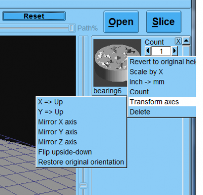

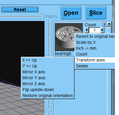

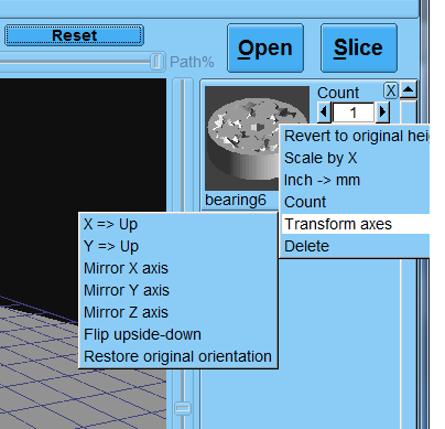

jesse wrote:Does anyone know how to rotate a part in KISSlicer or in general?
It's stuck sideways.
[img]http://i.imgur.com/MuTUkaq.png[/img]
Yup, go over to the right side of the screen and right click on the objects tiny picture and you will see a menu/submenu called transform axis.
In that submenu just select Y-up, or X-up and that should do the trick.
MorbidSlowBurn
Posts: 169
Re: mhackney's KISS settings
Post by MorbidSlowBurn »
Flateric posted as I was getting a screen cap. As he said right click to get the menus.

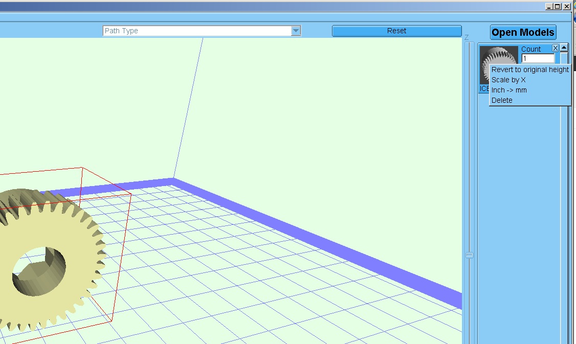

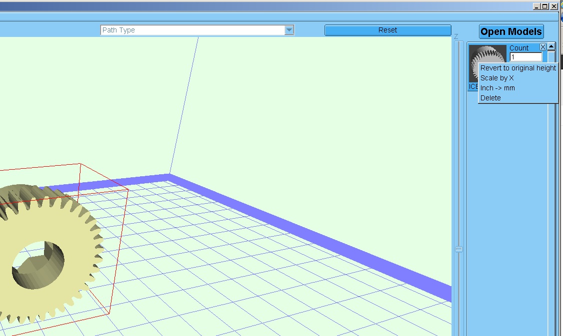

Leave it to me to somehow have a completely different set of choices from everyone else. Any ideas about why I don't have the option to "transform axes"?
MorbidSlowBurn
Posts: 169
What OS and Version are you running? Not sure if it will have an effect, but have you set up the printer settings in KISSlicer yet?
