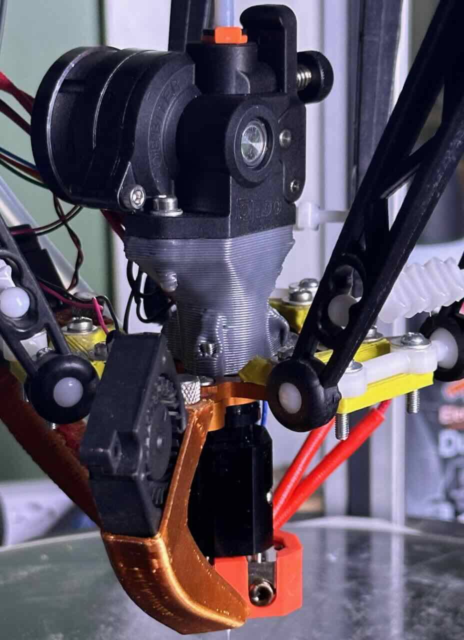

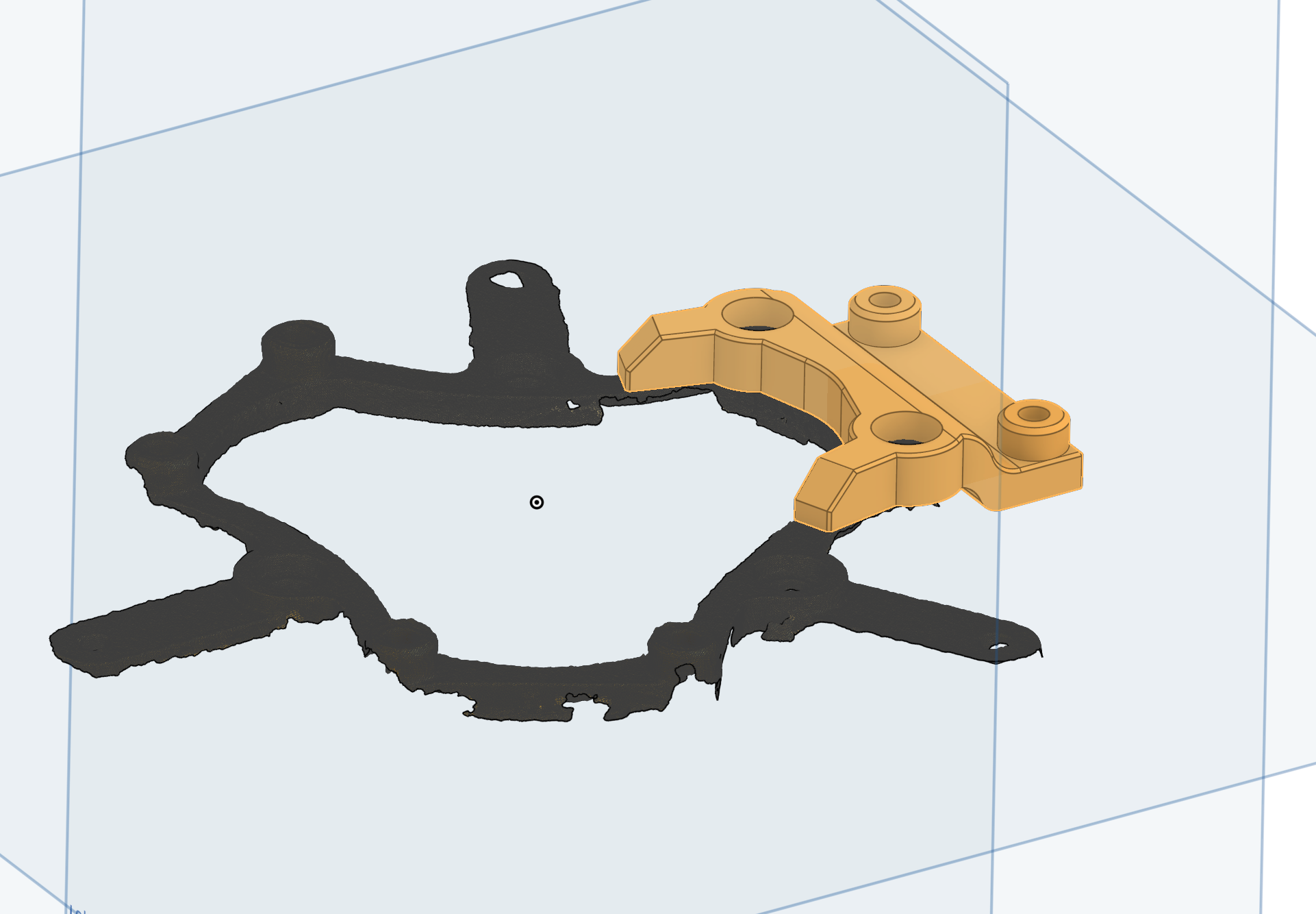

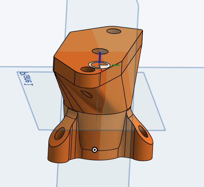

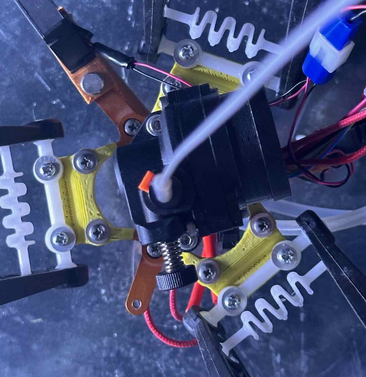

I switched out my long bowden tube for a direct drive extruder on my Rostock Max v2 with 713maker effector. In the process I raised the extruder 25mm and rotated it 20º to help it clear the arms, and then when it still hit an arm at an extreme point within the build envelope I printed 13mm extensions for each of the arm attachment points to effectively enlarge the effector plate.
In case anyone has a similar setup and wants the STL files or a link to the Onshape project to alter, it's all here:
Thingiverse link: raised Orbiter 2 mount and effector extension for 713maker Rostock effector plate
These may not be the world's prettiest or most-advisable mods (they were printed with the prior miscalibrated extruder and I melted the mount a little much when getting a heat-set insert into place), but the setup in these photos has now been functional and very sturdy for several weeks of printing.
