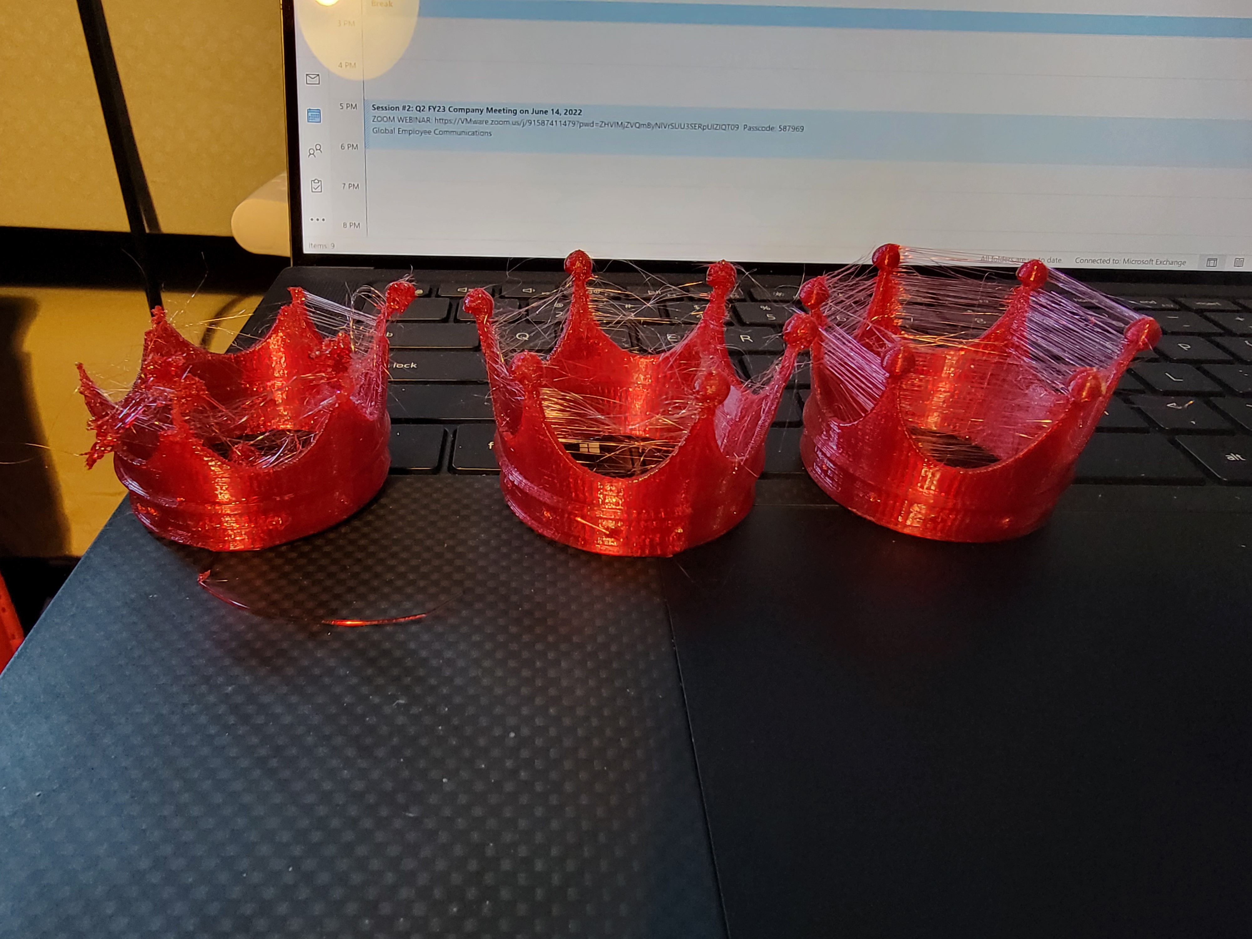

I decided to pull apart the hot end. I found that the new filament got stuck in the cold end where a random section of the old filament did not. I got everything put back together and decided to change the filament again. I assume the new SIlk Gold PLA+ from Dikale (Amazon) doesn't retain the tolerances my machine needs. I have a new role coming from a company with significantly more reviews (Overture).
In the meantime, I am running some red T-glase. This stuff has got to be seven years old. I had bed adhesion problems, but the tape and glue stick combo seemed to work. I usually do one or the other, never both. My slicing speed is 60mm/sec, with the outer layer at 30 and the first layer at 20. I then slowed the machine down to 25%. The nozzle is at 242C (the site says 245-252). I got a great start. Over the 45-minute print, I increased the speed to 50%. The print came out okay—lots of strings.
On the next print, I increased the retraction from 3.5 to 5 and reran it beginning at 50% speed and working up to 100%, and things came out a little better.
On the next print, I bumped up the retraction to 10 and dropped the nozzle to 240. the tiny bits failed, and the strings did not seem to be any less. I did get barking again from the very first layer. I dropped the speed down to 50% until layer 5, when I put it back to 100%. The remainder of the print was unsupervised.
When I set this machine up, I did several bed and nozzle calibrations to get them dialed in, but I see a 2.5-degree deviation from my set point, especially to the cold side. What is the standard method for verifying nozzle temp?
The photo below are the prints. The last print is on the left, and older prints are to the right.

If my memory is correct, T-Glase is going to suck up water, so you should really dry it out (google "filament dryer" - you can make them out of food dehydrators) and it won't print well until you do.
The skipping on the first layer is because your nozzle is too close to the bed and the filament can't flow well enough to prevent a lot of backpressure from building up. This will also cause "elephant's foot" in your prints.

1. Each roll of filament is going to have its own "sweet spot" for printing. Try bumping the temp up 5c and see how it prints.
2. I tried it out on a 7 year old spool and it worked great.
3. No idea.
4. Ahhh, I didn't know you were printing from Cura over USB. I thought it only did that with UltiMaker printers.

This is very strange. I had to do some digging to refresh my memory on how the E3D v6 was put together. I couldn't recall whether or not it has a PTFE liner or not. (according to the doc sheet I found it doesn't)
The repeatable timing on the skipping is just *screaming* "heat creep" at me - you're absolutely positive the fan on the heatsink is running and blowing air AT the heatsink?
I missed this in a previous question - you can check your hot end temp by bringing the hot end up to temp and inserting a thermocouple probe down into it until the tip touches the inside of the nozzle. Before you do that, you'll want to do a cold pull to make sure the hot end is free of filament - heat up the hot end, extrude a bit by hand and then turn it off. When it hits 160c, swiftly pull the filament out of the hot end. If it worked properly, you should be able to see a dot of light when looking down through the hot end and with a small light aimed at the nozzle opening from the outside.

I'm running retracts at 25mm/sec and the retract length is 6.5mm. I'm printing at 60mm/sec with an infill speed of 100mm/sec. This is for my BOSSDelta 300 though. (it uses an SE300 hot end, so basically anything that uses the SE300 can use those speeds)
I'm wondering if your retract speed and length is the root cause of your issue... What retract length are you using?

At the begining of this my retraction speed was set at the default,3.2 mm at 45 mm/sec.geneb wrote: ↑Tue Jul 19, 2022 9:44 am I'm running retracts at 25mm/sec and the retract length is 6.5mm. I'm printing at 60mm/sec with an infill speed of 100mm/sec. This is for my BOSSDelta 300 though. (it uses an SE300 hot end, so basically anything that uses the SE300 can use those speeds)
In playing with the settings, i felt that this was not enough distance. I had not found the sweet spot, but felt that 5mm was not quite enough and 7.5 - 10 had about the same results, so i had left it at 7.5 mm.
As for the speed, because i was printing at 30 mm/sec, i reduced the traction speed to 30 mm/sec and it seemed to help.
I have changed to your settings: 6 mm @ 25 mm/s and will print another crown.
