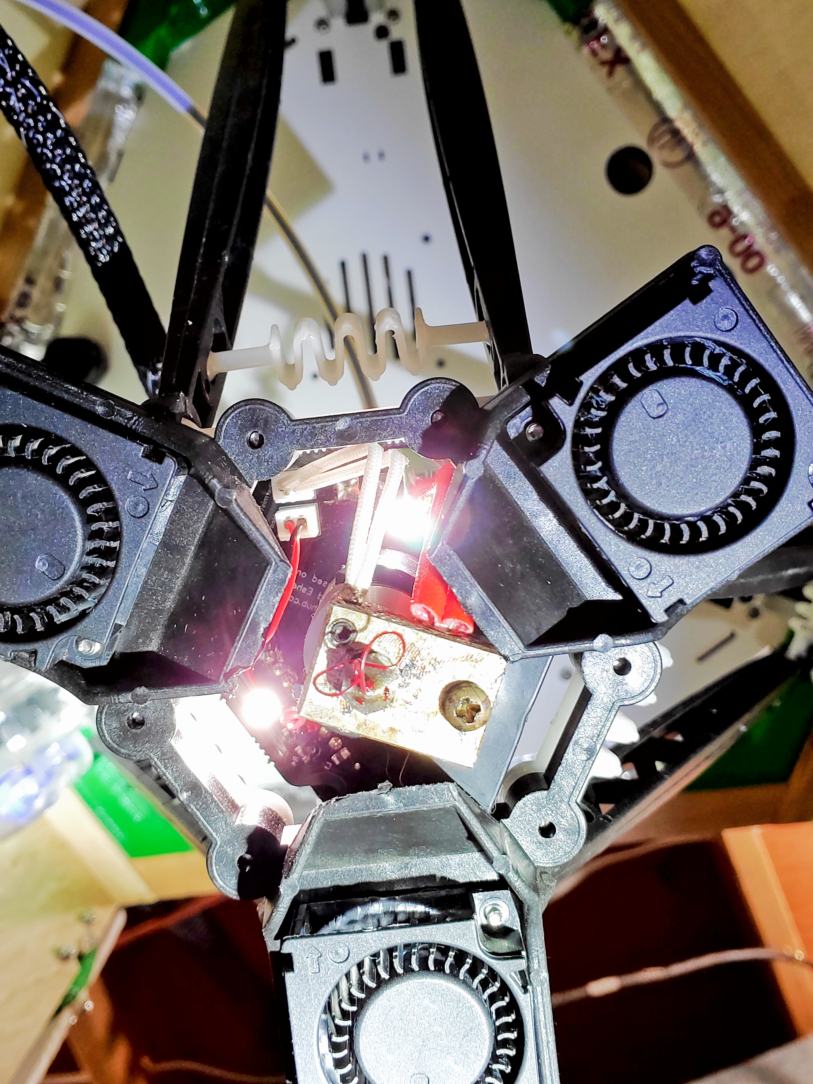

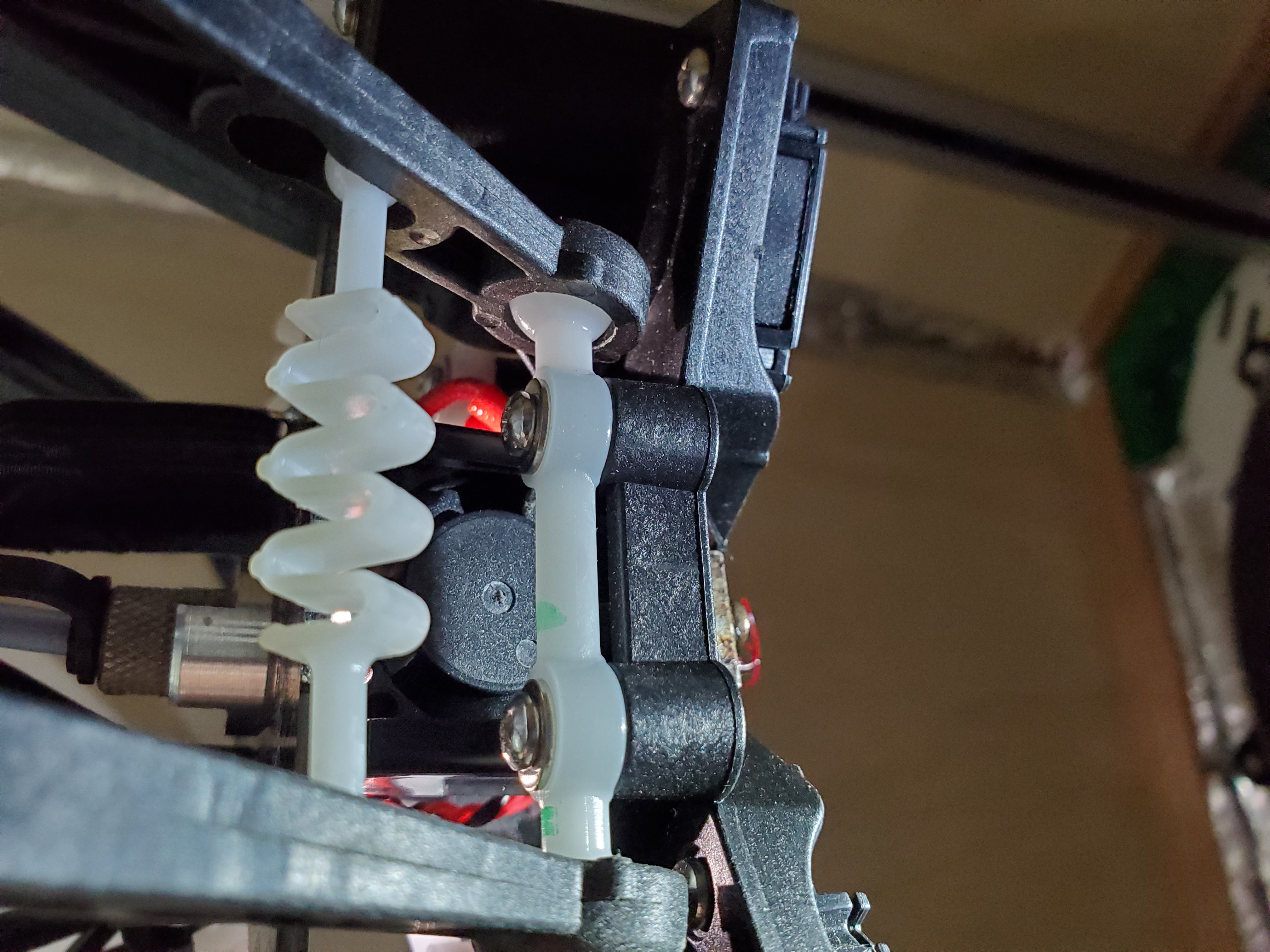

When you put it back together, did you make sure the heat sink fan is blowing through the fins of the heat sink? Can you post pics of the hot end assembly?

Not the best pics..
- 20210325_175206_01[1].jpg (2.73 MiB) Viewed 27921 times
- 20210325_175332[1].jpg (3.09 MiB) Viewed 27921 times
Re: V3.2 problem
So the only thing I can think of at this point is the nozzle face isn't meeting the face of the heat break as it should. The heat break and the nozzle face should meet in the center of the heat block.
The clogged heat break is confusing because that only happens if the "cold section" isn't being properly cooled. The fan should automatically come on when the hot end hits 50C and should be blowing through the heat sink.
