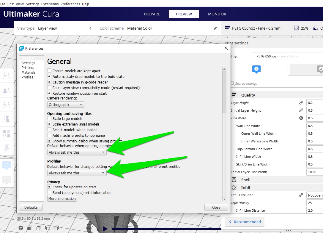

Cura 4.8 won't work. It won't likely be fixed until the next release. We don't make software, we only advise customers to use what is proven to work, tested, and solid.
Take another look at your email from SeeMeCNC technical support Saturday at 4:20pm.
no YAT, no USB connecting. We do not run our printers through Cura. Cura only is used to generate Gcode and upload to the printer or run over an SD card inserted in the touchscreen.
We stopped recommending any USB connection in 2016/2017. Only this information:
https://www.seemecnc.com/pages/seemecnc ... tart-guide
Cura 4.6.2 is solid. In our guide (link below), STEP 5 has show you how to open the 3MF project file. This sets Cura 4.6.2 completely up in one step. The 3MF file would be downloaded in STEP 2 of our guide.
From the above Quick Start page of our website, you will end up at this Cura 4.6.2 setup guide. We are not supporting any other version (because they have defects and Cura 4.6.2 works perfect)
https://seemecnc.dozuki.com/Guide/Clean ... 41?lang=en
In Cura 4.6.2
  • go to Preferences.
  • On the "General" screen scroll to the bottom.
  • (see picture below) select "Always ask me this"
  • then close the window and try "File > Open Files.." in the menu bar again
  • Choose "Open As Project"
Cura-preference-settings-open-3MF-project-files
~PartDaddy

PartDaddy wrote: ↑Tue Jan 26, 2021 11:43 am Cura 4.8 won't work. It won't likely be fixed until the next release. We don't make software, we only advise customers to use what is proven to work, tested, and solid.
I just always keep my software up to date, is why I'm on 4.8 now - what differs in the newer versions that makes them unsuitable?
This is strange, not only because YAT was literally the ONLY way I could get the M587 command into the machine to get it on wifi, but also because the YAT method is exactly what was recommended/needed to set up my RMax on network as well, in 2019. So I'm not sure what to think or do here. Oh and I'm not trying to "run the printer through Cura" I just use it to make gcode of my models, as you said. I did include that detail when I responded to that support email, too.
I did finally find the blinky batarang 3MF file, which I *was* able to open and get the profile into Cura with. If Cura will let me downgrade or double load 4.6.2 alongside then I can definitely try it, but I'll have to see.
I just don't understand the bizarrely different setups between using the Rmax vs the Artemis, as beyond the second extruder everything should function exactly the same.
