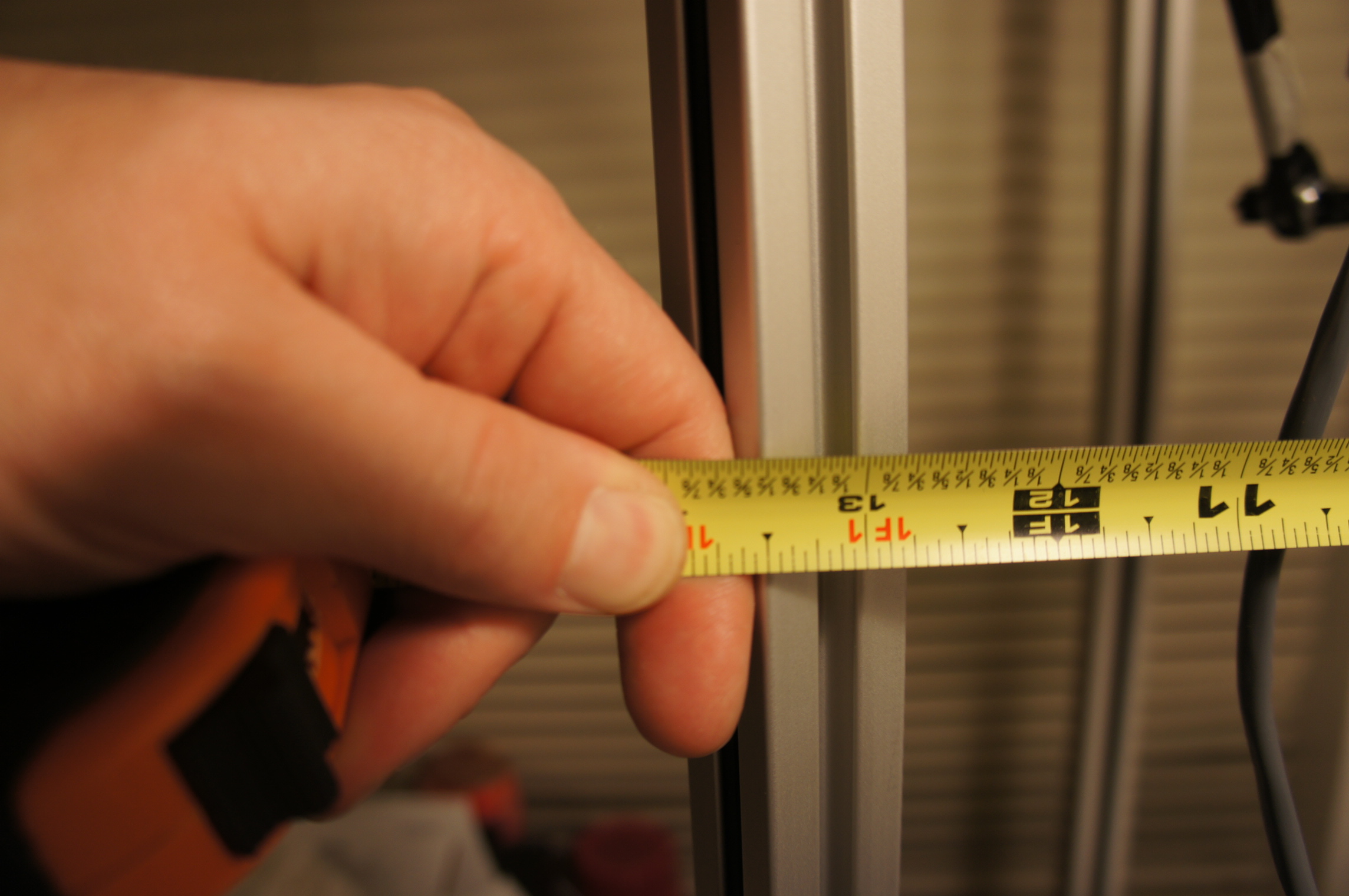

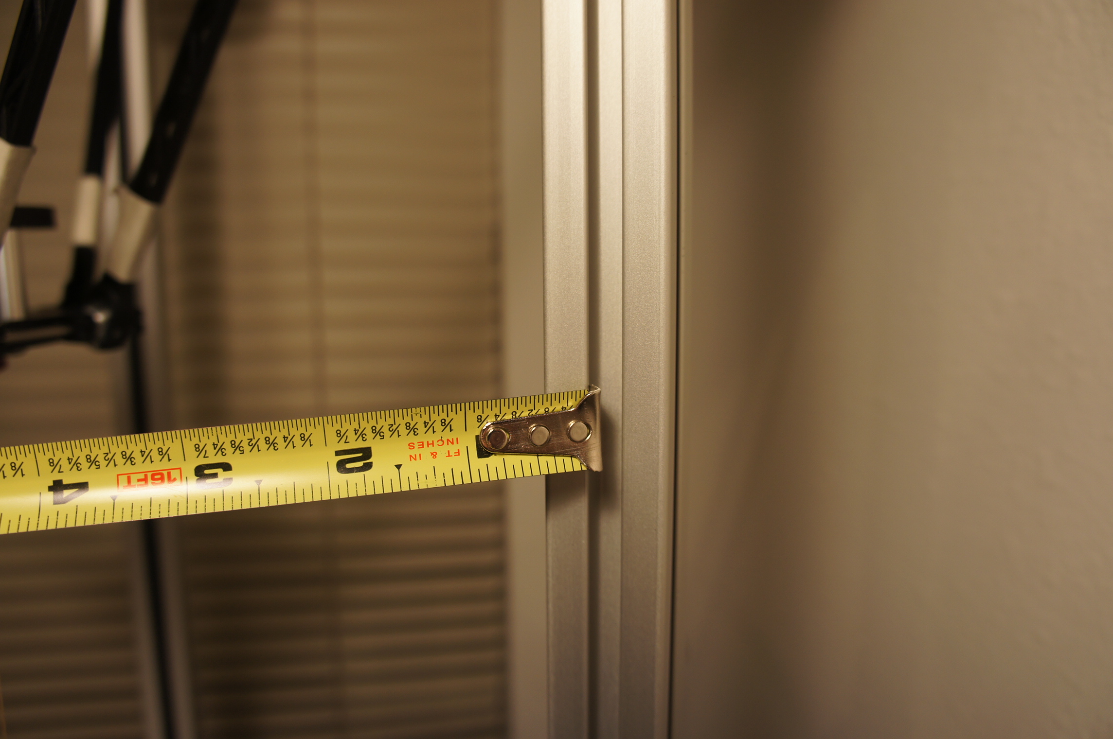

The distances from the X tower to the Y tower, Y to Z, Z to X. You need to get all of those as close to the same as possible.
No matter what I tried. Just getting the rails flush with the cut outs wasn't good enough, at least with the parts I got. It was off about 0.080. For mine it took filling down one cut out on the base, and slotting the holes to pull a rail further out on another to get the distances all the same. A lot of work, but worth it if your trying to make precision parts.

Re: Square/scale
Considering that the distances between the rails are fairly large and the tolerances are very small what in your opinion is the best way to measure these? I'm getting closer to starting my build and need your type of input. I'm really not sureAv8r RC wrote:The distances from the X tower to the Y tower, Y to Z, Z to X. You need to get all of those as close to the same as possible.

what I could use to measure within thousands of an inch over a large span. Any help would be appreciated.

Re: Square/scale
I used a tape measure. I hooked the hook in the slot and spanned it over to the adjacent rail. I used the beginning of the radius on the corner as a reference point. You could make a mark on the tape measure and compare it to the others. I work in 0.001's everyday at work so I have an eye for small distances like this.
EDIT: You also want to measure at the top and bottom. Double and triple check it.

Re: Square/scale
Thanks for the pictures, it helps to see how you did it instead of just reading it.
