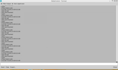

Hello again!
I'm trying to do the initial function tests, and the Gcode terminal keeps saying that there's an error, something to do with "SD init fail"?
I'm not sure if this is something I can ignore and move on, or if I need to figure out how to fix this before I continue. I took a screenshot of the terminal if that would help.
If anyone can help me out, that would be great!
Re: Problems uploading to board
It may say that if there's no SD card installed or the one installed is bad.
It doesn't affect the printer itself.

Hmm... Is an SD card necessary/should there be one?
It's not required for the printer to operate,

So... I checked, and there isn't an SD card inserted anywhere in the computer. I cleaned out the slot for the SD card since it was really dusty because I thought that might be what's causing the issue.
I went into Matter Control again to open up the Gcode terminal and again it came up with the "SD init fail" error.
Should I just ignore this and move on?
Posts: 1561
Post by Xenocrates »
The SD card in question lives on the printer. Stop worrying about it, because you're not using it to print from currently.
