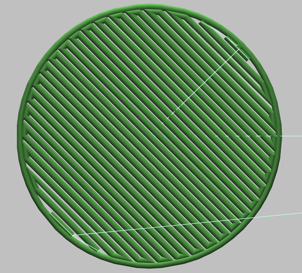

I know the segment length is not adjustable in Slic3r and does not appear to be in KISSlicer. I've now created 2 very simple objects:
1) a 2cm square .2mm high
2) a 2cm diameter circle .2mm high
I configured both slicers as similarly as I could and created the gcode. For these very simple objects there is very little difference in file size or # of segments for the perimeters (on the circle). However, it doesn't appear that KISS allows you to specify the orientation of the fill layer? I'm using the latest beta 1.1.0. Also, the Slic3r version of the circle has horrible infilling at opposite sides as you can see here:
required 48.0 mm of filament
