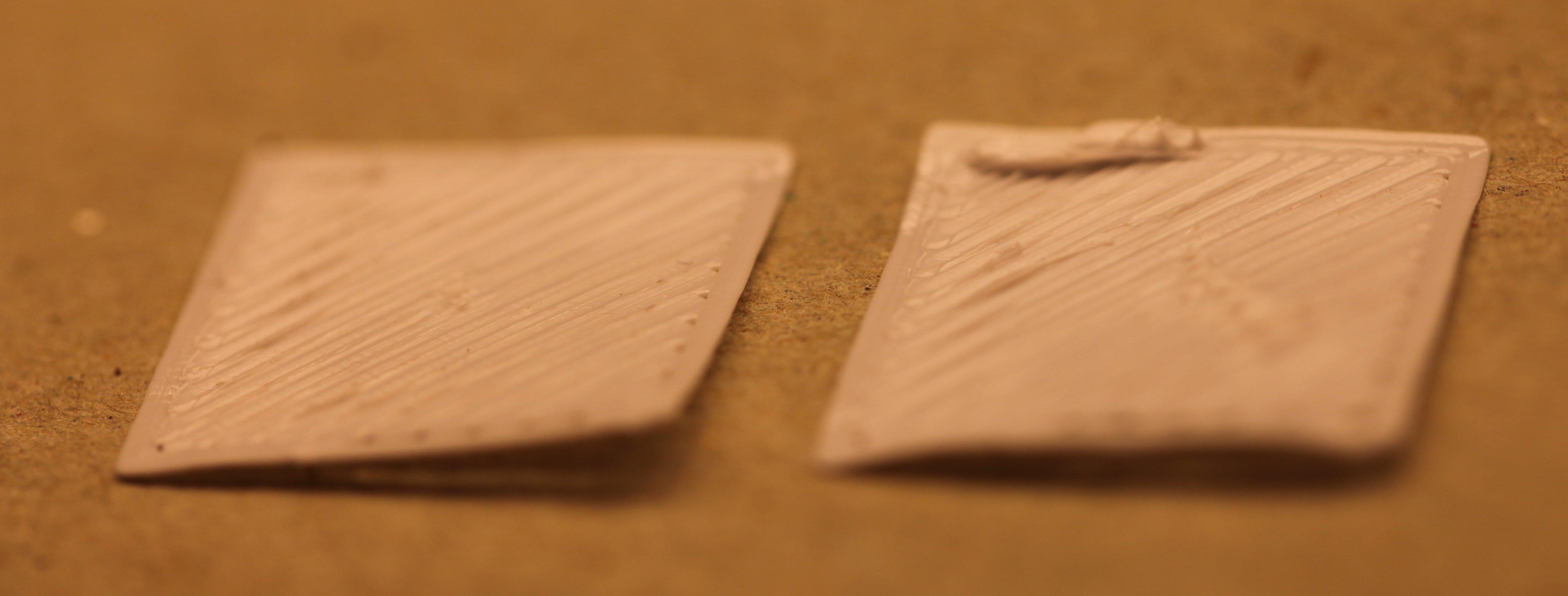

I'm getting a big blob at the end of each layer caused by the G92 E0 command and I'm confused.
I've attached a .gcode file for a 20mm flat plate and I get a blob.
If I comment out the G92 E0 at the end, I do not get the blob.
Can someone help me understand this?

OK, I found out it's the G92 E0 combined with a G28 X0 that causes the extrusion.
Could you try this?
Set your extruder temp to whatever filament you have and wait for it to heat up.
g0 x0 y0 z50 ; Move near the bed.
g1 x100 e10 f1000 ; Move to the right and extrude some filament
g92 e0 ; Set Extruder current position to zero
g28 x0 ; Home the "x" axis
I see a slow move towards X==0 with the extruder running!
If I remove the g92 e0 from the above test, I see a slow move towards X==0 without the extruder running

Yes, this is the default end G code for the Slic3r slicer.
I changed it to a G28 Z0 and the problem went away.

Cool. Just a G28 does not exhibit the problem.
I'll debug the Arduino code and see if I can push a fix to GitHub.

G28 X0 under certain circumstances causes the extruder to run and pump filament out the nozzle.
It should not run the extruder.

OK, I've got a one-line fix to Printer.cpp so there will be no extruder operation on homing.
G28 X0 first moves to X=0 and then homes in Z
G28 Y0 first moves to Y=0 and then homes in Z
G28 Z0 (or G28) moves directly vertical as it homes in Z
None of these extrude filament now.
