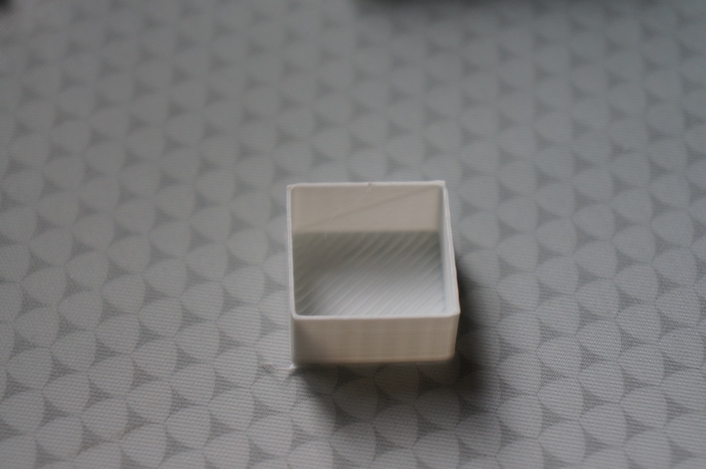

To my mind there is only one model and 2 print settings you care about to calibrate extrusion, I use the 20x20x10 test cube, though any cube or cylinder would do.
I'm using Slic3r in the following but I'd do the same with KisSlicer or Cura.
Generally I set my extrusion width explicitly, in particularly I don't like Slic3r's automatic extrusion width calibration. I set all of the widths in Slic3r to the same value 0.55 for my 0.5mm nozzle, general rule of thumb being nozzle diameter +10%.
I want settings that minimize other effects on the feed rate so
  • I disable retraction
  • I set all of the speeds to the same relatively low value of 20mm/s
  • I disable any slowdown for cooling (I run a fan always on)

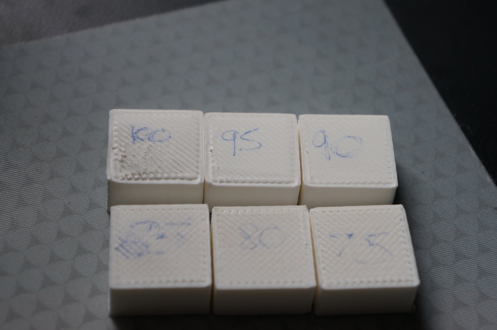

I set the extrusion multiplier to 1.0, set the settings to print 1 wall 0% infill and I print a bottom layer
I measure the wall thickness in several places with digital calipers, this take a bit of messing around, Ideally you to want to measure it for one layer in one spot to remove any inflation you get from waves in the wall, measure several times throw out unusually high or low values and average the rest, in this case it was 0.65mm much larger than the requested 0.55mm.
At this point I'd normally take 0.55/0.65 = 0.85 and just use it as the extrusion multiplier, print another hollow cube, verify then print a solid cube, but I want to show you how extrusion affects print quality.

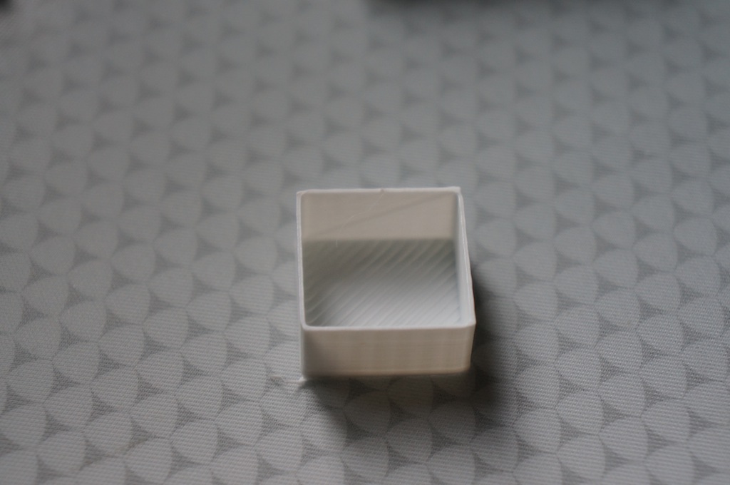

The final litmus test IMO for extrusion is being able to print a tidy 100% fill test object.

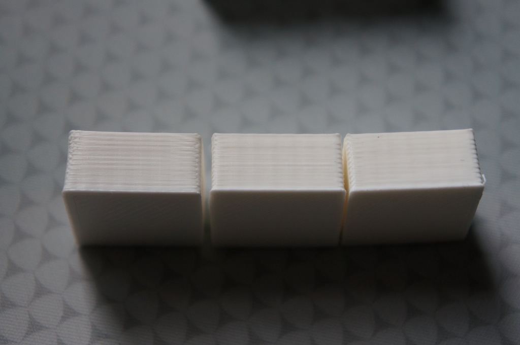

I use the same settings as above but I set perimeters to 2 and infill to 100% for the test cube, to illustrate in the following picture, I printed from 1.0 to 0.75 extrusion multipliers in 0.05 steps.
The excess material is obvious on the 100% example and can be see decreasing through the 90% one, the 85% one looks good and if you look closely you can start to see small gaps in the infill and between the perimeters in the 80% and 75% cubes. So apparently my rough calculation above was good.
I would note here that the gap between the left/right edges and the infill is less that the gap between the top/bottom edges and the infill, I apparently have a small mechanical issue, probably one of my ujoints has too much friction, or a belt isn't tight.
What's not obvious is the general effect it has on other aspects of quality here is the profile of the 100 85 and 75% cubes.
Note the unevenness and generally poor layer alignment of the 100% cube, it's worse in Slic3r than most other slicers because Slic3r only prints perimeters inside to out, pretty much guaranteeing that the outside perimeter is displaced by extra material in the inside perimeter.
The 75% one is cleaner than that "correct" 85% one, because the perimeters don't touch so it's like printing a single wall object, with a slicer printing perimeters outside to in or with only a single perimeter there would probably be no visible difference between them.
Note You can't just take my 0.85 value and use it, you need to measure and print a couple of test objects, the 0.85 is correct for the PLA filament I happen to be using right now on my machine using the version of Slic3r I happen to be using, if I were printing ABS, that 0.85 would likely be higher because the pinch rollers compress it more.

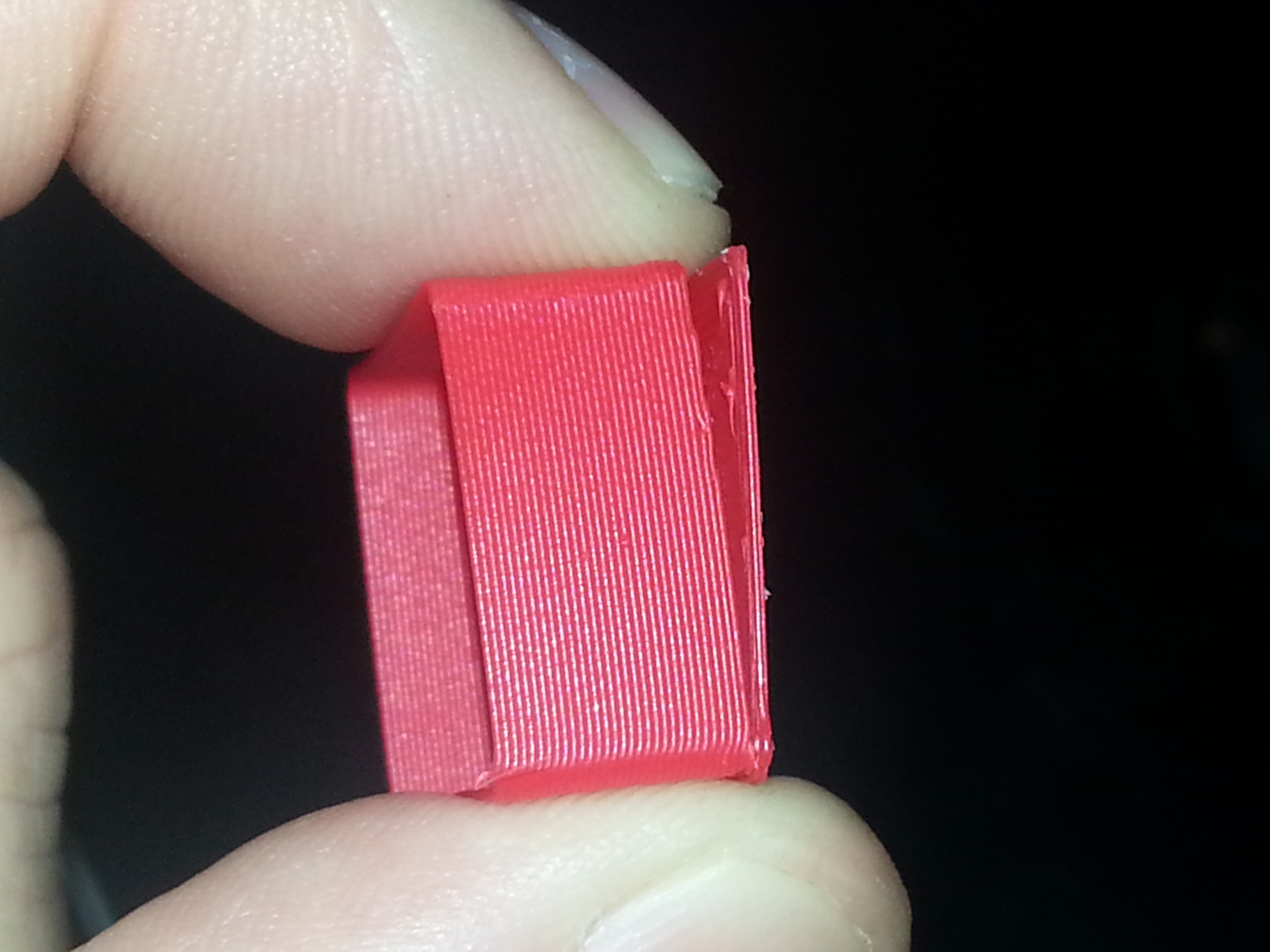

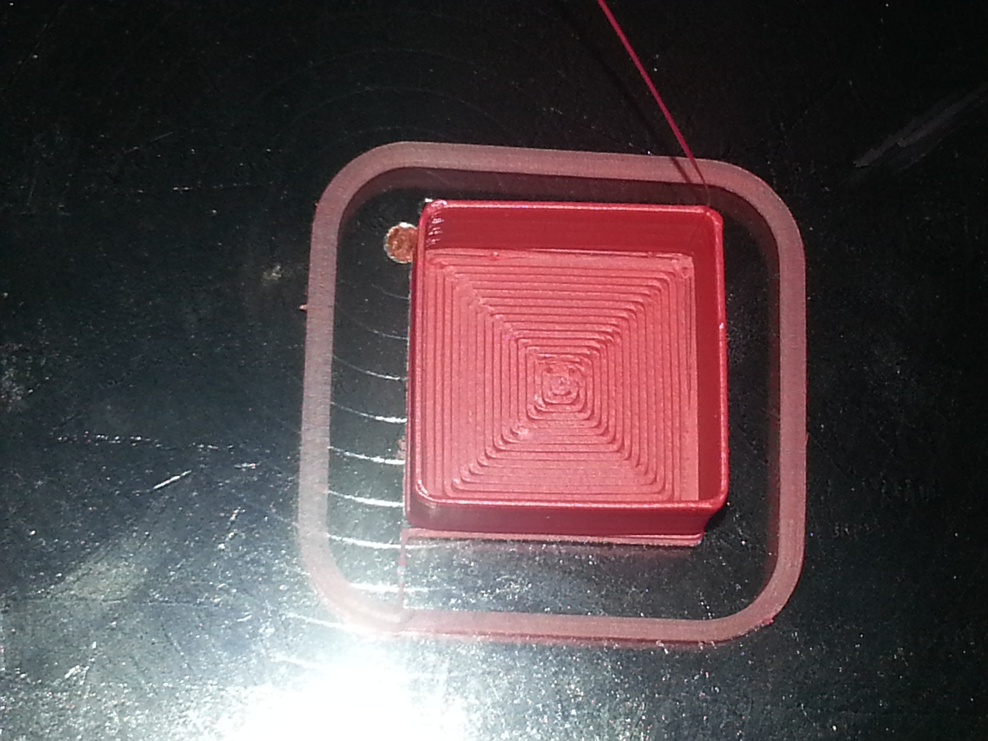

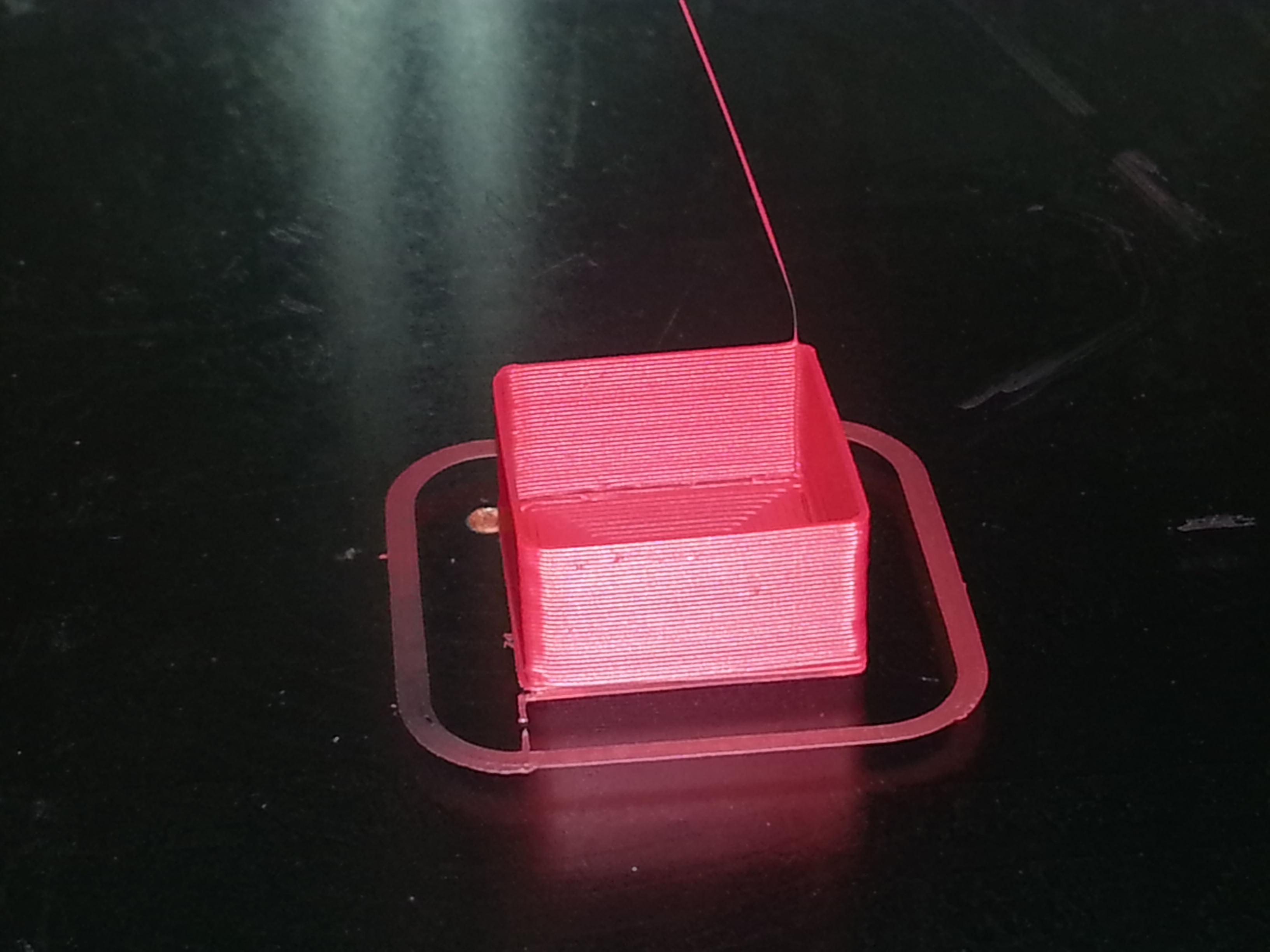

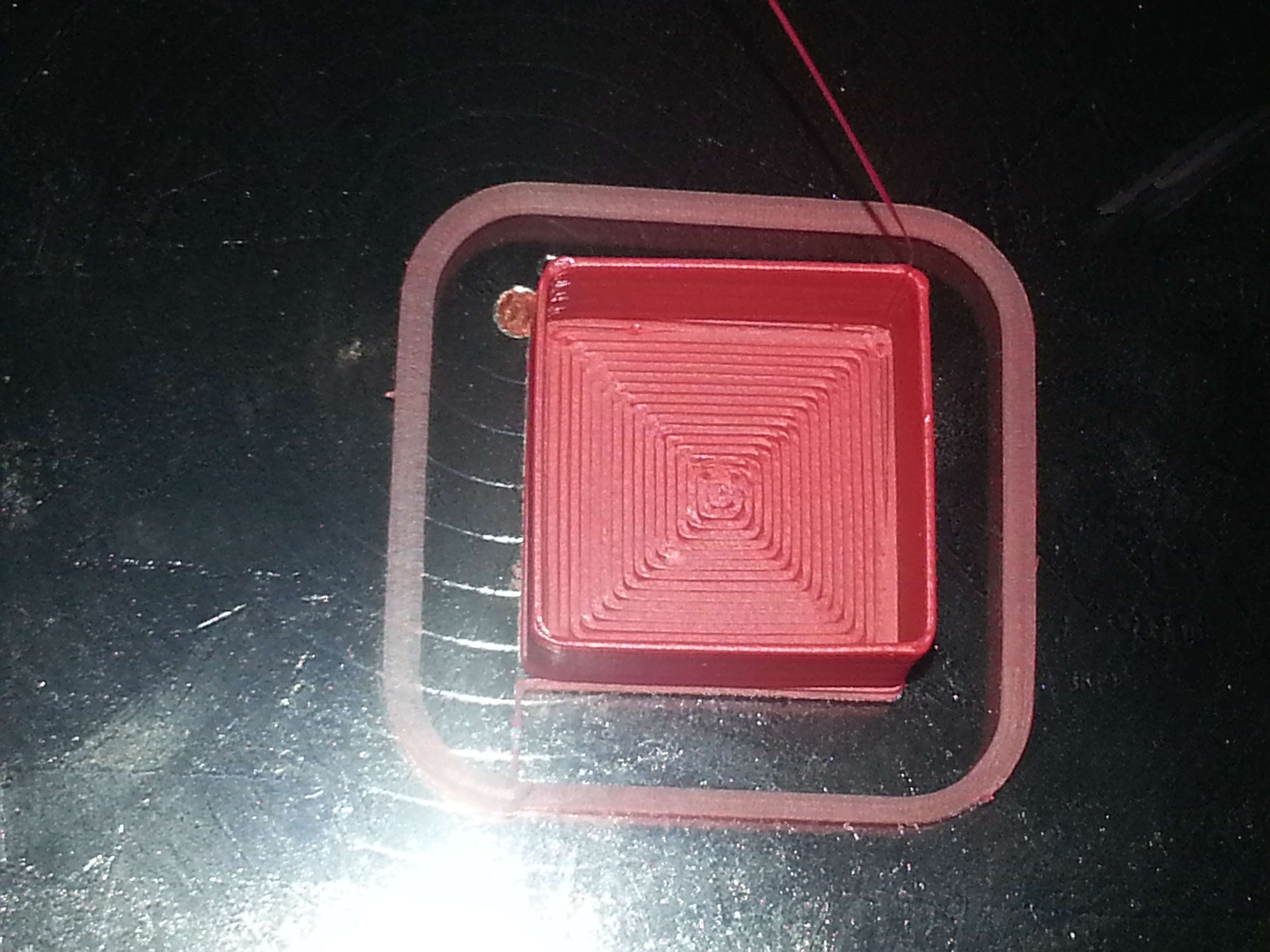

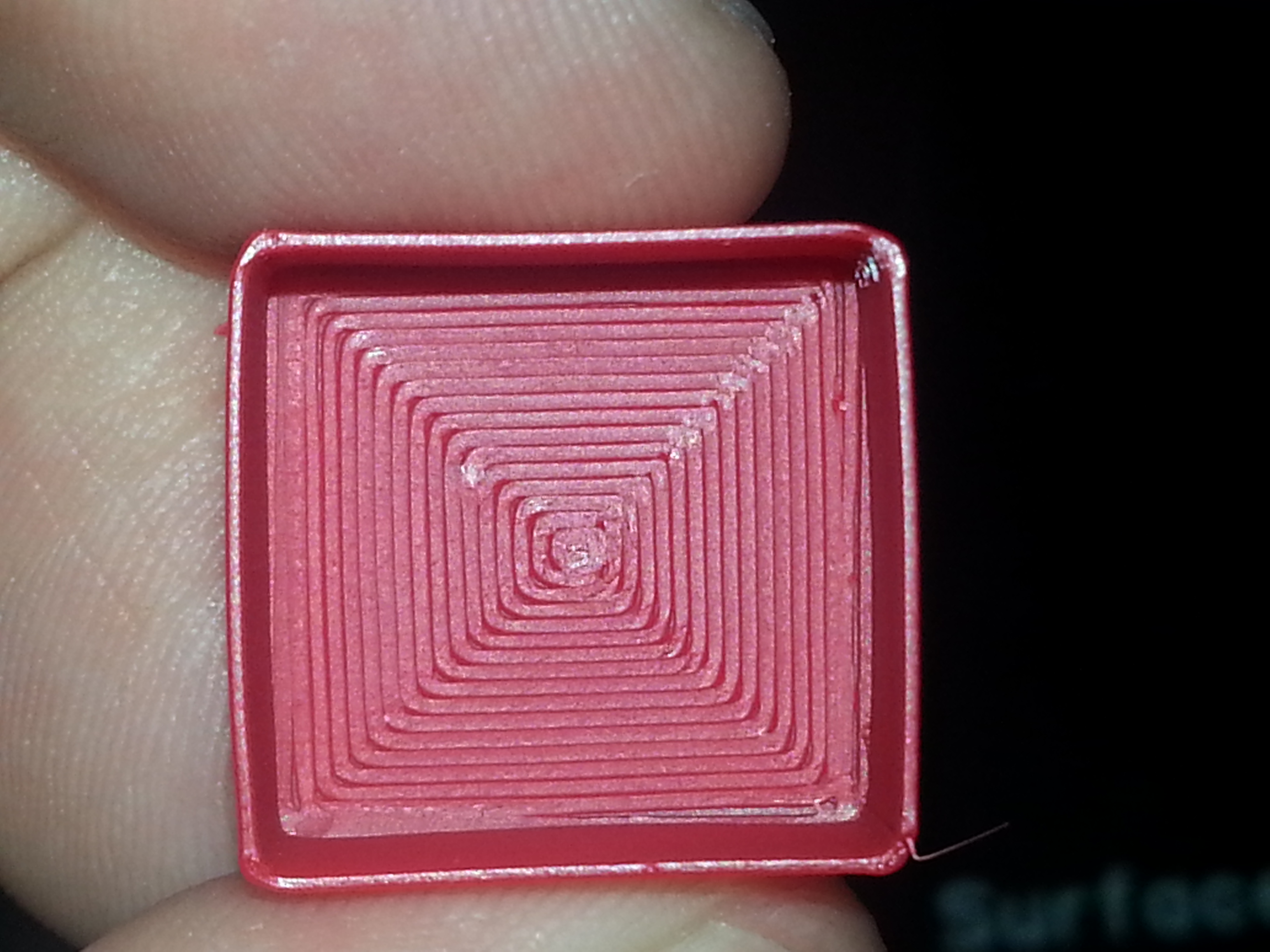

Okay, so I tweaked my settings as indicated and printed a cube, (see pics). It should be 20mm x 20mm x 10mm with .55mm walls. Actual is 19.05mm x 19.3mm x 9.7mm with .51mm walls.
I'm curious about a few things. For every print I've done, it has circled the part at least 1 lap and usually a lap and a half or more before it finally starts actually putting down plastic for the boundary.
Also, despite setting what I though was going to print 1 layer for the floor, it still printed two layers. It did 1 only for the walls, as expected.

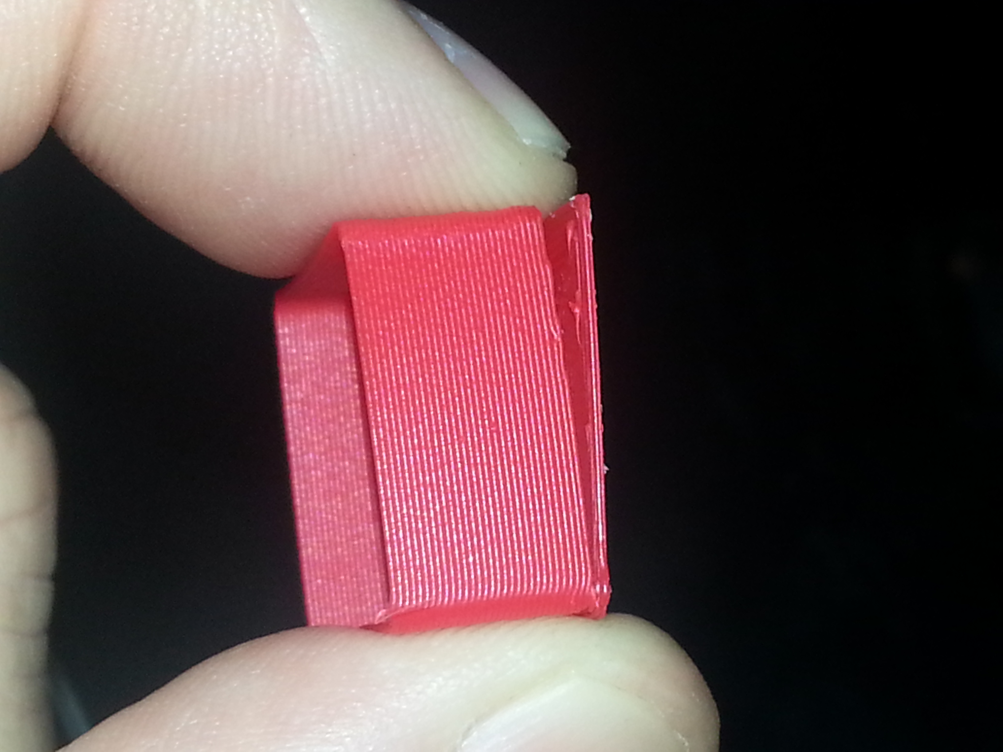

One more thing. It didn't actually fuse the walls with the bottom layer in a few spots.
Thoughts? Input?

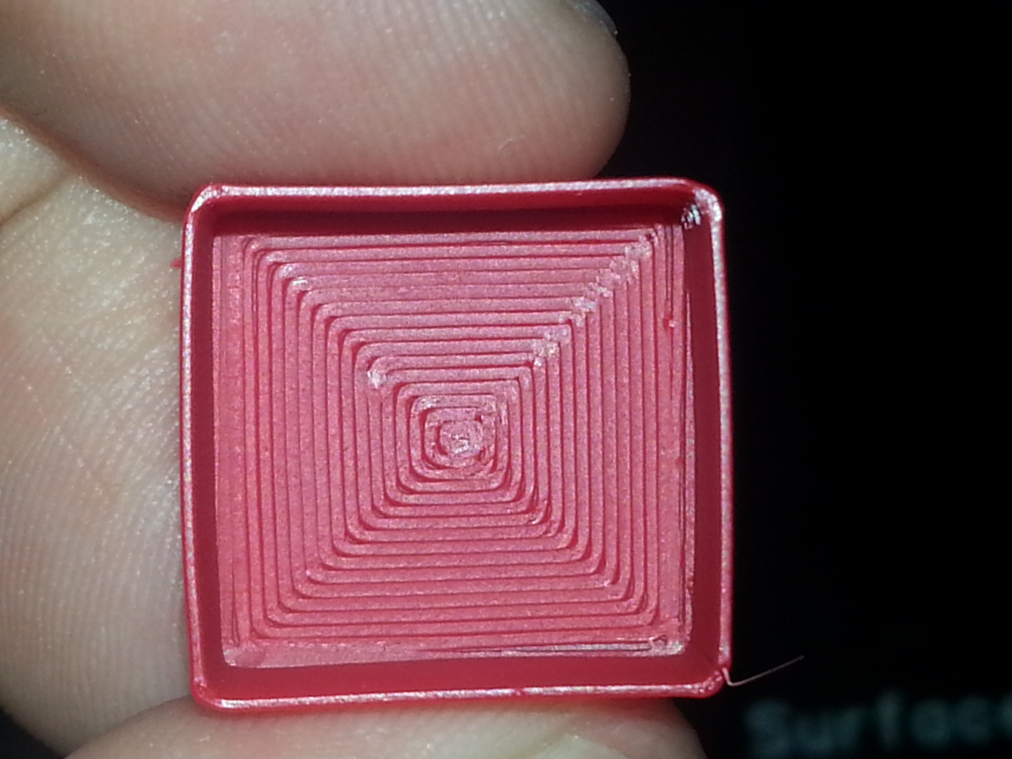

harley573
Posts: 72
Joined: Mon Feb 25, 2013 10:53 pm
Re: Extruder Calibration
Post by harley573 »
Additional photos:
Posts: 2417
Location: Redmond WA
Post by Polygonhell »
Layer alignment looks good, IME printers tend to print slightly undersized.
You can adjust the X/Y size by changing the delta arm length in the firmware, I increased it slightly I think. Z ought to be spot on because it's direct translation of the belt motion.
The detaching could just be not printing quite hot enough, ABS in particular will delaminate if you print it 5 or 10 degrees too cold.
