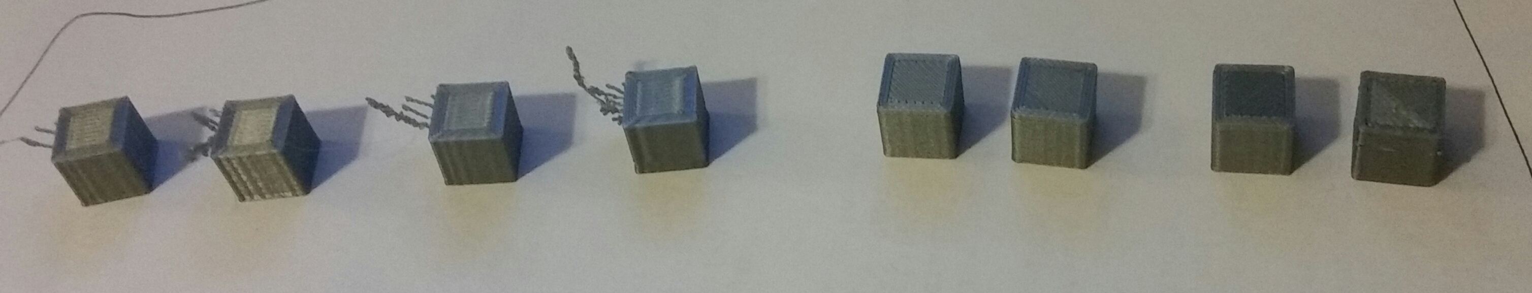

Bad picture, but the "coast" feature COMPLETELY eliminated stringing.
These were printed with virtually the same settings, but the cubes on left sliced and printed with Mattercontrol, cubes on right sliced, Coasting enabled, with Cura and printed with MC.
