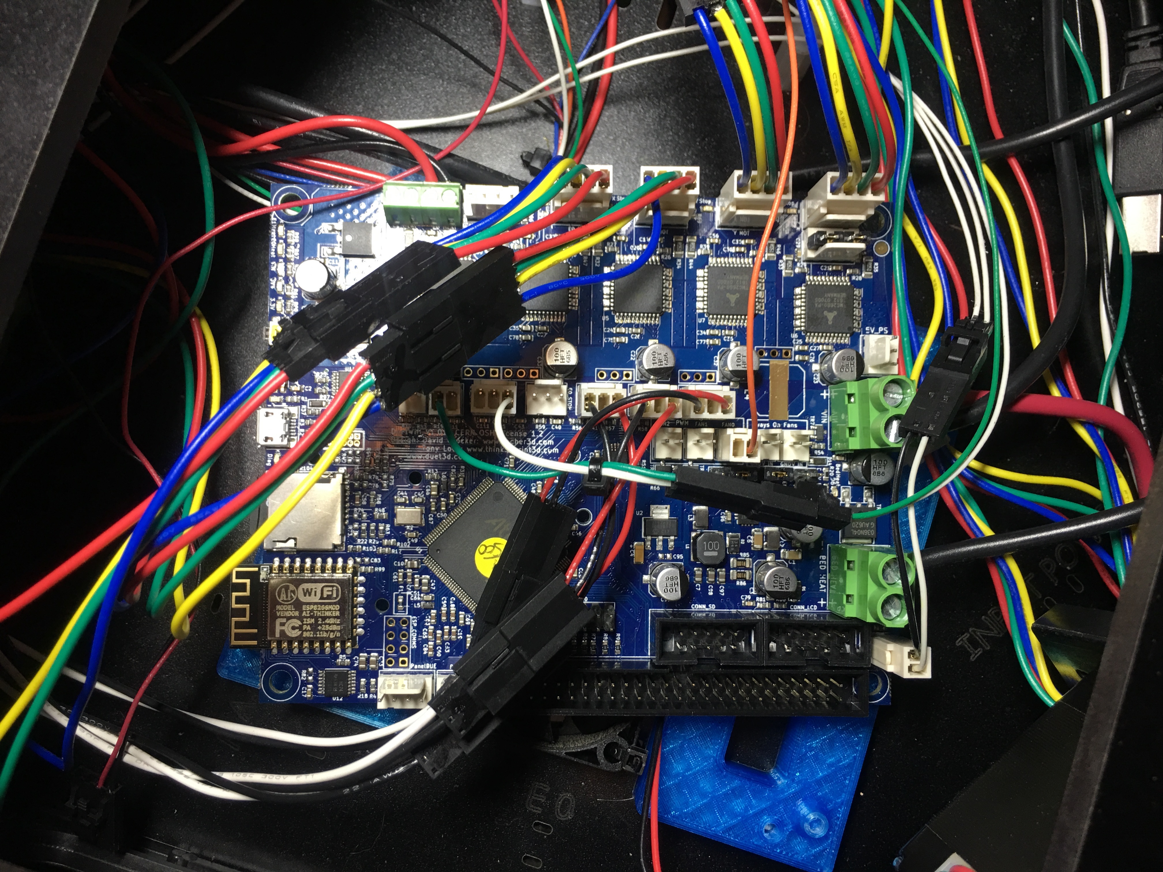

Okay. Conversion done, love the endstop lights on the stepper drives makes it really easy to double check.
Have a problem.
How do I get this thing calibrated? I hit "home all" it goes up and homes. then I hit "Auto Delta Calibration" and it crashes the print head into the build plate.
what am I doing wrong and how do I fix it?
Thanks for helping.
Have a problem.
Thanks for helping.

What are you using as a probe and how do you have it hooked up and configured!
Re: RostockMAX V3 to Duet WiFi conversion instructions
mhackney wrote:What are you using as a probe and how do you have it hooked up and configured!
Adafruit 3.3v Trinket and in the Z-Probe 4 pin port straight out of your instructions

Okay so converted from the Z-porbe input to E0 endstop. I get the red endstop led and now when it crashes into the bed I see the LED blink for both the end stop and the Trinket. The web interface reports back "End stop already triggered" or something like that. Also in the right side it shows 1000 for the end stop sensor.
What is wrong?
What is wrong?

If the LED on the trinket lights, it is seeing a probe hit. That is confirmed with the LED on the Duet when connected to the E0 endstop. So you have things wired correctly. Could still be a config.g issue. You should have:
M558 P4 X0 Y0 Z1 H5 F1200 T2400
In your config file.
What is your bed surface, this greatly affects the probing.
Start with the above M558 and if you still have trigger issues, increase the F value by 300 and test in steps. I probe on PEI and 1200 works for me. The original SeeMeCNC value is around 54000 mm/min. If I go that high, it probes fine but the variability between probe runs is all over the map.
Accelerometer probe configuration is more of a balancing act than other probes. They are highly dependent on bed surface, bed rigidity, probe speed and other factors. I've spent a lot of time testing and profiling this week including some novel suggestions David Crocker mentioned like temporarily increasing the microstepping to increase resolution, adjusting the new probe recovery time (R in M558), etc. Lots of things tested, nothing provides the consistent results I'm looking for. I am now talking to an application engineer at the company that makes the accelerometer. He made some suggestions I'm working on today. Oh, and yesterday I enabled triggering on X and Y acceleration events too and that seemed to make the biggest difference in terms of precision from run to run. I am getting very consistent deviation of 0.08 +/- 0.003 now. But it's that 0.08 I know is too high based on other calibration results.

Glass bed. This all was working with the Rambo and when I did the conversion it's not
M558 was present already in my config. I'm getting the following error.
M112
M999
Error: Z probe already triggered at start of probing move
How do I fix that?
Increase the sensitivity in the source file and recompile and flash.
mhackney wrote:Increase the sensitivity in the source file and recompile and flash.
How much should I increase it by? it's at 20 if I'm reading the source file correctly
Increase by 10.
Also, then increase the F. Have you changed the F yet.
Oh, and you absolutely must not be heating the hot end, that WILL give false triggers. It's ok to be hot, but turn off the heater before probing.
okay I can bring the head down to the print bed and see that its triggering when I tap the print head to the glass by hand both the end stop led and the trinket led flash
The problem seems to be that the probe is already triggered and it's not reading the trigger state. I get this error
whats that about?
whats that about?
That means that something is triggering the probe. Vibration, too sensitive or something else.
