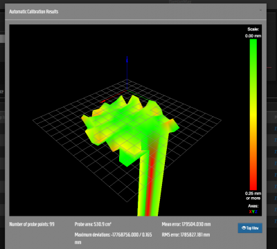

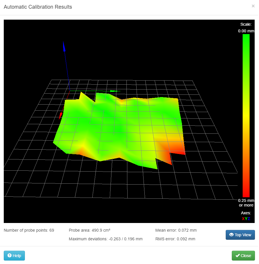

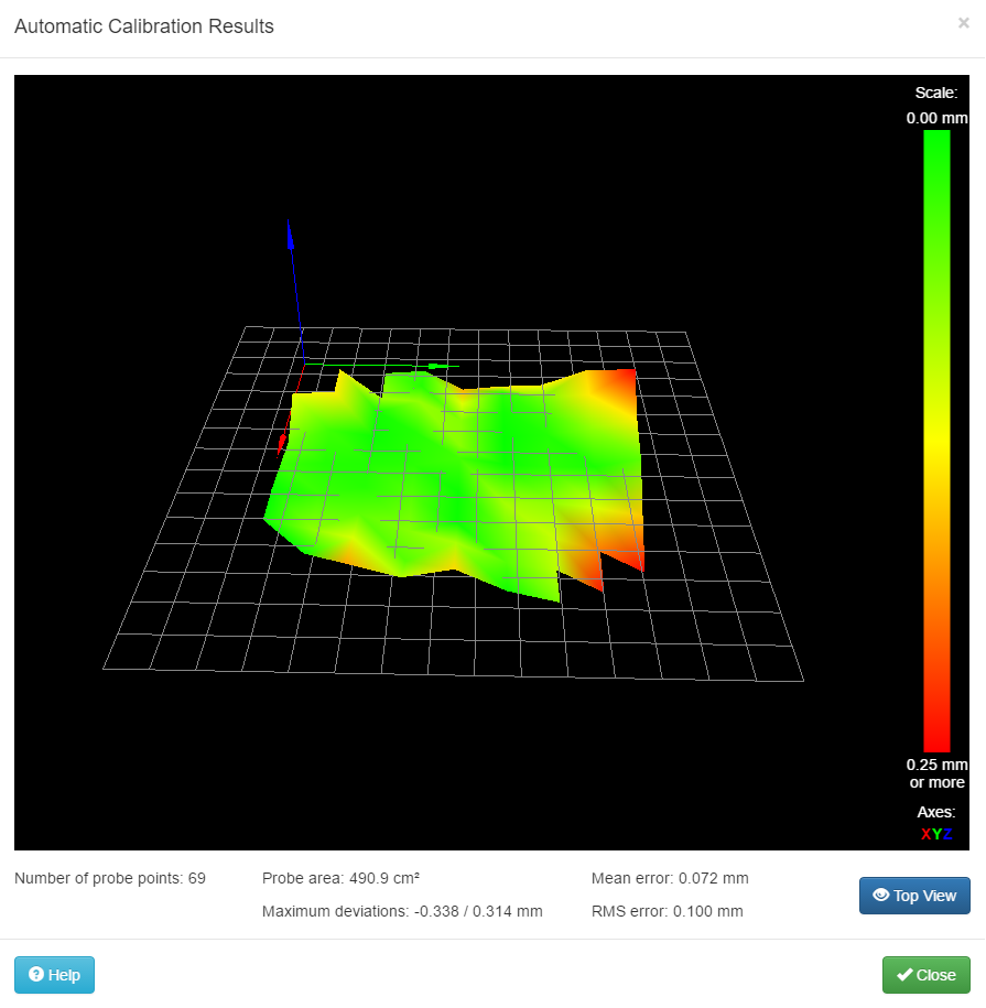

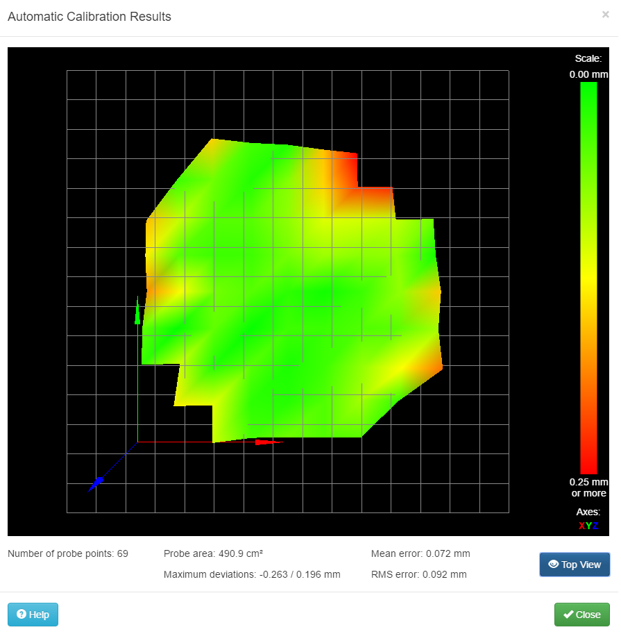

For those of you using the new G29 grid bed compensation feature, Duet Web Control now gives you a visual representation of the height map. Thanks to Chrishamm for his hard work on this. Here is an example which shows quite clearly the Y axis twist on my Ormerod.

gestalt73
Posts: 339
Joined: Wed Aug 07, 2013 11:10 am
Location: Anaheim, CA
Re: Please help us test RRF 1.17 and DWC 1.14 release candidates
Post by gestalt73 »
Oooh, Fun!

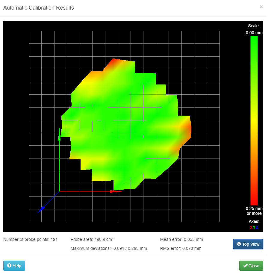

But it looks like I have some frame issues that I didn't even know about. :-/
(EDIT: Thanks to this height map, I dug deeper and discovered that I didn't update the effector plate with 50mm spacing for the magball arms. I just finished installing the upgrades to kosselorange. The carriages were updated to 50mm, and the effector platform was still 48. I knew my frame wasn't that far off. Doh!)
http://i.imgur.com/WYn7xE8.png
[img]http://i.imgur.com/WYn7xE8l.png[/img]

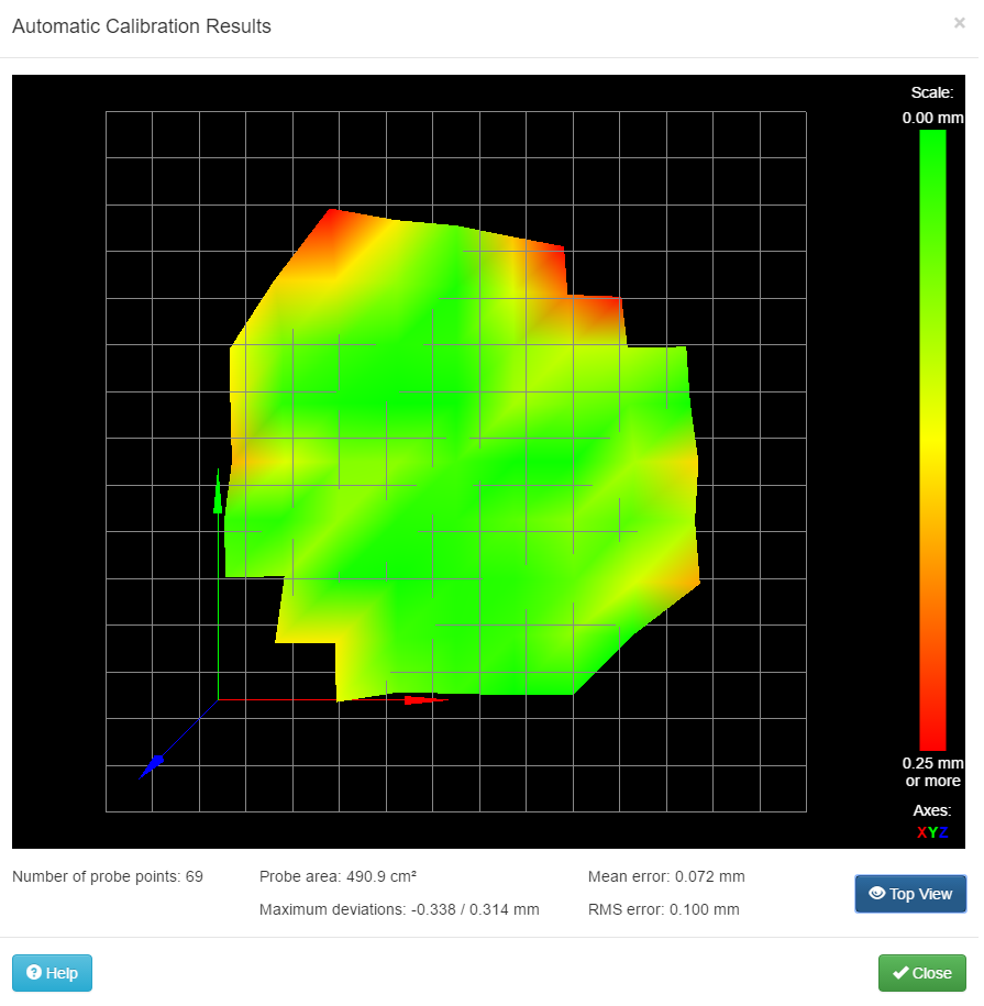

It's odd that your bed doesn't look more circular in the height map. Try a finer grid.

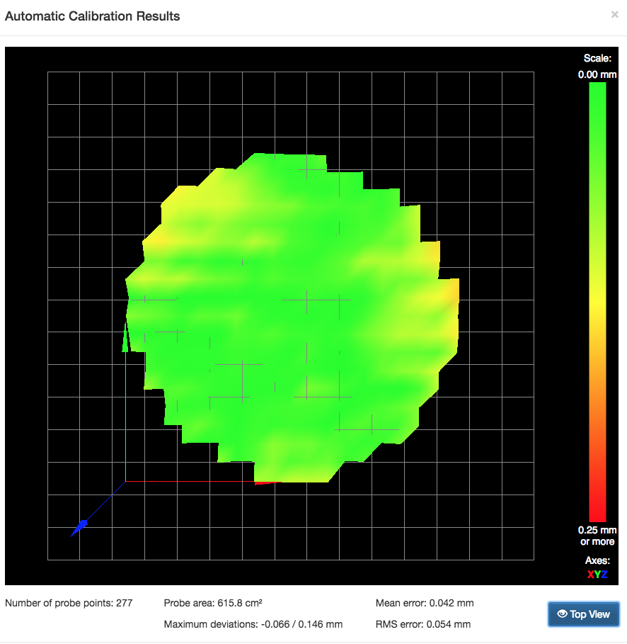

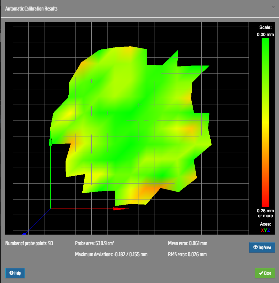

There we go, now we're talking. I knew my frame geometry wasn't that off.
Very nice!
[img]http://i.imgur.com/xds3fC6l.png[/img]
dc42
Posts: 454
Post by dc42 »
gestalt73 wrote:There we go, now we're talking. I knew my frame geometry wasn't that off.
Very nice!
I wish mine was as good as that!

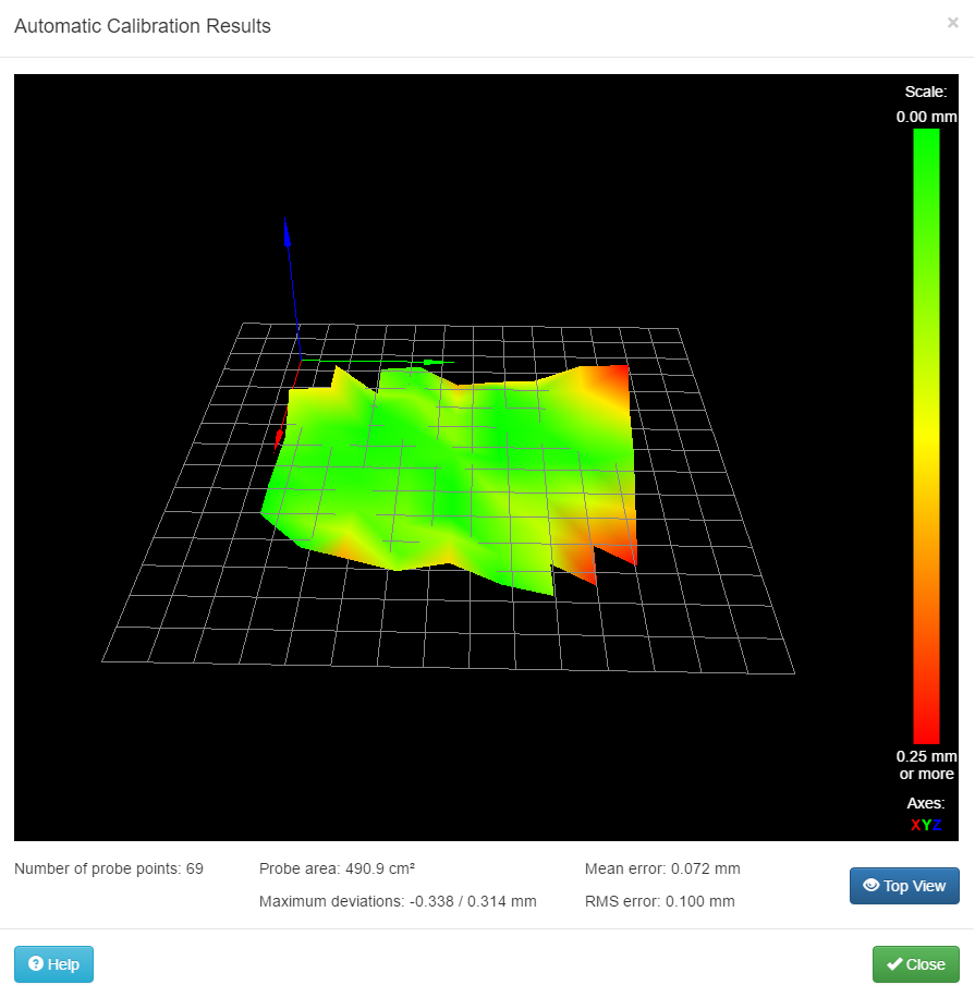

Not my V3 (it's a D300VS)

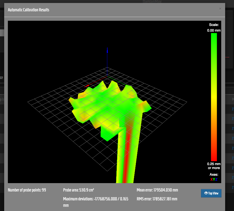

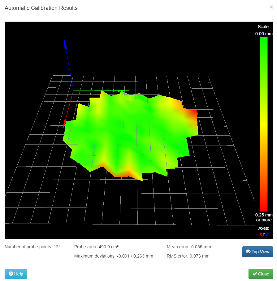

Hi there. I finally got everything up and running, but I have an odd bug with my height map. Any clue what could be causing this huge trough?
dc42
Posts: 454
Post by dc42 »
Were you probing off the edge of the bed on that side?
What type of probe are you using? If it doesn't use the nozzle itself as the probe, did you enter the probe X and Y offsets from the nozzle in the G31 command in config.g?

I'm on a Rostock max V2 with an FSR setup. Every point seemed to trigger and none of them missed the bed. The probe offsets are set to 0.
I thought maybe I was missing a command prior to homing my system because I got another error about moving the head before homing.
I'll run the test again to find the exact wording.

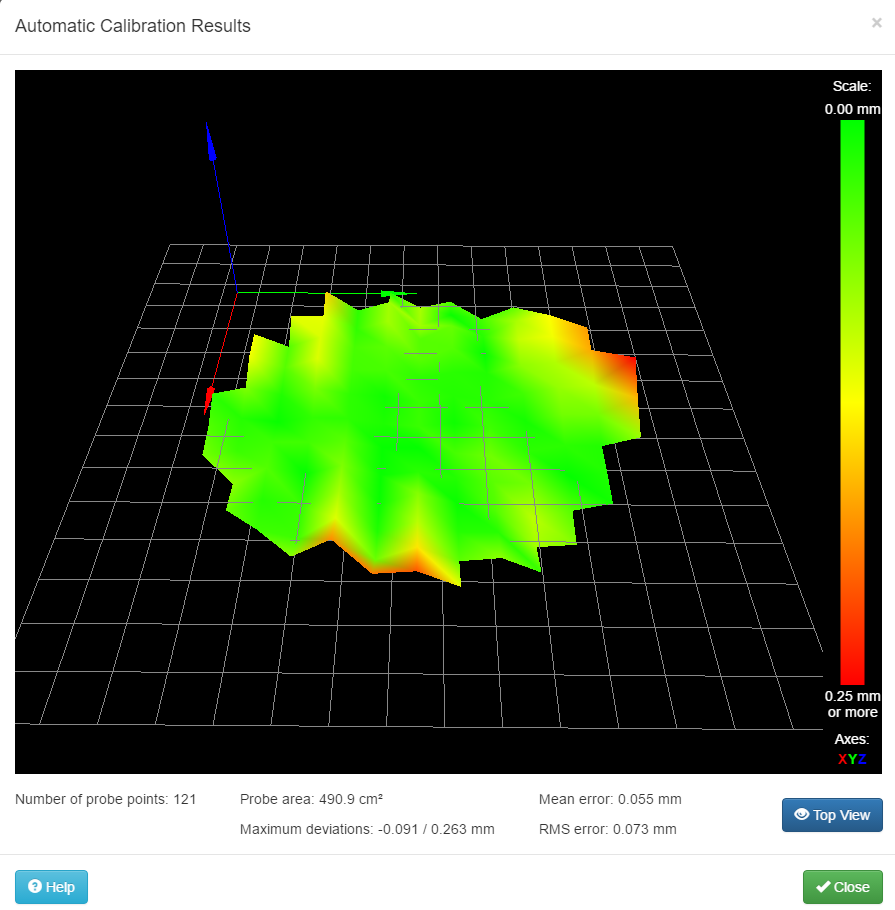

I was unable to reproduce the problem. It happened the first three times I ran the grid compensation, but this time it did not. It may have just been as simple as power cycling the printer.
dc42
Posts: 454
Post by dc42 »
My best guess is that the FSR at that point was triggering really late for some reason.

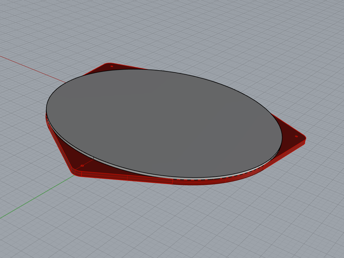

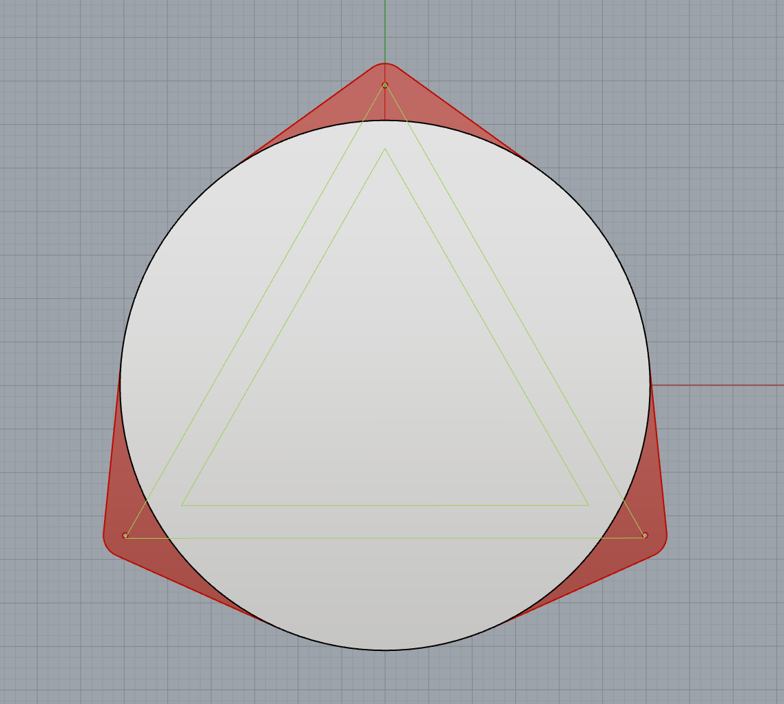

David, this may be the "ringing" FSR issue I mentioned to you a few weeks ago. I have a new D300VS delta that I discovered this on. It happens when probing points opposite (or near opposite) an FSR sensor location. You can see it if you watch the JohnSL - the LED or LEDs instantaneously light up on the initial trigger - this is quick. Then a split second later usually 1 LED (and it is at the FSR opposite the probe point) will illuminate and stay illuminated for quite some time, a second or more. This happens when the bed "pivots" when the point is probed and then falls onto the FSR on the other side after the initial probe is complete. I don't know why that secondary trigger takes so long to clear as compared to the initial trigger.
Grid probing exasperates the problem since the probe points are closely spaced and get hit before that ringing FSR is cleared. You can add a delay with the R parameter and really slow things down but that's a Pain and/or slow down probing speed. You can apply a little built-in top force to each FSR to prevent it from lifting.
I've been aware of this issue during normal auto calibration probing - I've seen it on several of my FSR equipped deltas. That led me to rethink the FSR mounting system and I've come up with a better solution that places the FSR contact points outside of the perimeter of the build surface. Ideally you want to completely eliminate the hinge point but that is not practical. This is a reasonable compromise that has been working well and I've not seen the ringing effect at all.
Here's a top view so you can see the overhang.

That's an interesting observation. I have my FSRs mounted half way between each tower and that point does appear to be exactly across from the FSR mounted between my x and y towers (if I'm reading that graph correctly).
