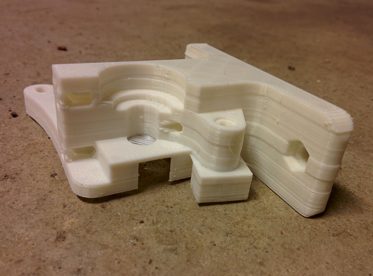

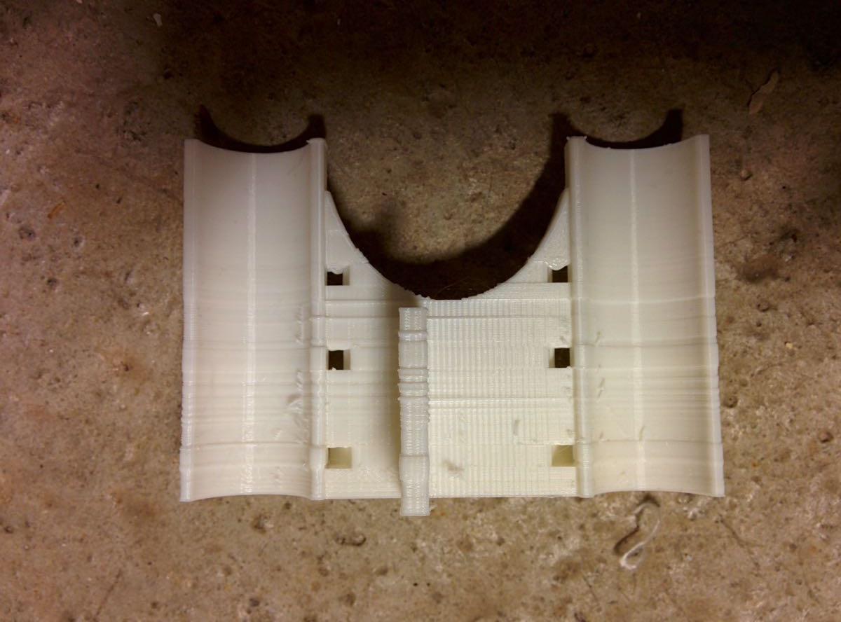

Hi all,

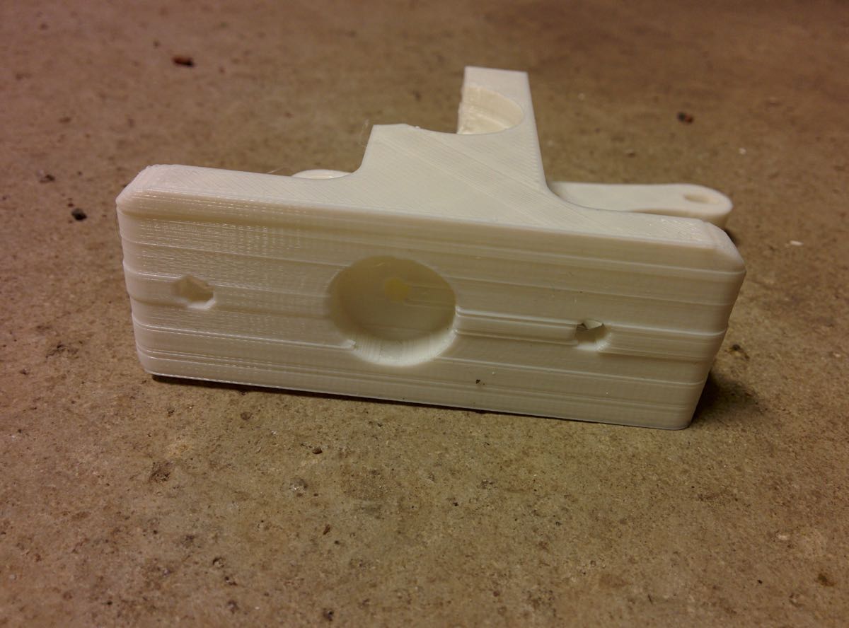

I have a Rostock Max V2 which is working well, except I see some banding/artifacts on the surface of layers with holes. I was asked to print a bunch of STLs and the effect is especially visible on some of them since there are so many nooks and crannies. I've printed smoother things like helmets without any such artifacts. The effect is somewhat exaggerated by the lighting, but still clearly visible in regular daylight.

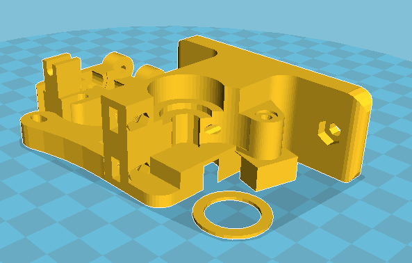

I'm attaching a number of pictures as well as two screenshots from cura.
The STLs were sliced in cura and I decreased the outer shell speed to 10 mm/s (I normally print those at 20 mm/s but decreased to see if that helped, it didn't). Resulting gcode was printed through octoprint. Looks like I'm using Repetier 0.91S
Code: Select all
Send: N1 M115*39
Recv: ok 1
Recv: FIRMWARE_NAME:Repetier_091S FIRMWARE_URL:https://github.com/seemecnc/Repetier-091-ROSTOCKMAX PROTOCOL_VERSION:1.0 MACHINE_TYPE:ROSTOCK MAX EXTRUDER_COUNT:1 REPETIER_PROTOCOL:2

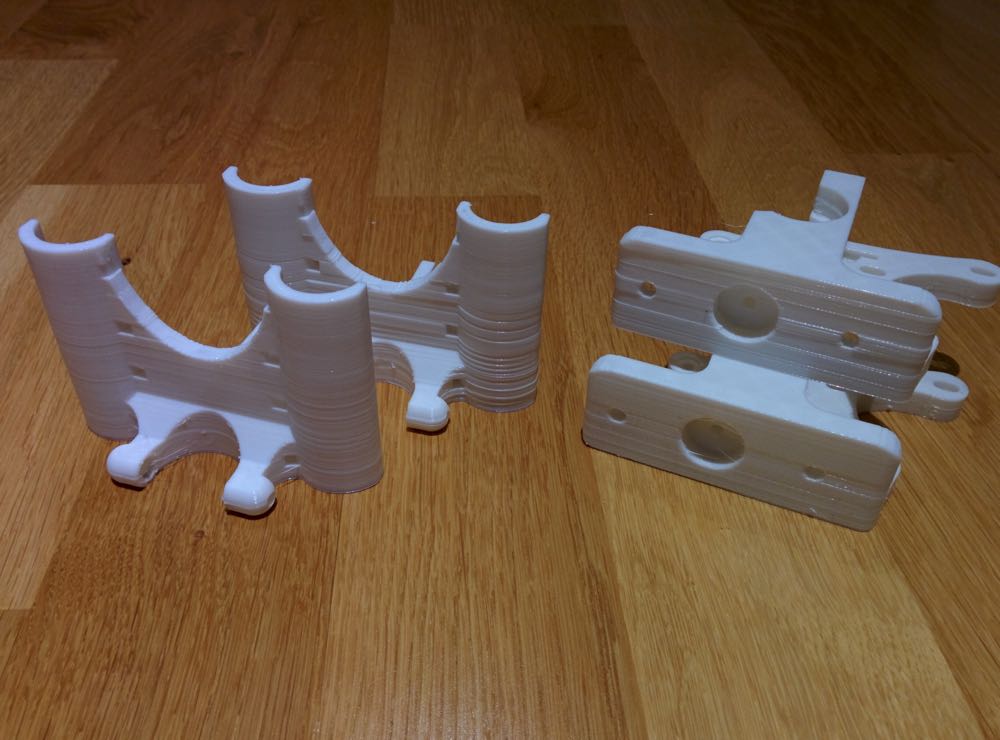

  • Areas where there no holes on the same horizontal layers print nicely, see for example the top section of the 4th picture
  • Take the hex-shaped hole to the right in the 2nd picture: the area to the right of that hole is wider all around to the other side, it's not like it's shifted
  • It doesn't seem to be related to which height the hole is at.
  • If it is a mechanical problem, I'd expect a more random result and/or shifted layers. These are... wider/narrower somehow.
  • Is this software/firmware related? Something like a rounding/calculation thing?
I'd be happy for any suggestions. I've tried searching around for solutions but haven't been successful so far.
/Klas

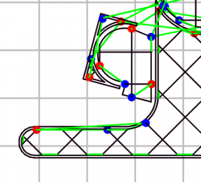

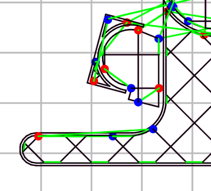

changes in coords visible in gcode: I looked at the gcode using gcode.ws and it looks ok (no shift in gcode apparent in 2d view)
arms/carriages: I have the injection molded cheapskates and arms. The printer is from Jan 2016
varying bed temp: I noticed the problem with the hole below the bed during first runs. The firmware/software never (or took forever) thought the bed had reached its target temperature so the print never started. I put some tape over that hole during assembly. I'm thinking the effect would be less connected to the presence of holes if this was the problem?
travel direction may be reversed when dealing with the holes: According to gcode.ws, it always moves counter-clockwise both on layers with and without holes :?
I'll play around with retraction and speeds on the machine and get back to you.

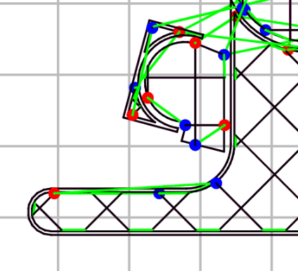

Attaching two screenshots of the area to the right in the second picture for reference.
A layer below the hole:
A layer at the hole:
Thanks again!

I've now done some more testing, using a few versions of speeds and retraction settings. It looks like the problem was a difference in speeds between inner/outer layers.
I've normally kept my values at these:
  • travel speed at 150 mm/s
  • outer layer speed at 20 mm/s
  • other layers at 40 mm/s
I've seen slight banding around holes there before, but haven't printed that many objects with so many holes in them.
For the versions I've shown earlier I thought I'd be clever and get a nicer result bu reducing the print speed of the outer layer. So I set them to:
  • outer layer speed at 10 mm/s
... thereby evidently increasing the effect. These last pictures were printed at the following values. The new prints are closest to the camera. The new ones look a lot better (and I'm not being kind with the lighting in these pictures), although there's still some slight banding. I'll experiment some more and increase the speeds a bit to reduce the print time.
  • travel speed at 40 mm/s
  • other layers at 20 mm/s
Thanks everyone!
