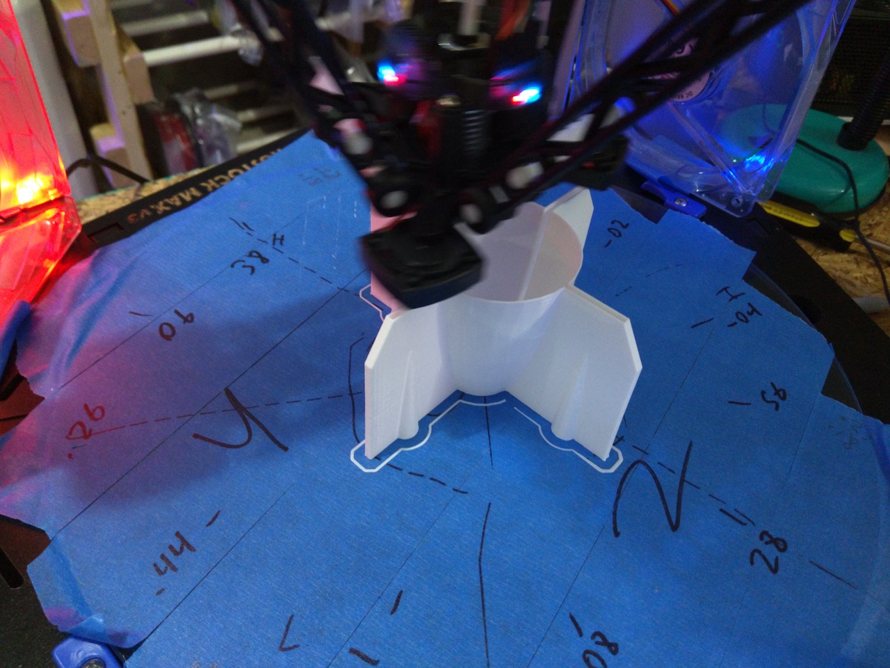

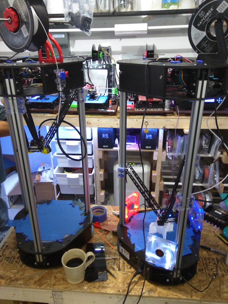

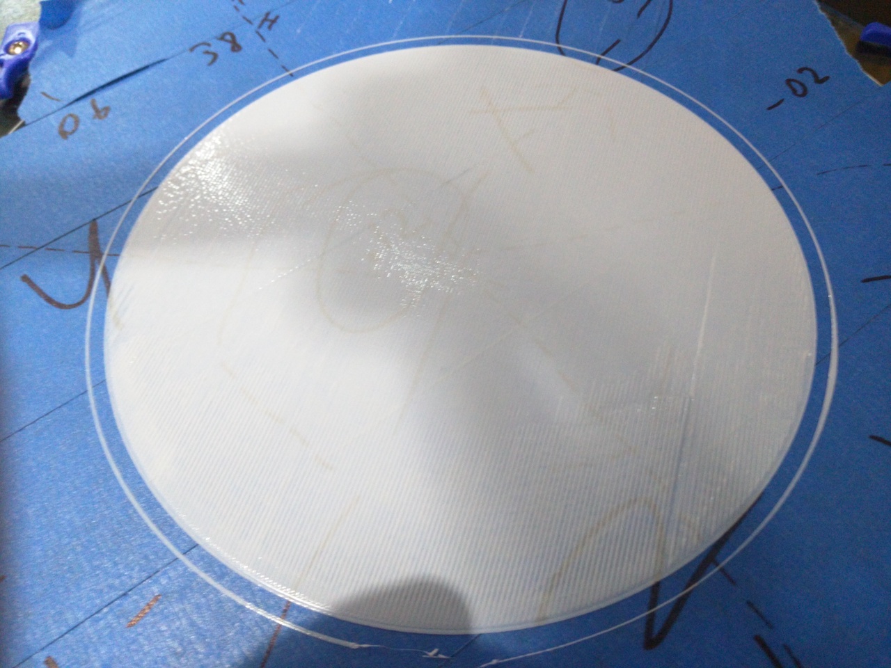

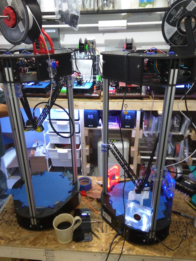

We had a redditor bring in his V3 to the depot for repairs. The printer would not level correctly and was useless for over a month.
Shameless self plug, we offer maintenance and materials contracts for printers as well as free depot repairs.
We looked into the issue before starting work and found a lot of ideas and no solutions, please point to posts if you have found others who have solved this issue: (http://forum.seemecnc.com/search.php?ke ... d+leveling) After walking through some test prints (see photos) we identified several issues with the build and found a solution for the probing issue which was repeatable on our V3 (after breaking it intentionally a bit).
Beginner level video instructions on how to correct this: https://www.youtube.com/watch?v=DxGT18rDKUM

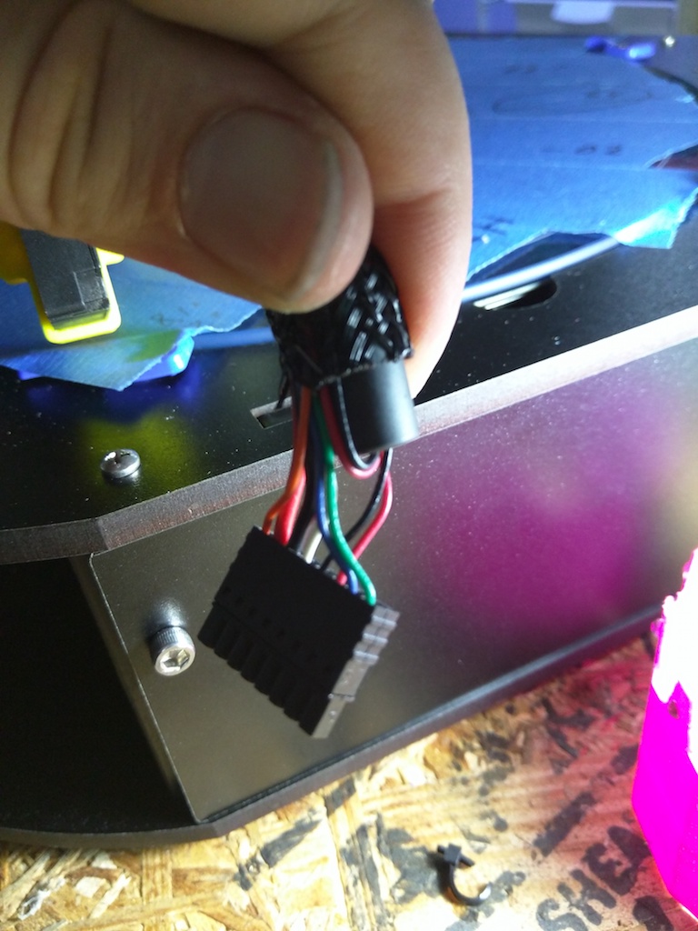

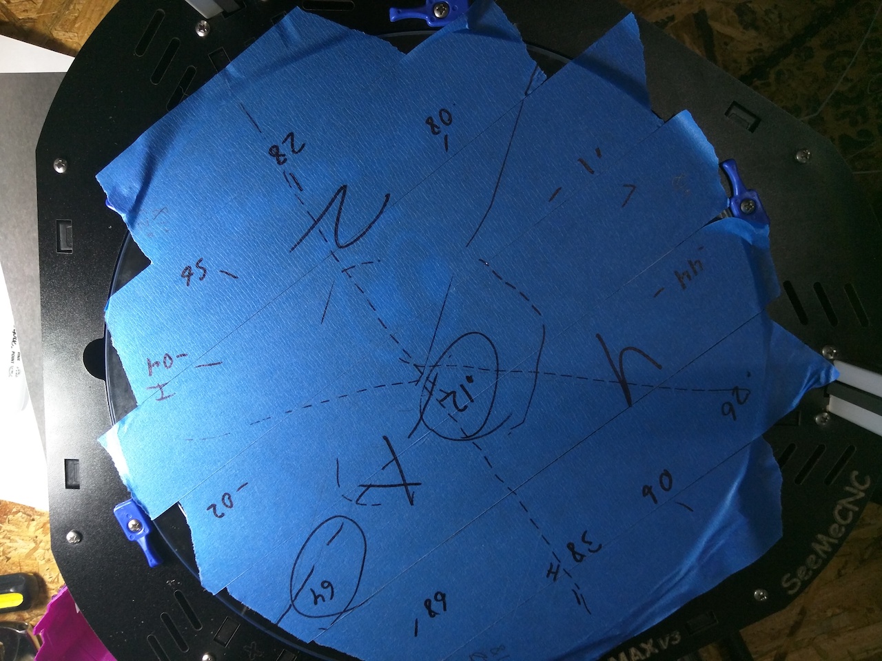

The following 3 Items seem to have cleared up the issue:

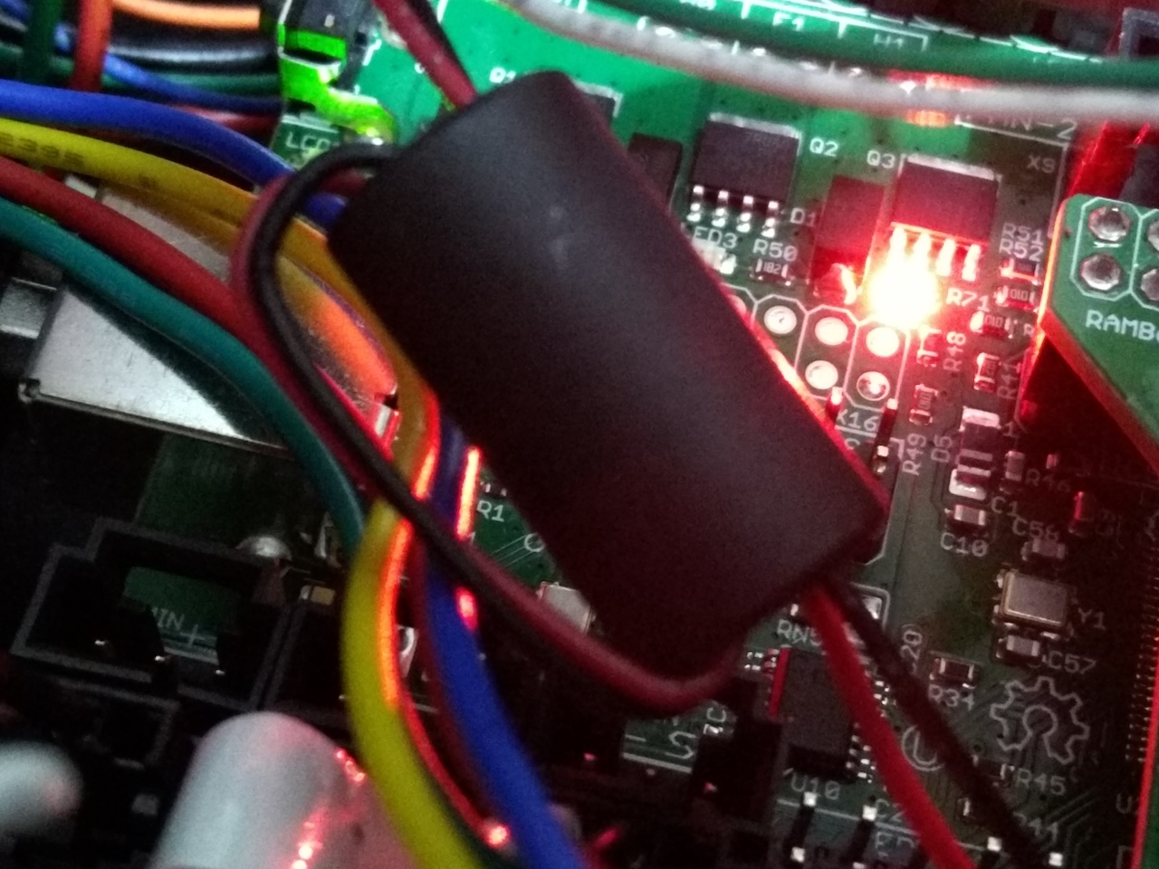

#1 Added a Ferrite bead on both ends of accelerometer wires, at the HE280 and at the Rambo (See photos)
#2 Wiring to HE280 plug, removed, cut wire ends flush and pressed them in properly this was for the power and probe wires.

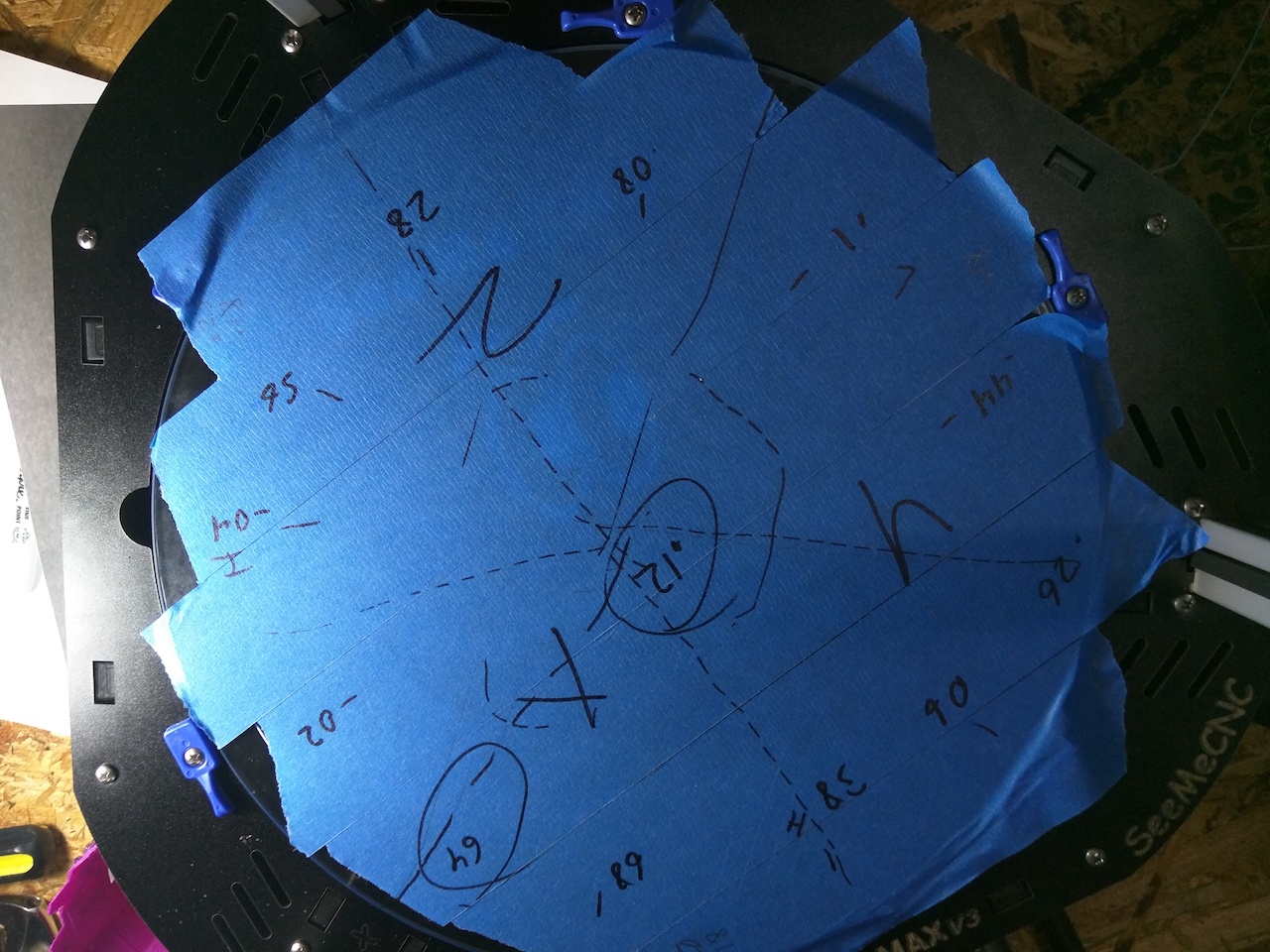

#3 Ran the V3 Probing code repeatedly until the first probe attempt doesn't crash at the X tower. This we found needs to be all of the time. If you get a crash when running the probing code, let it finish and then run it again until it runs the first tower without crashing (generally 2-3 iterations).
* We ran the probe with the bed and nozzle heated not cold. Heaters were killed just prior to probing.
**We saw no difference in probe results or first layer results with 0 3 or 6 bed clips. It didn't seem to change the bed shape. Obviously over time having pressure points on heated glass will warp the glass slightly so it be a good idea to tape the bed in place if you are concerned.

4. Added a Ferrite bead on both ends of accelerometer wires See photos
5. Wiring to HE280 plug, removed, cut wire ends flush and pressed them in properly.

mhackney wrote:The interesting thing, to me, in this post is the Ferrite bead.
If I have the chance to repair another V3 for this issue I will start with the Ferrite beads and then have some better observational evidence what the effect is.
mhackney wrote: Can you describe or show (photos) of what the problem was when the owner brought this in?
I can ask the owner if he has photos, lacking that there are photos attached of our initial print and the 13 point calibration readings which are written on the bed in black sharpie. This is the post he provided which "described his issue" http://forum.seemecnc.com/viewtopic.php?f=37&t=10934
mhackney wrote: Many of us have been battling a persistent leveling issue that appears in the same place for all of us. I have researched this at great lengths including rotating the HE280 hot end to eliminate position of the accelerometer as the culprit, etc. I have also completely disassembled the bed, inspected, reassembled with no effect.
I had read through a ton of your posts and the ideas of rotating the hotend etc I was not very confident that we would be able to solve the issue as you seem quite a bit more knowledgeable on these printers and willing to go to greater lengths to resolve the issue. The ideas we had came more from the think like a child camp. The wire and bowden tube being on the side can add weight and EMI sucks for sensors (We had to wrap our FSR's to get rid of EMI). Also DIY assembly by inexperienced (Apologies) users can cause weird issues. The symptoms were the same as described by you and others the tight spot between the Z & Y towers?
mhackney wrote: I've also used 3 or 6 clamps with no effect (and you need to be cognizant that with the force the probe hits the bed, if you do not have these all adjusted to support the bed, it will tilt slightly as there is not a support clamp directly underneath the probe points at the base of the towers). On my printer, the issue came and went then came again. I mostly have it. When I test the end stop offsets manually after a calibration I find that they are indeed incorrect, indicating a probing problem.
We initially did all probing with no clips holding the bed. Just masking tape. After a while we did clip the bed down with 3 and 6 stock clips. As I said we did not see much difference in the probing results. If you don't use clips you need to ensure you have the bed secured to prevent the force of the probe from offsetting the bed when it hits. I remember Steve talking about how they had to probe fast enough for the accelerometer to work and it makes sense so the tapping is not avoidable it just needs to be accounted for.

! To clarify I am speaking of the probe hitting and tilting on the first probe at the X tower. Mechanical. Not about the RAMBo or script crashing. Thank you for clarifying.
My V3 also has mechanical crash issues on probing as mentioned usually running the code 3 times gets a clean probe.

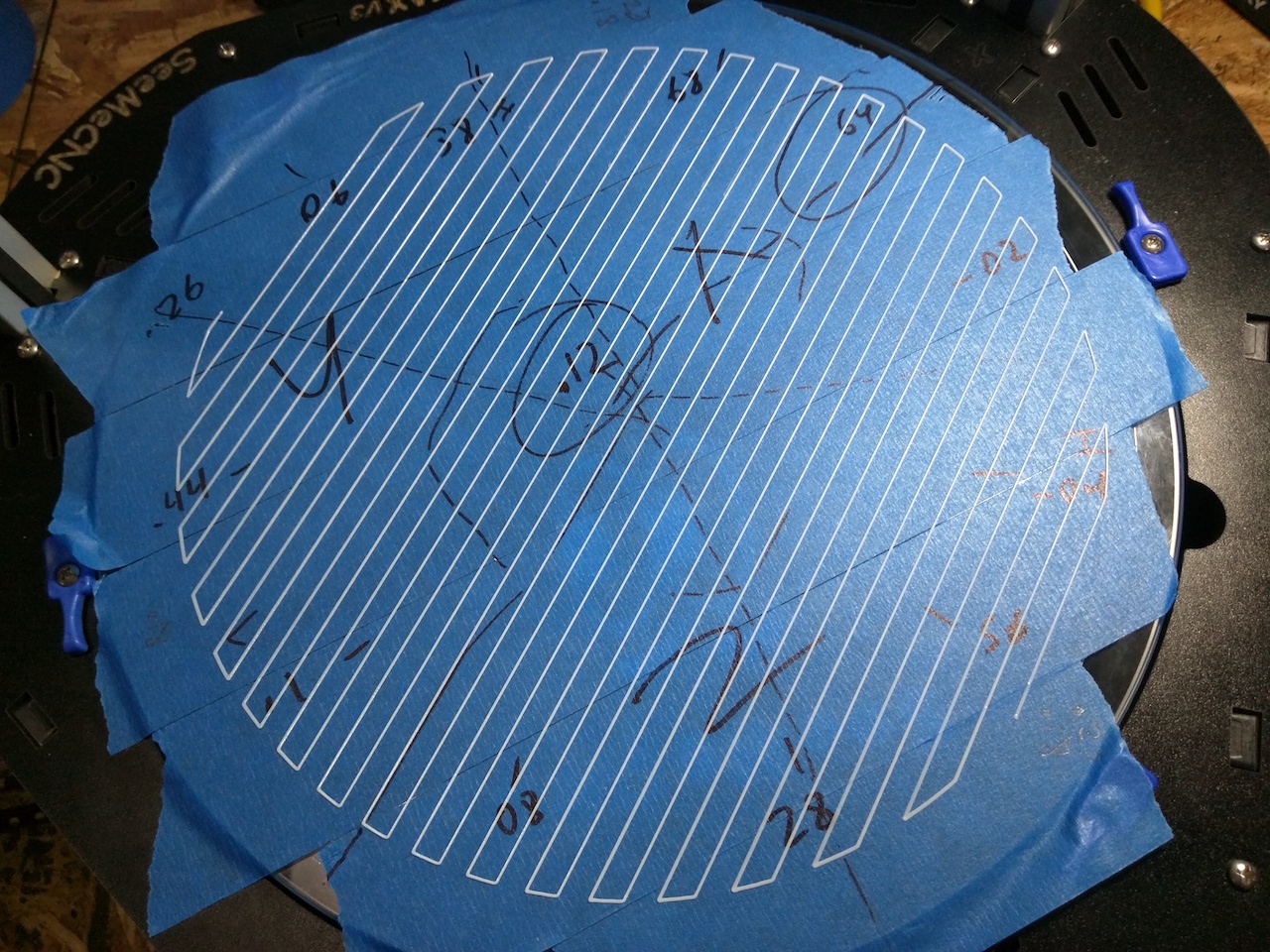

mhackney wrote:I'd be interested in the STL or gcode for that test print too - the large zig zag one. That's a great idea.
You will laugh. It's an extruded circle. Of any size. It's all in the slicing.
We used to make the print in matter control or cura or slic3r not sure which, there was an option for concentric infill and you could make a center out spiral to test these thing as well as this line version.
https://puu.sh/s0P5w/160bca34b0.png
https://puu.sh/s0P6M/75782e8dca.png
https://puu.sh/s0P9w/985a010c44.png

mhackney wrote:Thanks for the update. Interestingly, the 12+ printers (including mine) with a leveling issue all have a thin layer near the X tower and thick near the Y-Z. The opposite of ComJak's problem. His is the only report I've seen that is opposite.
That is what we saw after our initial testing. The extruder was off the bed at X/XZ and Squishing at Y/YZ.

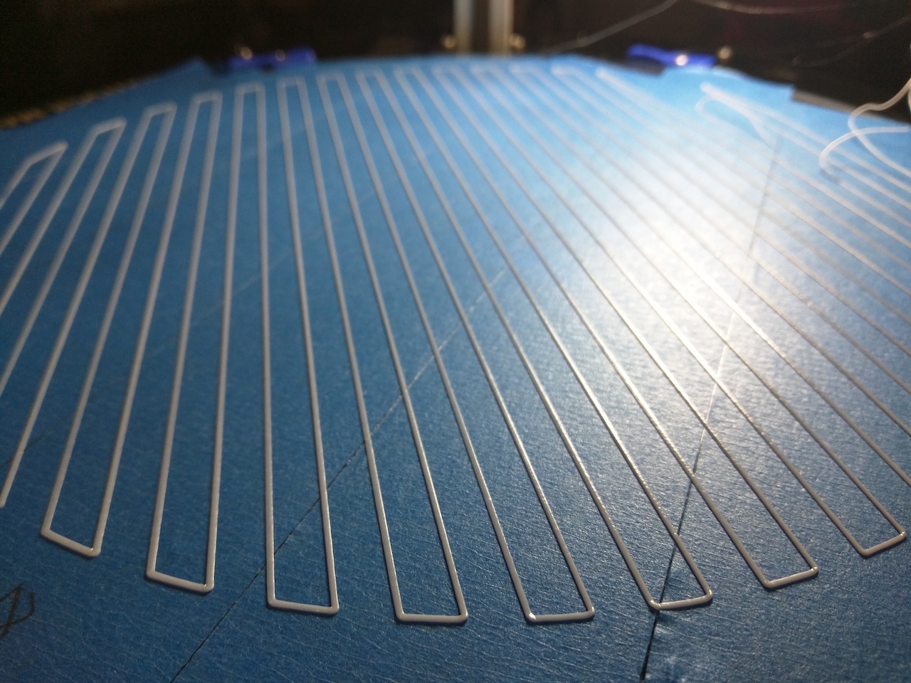

I'm still really struggling with this bed leveling/calibration issue. I have tried adjusting temps, several calibrations, decreasing the probe radius, using only 3 clips, using washers on the bed clips, etc. and it still seems like it's printing on a slant.
[img]http://i.imgur.com/vAtRU98.jpg[/img]
See how it's super smushed on the right (Z/Y) and lifts off the bed on the left (X/Z)?
Can anyone offer me any more insight on this? I've already scoured the forum. At the very least, can someone give me a step-by-step of how to manually calibrate the v3? I apologize for my newbness; this is my first 3D printer.

PhantamaroK wrote:I'm still really struggling with this bed leveling/calibration issue. I have tried adjusting temps, several calibrations, decreasing the probe radius, using only 3 clips, using washers on the bed clips, etc. and it still seems like it's printing on a slant.
This is the same problem I have X/Z tower lift Y/Z good to smashed

mhackney wrote:Yup, you are on my list!
I am going to pick up some Ferrite beads tomorrow and see what happens. I've spent a LOT of time investigating mechanical reasons for this but have come up empty. Perhaps miaviator is on to something.
Did you get the ferrite beads yet and if you have did they make a difference?
I'm working on a step by step video guide for this. I'll include referral free links to ferrite beads which can be purchased. Should be done this weekend. Lacking that if you read the first post it goes over what we believe the issue is when this happens. Until then printing smaller footprint items or using a raft should be fine?
