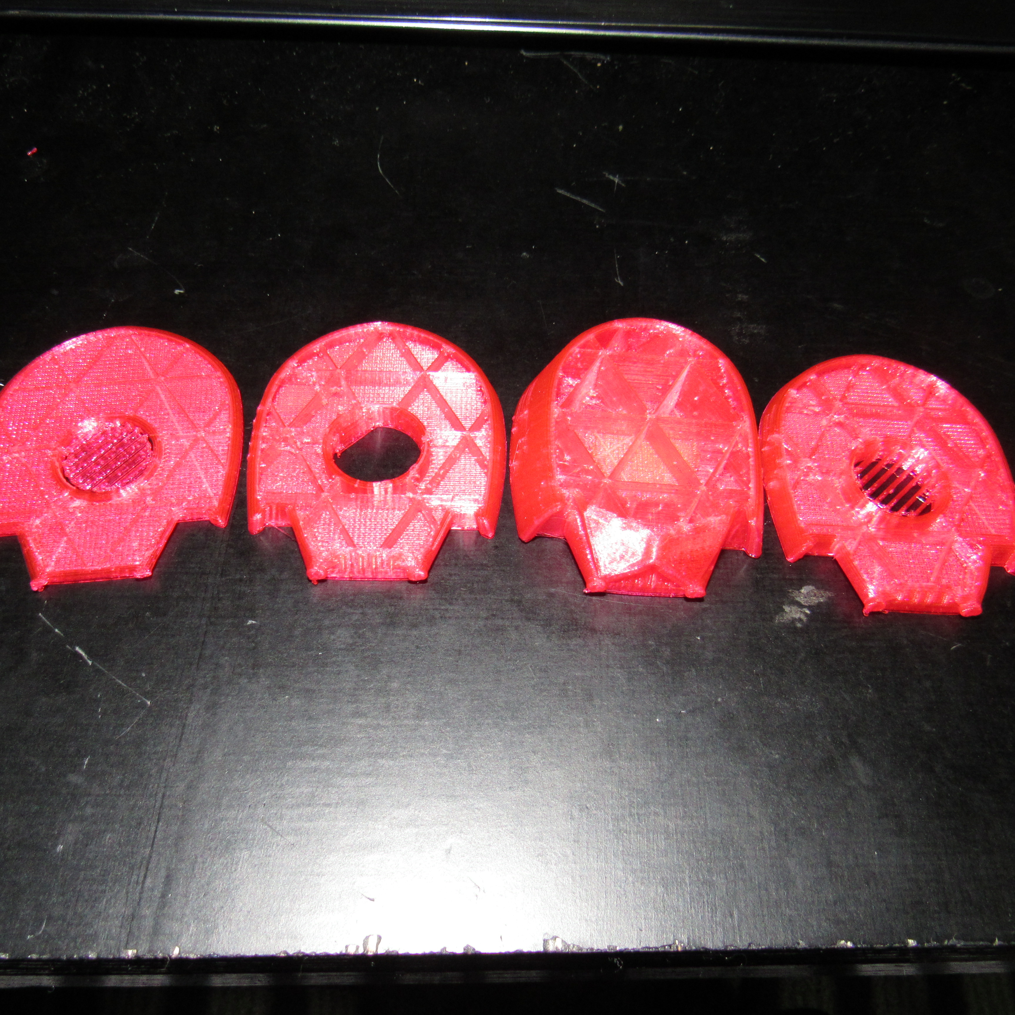

I am trying to calibrate to print my several PETG rolls. However I have an issue I cannot with random globbing in and on my prints. The following are several attempted prints with slightly tweaked settings to see if the globbing would go away with no luck.

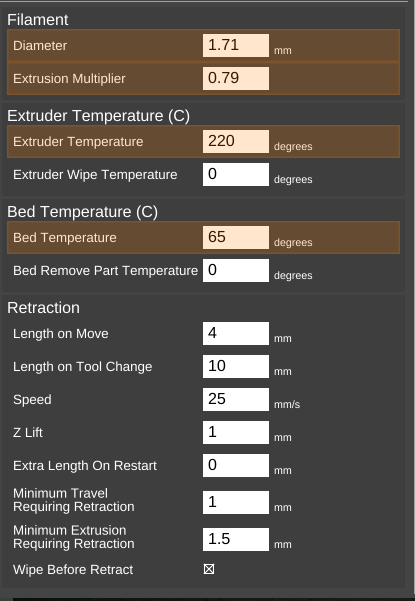

Here are the settings I am currently using:
Hope someone has a golden tip on solving this issue.

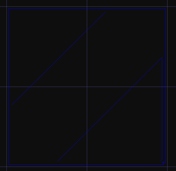

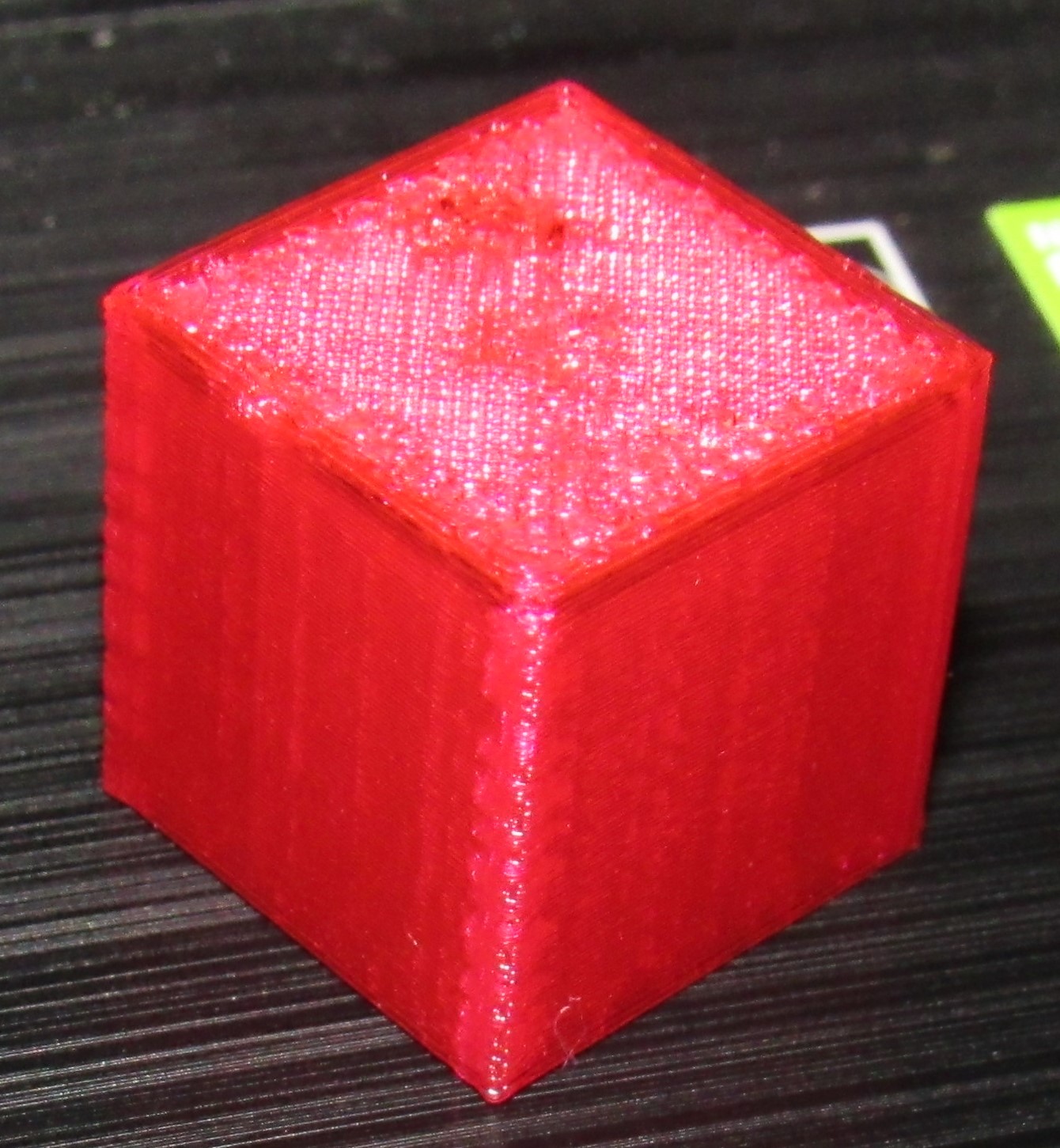

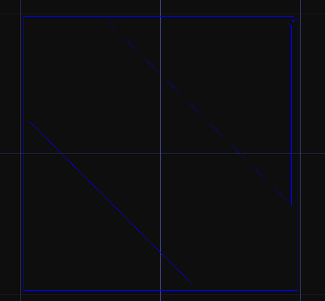

Hello,
Here is the test cube that I printed using KISSlicer. It has some weird artifacts on two of the four corners and the bottom layer looks bad due to not being primed enough. (the top of the image is actually the bottom layer)
In the slicer I noticed that when I look at the layers. I see the following which seem to line up with the weird artifacts I see in the cube.
Re: PETG Calibration
Are you talking about the upper right corner on the top image and the lower right corner on the lower? That is KISS' method for preventing perimeter blobs. You can control that on the Style tab with the Depth and the Seam Hiding Gap settings. Jitter will randomize where seams are. The PDF manual file I've linked to show how to use these with examples. Page 15 in my copy of the manual. You can turn it off, make it bigger, smaller, etc.
You can also control the print speed with the Slider on this tab. It scales all of your speeds as you adjust it. The resulting speeds are displayed on the right lower corner of the window.

IMBoring25 wrote:I use a 255C hot end for PETG but you may not want to do that depending on what hot end you're running.
Hello there,
Now that I got PLA printing nicely and got many prints done so far. I am back to fighting with PETG. Could you share your settings so I can use them as a guide to calibrate my filament?
Lately I have been having a lot of success with KISSlicer. I think I got the hang of it for most prints. It does have limitations which i hope they put in future versions. I am using mhackney's profile for the Rostock v3 and so far I have printed Hatchbox regular PLA and Wood PLA without any major issues. I now hope to find the right settings to print PETG so I can make use of the filament rolls I have.
IMBoring25
Posts: 616
Post by IMBoring25 »
What hot end are you running?
javiercordero20
Posts: 62
Joined: Wed Oct 05, 2016 8:00 pm
Location: Curacao
Post by javiercordero20 »
IMBoring25 wrote:What hot end are you running?
The stock hotend that comes with the Rostock Max V3.
IMBoring25
Posts: 616
OK, that one can do 255. Other than 255 hot end and 70 bed, I'm just using my standard E3D ABS settings. 2mm, 10mm/s retracts, which I believe are also appropriate for the HE280, if you're using something else.
javiercordero20
Posts: 62
Location: Curacao
IMBoring25 wrote:OK, that one can do 255. Other than 255 hot end and 70 bed, I'm just using my standard E3D ABS settings. 2mm, 10mm/s retracts, which I believe are also appropriate for the HE280, if you're using something else.
What about your extrusion multiplier?
IMBoring25
Posts: 616
I've never touched that.
