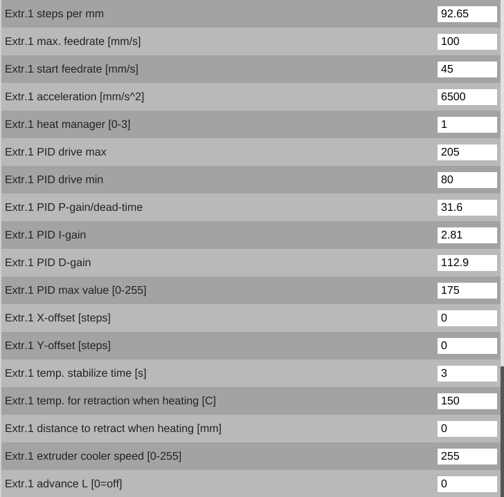

Been working and reading the forums all day. I printed the fan shrouds last night and when they were installed today it reduces the hot end below the calibration threshold. What settings can i change without melting my printer?

Hi, what's your Extr.1 PID max value??
Martín S.
Circus621
Posts: 21
Joined: Mon Jun 27, 2016 9:31 pm
Location: Hudson Valley NY
Re: M303 S200 WONT REACH TEMP AFTER FAN INSTALLED.
Post by Circus621 »
I believe its 205 I hover around 194°.

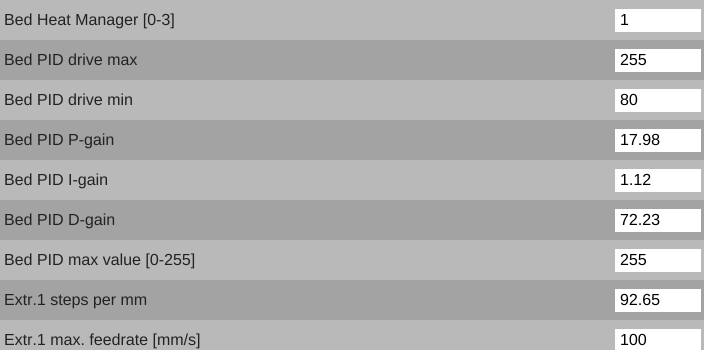

I had the bed info sorry about that. Still getting used to this whole thing. Thanks for looking at this with me!

I would increase your drive max somewhat, say 230, and if that doesn't do it, start boosting your P-gain until it does. Also wrap the block of the hotend in Kapton tape.

By looking at your picture, the "Extr.1 PID max" value is of 175, bump it up at least to 205. If it doesn't work, increase it more like Xenocrates said.
Do that first, it should work without needing to play with the PID.

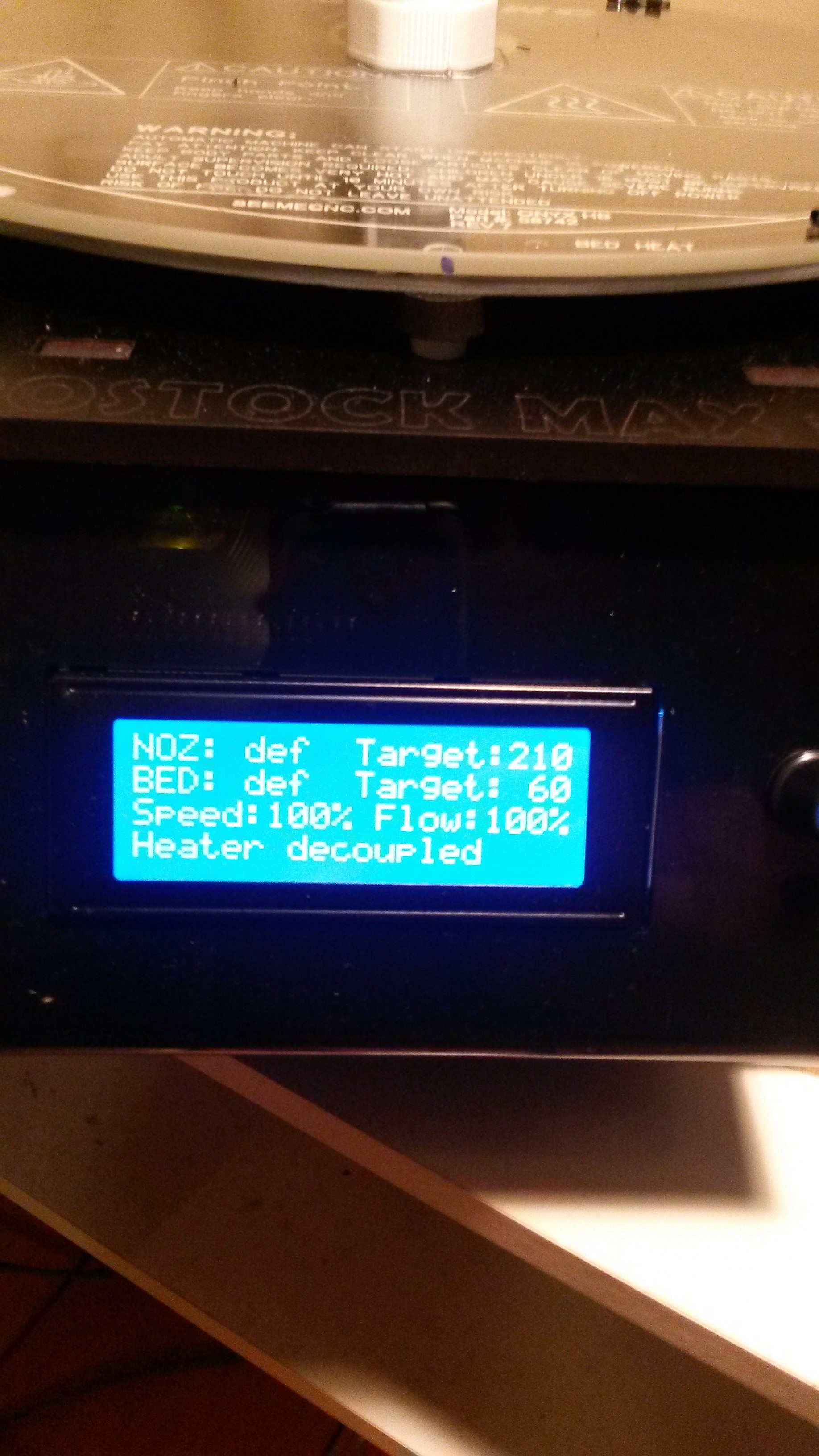

I am up and printing now. Thank you guys. I raised the PID max from 175 to 205 on the bed and extruder and seem to be good on the temps now (I ran an auto tune on the hot end). I did get halfway through a pla print last night and the extruder stopped and left a double def error. This happened 2 times at different heights. I'm thinking it has to be a break in the thermistor wires? I see this error often.

It's a fault somewhere. It might be that your thermistor wasn't well potted, and so the leads are either touching each other, or the hotend. It may be that there's an intermittent fault in the wiring harness (anywhere from the bed to the board to the hotend). It might even be some loose soldered strands on the bed or hotend thermistor wires wandering elsewhere. Give it a look, starting with the hotend side (As that has the most motion and fails most often), and if you can, check your resistance at various stages. It should be ~100K at room temp almost all the way along. If it is much higher or lower at the connections for the Rambo, start testing chunks, like across just the thermistor at the solder points, from the solder point to the connector for the board (Not across the thermistor). That way you can find and isolate your failure point relatively quickly.

So the thermistor default issue goes back to the low temp settings. the default issue happened when the temp dropped below 183 for pla set to 210. Im sure the low p max value (205 i reset it to) was not enough to keep up with the extrusion. I have it at 220 now and the temp is still dropping ionto the low 190s while printing. I will raise the p max to 230 and play with the p gain as you suggested. I will also be adding some tape to help help the heat in the hot end. Thanks for the help guys!
