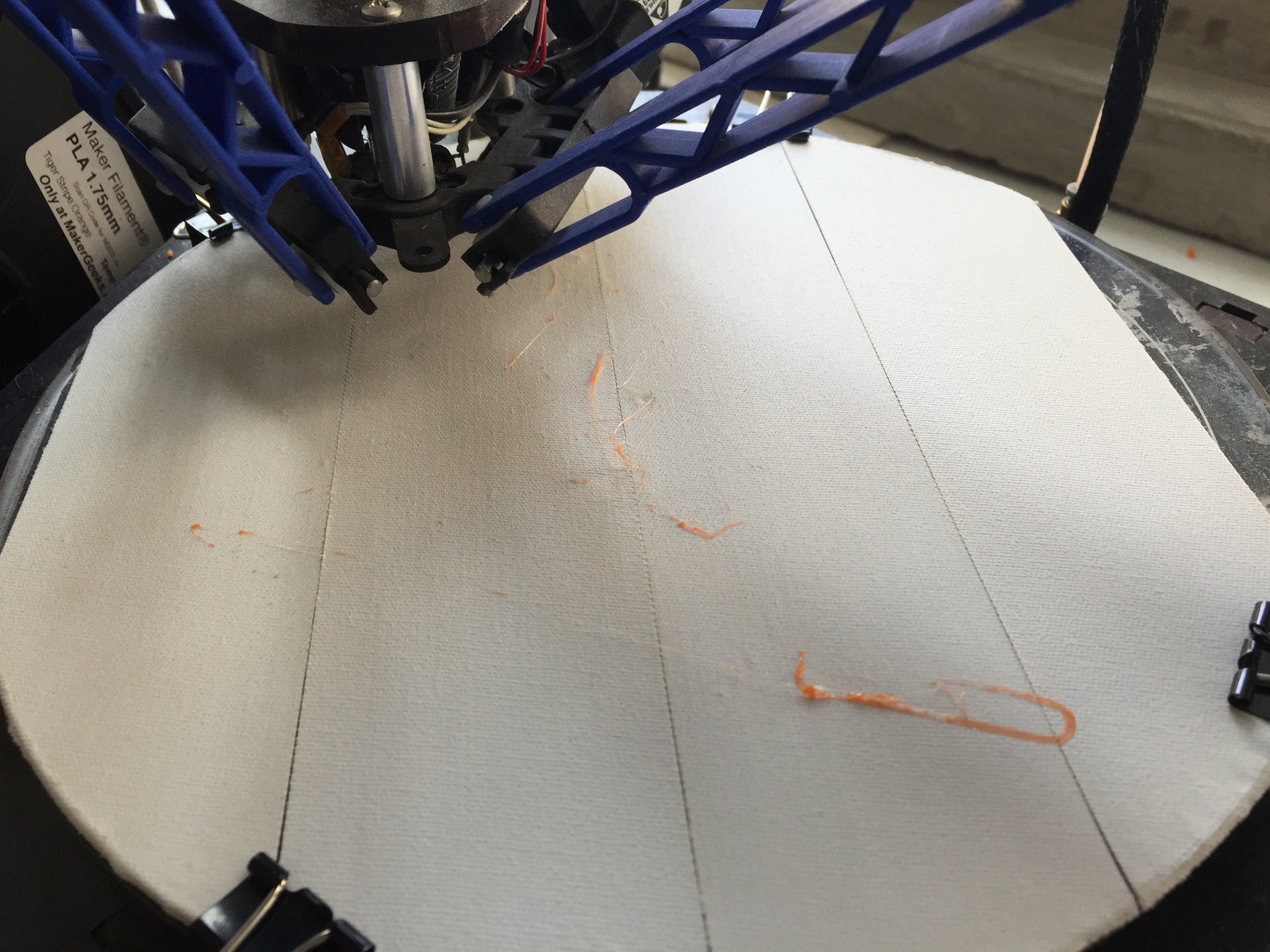

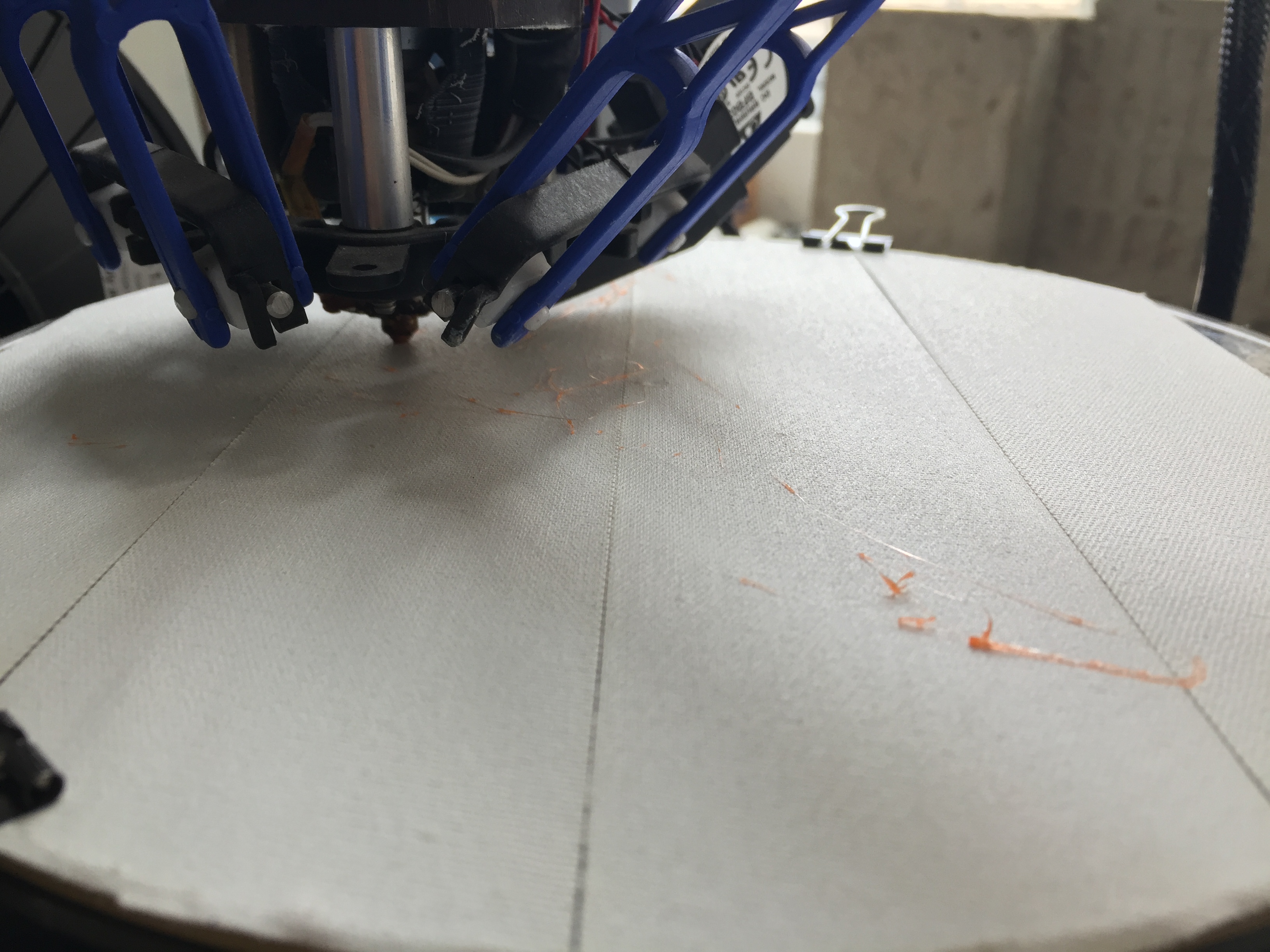

these are two picture of my first layer print

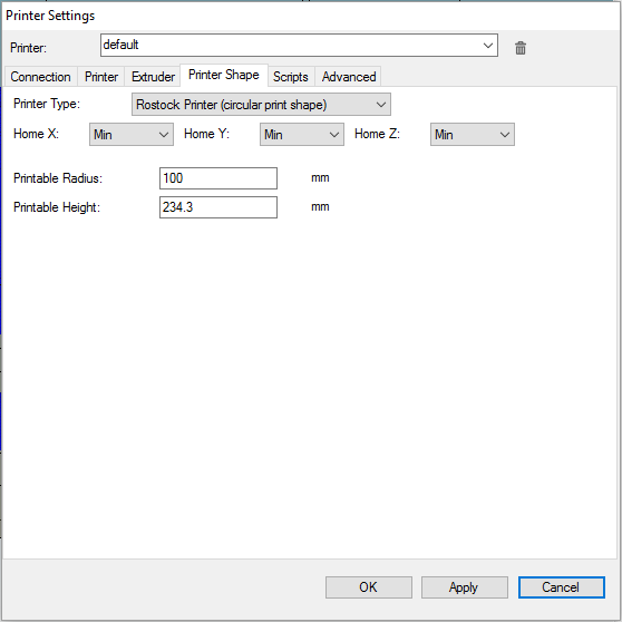

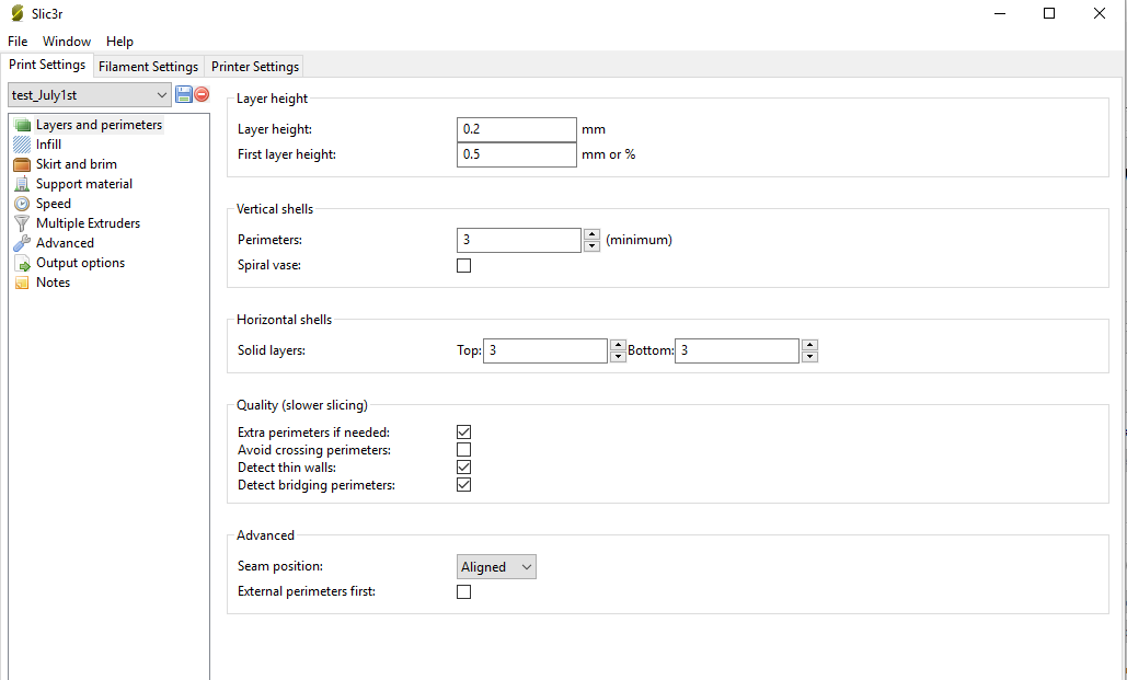

some settings i'm using, i've tried different first layer height, it's not working

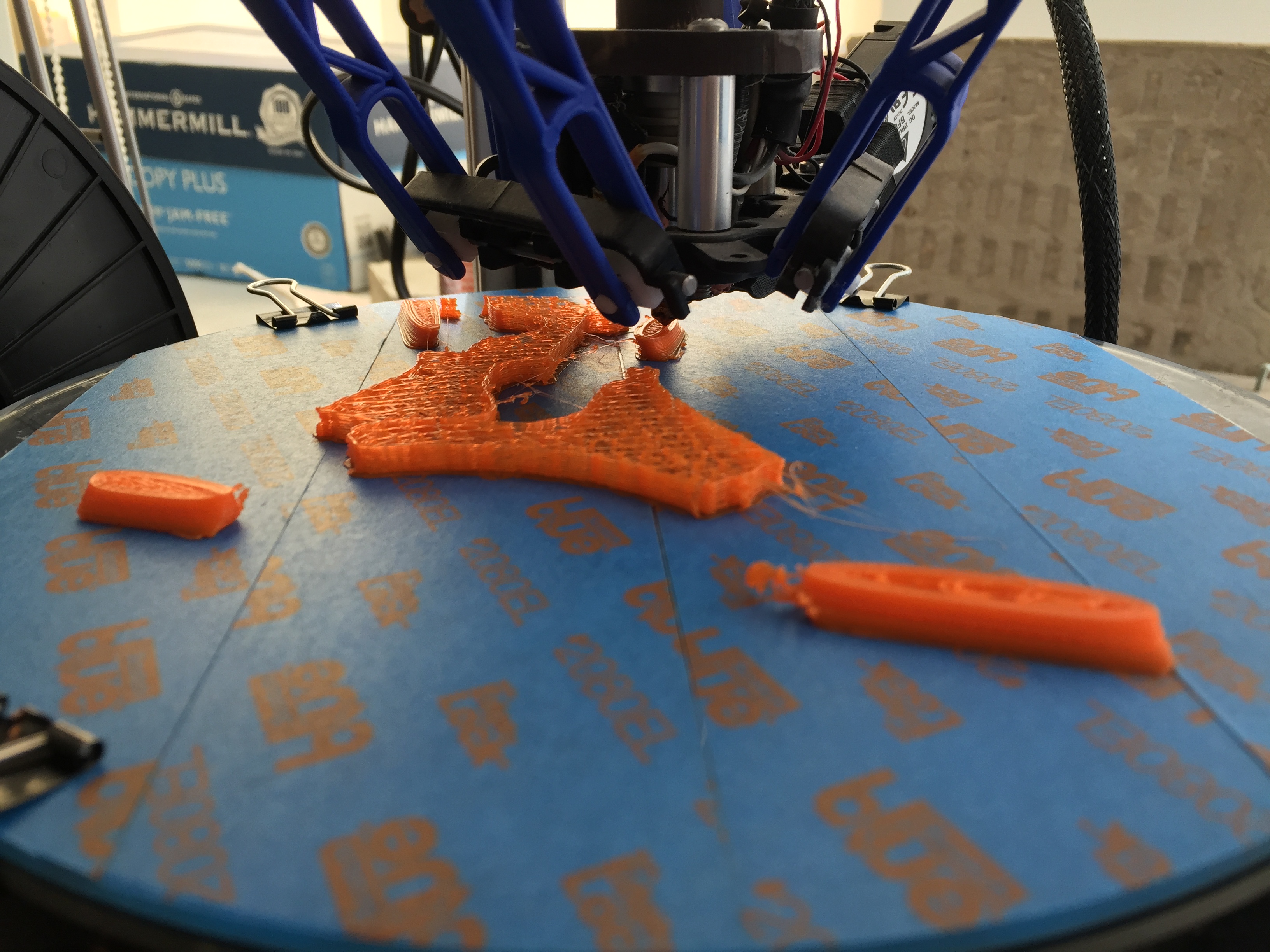

I switch my surface material to the blue painter tape, it's working pretty well,
Another key change is that I use an piano wire to clean up the nozzle, somebody must leave some burned PLA causing a jam in nozzle. Once the material could be extruded smoothly, the first layer is sticking pretty good.
