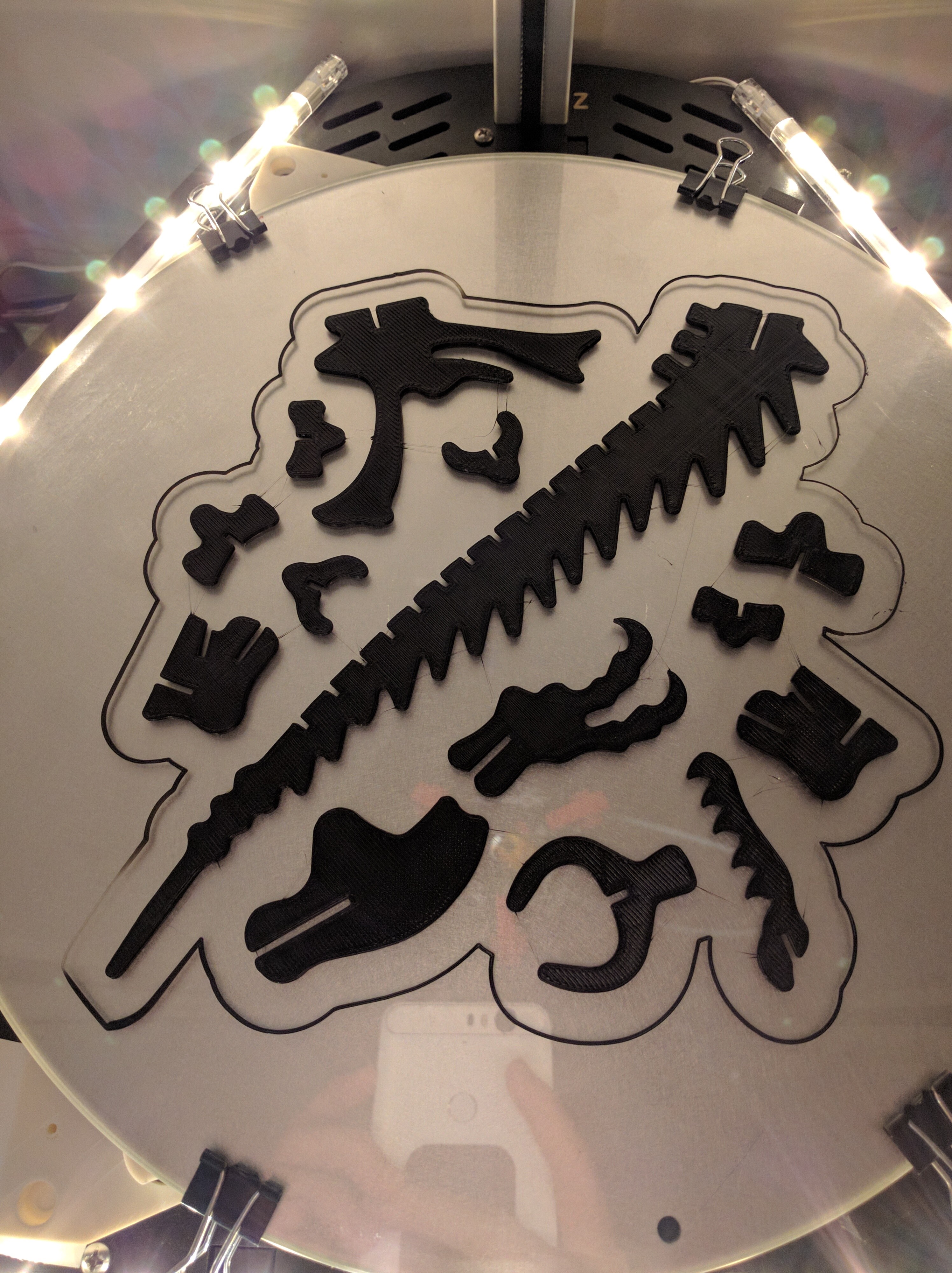

I have been trying endless to no avail to level my Rostock Max v2. I can get prints that stay within the center to print really well but anything on the edges and it does not. Spend my whole entire day yesterday trying out various things to get my FSR sensors to trigger more evenly across all points but still nothing. Link below is an image with a spiral showing where I am having issues getting the bed leveled.
The area between the Z and Y towers, and basically anything in the center. They are too close to the nozzle so that is why you do not see any filament.
https://imgur.com/PoXXBAQ
I am running a Duet board running DC42 (RepRap fork), and using FSR sensors.

I've had mixed results as well. The issue I'm seeing is directly inline with my X tower's FSR about 100mm from the center. It's a much larger usable area that I've ever been able to get out of my Rostock, but I still want to figure it out and to be able to print edge to edge on one of my machines.
[img]http://i.imgur.com/7V3Th3F.jpg[/img]
The brims and first layers are beautiful everywhere else.
[img]http://i.imgur.com/FrIPyHb.jpg[/img]
I'm going to investigate whether moving the sensor's wire, and then moving the sensor itself makes the symptom move. It's also the very first point that the routine probes, and I can see the hotend deflect a little bit, so it's pressing harder in that spot than the others. I'm going to try changing the probing routine to hit a different spot first to see if that makes any difference, too...
I'll share my findings later when I've poked it a little bit more.

Kept at it and then tried printing something to test. Was paying attention to my other printer and this happened... Its not perfect, but it is a lot better than before. Victory!

I watched as the skirt was printing and I noticed that my bed is not level at all. It varies off and on but due to the starting Z offset that I set it offset most places and allowed for printing. More work left to do, but for now I am happy.

I did change my bed.g file to try some different probe points, and I'm still having trouble. The file I tried did 0,0 first, then 8 points on a 250mm circle, and 6 points at 125mm. Same results, so it's not a math anomaly or fluke.
This is probably what's going on. I can see my hotend deflecting more in the point that's too tight, so I should play around with some H values.

I did this process with the paper trick, and am very happy with the results.
If it helps anyone, I did also create an STL with a little 1 layer high (.3mm) disc at each of the 13 probe points so that you can print and measure them if you really want to.

I ran the auto calibration first, which makes the whole bed at 0 or above (due to deflection), plus the thickness of the paper, so I didn't run into the need to go into the negative Z's at all.
I documented the Z height for all 13 points that gave me a good feeling on a piece of paper, shifted all of the numbers so that the mode was 0 (no need to change the most frequent measurement, it's much easier to define 0 with it), and added in the appropriate "H values" to my bed.g script. Lather, rinse, repeat.

A note to anyone doing the "paper drag" test. The height that you measure the paper at, whether positive or negative from Z0, should be subtracted from your current H value. The polarity seems backwards to intuition (for me at least), you're changing the overall Z height by that amount, not moving 0 by that amount. I.E. if your paper drags nicely at +0.02, you need to subtract .02 from your current H number.
A tight spot is fixed by decreasing your H value and shortening your resultant Z travel at that point, and a loose spot needs a higher number to flatten out.
Hope that makes sense and keeps someone else from doing the numbers backwards and chasing your tail trying to calibrate.
