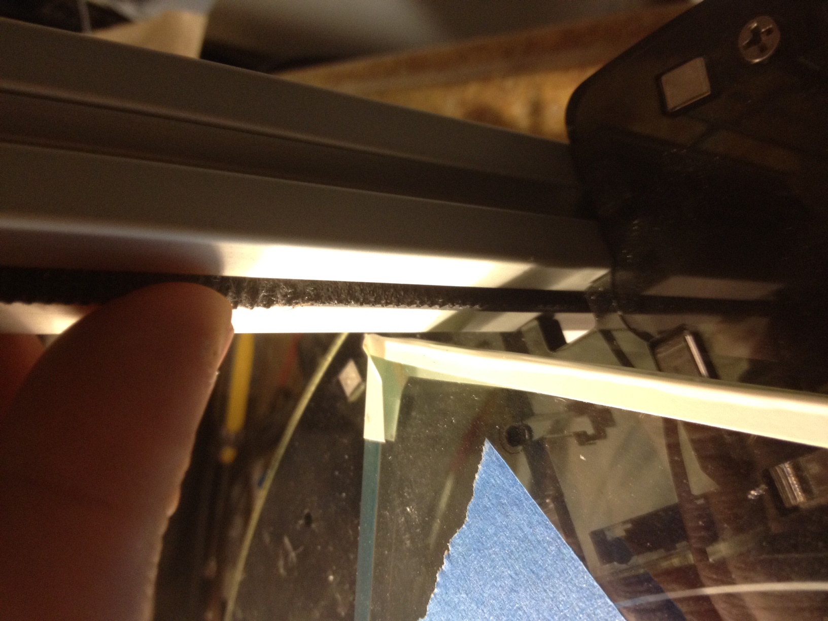

I'm still trying to figure out exactly how it happened but two of my 3 Rostock Max belts have an area on them that has been stripped. After assembly, I was having what appeared to be belt lash issues so I tightened the belts to felt to me should have been tight enough. I continued to have the symptoms of belt lash so I tightened the belts even more. I'm not sure if I went too far or if something else happened. One other strange thing is that I had some motor connector problems on the axes that ended up getting stripped and that was causing the motors to jump. An interesting thing I noticed is that the damage is in exactly the same spot on the two belts, at the motor gear when the head is centered and about 3 in above the bed.

I'm still not confident I know the exact cause but one clue appears to be that the damaged area is near the motor pulley around the time when the nozzle would be at the bed. While I was tuning the machine I had other issues that were causing the nozzle to hit the bed. Maybe during those times the motor pulley slipped on the belt and slowly started eating it. I don't remember any violent impacts though so I'm not sure if this would explain it or not. Maybe a combination of that and having the belts too tight? I ordered new belts so hopefully I'll get them by Tue. In the meantime, I have taken the two damaged ones and pulled them off and changed them end for end. So now the damaged area is running up over the idler. They stretch too much due to the fact that you can see the bare threads and it's pretty weak but it does seem to let me keep printing this way.
Re: Stripped Belts
Posted: Sun Jan 06, 2013 10:14 pm
by geneb
There are a couple of factors that resulted in your eaten belts - I have the same issue.
First off, you may have gotten a set of drive gears that were not wire brushed after manufacture. This will leave the gear teeth very sharp.
The other issue involves what you've already found - the hot end being too close or in contact with the build surface. What happens is that instead of the stepper motor stalling, it starts chewing on the belt. It's my understanding that Delta geometry printers really don't have belt lash issues like Cartesian printers do - if you're seeing something that would normally be attributed to belt lash, chances are pretty good that one or more of the stepper motors is having Belt a La Carte for lunch. :) Because the early gears are sharp, it does pretty serious damage to the belt in a very short period of time.

I am persuaded that my X belt was chewed by the gear during an incident where the nozzle dragged on the build plate for about an inch. I went from tape on bed to tape on glass on bed and forgot to adjust the height.
The nozzle dragged from left to right as it started the loop around a test object, so that's probably why only X was affected. My Z belt has what looks more like chafing along the edge for about 8 inches. I probably won't replace it immediately, but I'm ordering 3 new belts.

I had a few g-code issues that contributed to the mess as well. When you drive the carriage all the way to the top or to the bottom, that loud buzzing noise you hear is the stepper motors eating the belts. :)
Re: Stripped Belts
Posted: Mon Jan 07, 2013 12:13 pm
by Polygonhell
geneb wrote:I had a few g-code issues that contributed to the mess as well. When you drive the carriage all the way to the top or to the bottom, that loud buzzing noise you hear is the stepper motors eating the belts. :)
Then you should turn down the digipots or further tighten the belts, ideally you want the steppers to skip rather than damage the mechanical components, steppers will skip all day without hurting themselves.
Backlash on Delta printers looks a bit different than on conventional printers, but it's still very much present, it causes a layer to "tilt" (be lower at one end) in the direction of motion, but enough will result in the familiar infill not reaching the perimeter issue most associate it with.
FWIW I just checked and on mine if I manually stop a carriage moving, the steppers skip rather than the drive gear eating the belts.

The digipot settings are in configuration_adv.h, I have mine set to 160, the default is 195, but I turned mine down because the stepper drivers were getting too hot, not to prevent the belt skipping. The GT2 belts have a rather shallow tooth profile, so they also have to be very tight to prevent the pulleys from slipping teeth.

The black dust is the remnants of the belt teeth. :)

If the pulley has been manufactured to the specs, it will not have a significant effect on belt wear. The problem is not the pulley teeth wearing the belt, the problem is either the teeth "skipping" over the pulley grooves (which would result in a very obvious motion problem - i.e. the head would not travel in a plane - during the print. Of course, rehoming would reset the axis with the skipped teeth) OR stress put on the belt teeth that happens just below the force required to skip. I suspect this later issue is the major contributor. Skipping makes a thunk sound that is pretty hard to miss.
There are machines out there with 1000s of hours on metal and plastic pulleys (at the same or similar numbers of teeth) and belts with no signs of wear.
