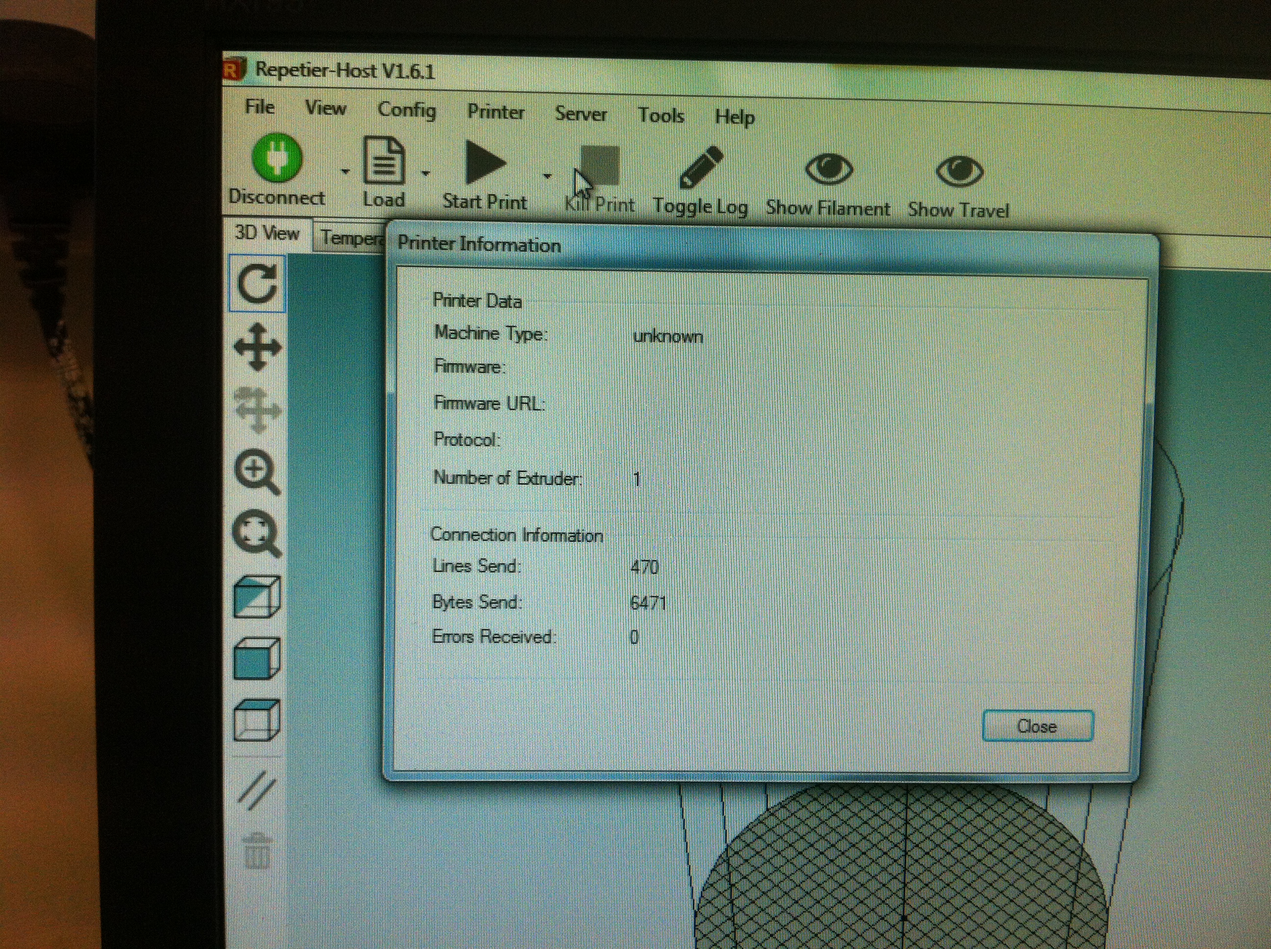

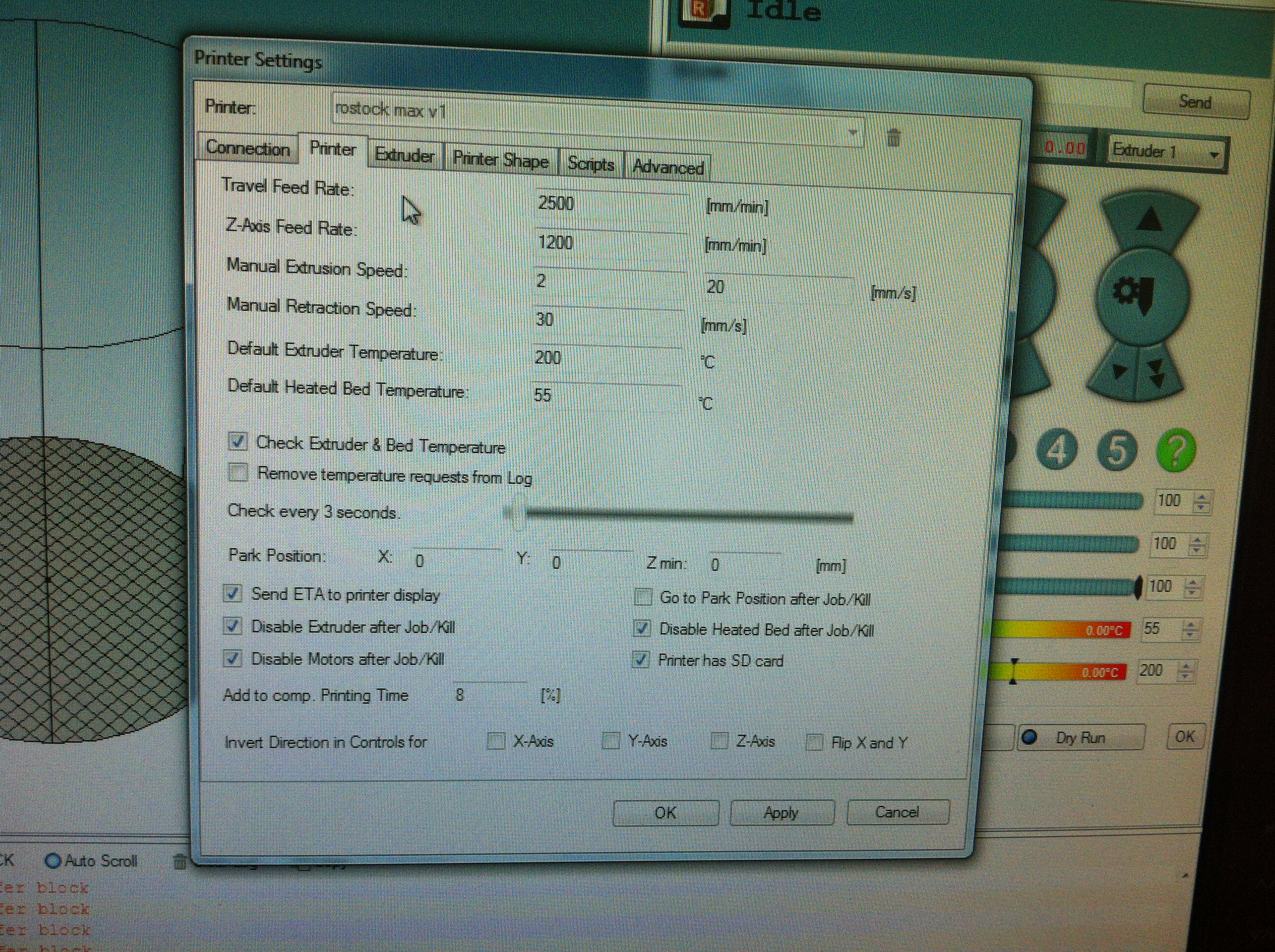

config : printer settings
and printer : printer information

It seems you have a really old version of Marlin or something. This seems likely since it is a V1 and they shipped those with Marlin at the time. You'll have to upgrade the firmware to a newer version of Repetier most likely. Can you post some pictures of the machine so we can see if there are any mods that might need to be accounted for in the firmware config?

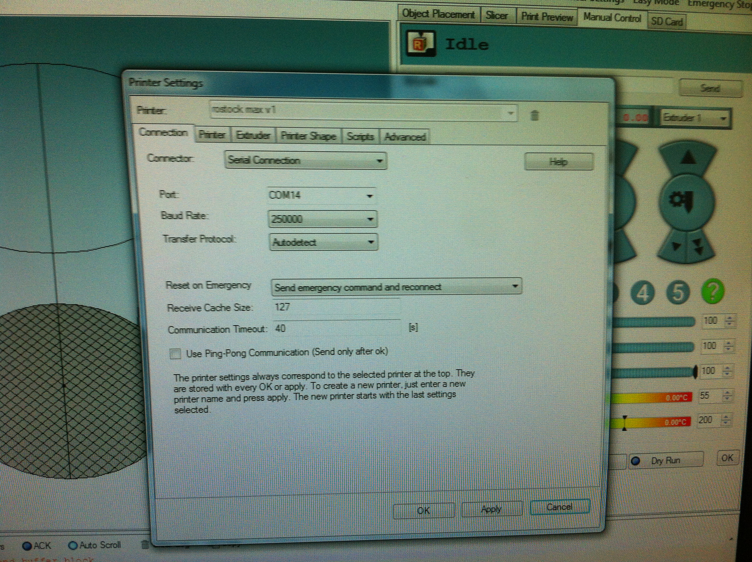

Ok, we need to see what's on the Connection tab please.

connection tab :

Ok, so first up is we need to see if we can get Repetier to connect. Is COM14 the port that shows up in the windows device manager? If not, change that and attempt to connect first - you do have to click the Connect button at the upper left of the Repetier screen. Hopefully you know that
Try it and let us know how it goes then we'll go from there.

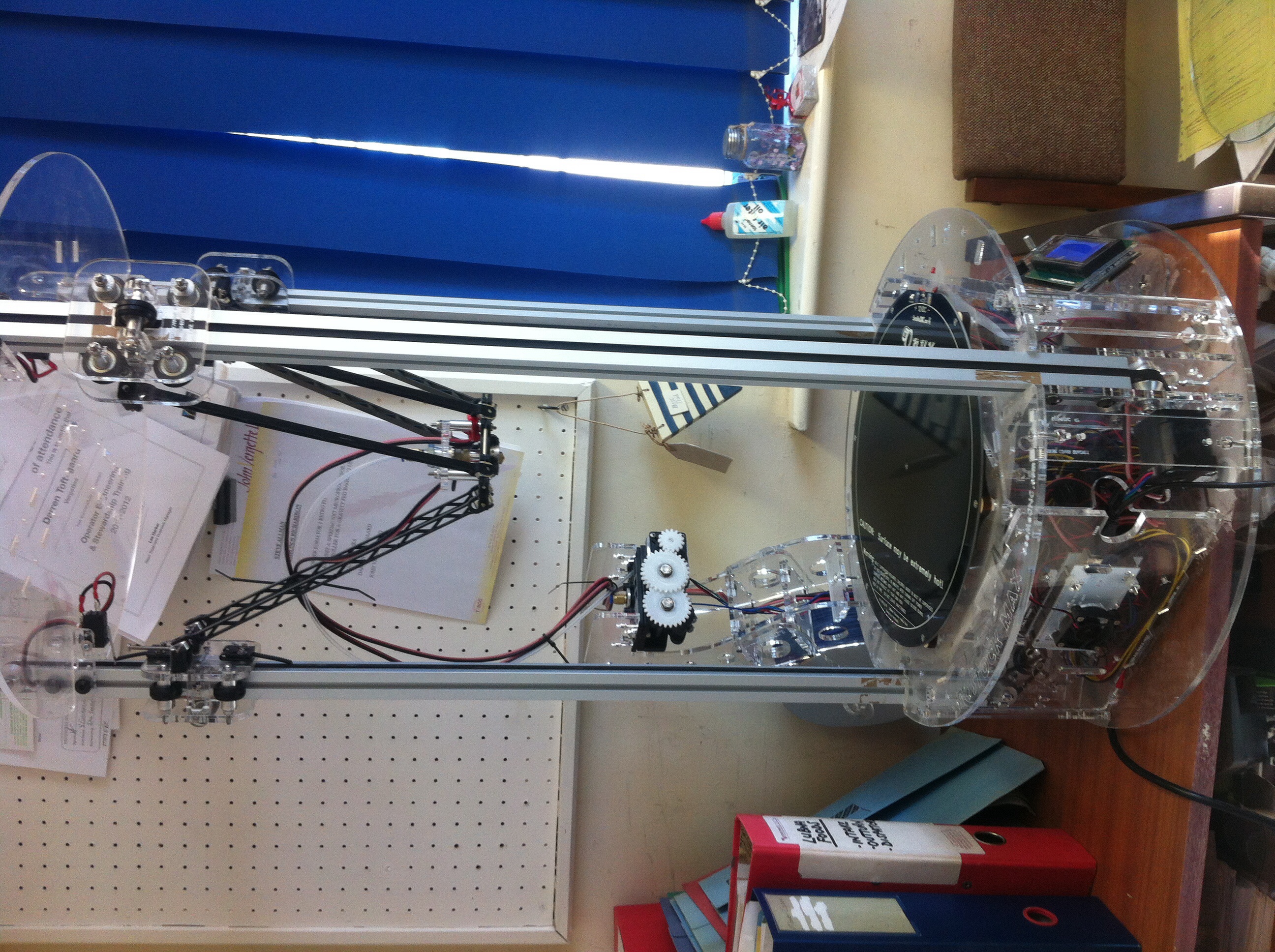

Pic of printer.

That is classic. RAMPS, the Steves extruder and an earlier SMC hotend.

Your picture brings back a lot on memories because my first printer years ago was exactly like yours.
Best of luck with it!

Lol is it really that old. Haha. Is it actually going to be able to work ?
