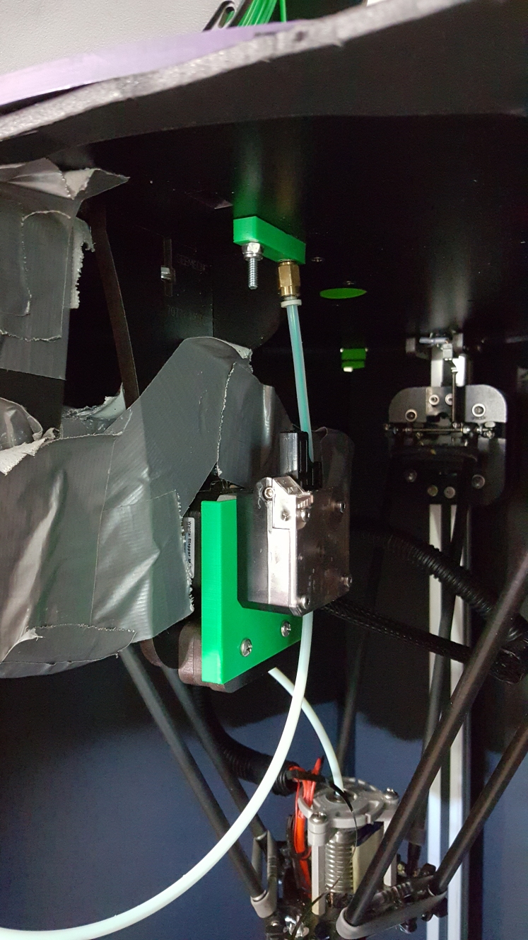

I also have seen the new Titan extruder with a 3:1 gear reduction. The design concept looks great and really thought-out. I have ordered one, to replace my Ezstruder, to give it a shot!

My E3d v6 has arrived, and my Titan extruder will be here very soon.
Anything special about the install for the titan? Looks like it should bolt right on.

kraegar wrote:Anything special about the install for the titan? Looks like it should bolt right on.
Just be sure to remove the collet from the heatsink (if 1.75mm) and use a just barely short enough piece of PTFE, so the Titan will push down on the PTFE and not leave a gap down in the heatbreak.

kraegar wrote:My E3d v6 has arrived, and my Titan extruder will be here very soon.
From the looks of it you'll need to print up at least some form of mounting plate, I ended up pulling the trigger on it and buying one which is supposed to show up today so I'm planning on designing one to mount it right to the same mount points the EZ extruder uses.
The other thing I can think of is that because of the gearing it looks like it'll require reversing the extruder direction and of course changing the extruder steps/mm.

I have my Titan installed now and so far so good, haven't tried any difficult to extrude filament yet though, just some ABS.
One thing to point out is definitely calibrate your extruder steps/mm as the 456 steps/mm that E3D's install guide was way off for me, I ended up with 403 steps/mm

Anyone got a mount print that'll work for the titan to the standard rostock max v2 mount? E3D doesn't have anything up yet.

kraegar wrote:Anyone got a mount print that'll work for the titan to the standard rostock max v2 mount? E3D doesn't have anything up yet.
they do have a 6 hole mount that you can screw in, listed under downloads on the wiki.
Not familiar with the extruder mount of the V2, but if it's the same as the later model V1 then I can upload the one I made for mine.

Yeah, that was my "temporary" air duct to cool my extruder motor cause I was having issues with it getting extremely hot to the touch inside my enclosed build chamber, so I made an air duct with foam board, hot glue, and duct tape with an 80mm fan pulling air though the duct. Some day i'll replace it with a nice printed one, but not till I get around to building a new nicer enclosure around the printer

Shizuma wrote: Not familiar with the extruder mount of the V2, but if it's the same as the later model V1 then I can upload the one I made for mine.
I believe it's the same, if you can upload I'll print and give it a shot. The bracket that e3d has would be a pain to use, I'd rather just bolt on in place of the ezstruder.

Here you go :)

I can confirm this bolts right up to a v2, thanks!

I posted a mount on thingiverse for my v2 - making it very similar mount like easy struder. http://www.thingiverse.com/thing:1511130
I put speed at 403 steps/min thanks for the tip. I'm installing it with a new e3d volcano to do fast low res printing for early prototypes. I hope it's fast enough for the biggest volcano nozzle... any tip would be welcomed.
