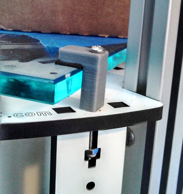

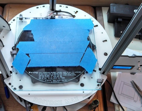

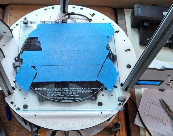

I'm not using the plate that came with the kit. I was assuming that was for PLA and not ABS. Since I have the ONYX round plate I'm using a piece of glass (pretty thick) that I had cut a local shop (since I couldn't find a 280mm piece of round Borosilicate anywhere). I printed some clips to hold it down and I use blue painters tape.
If your first build layer is set so low that your cutting through the painters tape and some of the ABS is getting on the glass I think your doing something wrong. I'm able to reuse the tape that I lay down for 3 or 4 prints most of the time...
I'm only printing ABS and I run the bed temperature at 100 deg C for the first layer and crank it down to 80 for the rest of the print. So far I've printed silver, red and natural ABS and they have all acted pretty similar.
Here is a quick picture of what my setup looks like. I replaced 3 of the 6-32 screws that hold the base together with longer ones so they could serve double purpose for clamping the galss and holding the base together. I only have 2 screws that aren't under the glass holding down the actual ONYX plate since I didn't want the heads of those screws to hold up the glass. I poked my thermistor throught he center hole and RTV'd it in so that it was proud by about 2mm from the surface (so the glass pushes it back down). That way I'm getting a good reading on the bottom of the glass. For what it's worth my IR termometer says the blue tape gets to about 200 deg F when I have the plate set to 100 deg C (212F).
The 2 smaller pieces of tape are there to have a consistant distance to level the print head at all 3 post (FYI)...
If someone has a better system or suggestions for me I'm listenting...
