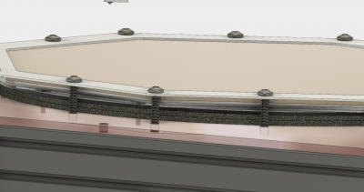

bot wrote:
Holy1 wrote:
bot wrote: I designed custom clamps to hold all around the edges.
Did you want to share those clamps?
I just noticed your post now, sorry. I will definitely share the clamps, but they are for a very specific design, and are cut on a CNC router table, so I'm not sure how useful you will find them. I'll show you a picture. If you want them, let me know and I'll upload some cad files.
I have just read through this thread and the sticky one on PEI and I am fascinated by the process and al the experimentation and your clamp is most ingenious . It would be a doodle for me to make something like this in my shop using something like 6061 T6 Al plate rather than the glass... and for the clamp ring as well the question will be how thick should I go on the Al I wonder if .25" would work with the Max heater; or if getting a high power heater and something like a .5 to even .75 thick Al plate would be best; I think I would also use a Al for the clamp ring as well. Oh just curious what thickness of PEI did you use? the .03"?
bot
Posts: 988
Location: Vancouver
Re: PEI print bed surface experiments
Post by bot »
Windshadow wrote:Even though it will be a month or 3 before I am at the stage where I can be useful commenting on this or other topics I could not resist sticking my oar in.
Surprisingly the clamp I'm using was cut out of .050” 2024-T3. It works very well. It obviously acts as a spring, and deforms slightly, but clamps nicely and evenly and only lifts up a tiny bit on the inside egde. If you'd like, I'll certainly share the files, but it seems you'd be capable enough to design your own if you wish. The PEI I used was 1/8" thick. Using the thin stuff requires it be glued down to a flat substrate. I don't like that, I prefer a thick sheet held in place by mechanical force.
*not actually a robot

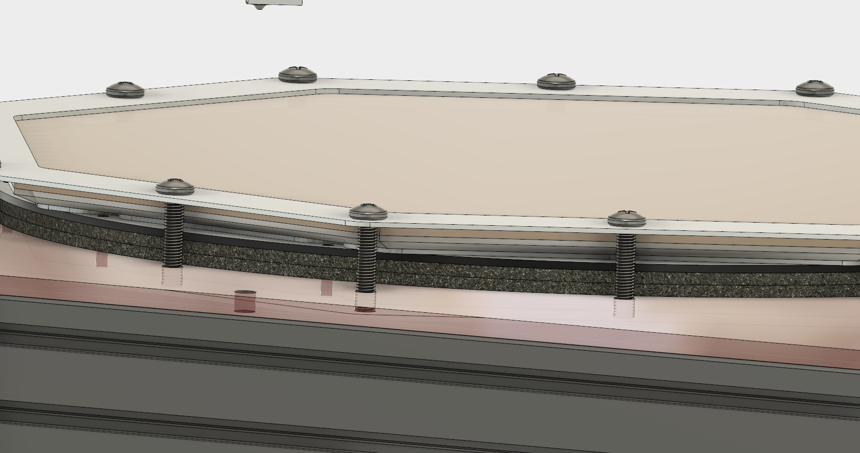

I would enjoy seeing the file it never hurts to see how others solve problems... and right now I have yet to have an inkling of what my problems will be :)

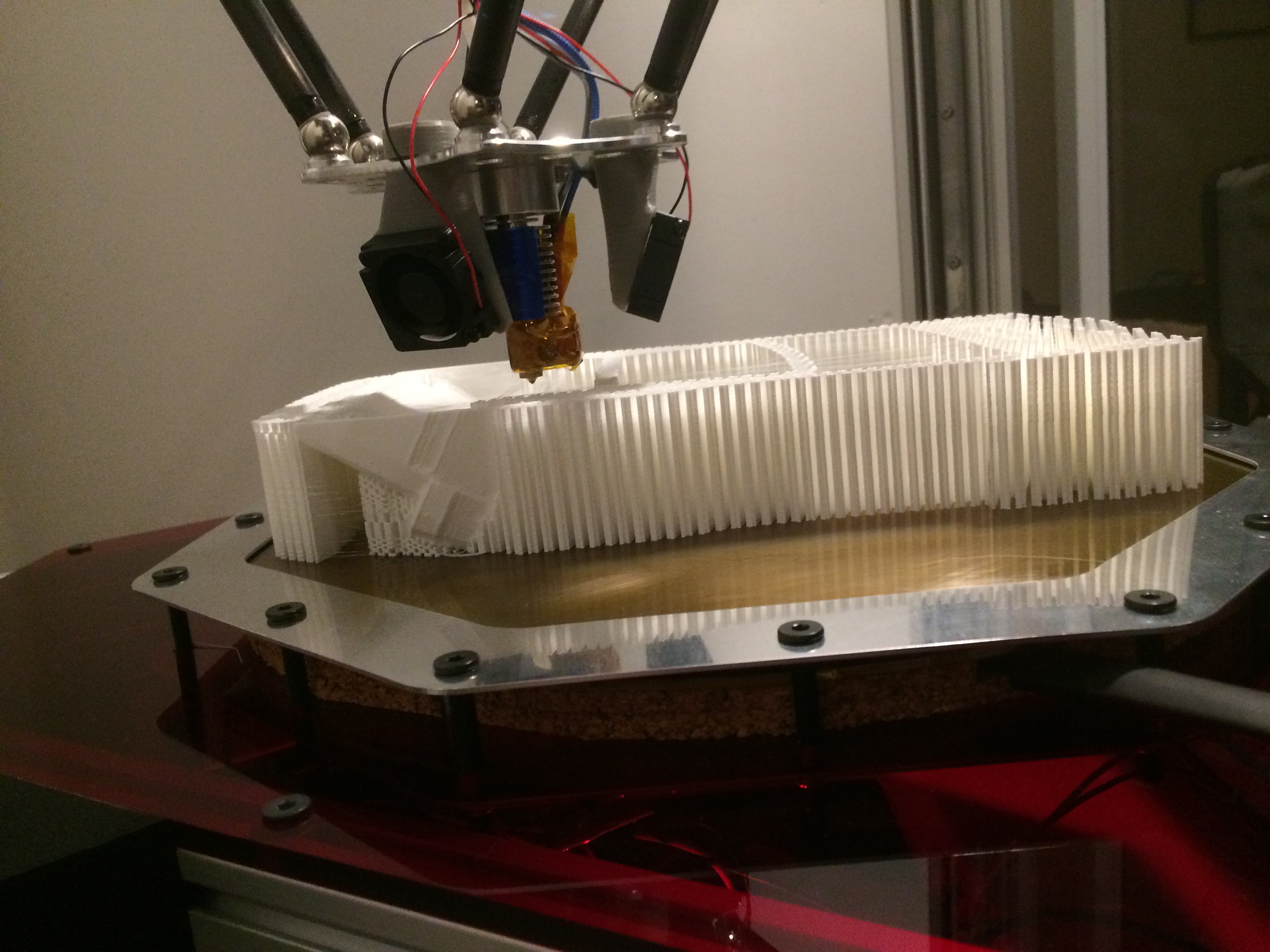

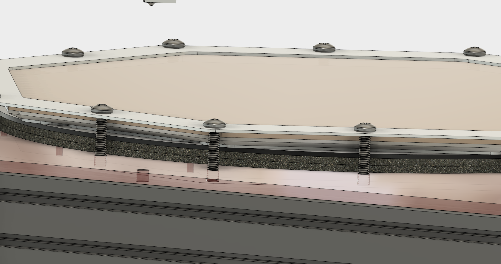

Bot, how did you attach the clamp?
I just removed the cracked PEI (my mistake cracking it) and cut it in half, i used 4 binder clips? folder clamps? to hold it secure to my AL heat spreader. It was not lifting at all and it printed perfectly, but at the end of the print, the sides of the pei had lifted 2-4mm off the AL. Luckily the section with the part had not lifted so i got a good print.
How would I go about attaching the thicker PEI sheet to the bed?
Thanks in advance.
bot
Posts: 988
Location: Vancouver
Post by bot »
Here are the STEP files for the bottom and top part of the clamp. The bottom one has holes for the onyx's hole pattern.
BOT-PEI-ONYX-BED-SANDWHICH-CLAMP.zip
(43.45 KiB) Downloaded 1089 times
The onyx is screwed to the bottom, sandwiching some cork and acrylic. The top clamp sandwiches everything together including the PEI, a mirror, and an aluminum heat spreader.

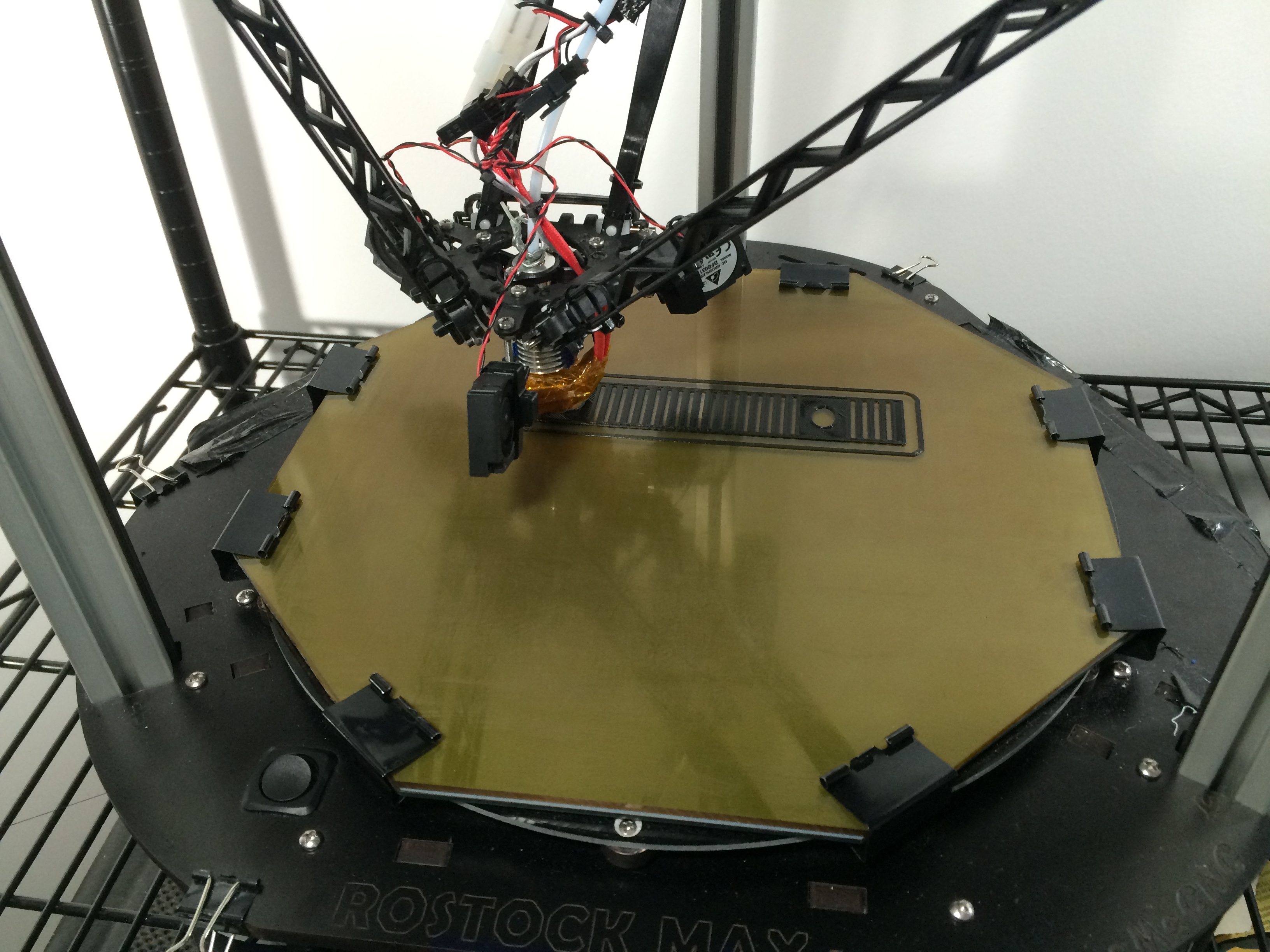

teoman wrote:Bot, how did you attach the clamp?
Thanks in advance.
On my Rostock Max, I just clamp the PEI and a mirror to the onyx bed like so:
teoman
Posts: 1770
Post by teoman »
Thanks for the pictures!
That is how i had imagined it, but seeing the thinner PEI bulge so much i had started pondering if there was something else to it.
