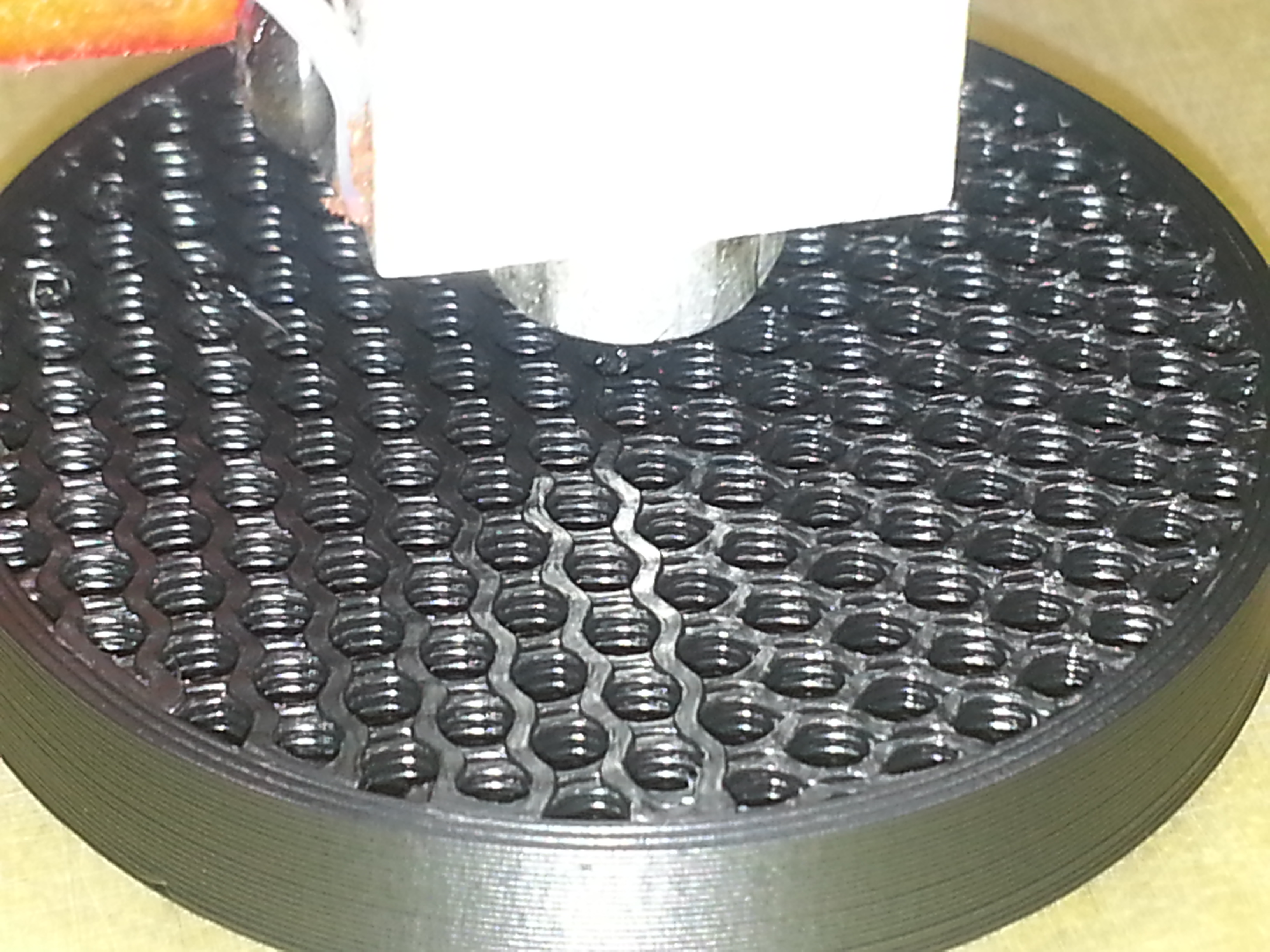

Here bot, its 4.59x6.06, its as close as you're going to get. its not a wide open space like your asking for and I have no need to print one.
Layer 1.
[img]http://i.imgur.com/9sA6BVR.jpg[/img]
Layer 2 starting, already looks almost perfect
[img]http://i.imgur.com/8chtT17.jpg[/img]
Layer 2 done
[img]http://i.imgur.com/gCXPaj2.jpg[/img]
Layer 3, it could be done, but I programmed it to do 4
[img]http://i.imgur.com/xmkWJwn.jpg[/img]

Jfettig, no offence but unless you are willing to print the exact object I told you, your posts are pointless.
I'm not saying that every single print has a terrible top surface, but that specific larger ones did... and until I find out exactly why that is, I can't risk using v3.0
Calm your ego down... congrats, you can print will with v3.0. I hope you're proud. I'm trying to find out why a specific problem occurs...

I believe this is one of the issue in the slice pathing. 1 perimeter I believe is correct, but you can see what happens when 3+ perimeters are added.
[img]http://s29.postimg.org/jv7cbvepz/model.png[/img]
[img]http://s29.postimg.org/7ulwb57bb/1_outline.png[/img]
[img]http://s29.postimg.org/z6h5chc1z/3_outline.png[/img]

That isn't something I'm gonna get hung up about... just space the stars out by the width of the perimeters or something, its purely cosmetic in the first place.
Re: S3D version 3.0 is out
KAS, that is exactly right. That's why it is perplexing that 2 or more perimeters exhibits this problem.
JFettig, this is my design. This is a simple example. I have many more that I've developed over the last year that all have perimeter issues similar to this. Aesthetics are important to me. If I wanted to space the stars further apart I would have done that when I designed this part. I sliced and printed the original design in KISS and had no problems. It is a popular item so I thought I would use it as my entry into learning S3D in detail and, of course, immediately ran into this issue. My goal is not to find a slicer I can use for some things depending on geometry, etc but to find a slicer I focus on 100%. Right now, that is not S3D. If this issue gets resolved, I'm happy enough with everything else I've tested - and I did a lot of work to tweak surface quality, infill, multiple types of infill, etc. I really do like that aspect of the program. I've spaced the stars out in this case in the tests that I did. I can say that even with them further apart than the perimeters, the artifact can appear, it isn't that simple.
Micael, no printing is necessary to test this - it is a slicer issue and you can see the problem in the rendered gcode, no need to print. It's been verified now that this exists in 2.2.2 so no need for spending more time on this.

KAS wrote:I believe this is one of the issue in the slice pathing. 1 perimeter I believe is correct, but you can see what happens when 3+ perimeters are added.
If that's the issue mhackney has there really is nothing to be done on S3D, the only things that would make a difference on the model inside the software is horizontal size compensation, but that doesn't change the way perimeters are sliced, it just changes the size of the stars, there is ofc also rotating the model 90 degrees, but that's changing the surface finish completely.
mhackney wrote:Micael, no printing is necessary to test this - it is a slicer issue and you can see the problem in the rendered gcode, no need to print. It's been verified now that this exists in 2.2.2 so no need for spending more time on this.
Yeah from the photos with the arrows you had placed on page 2 I thought you were having issues related to transition between layers, but the issues shown on the previous images is OFC completely unrelated to that, and having used S3D for the last year, there really is no setting to change the way perimeters are sliced
