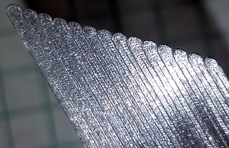

I noticed something interesting when I created a test piece for this vertical banding issue. This rectangle is 60x10x15mm with no top, It's created with a .5mm boarder and printed as a spiral vase.
It appears the bottom 3 layers matched my large parts vertical banding exactly. Both items were printed the exact same speeds (20mm/s) except for the spiral vase option on the test.
Once it starting making the walls it started looking pretty damn good with almost no noticeable banding.
I'm at a loss why it would band part of a print and not the whole thing...
Click the image and zoom in with the Photobucket controls to get a closer look.
[img]http://i482.photobucket.com/albums/rr189/Onuxis/20150211_191606.jpg[/img]

Re: Vertical Banding Revisited
Post by Polygonhell »
Implies it's related to the infill.

Post by lordbinky »
Yep, which leaves you with a couple fixes. One is you can decrease the bulge by increasing your jerk setting (which might also affect the perimeter to infill adhesion) or simply avoid all that add another perimeter that will be less affected by the infill.
Single layer infill no perimeter

Polygonhell wrote:Implies it's related to the infill.
If someone who's having the issue real bad has S3D, they could try the random infill option to see if its banding still, infill is mostly junk with this setting but it will randomize it.

so im having this issue on larger prints with infill... going up to 4 shells one suspects may resolve the issue? thats a sucky workaround though :)

And that's the confusing part for me to grasp. My infill is 10% triangle and it doesn't match the vertical bands at all going up the wall. Matter of fact, you can see the banding in the infill it's self and that's only one layer thick. crazy stuff...

Actually a complex phenomena.. Infill also behave like a support material for the outer layer... You can see that the unsupported area between two infill point may behave differently due to shrinkage etc..

Khalid Khattak wrote:Actually a complex phenomena.. Infill also behave like a support material for the outer layer... You can see that the unsupported area between two infill point may behave differently due to shrinkage etc..
As much as I would like to just take for granted that these evenly spaced bands are caused by shrinkage or support layers/infill, that's to random to produce something so specific and uniform.
For example, in the large part above has been created twice with 10% and 25% infill both covers exactly 5 vertical bands within the same distance. Those 5 vertical bands line up exactly with the part on top that effectively has a solid three layer base with .07 overlap. Now the bottom part infill which produces rather large interior open gaps because of the 10% produces the same vertical banding as the face of perimeter wall at different angles. The small part perimeter produces no vertical banding after it passes the layered base with no infill at all.
The infill of the large part produces a wall the same thickness of the small parts perimeter.
This vertical banding appears to be extremely common throughout the Detla style printers. Obviously it's not an easy fix, and most just seem to loose interest and find a setting that minimizes the effect or deal with it. The only somewhat fact I can find is that it is more prevalent in smaller nozzles. That might be the reason that I did't notice it as much in the stock .5 nozzle vs the E3D v6 .4
Dont get me wrong, while the images I show looks horrible it's because I'm finding that perfect angle this light reflection to show the banding depth. In normal light, it's doesn't look anywhere near that bad.
Anyways, I'm going to keep tweaking my prints until I'm happy with the results then move on to the move difficult filaments. I'm really interested in the wood and metals.
