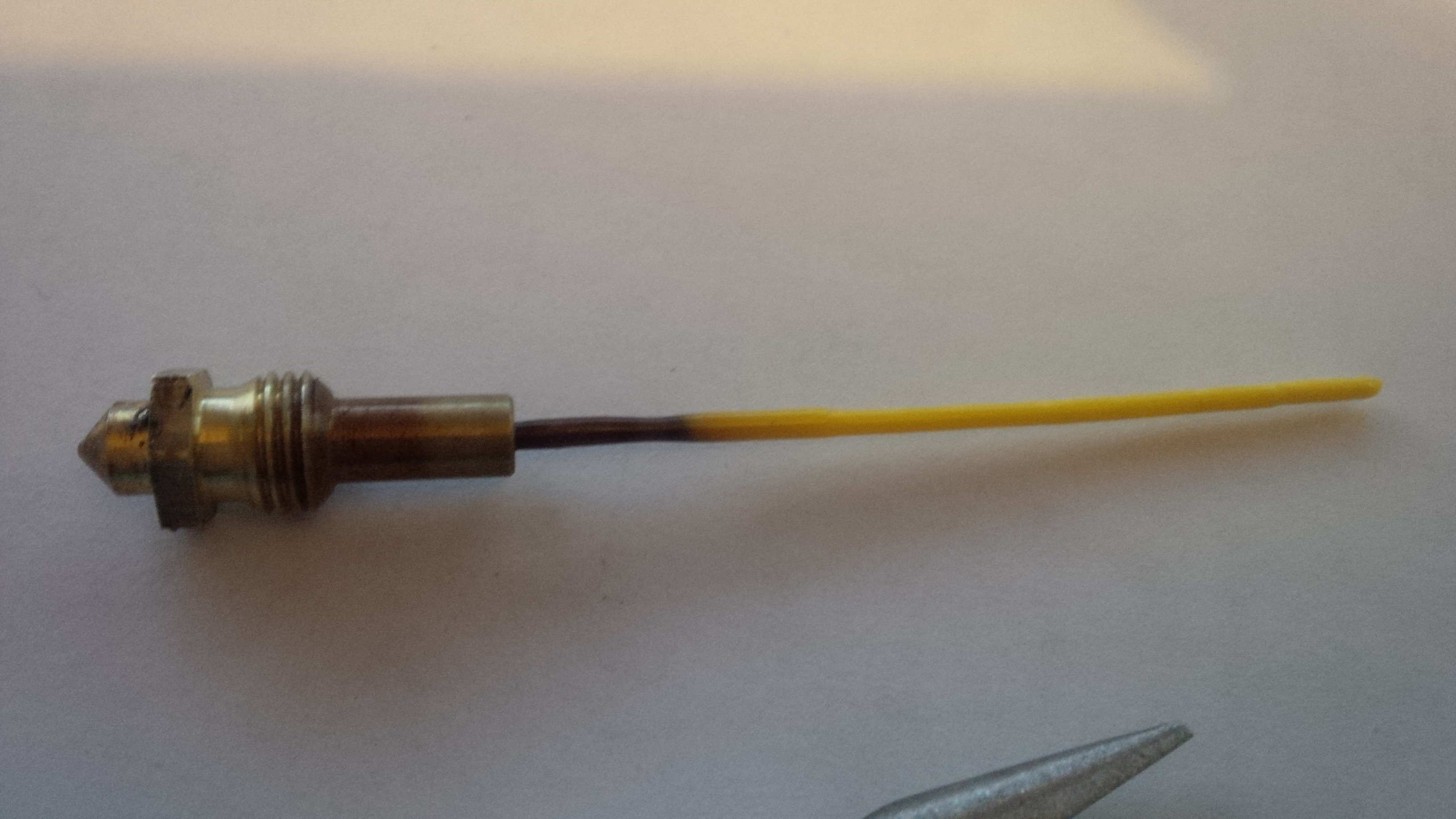

I need some help guys, my filament does not seem to be moving. When I use the manual controls and push the button to extrude 10mm filament nothing comes out, the motor is moving but is hot and it seems to be chewing up the filament rather than moving it. Does it sound as though my hot end is clogged, if so how can I remedy this issue?? I only have basic tools.

AndThenSome09 wrote:I need some help guys, my filament does not seem to be moving. When I use the manual controls and push the button to extrude 10mm filament nothing comes out, the motor is moving but is hot and it seems to be chewing up the filament rather than moving it. Does it sound as though my hot end is clogged, if so how can I remedy this issue?? I only have basic tools.
I'll assume you've played with the temperature. If not, try increasing it 5C or 10C and see if that helps. Assuming you've already tried that, you should disassemble the hot-end and see what you can find.
I'd start by unscrewing the nozzle from the hot-end. Make sure you grip the head with pliers (but don't break any of your connections). Then, I'd remove the push-to-fit connector (with the bowden/filament still in it) by unscrewing it. You should be able to pull out the two PTFE tubes at that point. With those pieces out, I'm guessing you'll see the problem. If not, start posting some pics here and someone will help.

Alright, I took the nozzle off the hot end once everything had cooled down and when I pulled it out 2 PTFE tubes came out along with it and the outer PTFE tube is cracked all the way along the length of it and another smaller spot. The filament had gotten too large to move through the tubes and also looks as though it was burnt. Should I contact SeeMeCNC to have them send a replacement tube or what, I've only had this printing a few days, not even a full week yet! I tried pulling the filament out but it just snapped off right where it starts to go into the nozzle, I dont know how to get it out or even if I should run it with the cracked tube. Here are the pics.

The "crack" in the outer tube is supposed to be there. But it looks like perhaps things have gotten hotter than they should have. I think the tubes are fine, but you'll need to get the filament out of the nozzle. Is that ABS or PLA? There's another thread here: http://forum.seemecnc.com/viewtopic.php?t=2861&p=23067 talking about ways to clean out the filament in there. If it's ABS, you can try soaking the nozzle in Acetone (Nail polish remover), but I'm not aware of a similar solvent for PLA.

by AndThenSome09
it is abs, how long should I soak it?
Re: My first 3D Printer is a Rostock Max -- Build Log From M
Posted: Thu Nov 28, 2013 1:06 am
by dpmacri
Well, probably until it all dissolves :-D. What I don't know is whether or not "burnt" ABS still dissolves in acetone. So you may end up with it mostly removed but not completely. I'm sure others will have some comments to help as well.

The outer tube is "cracked" because the inner tube won't fit inside the outer tube without first slitting the outer tube.
All the hotends, at least from SeeMeCNC have the liners make like that. It would be a good idea to get a perfect measurement
of the length of them while you have them out so you can replace them in the future without too much hassle.
There is no set length of time to soak the nozzle in Acetone but I would try a couple of hours as a start. Happy printing!

After soaking for the night and a few hours with some tiny pick tools and a very small drill bit powered by hand I got the hot end free from the clog! Back to printing I went. I printed out a stretchlet, it came out alright but not the best. The layers around the outside are very thick and choppy, I dont know if its because of the .stl file I began with or the way it was sliced but it did not have nice fine layers like my test cube did. I dont know, here are some pics:

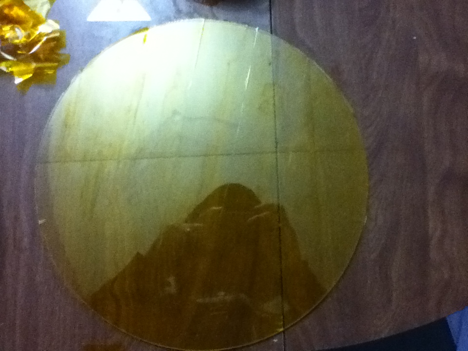

I was having a very hard time getting my first layer to stick fully, I got tired of failed print after failed print so I did some research and came to the conclusion that I needed to cover my glass build surface with Kapton tape and prepare some ABS Juice to use on top of it.
I added about 4 ounces of Acetone to an old fingernail polish remover bottle and cut up about 7 - 8 feet of natural 1.75 mm ABS filament closed the cap good and started shaking the bottle like crazy. Once that was all dissolved in there I had a fairly thick milky looking substance.
As far as putting the Kapton tape on the glass I found an awesome little trick which worked wonders, sorry don't remember where I found out about this but thought I'd share since it works so well. If you want to cover your glass with Kapton tape then this is how you should do it: Clean your glass with alcohol. Grab some sort of plastic Tupperware dish or big bowl, put a few drops of Dawn in there (im sure any dish soap will do its just what I had) and fill it up about halfway or so, doesn't need to be precise. Now pull out your Kapton tape and cut off a length long enough that it hangs over the edges of the glass a little. Take your length of Kapton tape and slide it through the soapy water fully submerging it and taking it right back out, make sure you dip the whole length so its all wet and soapy. Now just shake off whatever excess and apply it to the glass. The water allows you to slide it around and get it into place easily, makes it easy to but each strip against one another. Once in place then take a credit card or some kind of plastic card and squeegee the water and any air bubbles out from underneath it, just like putting tint on a cars windows, leave in place and keep on repeating until you have the whole area covered as you want it. Once it has dried a bit and is sticking in place pretty well then grab a new razor blade and slice around the edges of the glass to cut off any extra. Now you are done and you have perfect tape on your glass with no bubbles or anything. If you want to print on no tape then just flip your glass over. Pretty simple but it works amazingly well guys. Just thought someone may find it useful :D !
Here's a pic of everything you'll need:
Here's the finished product:

By the way, between the Kapton and a layer of ABS Juice my prints stick absolutely wonderfully now! It's like night and day, before a lot of times it wouldnt even print the ring around the object without lifting and being drug all over the place just building up on the nozzle, I think that was why my hot end clogged in the first place because there was so much built up on the nozzle that it had nowhere to go and ended up backing up into the chamber. But we r all good now!! :D Im happy with the results, and my parts are coming out spectacular! :D :D

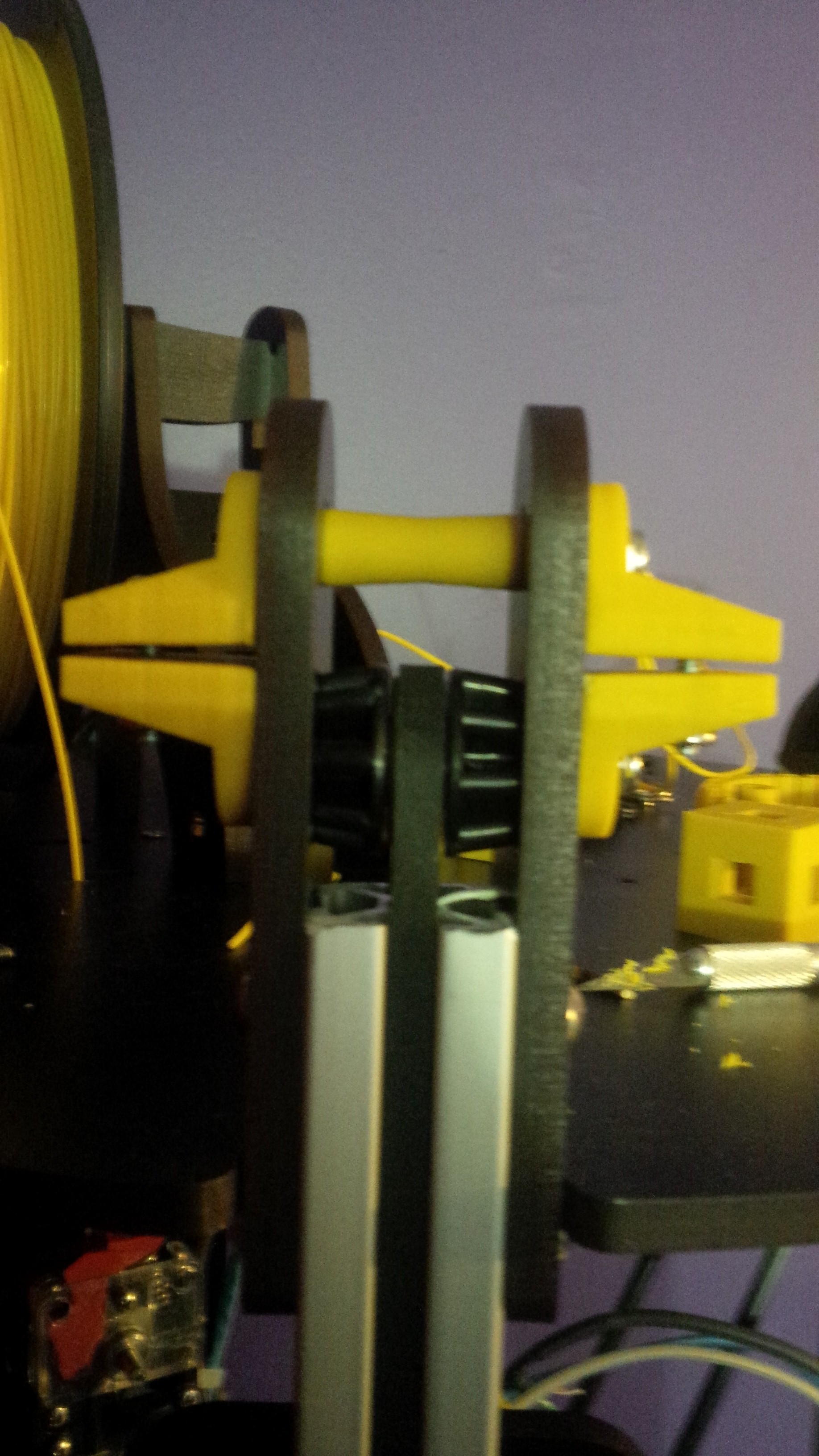

Since I am printing so well I decided to implement http://www.thingiverse.com/thing:87463 and I believe it came out good. I like this idea for the belt tensioner and think I will make the printed parts a nice blue to go with the colors on my Midnight Delta. Here is a pic of one of the tensioners:

Glad to hear the re-calibrate worked out so well. I'm thinking I'll recheck mine after another week or two to allow for any settling in on the machine.
Coincidentally, I am printing those tensioners right now too :)
