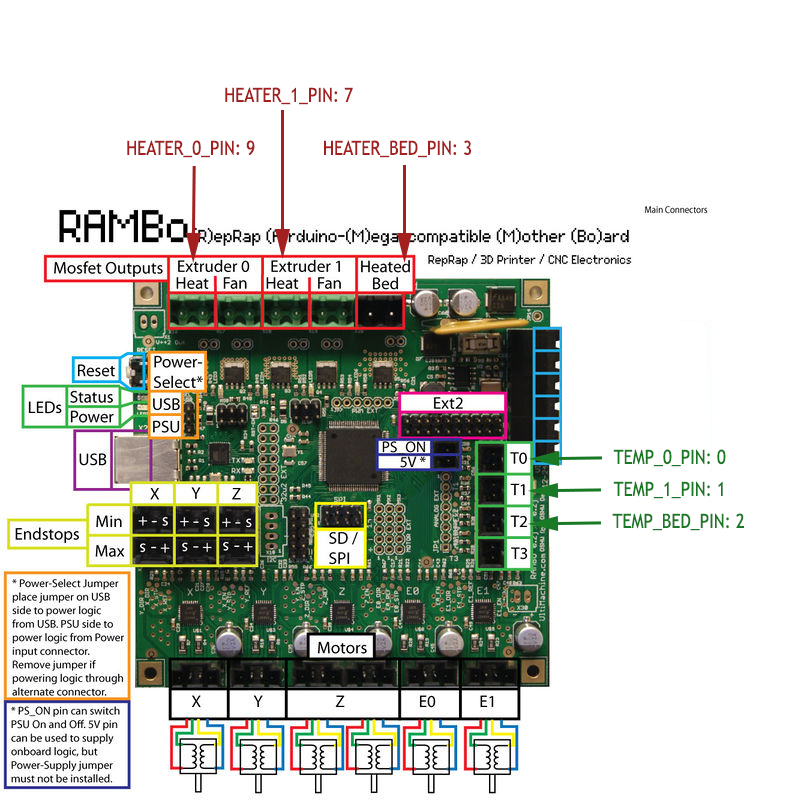

Code: Select all
#define NUM_EXTRUDER 2

#define MOTHERBOARD 301

#define EXT0_X_OFFSET 0
#define EXT0_Y_OFFSET 0
// for skeinforge 40 and later, steps to pull the plasic 1 mm inside the extruder, not out. Overridden if EEPROM activated.
#define EXT0_STEPS_PER_MM 92.4 // EZStruder

#define EXT0_TEMPSENSOR_TYPE 97
// Analog input pin for reading temperatures or pin enabling SS for MAX6675
#define EXT0_TEMPSENSOR_PIN TEMP_0_PIN
// Which pin enables the heater
#define EXT0_HEATER_PIN HEATER_0_PIN
#define EXT0_STEP_PIN E0_STEP_PIN

// =========================== Configuration for second extruder ========================
#define EXT1_X_OFFSET 10
#define EXT1_Y_OFFSET 0
#define EXT1_STEPS_PER_MM 92.4
// What type of sensor is used?
// 1 is 100k thermistor (Epcos B57560G0107F000 - RepRap-Fab.org and many other)
// 2 is 200k thermistor
// 3 is mendel-parts thermistor (EPCOS G550)
// 4 is 10k thermistor
// 5 is userdefined thermistor table 0
// 6 is userdefined thermistor table 1
// 7 is userdefined thermistor table 2
// 8 is ATC Semitec 104GT-2
// 50 is userdefined thermistor table 0 for PTC thermistors
// 51 is userdefined thermistor table 0 for PTC thermistors
// 52 is userdefined thermistor table 0 for PTC thermistors
// 60 is AD8494, AD8495, AD8496 or AD8497 (5mV/degC and 1/4 the price of AD595 but only MSOT_08 package)
// 97 Generic thermistor table 1
// 98 Generic thermistor table 2
// 99 Generic thermistor table 3
// 100 is AD595
// 101 is MAX6675
#define EXT1_TEMPSENSOR_TYPE 97
#define EXT1_TEMPSENSOR_PIN TEMP_2_PIN
#define EXT1_HEATER_PIN HEATER_2_PIN
#define EXT1_STEP_PIN E1_STEP_PIN

Code: Select all
#define HEATER_BED_PIN 3
#define TEMP_BED_PIN 2
#define HEATER_0_PIN 9
#define TEMP_0_PIN 0
#define HEATER_1_PIN 3
#define TEMP_1_PIN 2
#define HEATER_2_PIN 7
#define TEMP_2_PIN 1
Code: Select all
#define EXT0_EXTRUDER_COOLER_PIN 8
Code: Select all
#define MOTOR_CURRENT {175,175,175,200,200}
i think the UM rambo labeling and the RFW labeling arent exactly the same, what tipped me off was during the configuration tool... i about had a brain aneurysmmhackney wrote:Hmm. Why would the bed heater and thermistor be the same as heater 1? That doesn't make sense!
my peek fans i have wired to 12v directly, layer fan will go on fan0 because that is the one kisslicer will control with the M commandsmhackney wrote:In looking again, I have heater and thermistor 1 configured to pins 7 and 1 so that is the same. Where do you have yor fan hooked up to use pin 8?
sweet cause i need some help with kisslicer...or should i just change back to slic3r?mhackney wrote:Ok, I now have two operational extruders and hot ends. All it took was a blown fuse on RAMBo, a blown cartridge heater, several new gray hairs and a few hours of wasted time scratching my head.
I suspect there was a chain of events that started with a bad or blown heater cartridge on my second hot end. That may have occurred when the fuse blew or it blew the fuse. In any event, I was able to isolate it. Luckily I have 15 of these things that I bought last year cheap! A bit of soldering and my configuration worked just fine. Now to dial it in.
