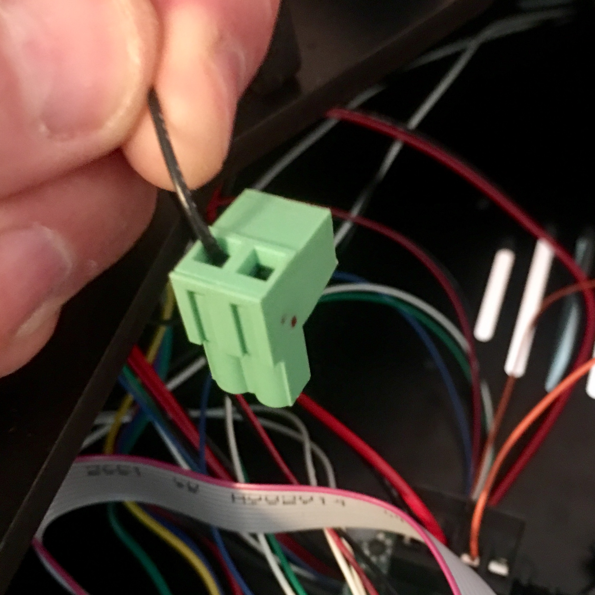

MOD: thermostatically controlled heatsink fan

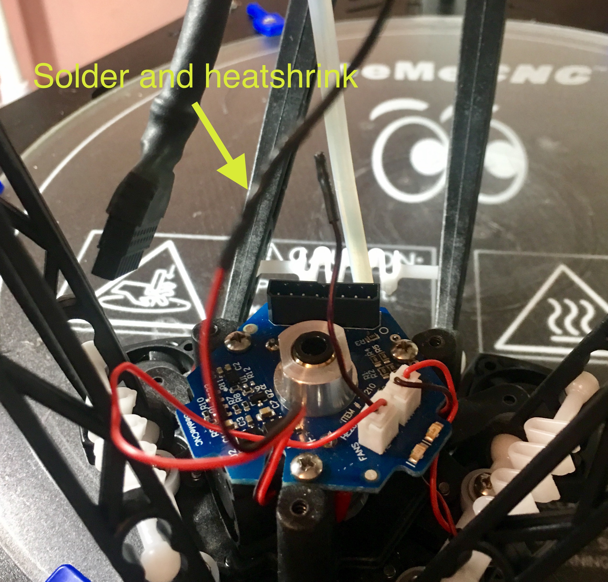

The heatsink fan on my V3 is noisy, very noisy, and it stays on all the time. So this mod will automatically turn the fan on and off when the temperature gets above/below 40°C. All it takes is:
  • 4' of 22 gauge wire - black
  • one 2 prong electrical connector - there should be an extra in the RAMBo connector bag that came with your V3 - see photo below
  • a few minutes of time
First, you need to heat up the hot end and pull the filament completely out of the Bowden tube. Then turn it off and let it cool down. Once it is below about 75° turn off your printer. Make sure you turn off your printer (yes, I repeated myself, it's important.)

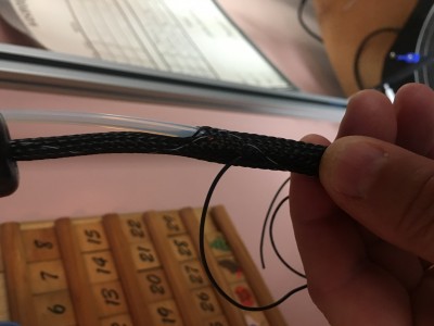

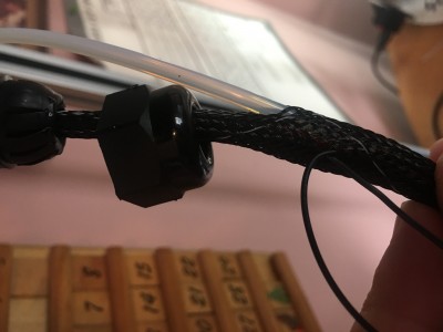

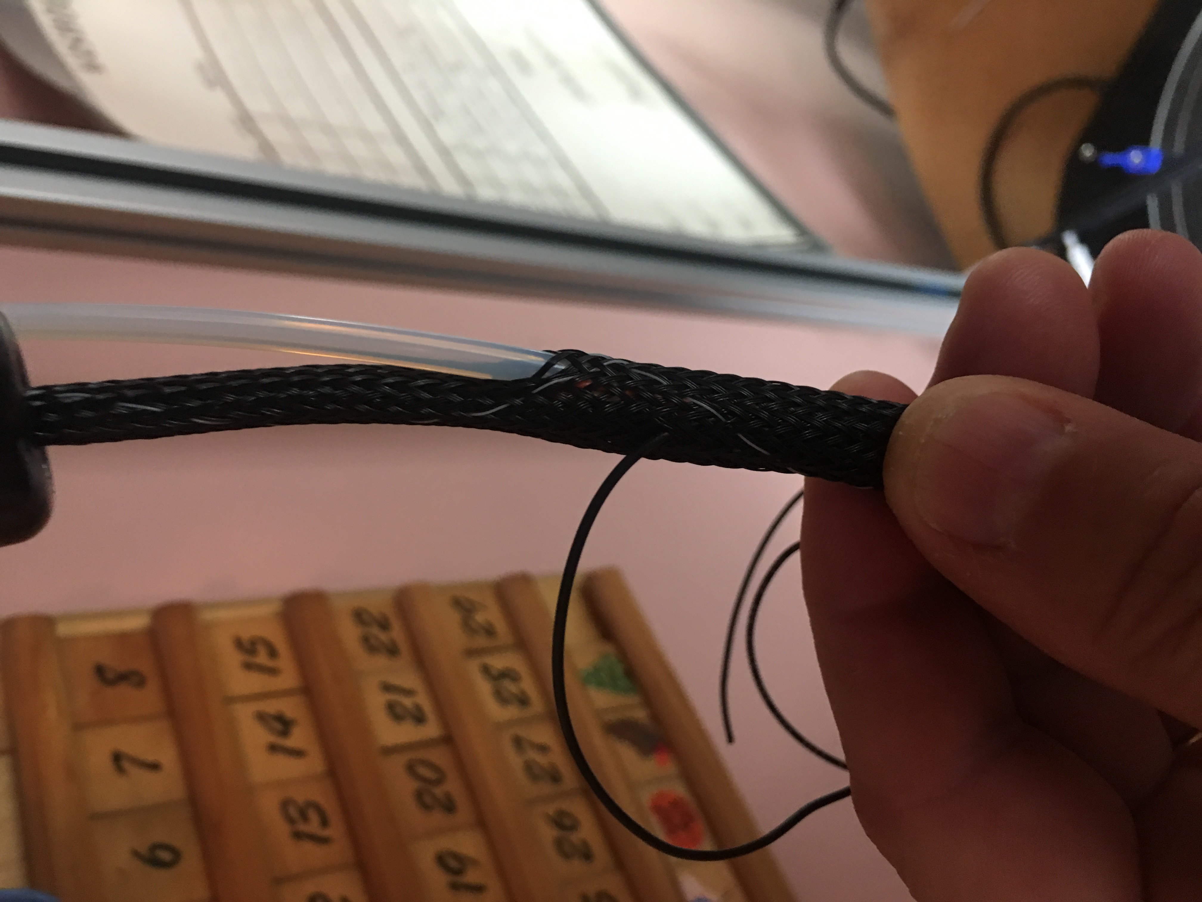

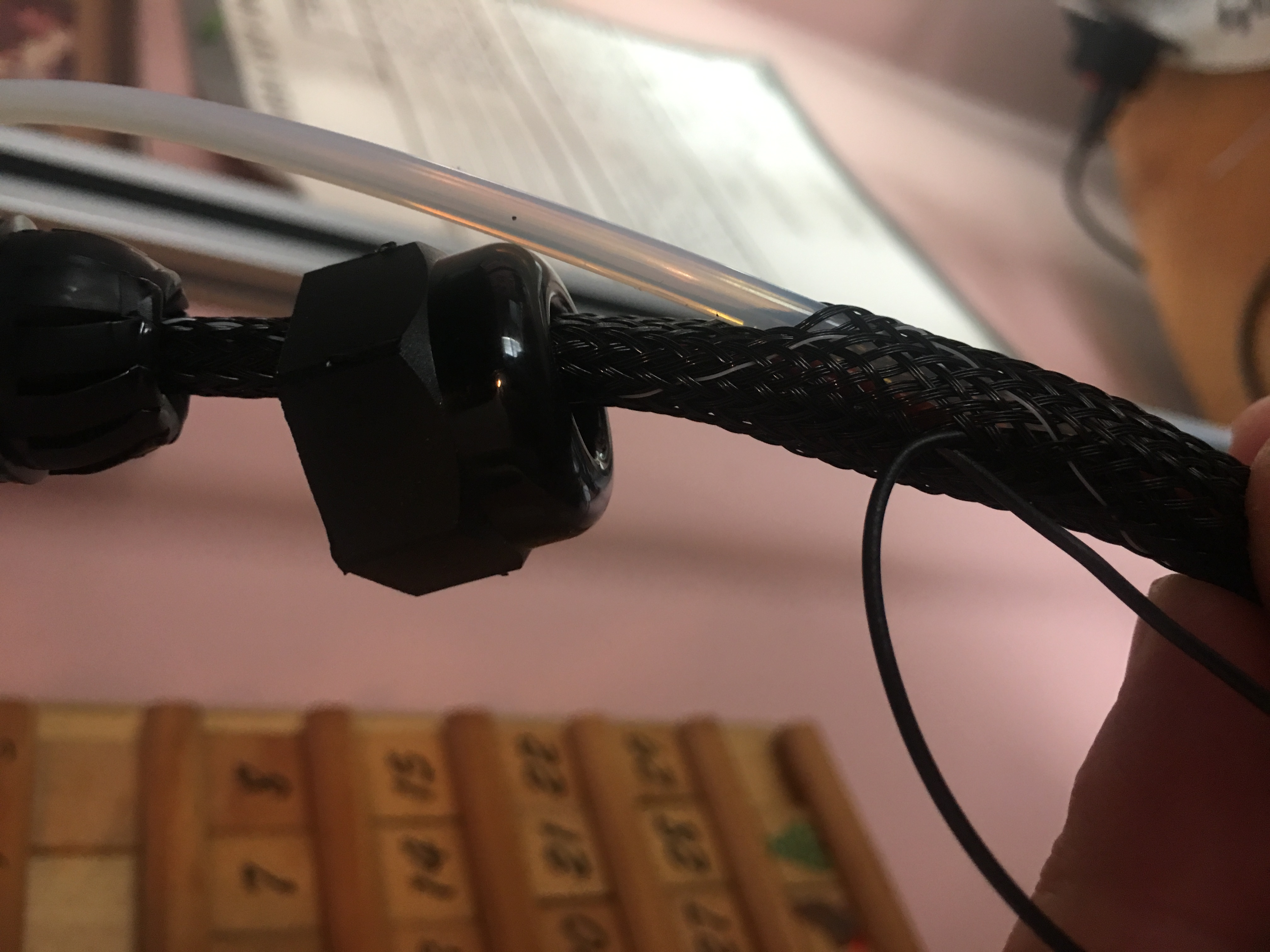

Disconnect the Bowden from both the extruder and hotend. Don't loose the little lobster claws! Now pass the 4' of wire INSIDE the Bowden from the extruder end until it comes out the bottom. Grab the wire at the top and then pull the Bowden out of the whip sleeve from the bottom near the hot end. Yes, you are removing the Bowden from the sleeve. This is all to make sure the thin black wire is inside the whip sleeve. If you come up with an easier way, chime in! Once the Bowden is removed, you have to put it back in exactly the way it came out (except without the wire inside it!). When you are done, you'll have the wire and Bowden inside the whip with the wire coming out of the side of the sleeve at the top like this:
Next, unscrew the bulkhead connector that the sleeve and wires run through in the top plate. Also remove the top access plate.
You need to loosen it all the way in order to get the wire through the fitting. Carefully find where the wire comes through the sleeve braid and push the end back through the same opening and up towards the top. The idea is you want to get this last foot or so of wire inside the sleeve, through the fitting and out of the end of the sleeve in the top. It is much harder to describe than it is to do! Once the free end is visible in the top, grab it and pull out some of the slack but make sure NOT to pull the lower end up into to the sleeve.

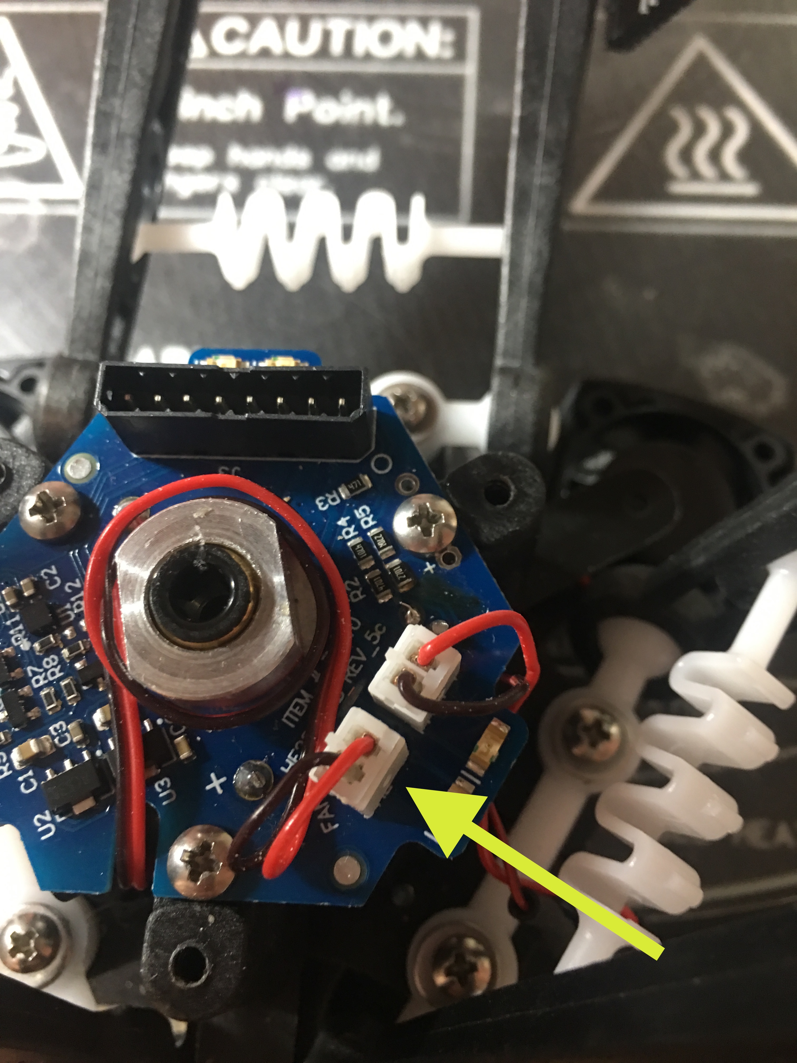

Now we are going to remove the connector and top cover from the HE280. Inside looks like this:
The arrow points to the connector for the heatsink fan. Clip the black wire about 2" from the connector. Then strip and solder the other end to the new black wire. Make sure to put on a piece of heatshrink tubing before soldering. There will be a short (2") black wire hanging free off the connector, that's correct. I like to put a little piece of shrink tube over the end to insulate it.

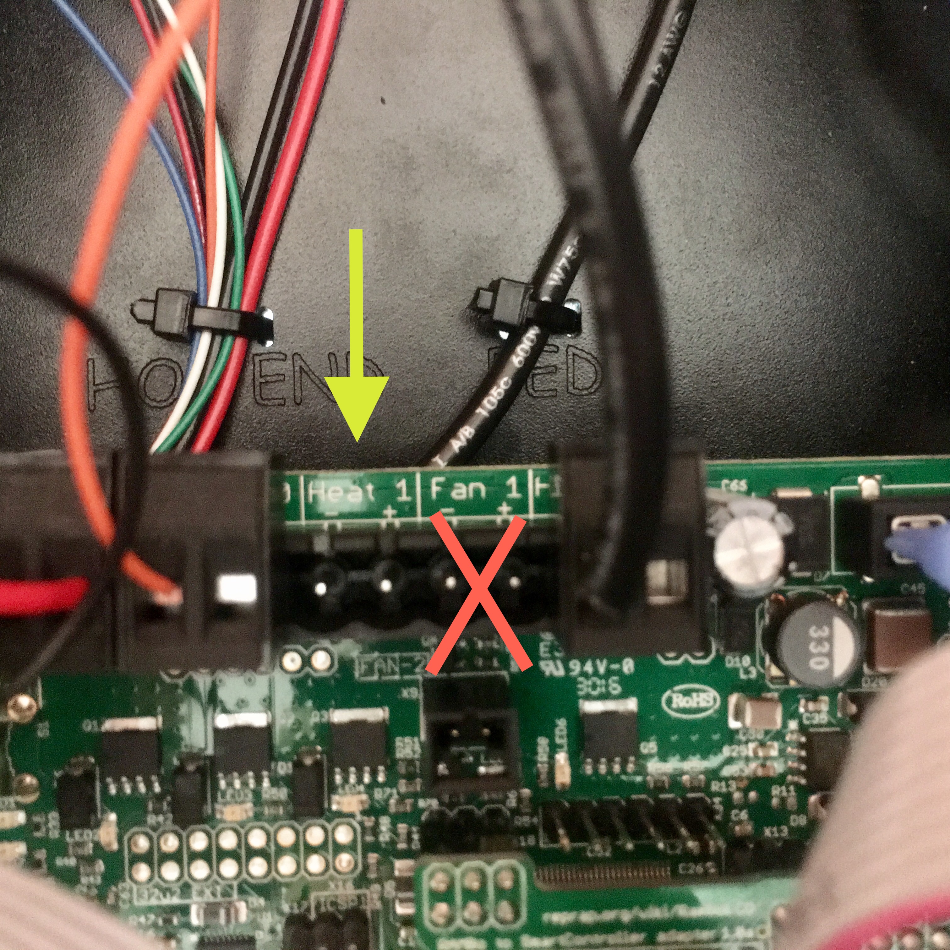

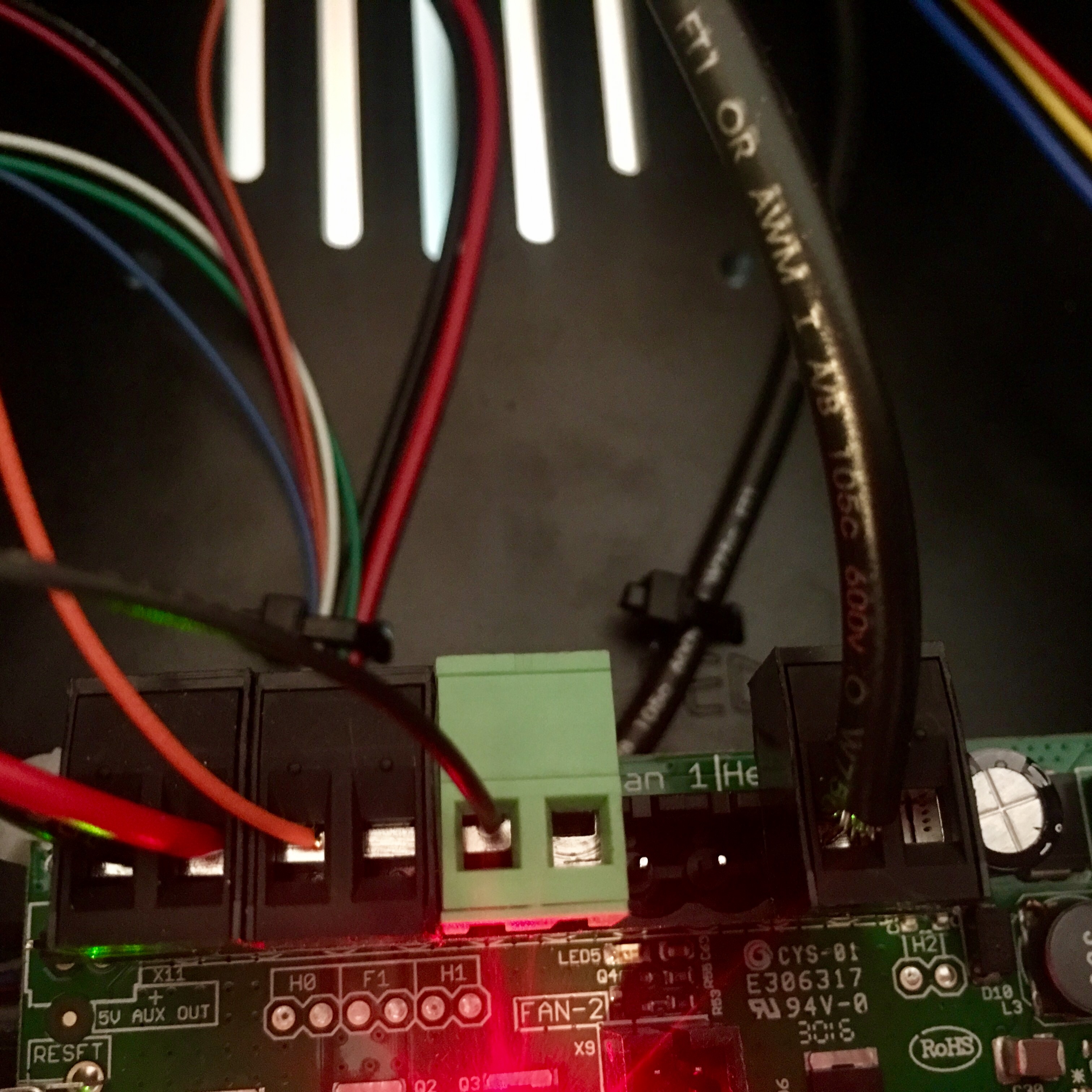

Now we are going to make the connection to RAMBo. The new black wire inserts into the connector like this:
The connector fits into the top edge of the RAMBo at the position marked Heat 1 - NOT Fan 1, like this:
That's it! Before buttoning everything up, test to make sure the fan comes on at 40°. You will need to plug in the HE280 connector and then turn on the printer. Then set the hotend temperature (LCD display is easiest) to 150°C (the minimum it lets you set). Watch and listen. If the fan comes on at 40° turn the hot end off and turn off the printer.

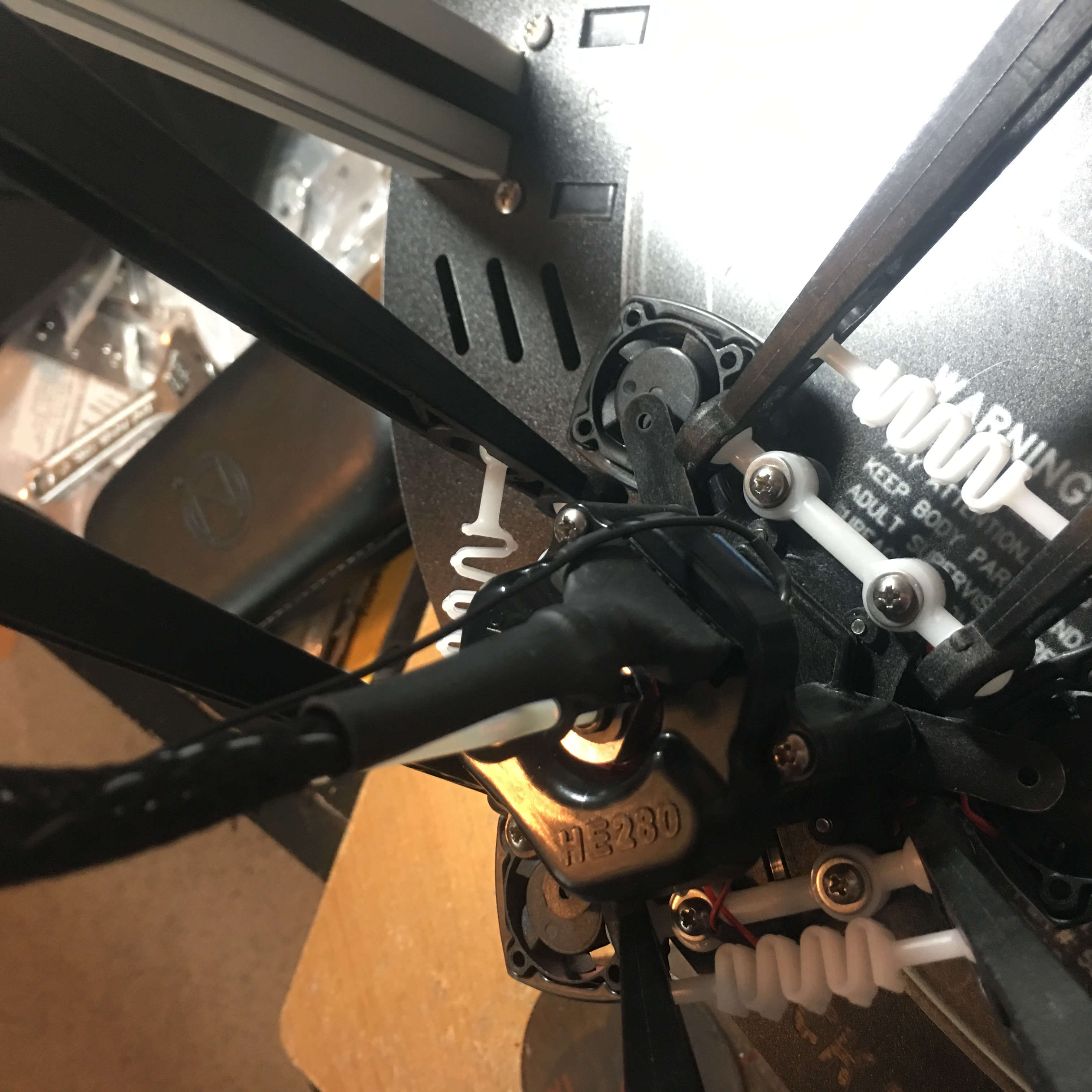

Now you can reattach the bulkhead fitting. Reinstall the HE280 cap, making sure to route the new wire so it does not interfere. Connect the connector to the HE280. Finally, connect the Bowden at both ends. Make sure to seat it all the way into both the extruder and the hotend. Here's a trick, after you insert the little lobster claw under the locking ring, push the tube in firmly, it should insert another mm or so. This insures that it is properly seated all the way. Here's the hotend completed:
Although not totally silent, the V3 is a LOT quieter now when it's not printing. This mod is certainly worth an extra wire!

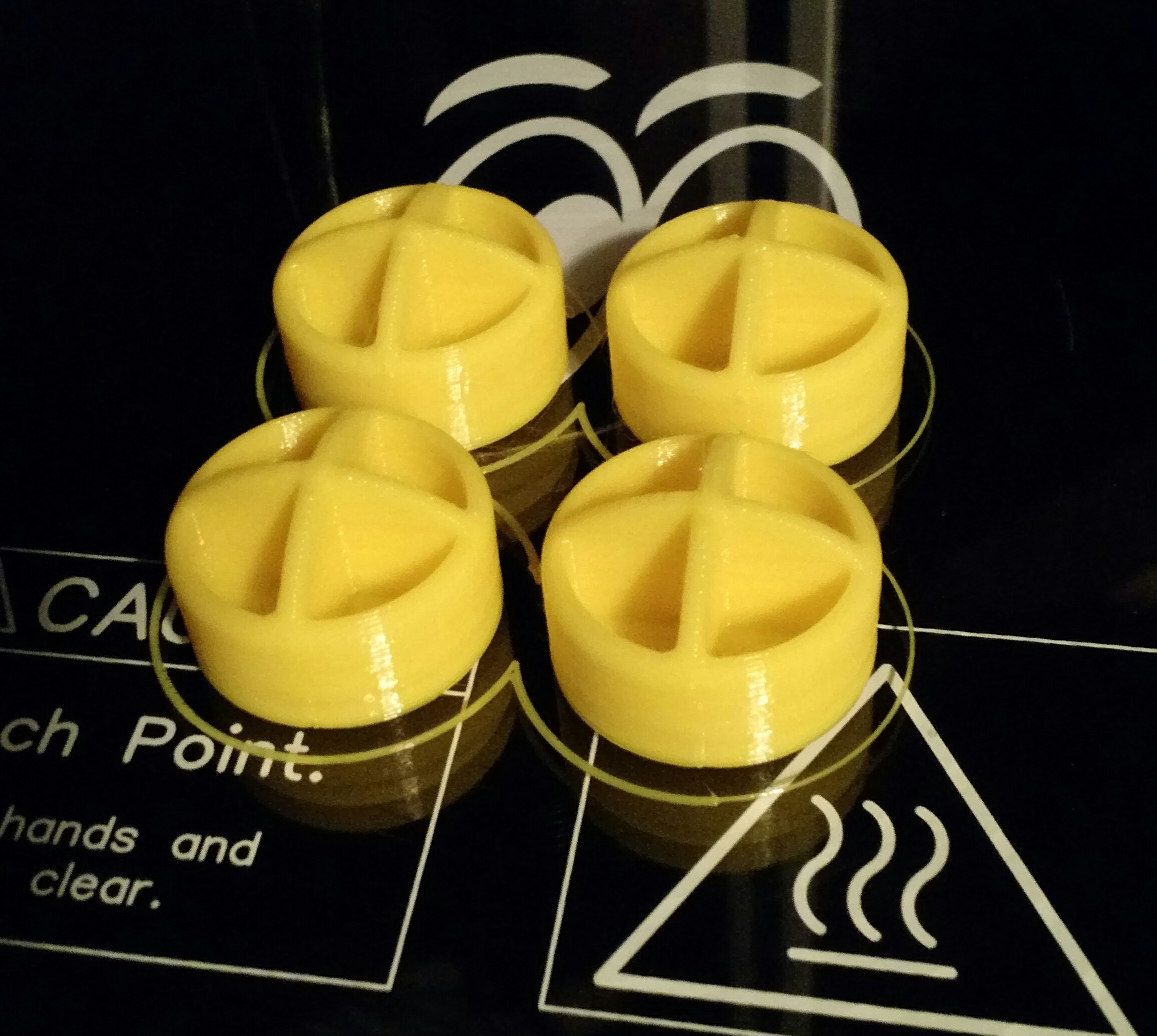

Calibration UPDATE

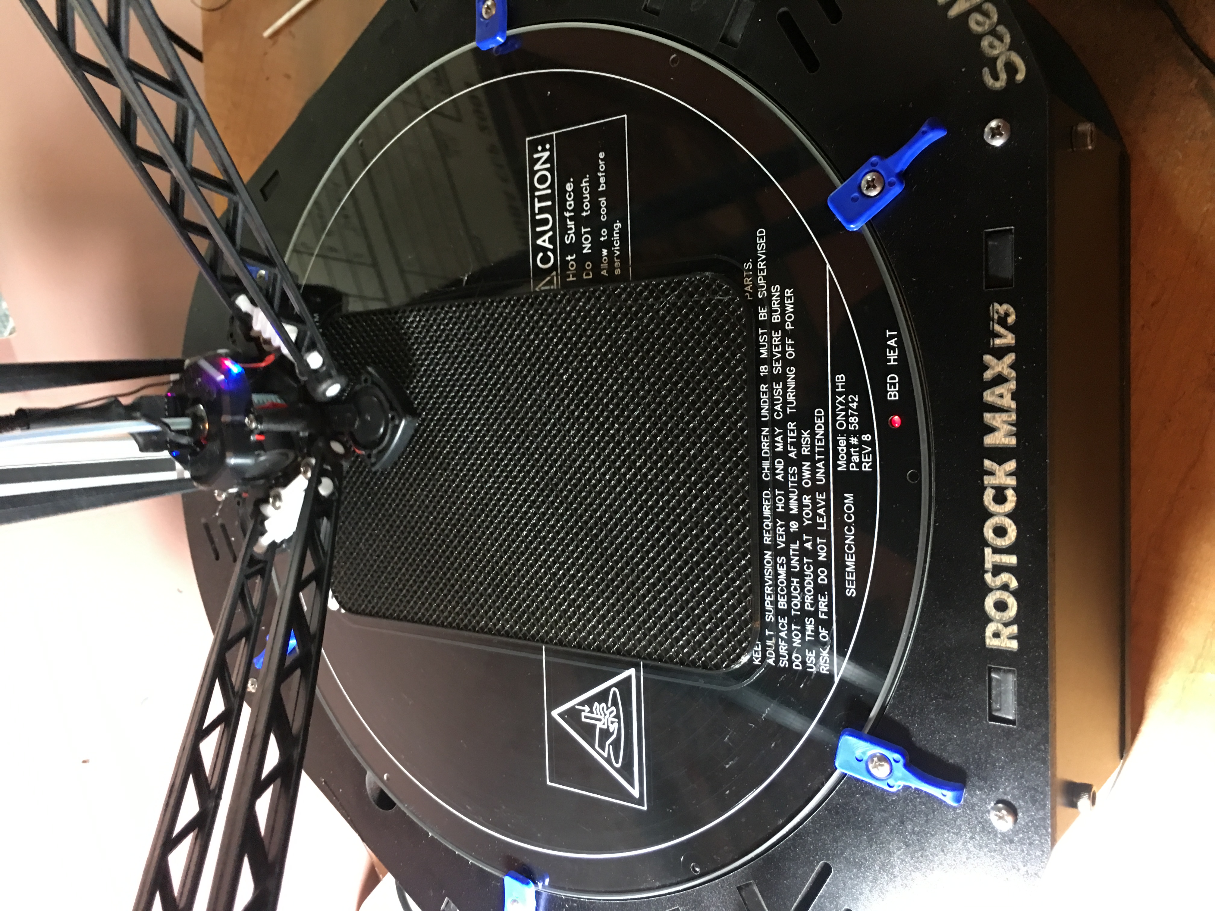

A few hours ago JJ (SeeMeCNC) texted me a photo of a 10.5" diameter (9.5" ID) single layer ring he printed on a V3 that was as perfect as a photo could show. That got my attention so I asked some questions:
bed surface? Clean borosilicate, cleaned with hand soap and water
filament: SeeMeCNC gold nugget PLA
temps: 60°C bed, 210°C hot end
So, that got me thinking I need to test on plane glass. I removed the FlabLam (it peals off easily) and then scrupulously cleaned the glass with soap and water and dried with lint free paper towels. I carefully reinstalled the bed making sure everything was clean and flat. I then ran auto calibration dead cold (well, room temperature dead cold!).
I drew up a 10.5" OD x 9.5"ID ring 2 layers tall for testing (attached to this post). I sliced this using my published KISS profile but set the temps as JJ did.
I made a few printer deity incantations and hit print in OctoPrint and watched, in amazement, as a pretty good first layer went down. My Z height was a little off which made for a thin first layer but it went down well enough. More experiments going on now. I am printing a rather large box for my CNC Router speed control now and after adjusting the Z the first layer looks even better.
This zip contains the STL and a KISS sliced gcode file you can print on a stock V3.

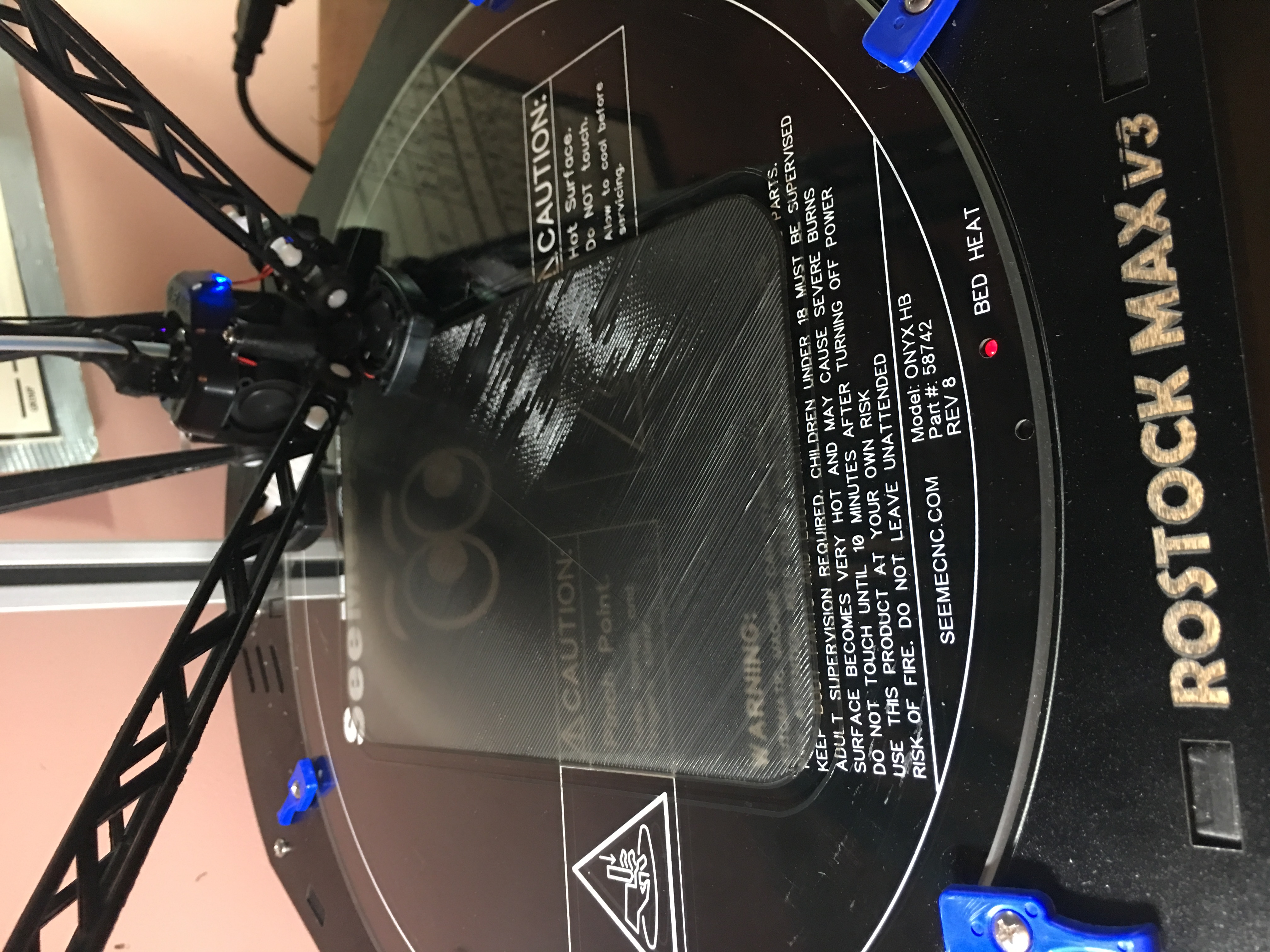

This is a print that I did overnight. Info: MatterSlice, MatterHackers PLA, 220C extruder, 65C bed, Rostock V3 stock nozzle (dia set to 0.4mm), 0.3mm layers, max print speed 35mm/s. When I used 0.5mm as the nozzle dia, I got problems with the extruder motor slipping and bouncing when printing _much_ slower...

mhackney wrote:They do have the now available for the HE280 and have been for a week or so. You never know if one got inadvertently shipped!
I didn't realize, but I stand by my assertion, picking a larger nozzle size should not cause slipping/skipping extruder issues.
All it does is increase the required extrusion rate and from 0,4 to 0.5 we're talking ~25% volume increase at 0.3mm layers.
It might exacerbate an issue, but if the extruder is skipping, either you're printing too fast for the temperature or the motor isn't providing enough torque.
Usually I'd assume a temperature issue, until it's been eliminated as an possibility either by pushing the filament by hand or ideally by verifying the hotend temperature with a thermocouple.
Pushing by hand is sufficient to rule out temperature, but it's so hard to explain to people what it's supposed to feel like.

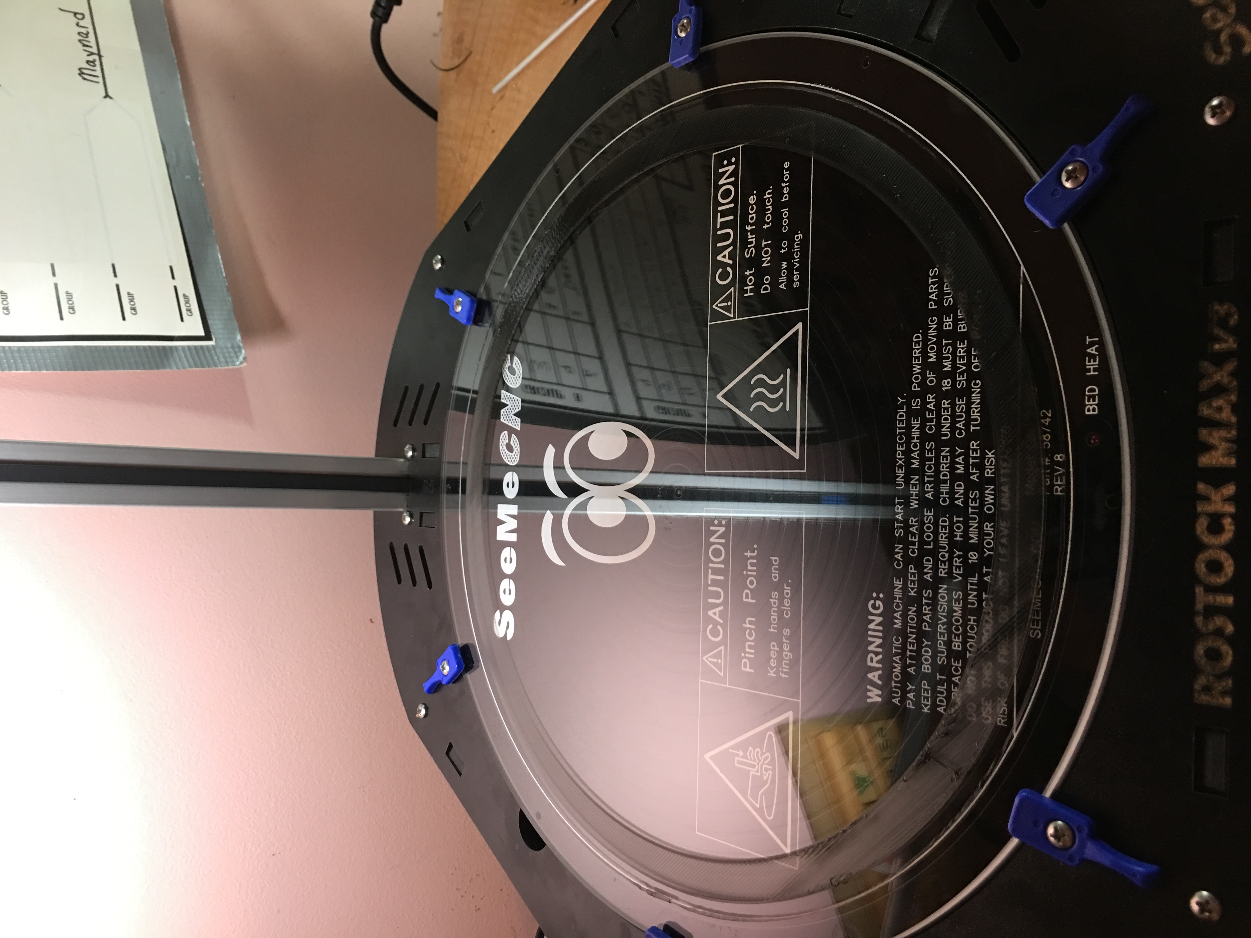

Here are a couple of large parts that I'm printing on bare glass. The first layer went down nicely on these.

Thanks for the tough love. I tore down, cleaned, and reinstalled my hot end. Then, using mhackney's instruction from a previous thread, locked the Bowden tube to the hot end with the lobster claw and then pushed it in again (felt like I got 1mm or more or additional tube into the hotend). After that, PLA flows great at 210C. No issue with the extruder stepper slipping or bouncing. I am now able to print at the default speeds (up to 40mm/s) with no problems.
MHackney,
I tried out your eeprom settings for changing the calibration circle as well as installing washers and using 3-point bed suspension. It got me a much better auto-calibration, but I still needed to do fine adjustments by the end-stop screws. I also used your suggestions to tune my retraction.
At this point, I'd say that I'm up and running. Now to learn more about printing support material. :)
