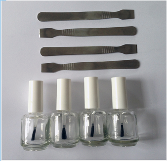

Where you get those tiny spatulas?
The BONE ZONE build thread.
Re: PEI print bed surface experiments
I bought about 500 of them and had intended to sell them when I was doing the aluminum heat dissipators last year. I'll bring some to the BBand3D meeting in January.
