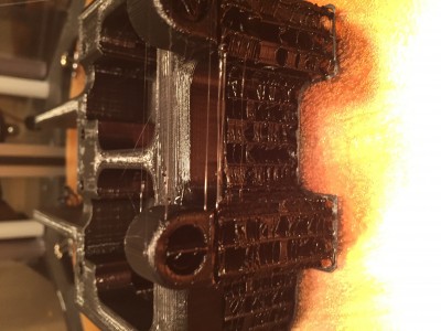

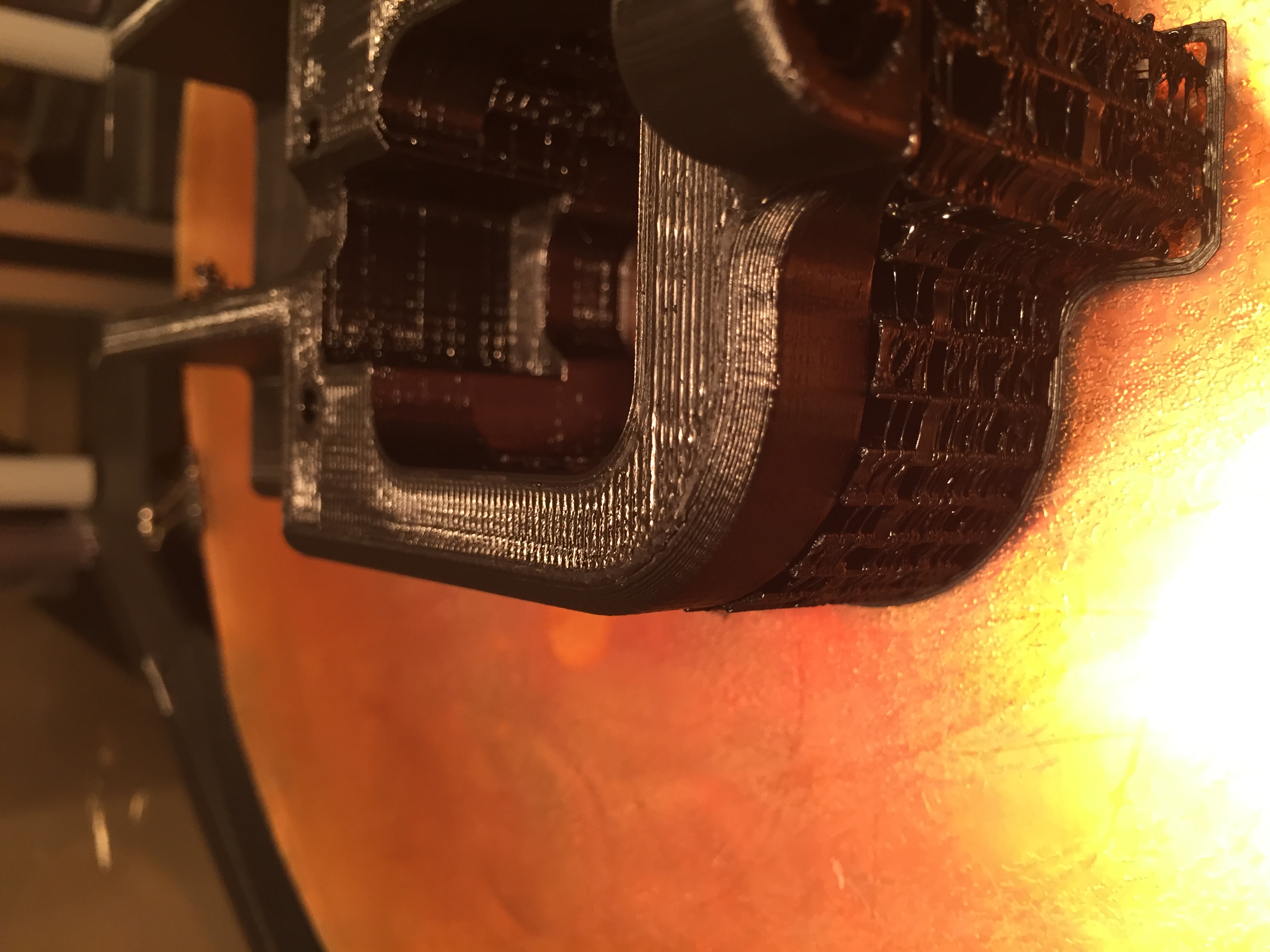

Received a couple of new roles of filament. Black was delayed so I used transparent black. Not totally excited about the "color" but I'm am going to use these. Maybe I'll reprint them later but at 50 hours of printing it can wait.
Everything fits very well. Now I just need to decide when to pull the Rambo and make the change.
Of note I printed this with the Diamond and so far it has been really good. You can see I did have a shift in the print which is unusual for me???
I haven't had the stringing with the Diamond as Polygonhell has mentioned before. I am printing something in Black today which is more complicated and we will see what happens with stringing (I will post settings at the time).
Re: DUET and DUE PANEL
I've been looking for a transparent black like that! Please let me know where you found it.
JFettig
Posts: 821
Location: Minnesota
Post by JFettig »
Looks similar to the hatchbox transparent black I got a year ago or so.
Yeah, the HB looks right, thanks!

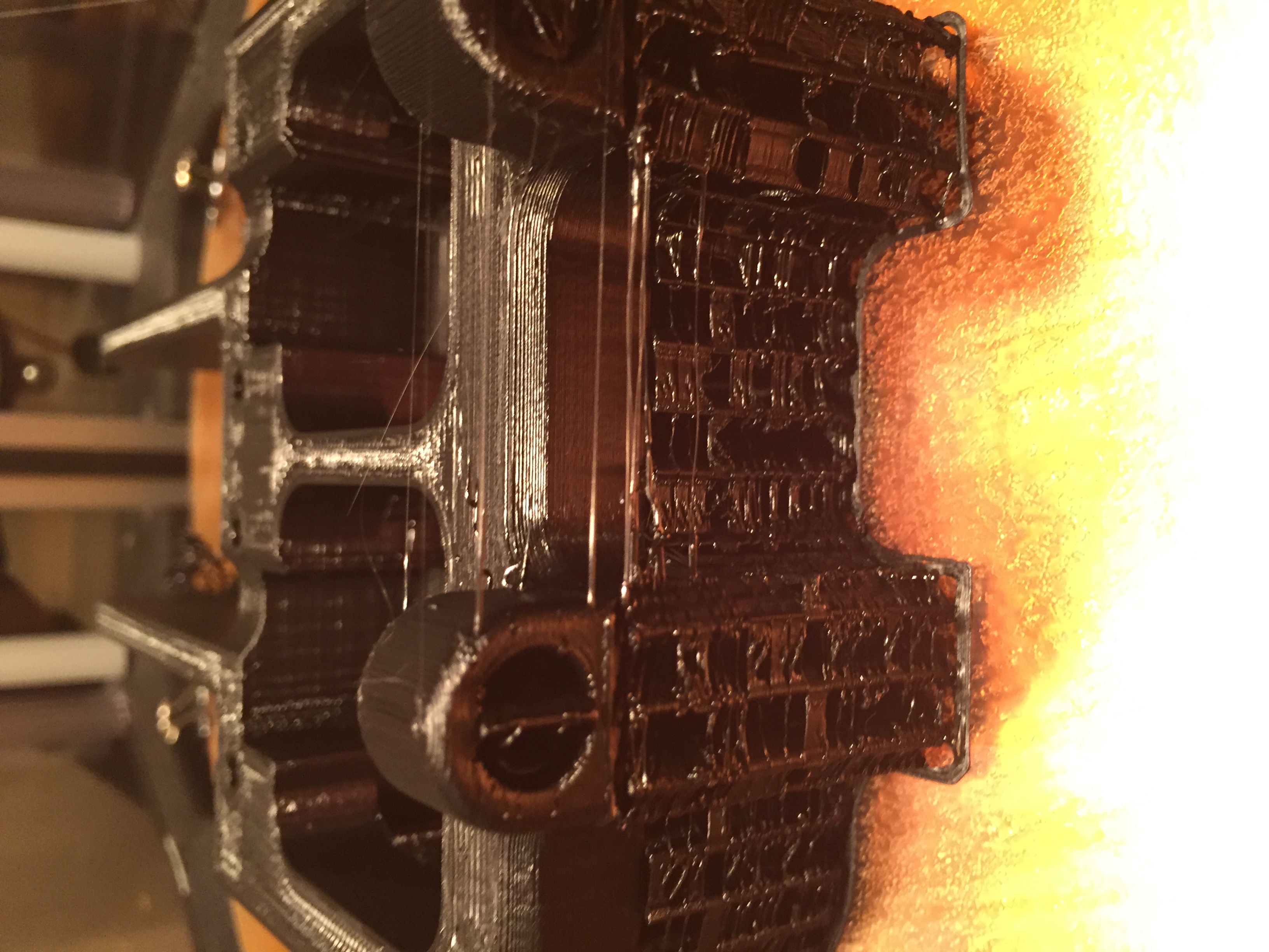

Just finished printing jfettig's double extruders that I modified (stretched the lower part such that it will rise above the upper plate). There was some stringing and mostly in my support material. However, I did forget to drop the temp of the HotEnd from 230. I will print something else at a lower temp and see what happens.

Here were my setting for the double extruder bracket:
Filament: HatchBox 1.72 ABS Black
Bed: 100 with PEI
Diamond HotEnd: 230 C (I usually run my HotEnd at 222)
Extrusion multiplier: 1.0
Frist layer 0.2 mm
Perimeters = 3
Top and bottom layers = 4
Touching Skirts = 3 loops
Infill: Triangles at 30%, 40 mm/sec
Speed: Inside=40 mm/s, Outside=35 mm/s, Support material = 40mm/sec,Bridges = 60 mm/sec, Travel - 300 mm/sec, First layer = 12 mm/sec
Retraction length on move: 6.8mm
Z-Lift: 1 mm
Extra length on restart: 0.1 mm
Min travel requiring retraction: 10 mm
Min extrusion before retract: 1.5mm
No wipe
Extrusion width for support material: 0.6
Sliced with Matterslice via Mattercontrol 1.4
Support:
Type: Line at 60 degrees
Pattern spacing: 4 mm
Infill angle: 45 degrees
Interface layers = 0
Z-gap = 1
Support Everywhere is checked
