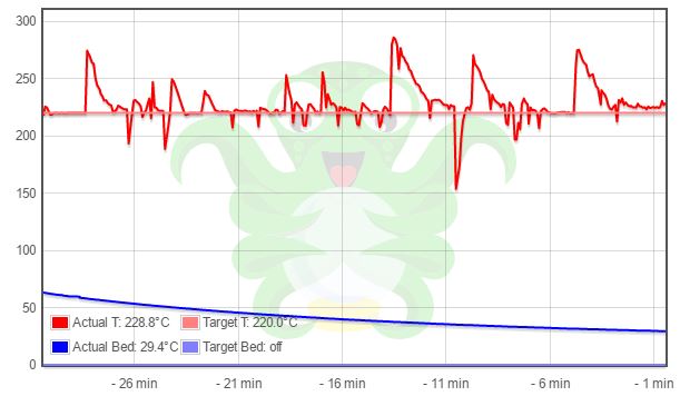

OK, on to my next problem, When I heat my hotend it heats up nicely and quickly and then sits at the temperature i set very stable....until i extrude. as soon as i extrude or retract the temperature jumps. sometimes as much as 30° to 65° off of what I have set. this does not seem normal. i was thinking interference so i moved the thermocouple wires and the extruder wires as far from each other as i could get, at no point are they closer than about three inches. I am trying to figure out if there is a pattern.
I just tried three retracts in a row, it droped about 10° the first two times and then the third time it jumped 65°. 4th retract it dropped 70°. 5th retract went up 50°. this makes no sense. The only trend i truly notice is that when it drops it recovers very quickly but when it goes up it takes a while to get back down. which would make sense since its easier to add heat than remove it.
Ok, i attached a screen shot of the last half hour of my temperature graph...any one have any ideas?

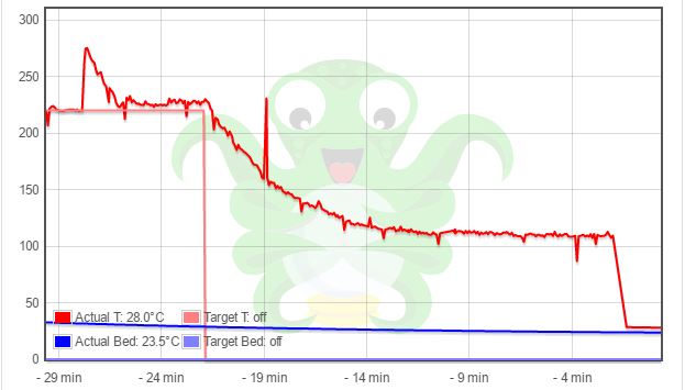

So this is interesting. the tempearture seems to have stabilized at just over 100° when it was infact just about room temperature....turn the printer off and back on and it dropped right down to where it really is. interesting.
Re: Going to Build using the Max Metal Frame...no kit
So I ripped the thermocouple out and put in a thermistor and the temperature works just fine and is rock steady....Ill do some testing to see if i can figure out the thermocouple thing. and if we ever get support for it i might through in the E3D PT100 sensor. but for now it looks like im sticking with a thermistor.

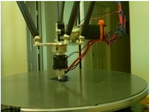

OK, the new problem, I got everything set up and calibrated and working. Got my energy on 626pilots auto calibration to 0.012, but when i try to print it goes down and is scraping the bed as it tries to print...i of course stop it quickly, but i am having trouble figuring this out. it obviously knows where the bed is from all the calibration, why is it crashing when printing. I tried changing the Z offset in slic3r, but that did not help...dang baby just woke up, got to go get him.
I want it to work, but fixing is fun.
I got that advice in another thread where i had asked about my problem...and now I am printing and everything is looking good....well I have a spot on my bed that is all scratched up from the scraping problem and I am having adhesion issues at that spot. but other than that I am good. and at least i know what that problem is and how to fix it and avoid it in the future.bubbasnow wrote:now that your bed is mapped thats fine, but i always drop my nozzle 10mm above the surface, and move it down incrementally then set the zheight using a piece of paper. then do M306 Z0 to ensure nozzle height is set correctly. This is done at temp.
