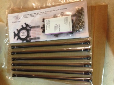

They came early :DDDDDD
Re: Mike's Birch V2
Posted: Sun Nov 09, 2014 3:39 am
by Nylocke

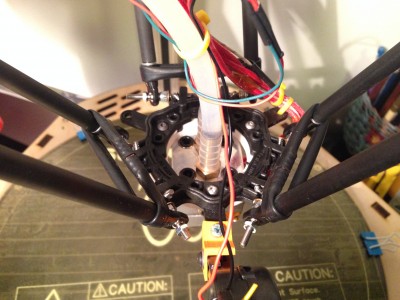

It took me 4 hours to do the upgrade, but a whole night, 60 pictures, and an aching back (I'm too young for an aching back :/) later its finished!
Finished!
Finished!
Close up on the Effector

Psst! Dude! Your effector platform is upside down.
Just sayin'. :D
Re: Mike's Birch V2
Posted: Sun Nov 09, 2014 12:14 pm
by Nylocke
That's intentional, the Kraken mounts better that way :P
