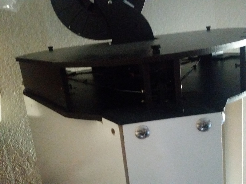

I've been trying to get this enclosure on my Max V2, but even the modified version posted earlier wasn't a good fit in my case (maybe a slightly modified revision, or whatnot).
So I contacted OP and got the original design files, and modified the top mount plate to fit.
I'm not really finished yet, but in the picture you can see how I mounted things, and instead of plexiglass, I'm using MDF particle board for now. I'd like to have it all laser cut with a somewhat stronger material eventually, and simply have a glass door on the front side. The enclosure parts were my first prints on this machine, so it's been a great learning experience designing the modified parts, and working with the heat inserts etc..
FWIW, it's a really tight fit around the top tower mount, so if you do print these it'll need a little bit of 'willpower'

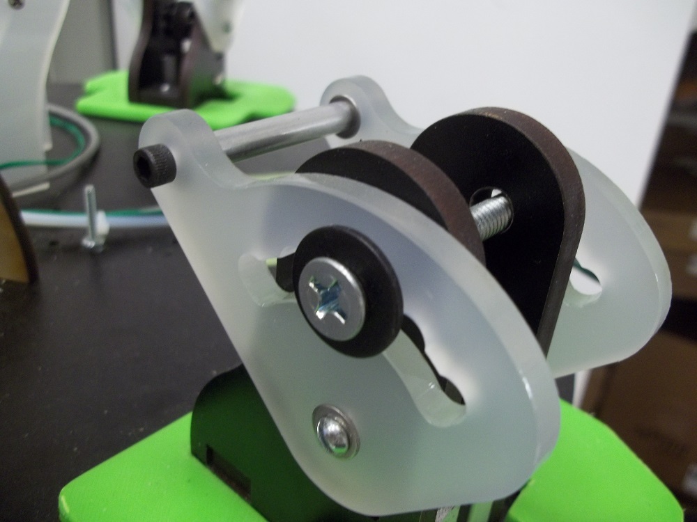

Sorry if I missed the answer to this question, but are those brass threadserts set into the bracket for the screws? I kinda skipped over the posts talking about the arm/hotend mount upgrades.

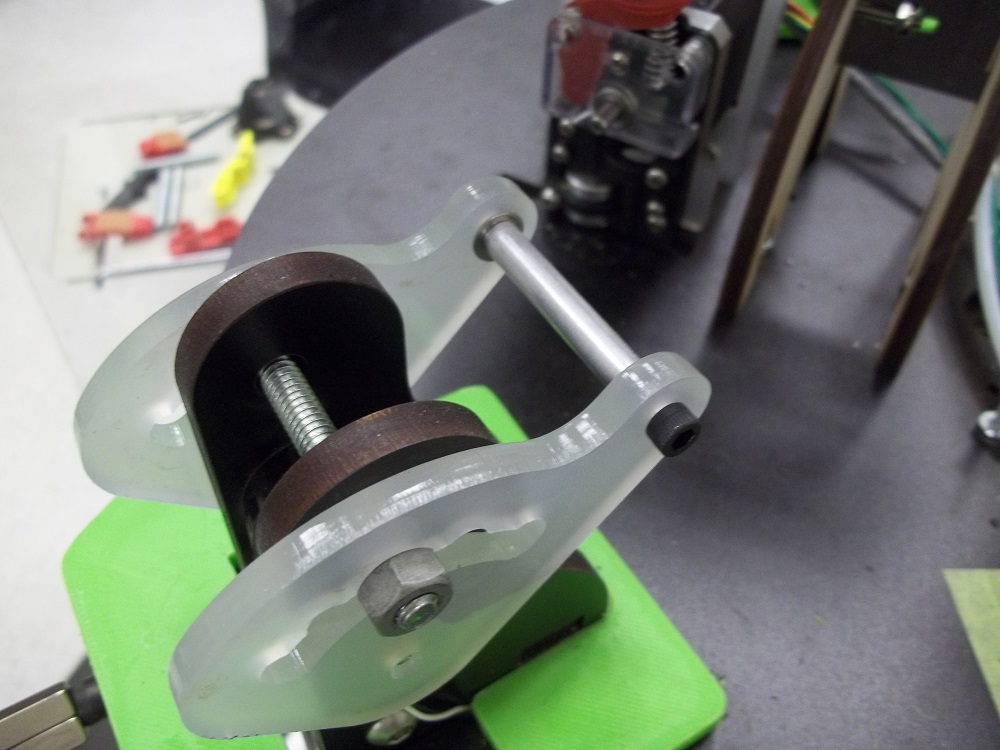

I am wondering if you have the .STL for those tensioners.

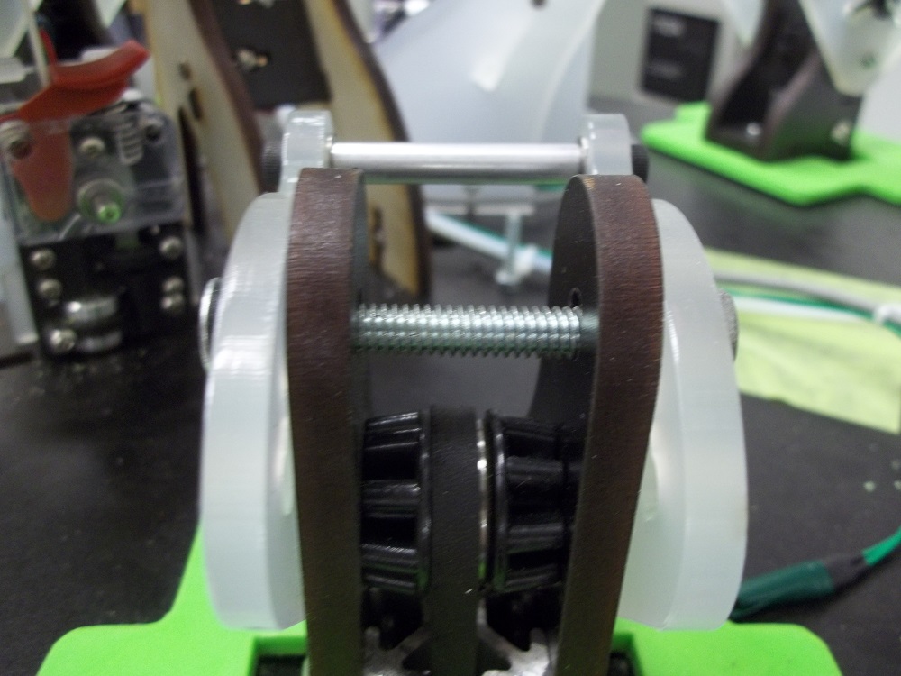

Yes, 1/4-20 heat-set inserts from McMaster (http://www.mcmaster.com/#93365a160/=x78n32). Since they're so big, I found it easier to heat them up with a heat gun and then pressing them into the ABS instead of using a soldering iron directly.cyber.shifter wrote:Sorry if I missed the answer to this question, but are those brass threadserts set into the bracket for the screws? I kinda skipped over the posts talking about the arm/hotend mount upgrades.
I laser cut the panels for the tensioners. Files attached. You'll also need a standoff and/or the appropriate sized bolts to make it work like I have it. I think it only works with the V1, since the V2 has a different top.stonewater wrote:I am wondering if you have the .STL for those tensioners.
