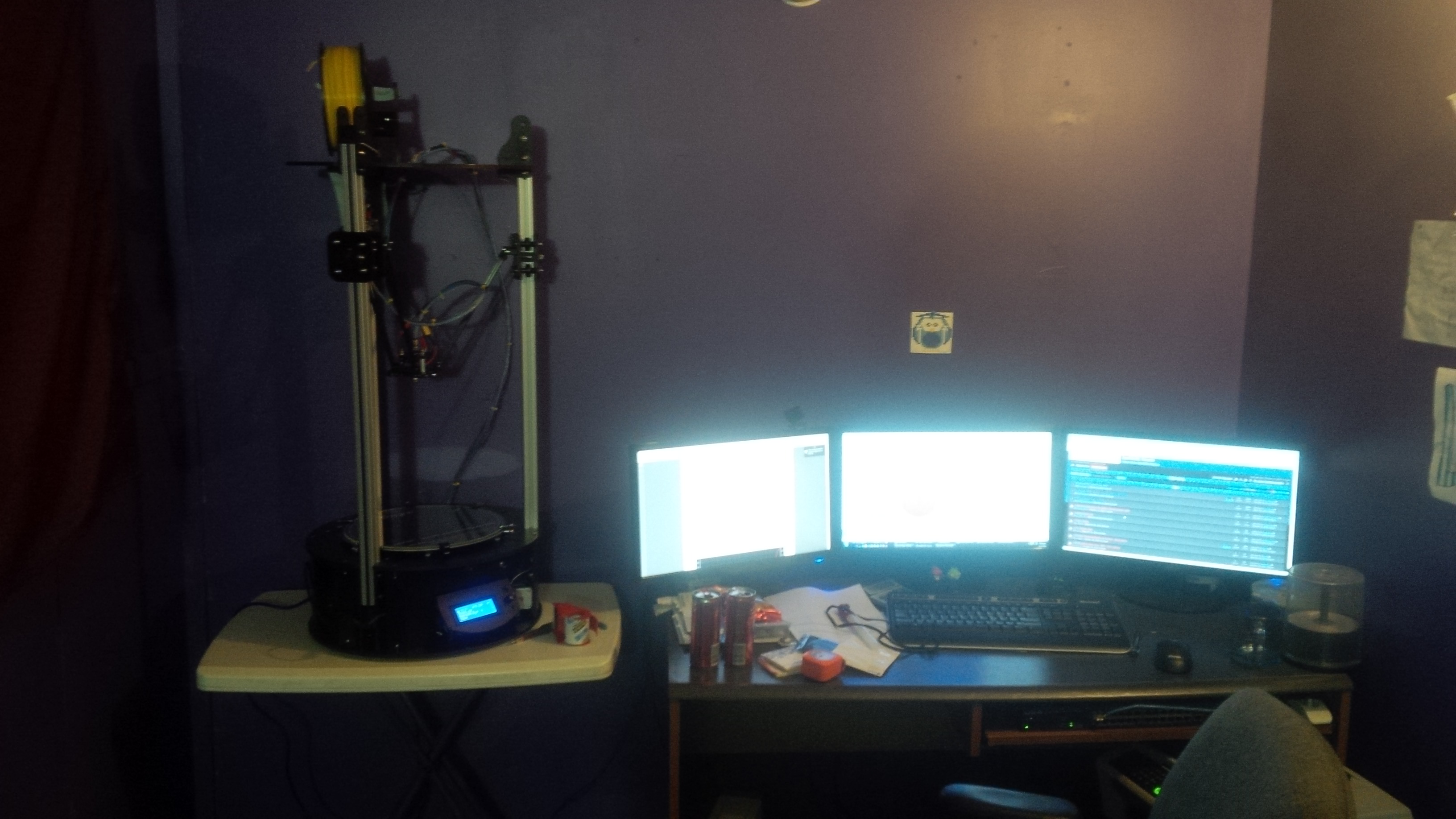

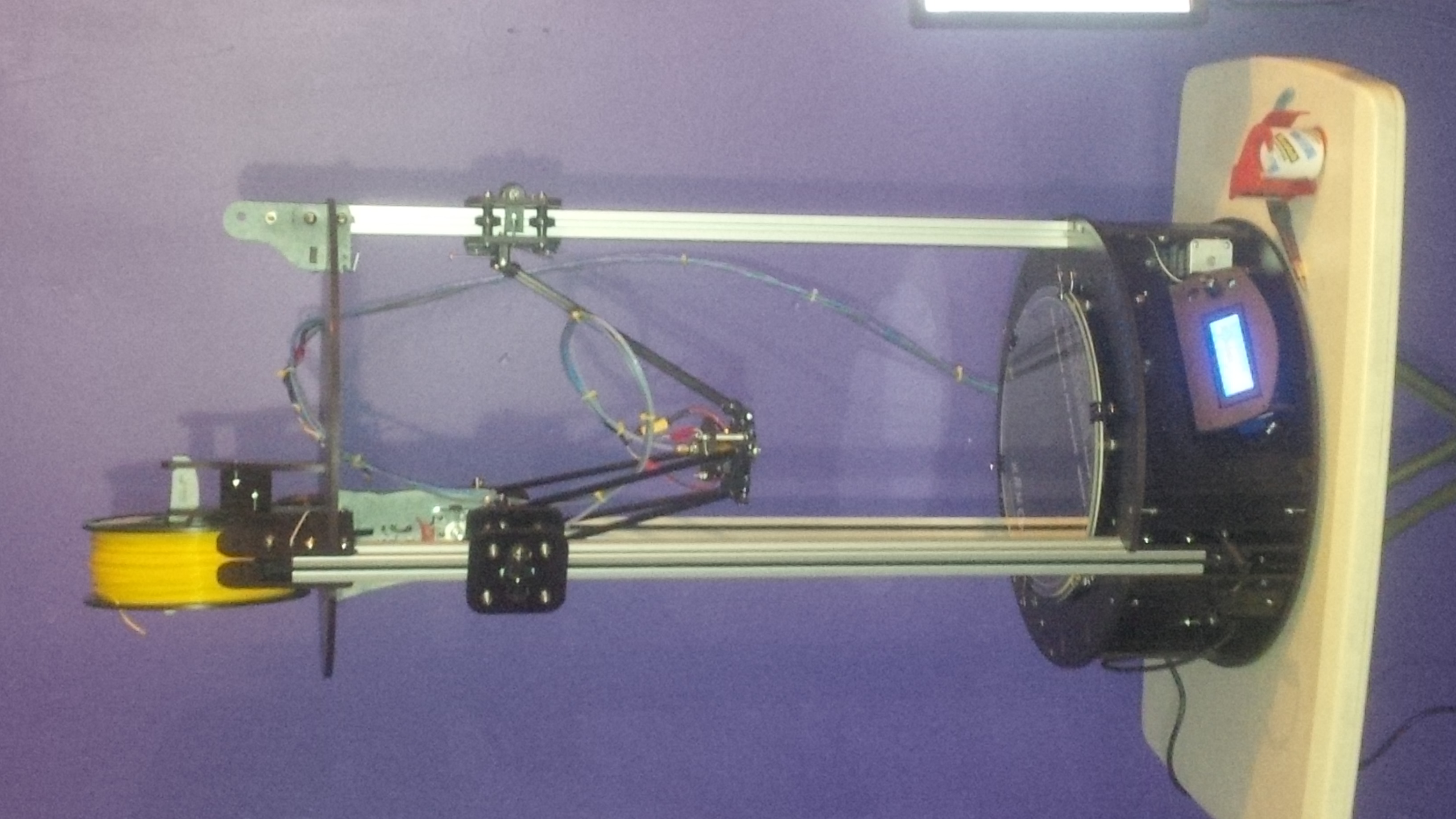

Here you go, this is what all M hard work resulted in, a very nice black Rostock Max with blue lettering and Trick Laser carbon fiber arms! I think it's a thing of beauty an that it goes nicely with my whole set up.
The build may be done but the configuration ha just begun! :D

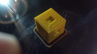

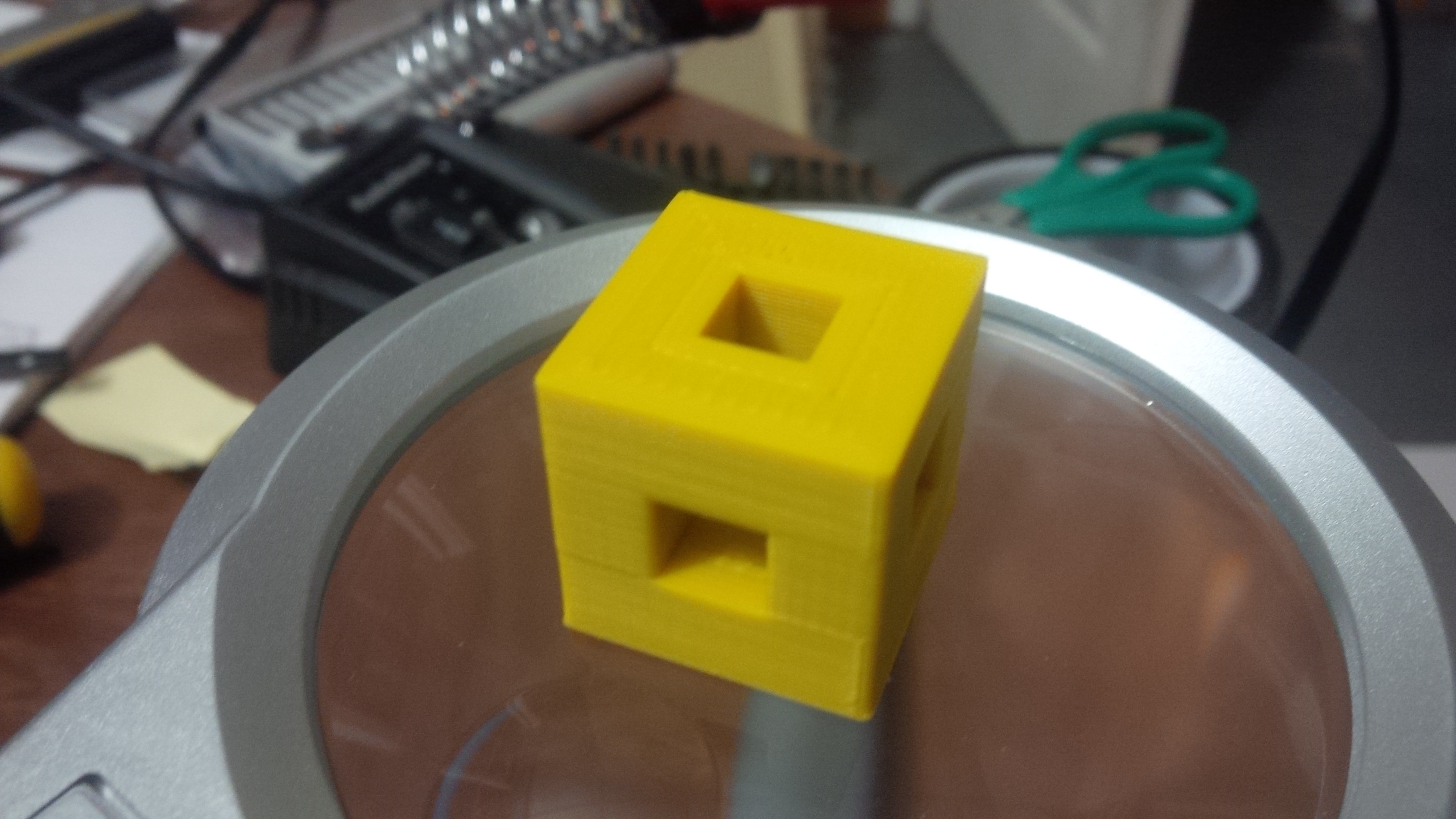

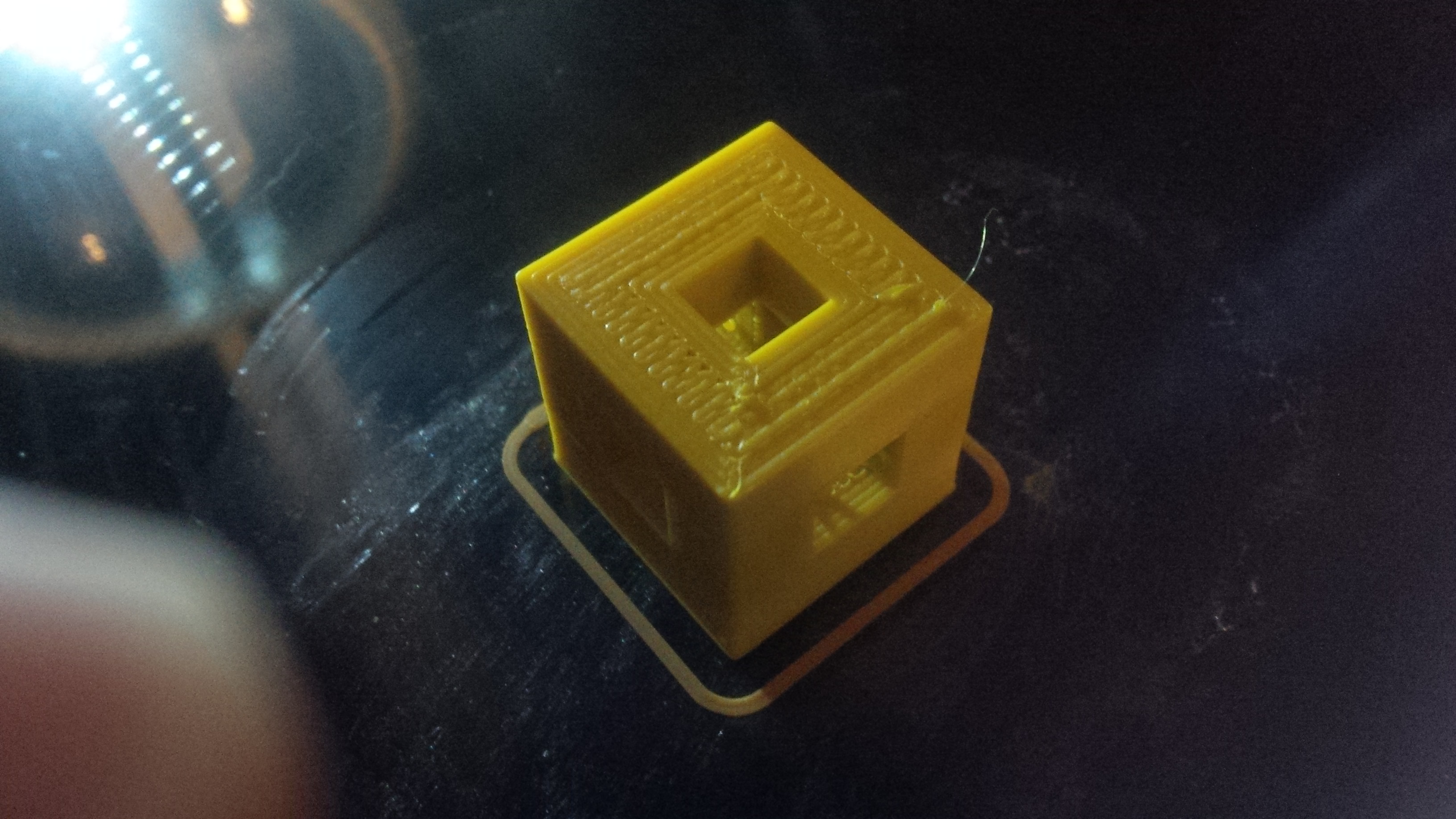

Well, it's not like I have tons to compare to, however I think my first print ever came out pretty good. The only part where there was was mess up was when it was done printing the 4 little towers and started the soli top part, between the gaps in the few spots the plastic fell a little. Other than that It went good I think, it was great to watch in real life rather than online! I'm hooked! Lol! This was the calibration cube in the manual with seemecnc yellow ABS, Hot end at 220 and bed at 80.

Re: My first 3D Printer is a Rostock Max -- Build Log From M
Looks pretty good to me!

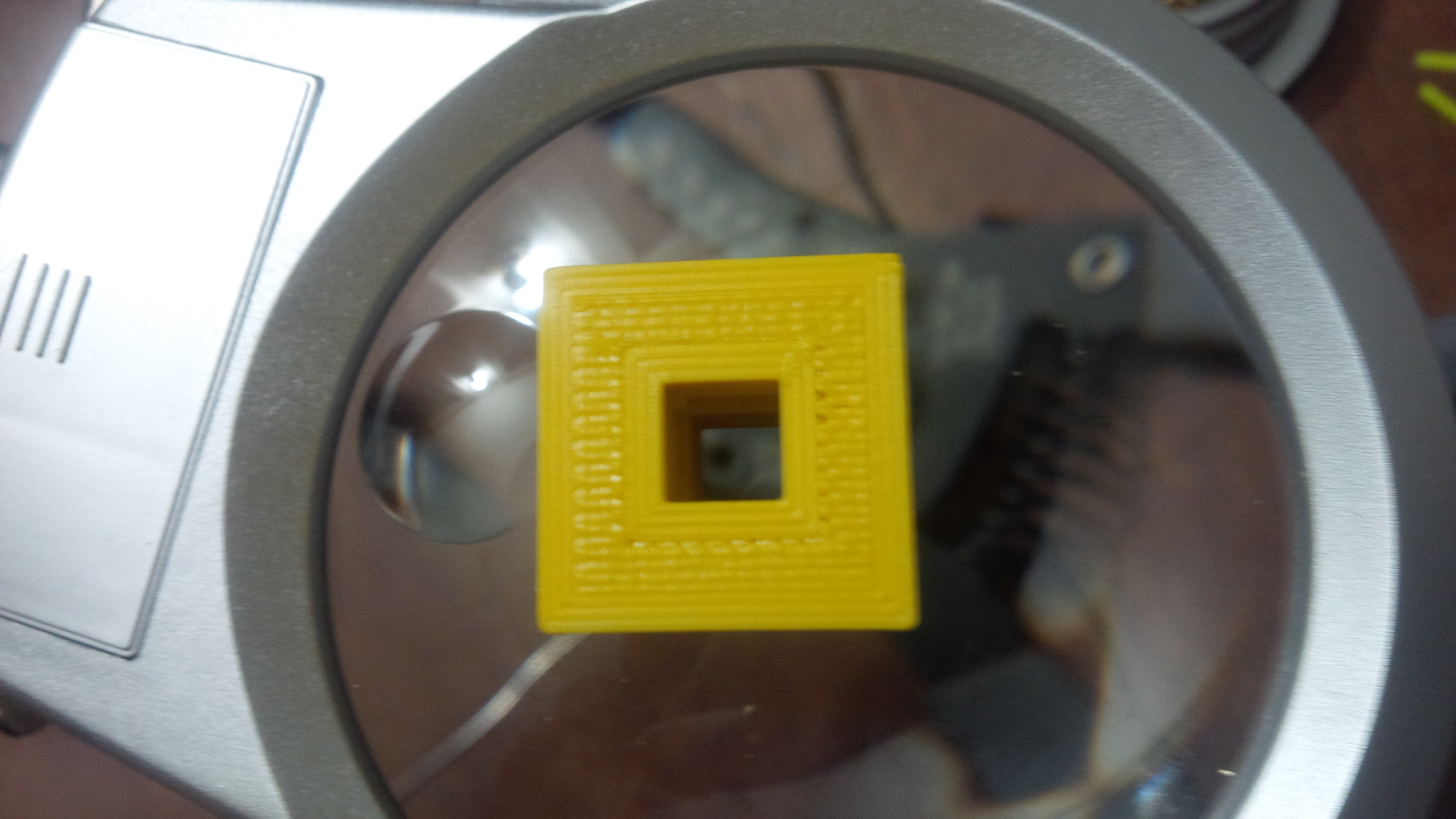

Doe anyone know what the measurements are supposed to be for the calibration cube?
I get 25mm when I measure my cube, and 8mm for the holes.
That looks dang good! Congratulations on getting this far.
AndThenSome09 wrote:Doe anyone know what the measurements are supposed to be for the calibration cube?
I'm not sure what the measurement is supposed to be but if you load up the stl in NetFabb you can use the
measurement tool to see what they are supposed to be.
He's got it nailed, Eaglezsoar. The cube is 25mm square and the posts are 8mm square.
Good job!
