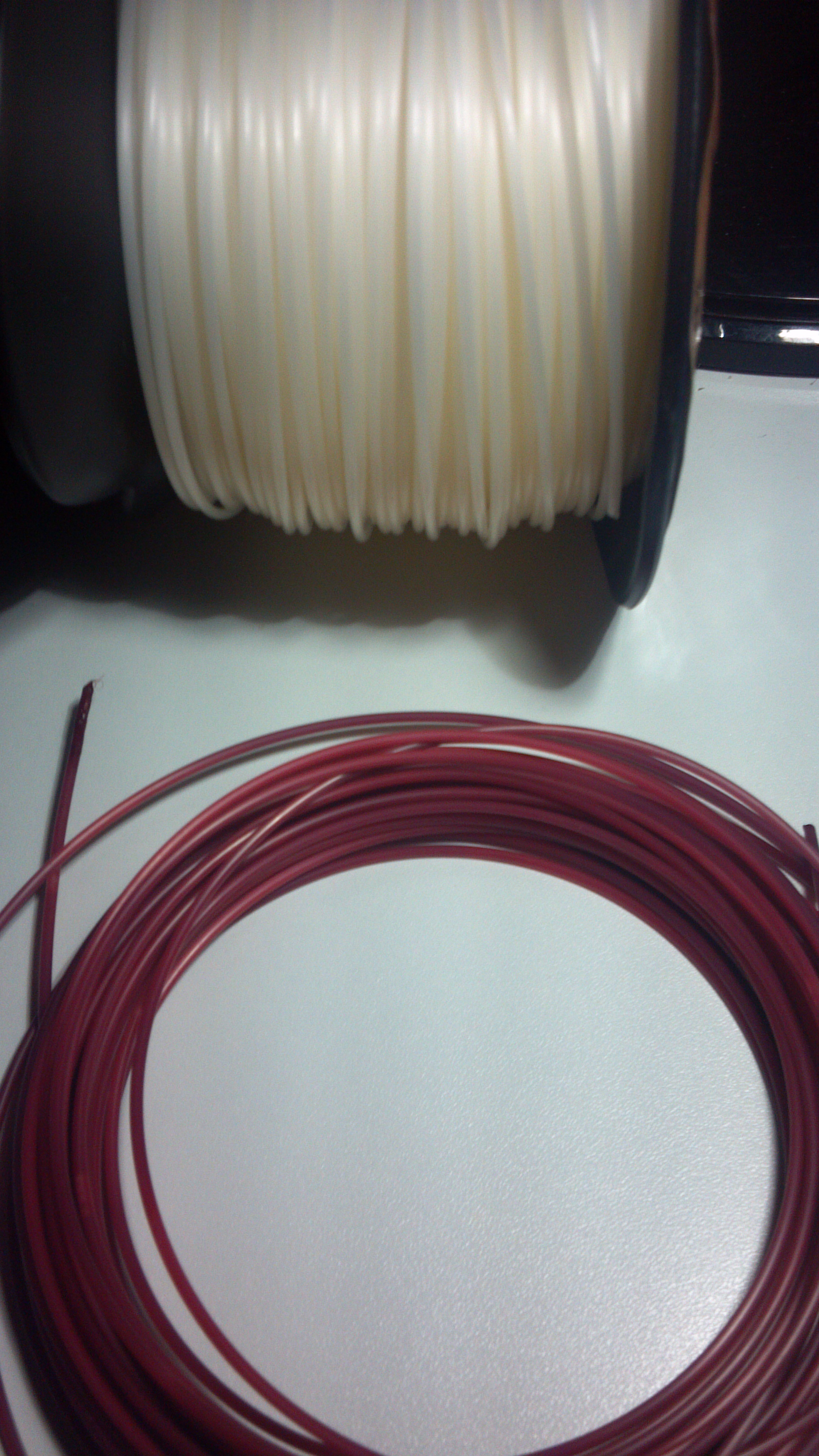

Initial signs show it took. I'll post pictures and my method in a little while. Filament will need to be dried before i can print with it to see the result.

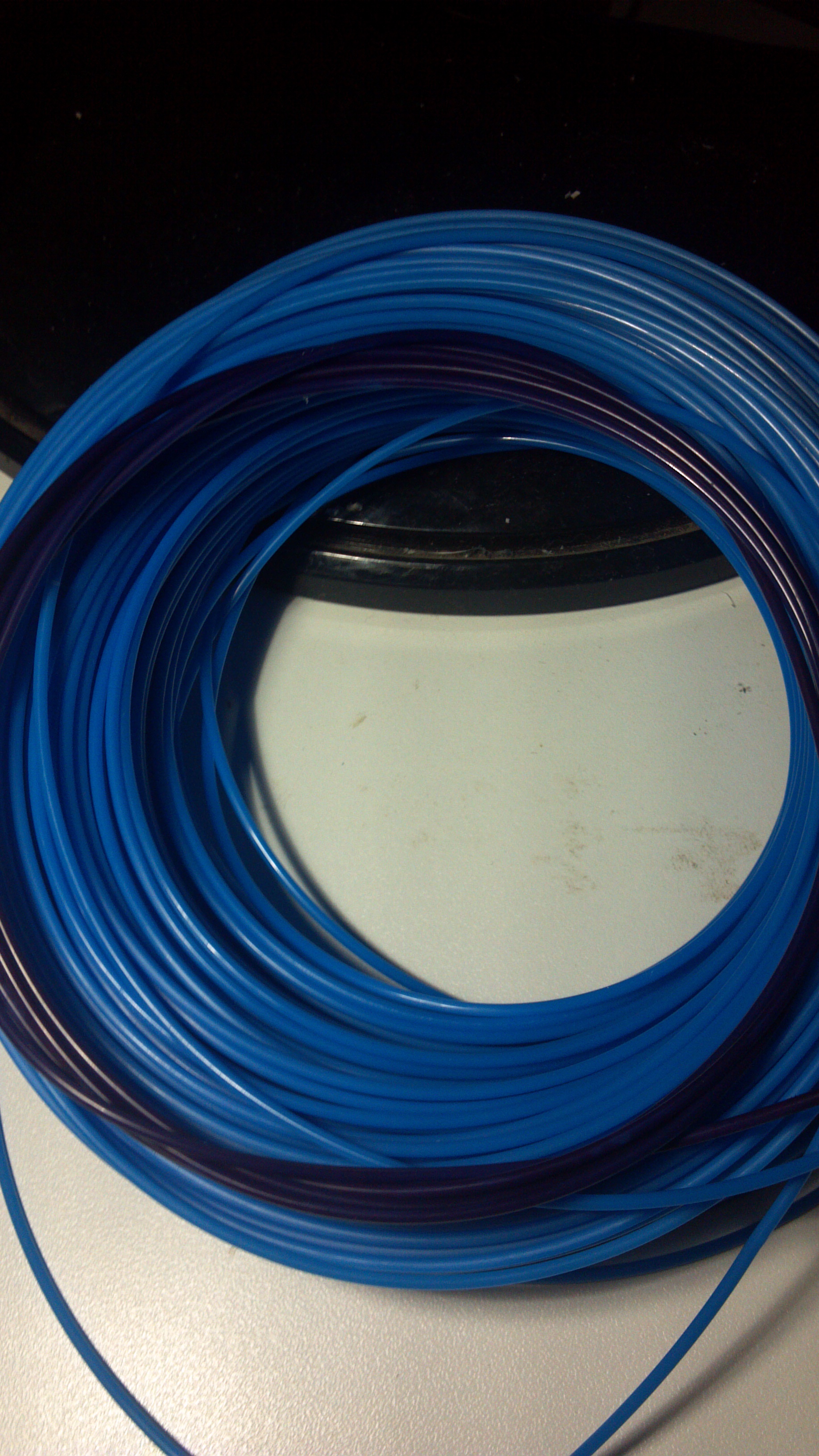

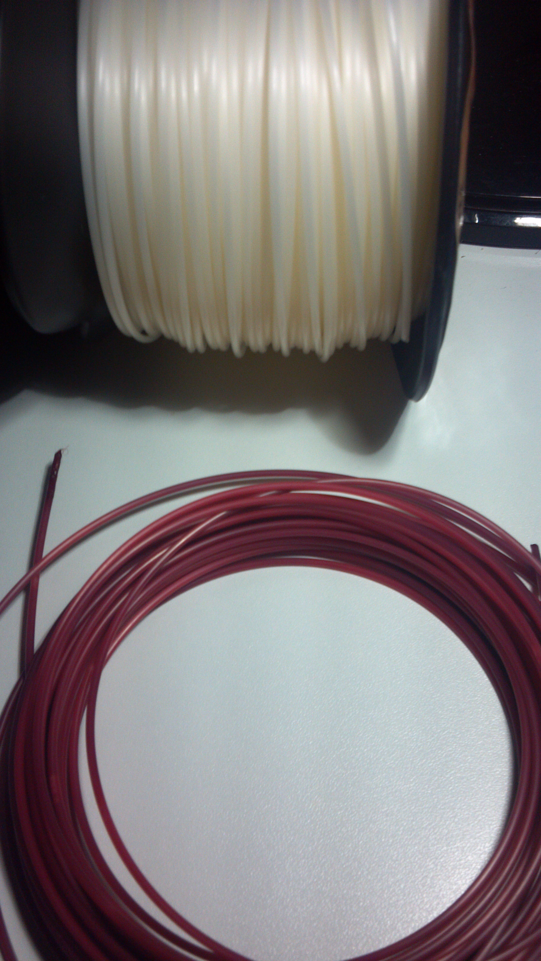

Ok, so I took pictures after I dried it since I was busy doing other more 'responsible' things :roll: My apologies for not being more precise I just winged it to gauge the effectiveness.
I used:
- Glass bowl
- Rit Liquid dye : Scarlet ( maybe a quarter of the bottle?)
- 1 Cup White vinegar (the only thing I actually measured.... :oops: )
- 1 or 2 cups hot water (I COULD figure it out by filling up the bowl again, but it's already been cleaned 8-) )
- I put in some natural taulman 618 and some of the blue trimmer line
- Some string to tie the filament together. I didn't want part of the filament lifting above the liquid.
Just placing the filament into the bowl and letting it soak for a couple hours just tinted the taulman filament, and nothing noticeable to the blue nylon.
So I figured I was missing some heat. I looked at the oven and thought how long that would take, so I went for the microwave above it. I covered the glass bowl with a paper towel so I didn't make a mess, and hit 2 minutes on the microwave. I ended up microwaving it for 2 minutes every few minutes and then feeling the bowl to see how hot I was getting it. I think it was 6 or 8 minutes of microwave time total, I stopped when the bowl was hot enough that I would prefer not to touch it for long but not to where I burnt myself. Then I just let it sit for another hour or so and when I checked on it... the taulman was a nice red shade and the blue trimmer line turned a dark purple! Victory! ....until I see how it prints... but until then Victory!
Here's crappy cell phone pictures :P :

Eaglezsoar wrote:
lordbinky wrote:Initial signs show it took. I'll post pictures and my method in a little while. Filament will need to be dried before i can print with it to see the result.
If you can, please give us your thoughts on how your process could do a whole spool of the stuff. If you have been using the line trimmer nylon you have an idea on how big
the spool is. By the way is your real name Harold? Mine is Carl in case you didn't know that.
I'm just a Josh, nothing as unique as a Harold.

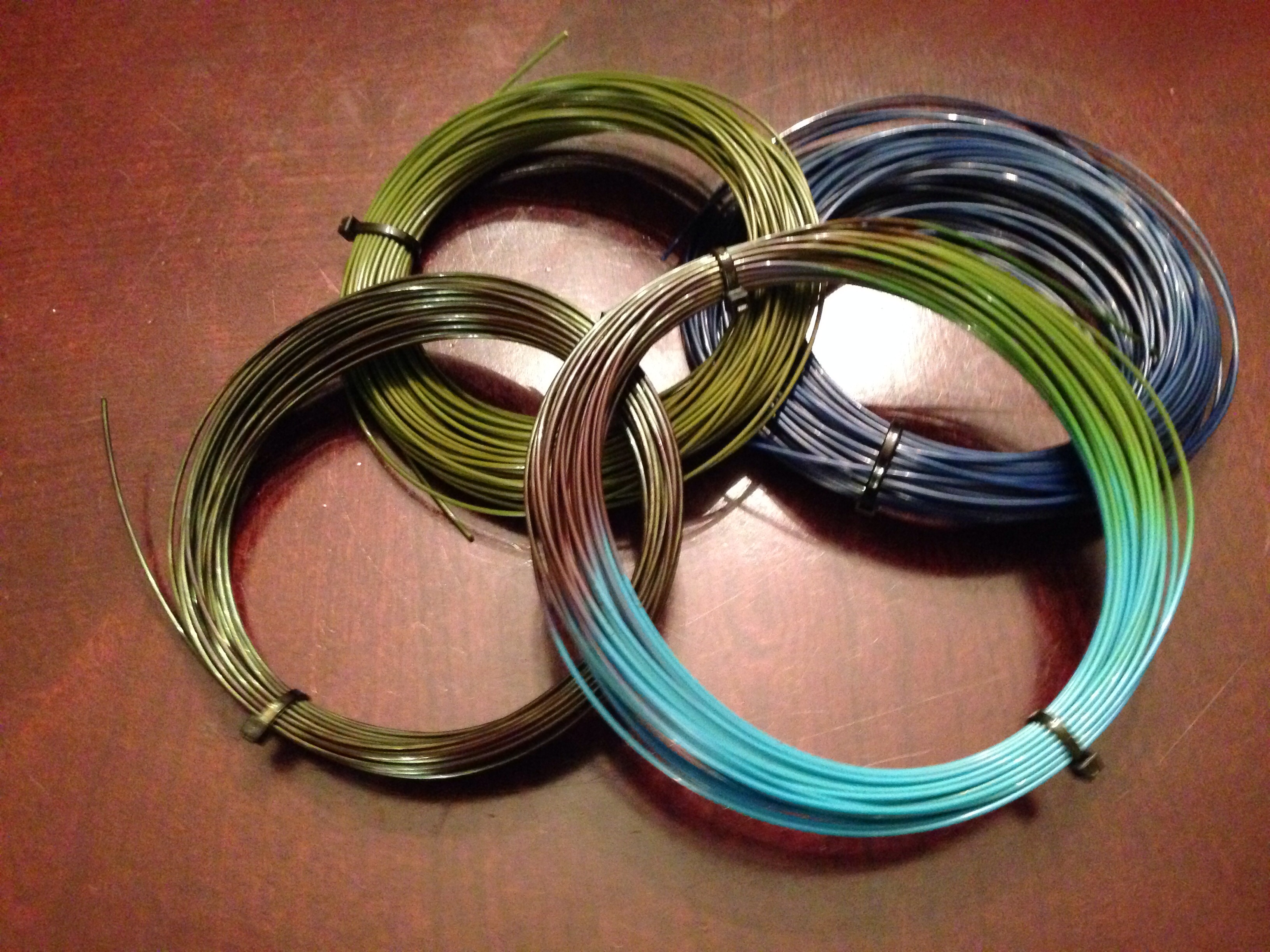

I had a partial success with my black dye job. I followed RichRap's post and pre-heated the nylon in boiling water and didn't use vinegar. I let it sit for about 45 minutes. When it first came out it looked like it had taken perfectly, but that was just the surface and after rinsing it came out much less dark. While it's not black, it's still a very nice shade of blue, so I'll call it a partial success.
I'll give it another shot soon and maybe try two packs of dye, and I'll give a run with vinegar too for comparison. I also bought some yellow dye and will give that a try soon.

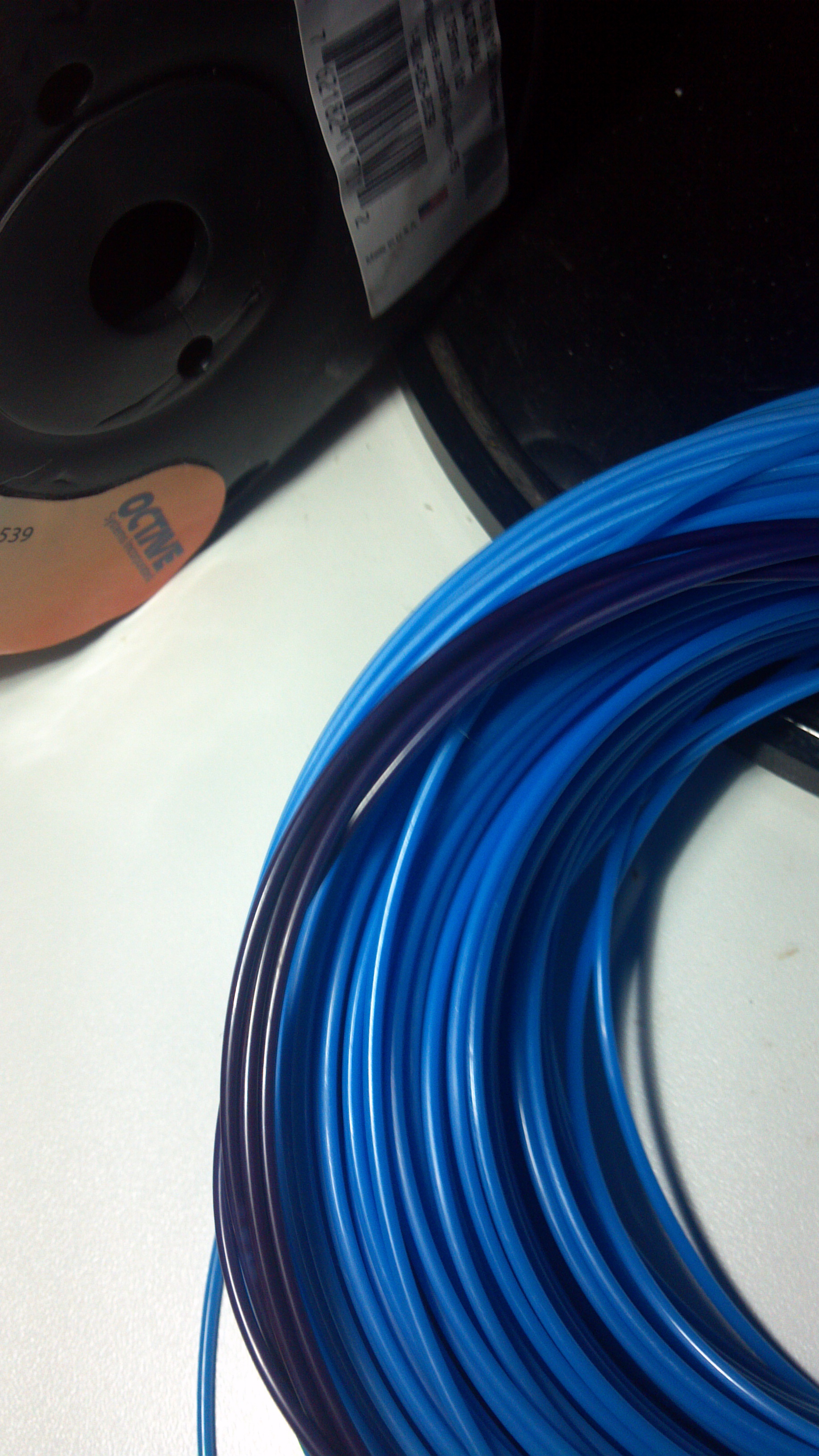

You have to remember that this line has already been dyed. The blue dye in the line will mix with whatever you're using. Mixing it with yellow dye will give you some form of green. Black should work best because with enough of it, you can get to a true black.

I essentially did that, just pre-heating the line in a separate pot. So I put ~100*C trimmer line in a pot of ~100*C dye, which was then taken off heat. Are you saying you keep the pot boiling for the 15 minutes that you're waiting for the dye to set?
And cope413: yes, with the yellow dye the desired outcome would be green filament of some shade. It prints very nicely but there's only so much bright blue I can look at!

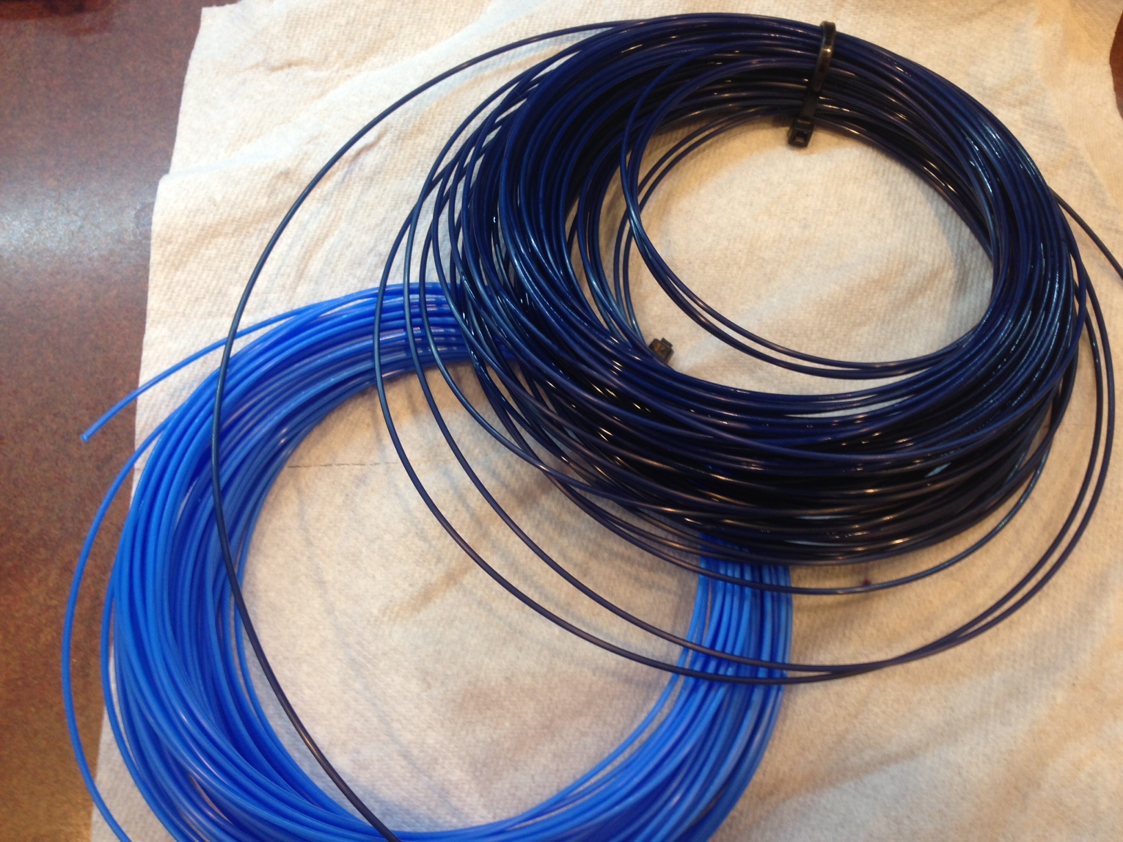

I died my first amount last night. Unspooled about 1lb of it, dyed it and left it soaking overnight. It's drying but it looks pretty black.
If the results from this amount are good, then I will attempt to dye a whole spool.

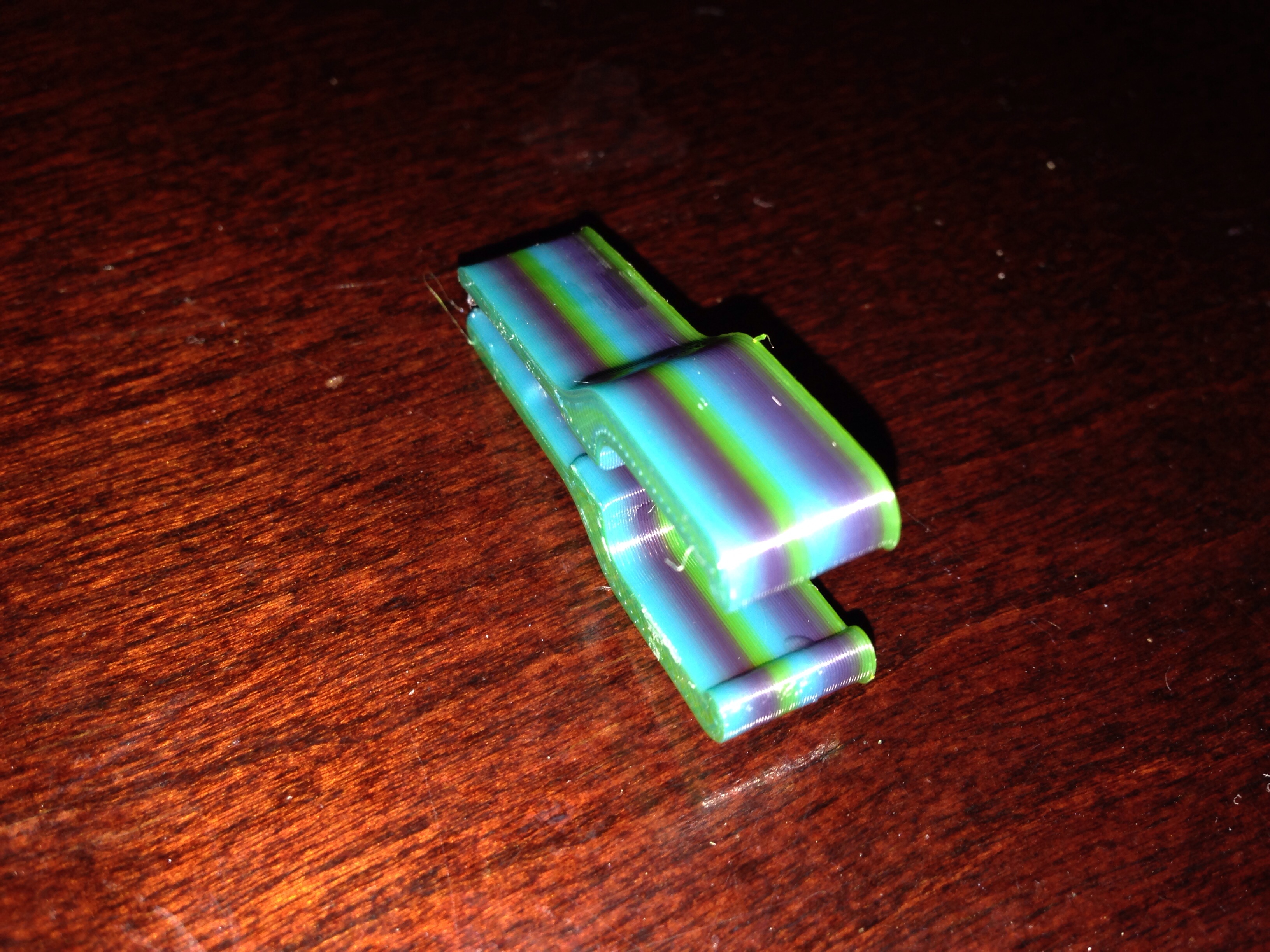

Yellow produced a nice green, and red gave a good lucking purple. As for the tie dye, well, this makes me happy. Used a cup of vinegar this time with about one cup of water and did leave it to simmer for about 30 minutes.
