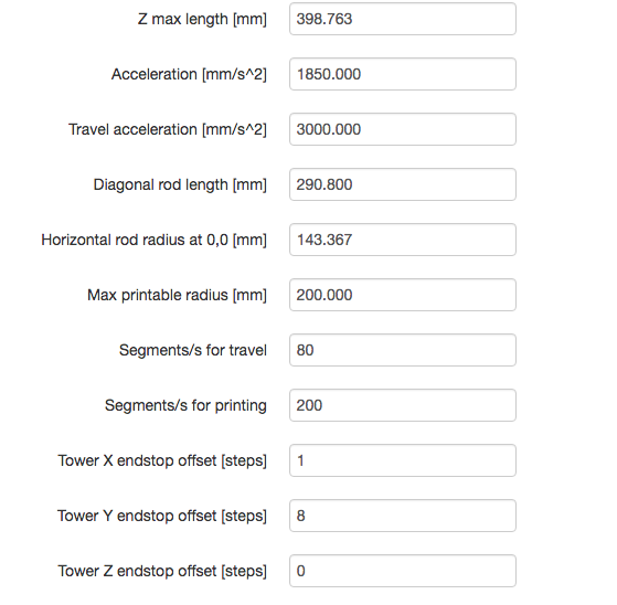

Once you have your V3 built and probing and printing here are a few things you can do to improve auto-calibration and reproducibility.

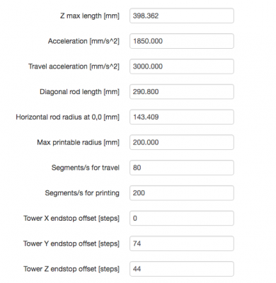

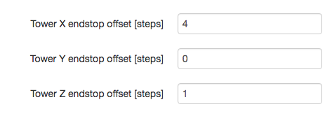

Tweak the carriage screws to get all three tower endstop offsets to within 4 steps/mm (or less). Travel is 80 steps/mm so 8 steps is 0.1 mm. The target 4 steps is 0.05mm. As you can see in the screenshot, mine are within 4 steps.
Here's how you do it:

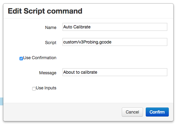

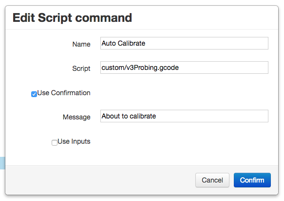

Calibrate to get your baseline. After you calibrate, look at the eeprom settings for the tower offsets as shown above. In OctoPi I use 2 plug ins that make this really easy: 1) EEPROM Repetier Editor Plugin and 2) Custom Control Editor. I created a custom button that runs the v3Probing.gcode script, making it really easy. Here's a screenshot on how to set that up:
Once you have the control created, you need to put a copy of the script in: /home/pi/.octoprint/scripts/gcode/custom on your RasperryPi. The control automatically looks in the custom folder.
Ok, so you calibrate and then look at the eeprom settings using the EEPROM plugin. I've found that a 1/4 turn counterclockwise is about 7 steps. Start with your tower with the largest offset. Take the difference in the number of steps between the towers with the greatest values - so if Z was 21 and X was 8 and Y was 14 - the difference between Z and Y is 7. Simply turn the Z screw about 1/4 turn counterclockwise then re-run the auto-calibration and check again. Continue this process until you sneak up on <4 steps for all 3 towers. Note that you could also do the opposite of what I described above and increase the steps of the lowest tower value.
Once you get to a low step difference, run auto-calibration several times to check repeatability. If the steps change significantly from run to run, you likely have some sort of mechanical slop somewhere. Loose endstops, pulleys, steppers and belts are prime candidates. Hunt the problem down and fix it.
While you are doing the repeatability check calibration runs, also jot down the delta (horizontal rod) radius and Z Max length to make sure they are reasonably stable too. If delta radius caries greatly, you may have an issue with tower rigidity, lean or angle or the bed is not rigid. If the Z Max length varies the bed may not be firmly clamped.
NOTE ON BED CLAMPS: I prefer to use every other bed clamp instead of all 6. With 3 clamping positions, since a plane is defined by 3 points, there is no chance to warp or distort the bed. With 6 there is a chance that the bed could warp if you are not careful. It is very difficult to calibrate a delta with a slightly warped bed!

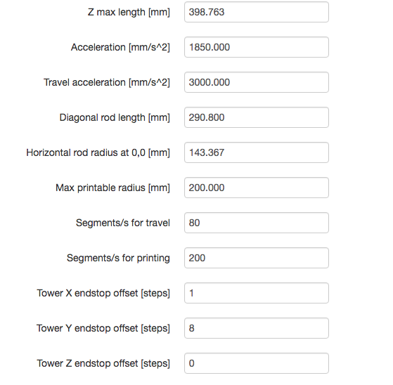

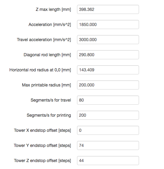

An experiment that I and user Th0mpy did last night was to rotate the HE280 120°, I rotated mine counterclockwise (looking down from top) and he did clockwise. The experiment was to determine if the position of the accelerometer on the board had anything to do with the out of level issue a few of us are seeing after calibration. In both our cases, the out of level stayed in the same place - high at the Y tower base and low between the X-Z towers. Very interesting result. Here are the calibration results:
After calibration in the new rotated position:
after rotating back to original position:
Interestingly the tower offsets were greatly affected with the rotated HE280 but they returned to "normal" when I moved the HE280 back. Note the 80 steps is 1 mm, so the rotation introduced nearly a mm of error. Just an observation for now, need to think through the math and devise some more experiments. The next thing I plan to do is a manual calibration to see how it compares to auto calibration and, more importantly, how it prints.
Ok, I simply swapped the Y and Z probing points to basically cause the firmware to do the probing at the base of Y (rather than Z) to calculate delta radius. After auto calibration, the results all looked reasonable and in line with the above. Most importantly, the bed tilt remains unchanged and in the same direction - from Y to X-Z.
I saw Polygonhell's comment in the other thread about possible calculation errors in the offsets. I'll run that test next.
