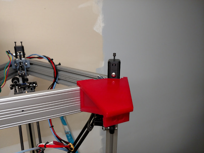

So... my bad, just saw this. I've been slowly picking at this. I'm not happy with the size of it to prevent reduction of print space and still clear the layer fans. I will soon have all the pieces in place to drop the layer fans and convert to a Berd-Air.
The advantage of the Berd-Air is a smaller enclosure and cool air coming in.
Below are a couple of pics of the first generation top bracket. The bottom was similar. The idea is to allow for magnets or heat set inserts for securing acrylic panels much like others have done. It was going to be six sided... 3 large panel and 3 narrow panels.
Always open to suggestions.
