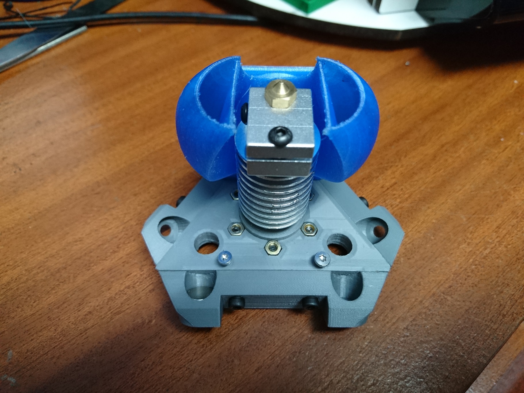

Posted: Thu Nov 05, 2015 4:53 pm
by the0ckid82
First off wanted to say thanks to everyone who has made the first 3 weeks with my rostock amazing. thanks to Xnaron for this great idea! This was the first mod i did to my printer. also Thanks to Techstorage for pointing me to the google group with the mag arms and premade balls. i just wanted to share my latest design that i will be printing later tonight for this mod, i created a new effector plate that has built in cooling ducts that eliminate the need to worry about clearance issues. it uses 3 blower fans ( these ones http://www.amazon.com/gp/product/B00MJU ... ge_o01_s00) which quite frankly is over kill as they only need to run at about 14% the majority of the time. anyways heres a quick render of it and after ive printed it and tested to make sure this version ( its the 6th version now) work correctly ill be more than happy to share the files if any one else would like to try it out
[img]http://theock.net/images/Rostock/ock_Effector_v6.PNG[/img]
[img]http://theock.net/images/Rostock/ock_Effector_v6-1.PNG[/img]

Posted: Thu Nov 05, 2015 4:57 pm
by Jimustanguitar
Nice! You beat me to it, I've literally got a half drawn effector platform in the works that holds and ducts the air from cooling fans very similarly to your design. Great work.
I'll keep at the design on mine, because it's for traditional axle mounted arms, and a lot of people (myself included) still need those.
*edit* Does that Amazon seller realize that their picture is of a broken fan? I'm pretty sure that one doesn't work.

by the0ckid82
haha ya i noticed that the wires were pretty much shit in the image as well, luckily the ones they sent me all actually worked.
Posted: Thu Nov 05, 2015 9:04 pm
by Eaglezsoar
the0ckid82 wrote:First off wanted to say thanks to everyone who has made the first 3 weeks with my rostock amazing. thanks to Xnaron for this great idea! This was the first mod i did to my printer. also Thanks to Techstorage for pointing me to the google group with the mag arms and premade balls. i just wanted to share my latest design that i will be printing later tonight for this mod, i created a new effector plate that has built in cooling ducts that eliminate the need to worry about clearance issues. it uses 3 blower fans ( these ones http://www.amazon.com/gp/product/B00MJU ... ge_o01_s00) which quite frankly is over kill as they only need to run at about 14% the majority of the time. anyways heres a quick render of it and after ive printed it and tested to make sure this version ( its the 6th version now) work correctly ill be more than happy to share the files if any one else would like to try it out
https://goo.gl/photos/4PfLHMqMHBjkYscK6
It would be great if you posted the stl and a picture of it actually hooked to the arms.
